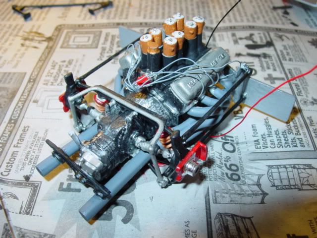

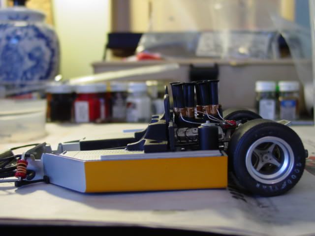

A very quick mock up
My attempt at some kit bashing with adding wire for the shocks and other detail wires.
Let me know what you think, good or bad :D

Just wanted to let you know that you have the plug wires coming out of the fuel distributor. The magneto is the verticle round piece that the fuel distributer mounts to. The wires shuld come out each side in bundles of four near the top of the magneto. Plug wires on that car were black. The Fuel injection lines come out of the same place your current plug wires do and go to the base of each fuel injecter tube. They should be clear plastic like thin fishing line.
I did extensive research on these cars several years ago. Don't even start on the dry sump oil system! :lol:
I did extensive research on these cars several years ago. Don't even start on the dry sump oil system! :(
Thanks for the info!! Even though it means reworking the engine I really want it to be accurate. What size fishing line would be proper scale? Are there any good pics around that might give me a clue as to how the engine bay really looks?

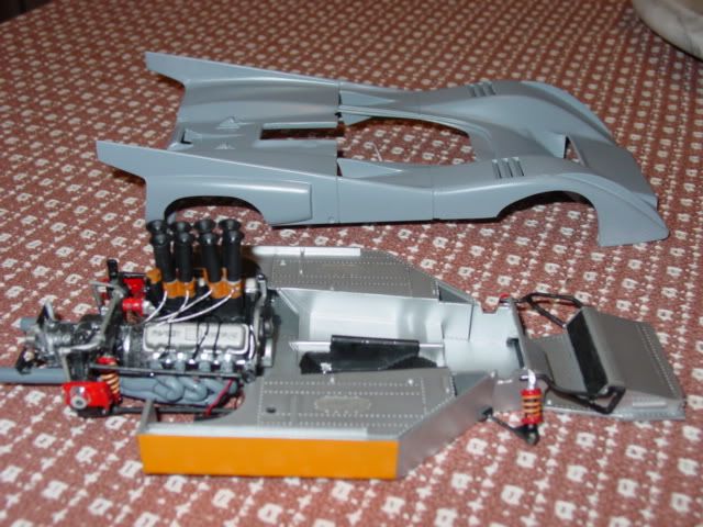

Quick update, I changed the wiring for the engine and put the first coat of primer on the body, I do have one question, How long should I wait after spraying primer before sanding? I will post pics later today on the new progress.

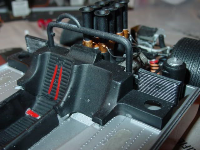

Some updates from today
I redid the wiring on this, I hope it looks better now
First coat of primer, been sitting for a week, should be ready for sanding.
Going to use Model Master Grabber Orange, closest I could find to match the online pics.

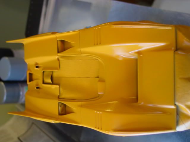

I tried to get a lot more done this weekend, I got the first coat of yellow on the body and more of the engine area done.

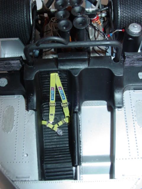

I painted the molded seat belts, i'd like to add some P/E belts but can't figure out how to mount them, lots more detail painting to go in this area, the pic looks like ###### :rolleyes:

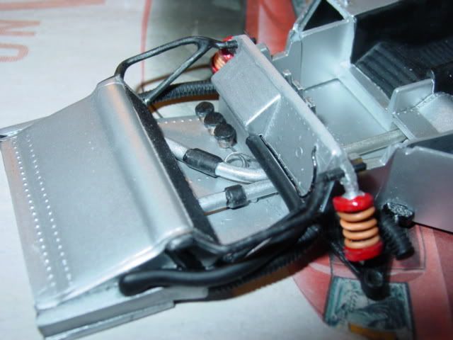

I added some brake line and other detail, how does it look?

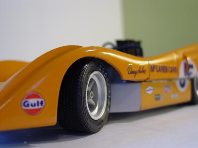

side view for the "stance" still more to do before fronts go on
Looking really good. The yellow looks super smooth, is that airbrush or spray can?
Rattle can, Hugger Orange, came out ok for a can IMO.

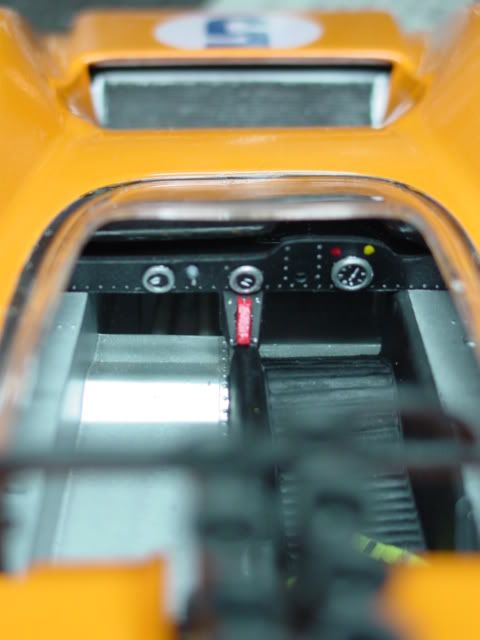

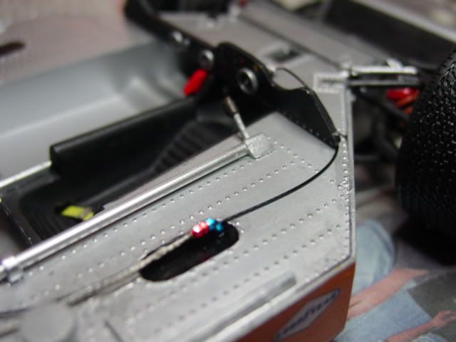

...added some scratch switches, hope they look good...
Nope - they look great :D Nice work with all the details and wireing on this tiny thing, m8!

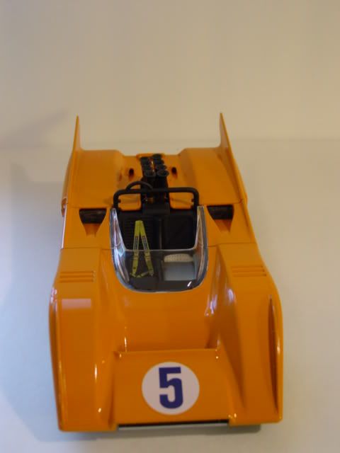

Added some more detail. made a complete shift linkage when the kit had nothing. Also added a tach line and gas line.
scratch made U-joint, as close as I could make to scale.
view of full linkage, matches all the pics I've seen of this car.
Hi Sean,
your model is looking very neat. I see you used Eduard etch belts? They certainly look better than the moulded in ones. This is going to look great when its done.
