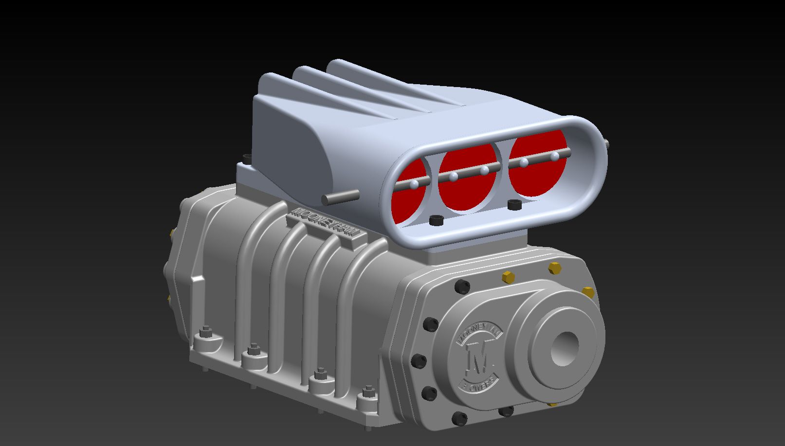

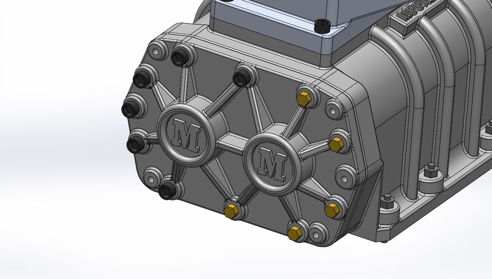

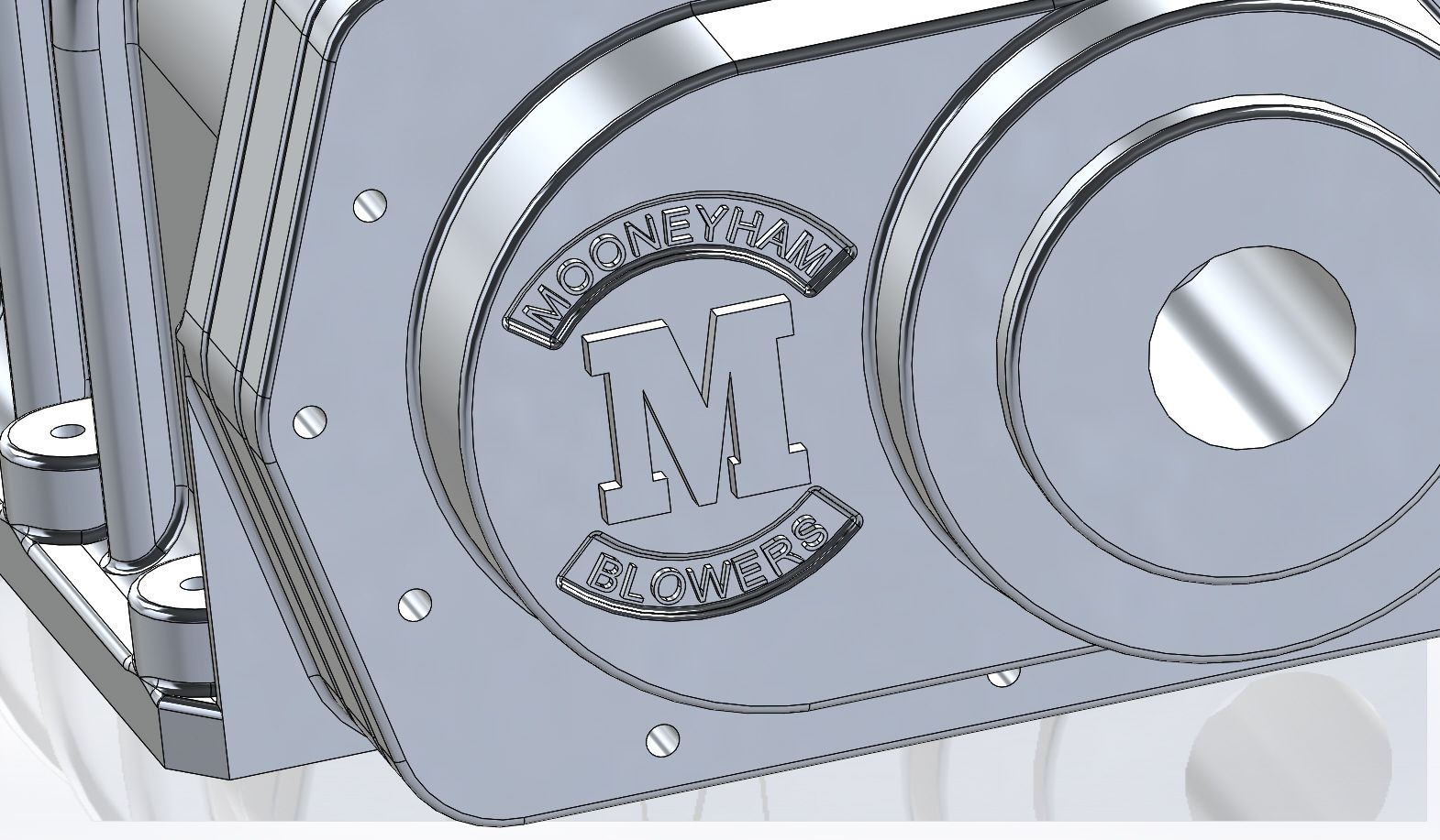

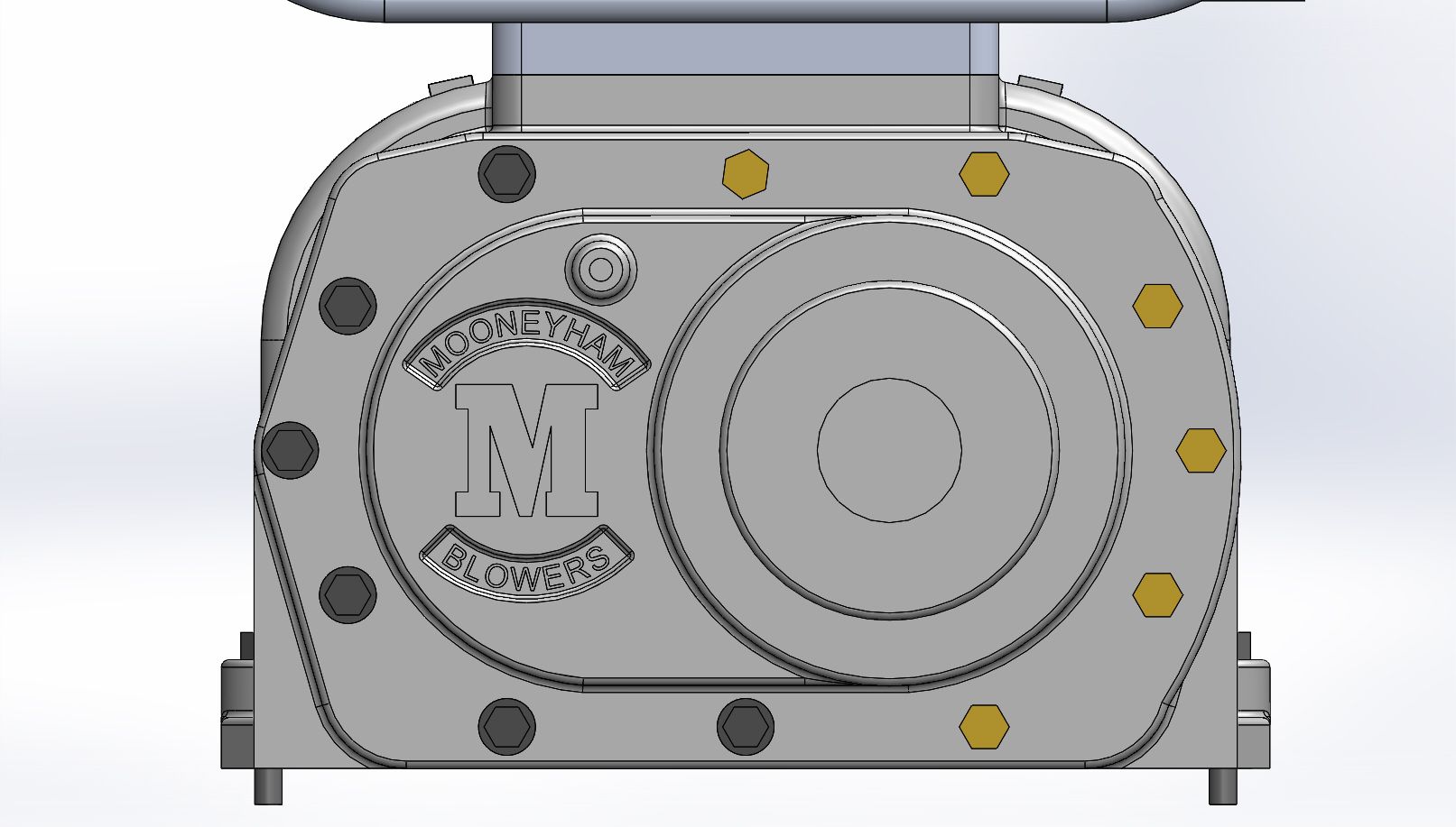

Ok Fellas... wanted to show you more work I have done today on the Blower and Injector Hat design. I think I pretty much have it completed other than I need to add the Injector ports on the injector hat and a couple of clearance holes to the blower housing. Pretty happy with it so far. I put lettering on the front panel of the blower but not sure how it is going to prints so I will probably print one with lettering and one with out. the one with out I was considering doing some thing with a decal. Any way here are a few pics and I will show you a few shots of the real deal to go along with the 3D models...
Here is the Back plate of the real car:
Here is the back plate of the 3D model. Now you will see that I have two different bolt styles as to figure out which will look the best. Most likely I will be going with the Socket Head Cap Screws as that is what is on the real blower:
BlowerampInjectorHatAssembly-13_zps30fd1
Here is a side view of the real thing:
Here is the 3D model and I decided to add the boss and "Mooneyham" on the side like the real thing:
MooneyhamBlowerAssembly-3_zps8950b1e1.jp

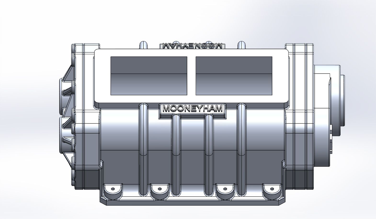

Here is a straight on view of the front plate:
BlowerampInjectorHatAssembly-14_zpsa69d1

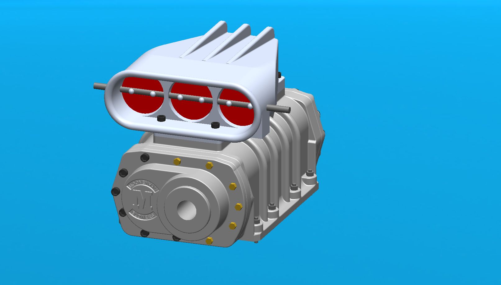

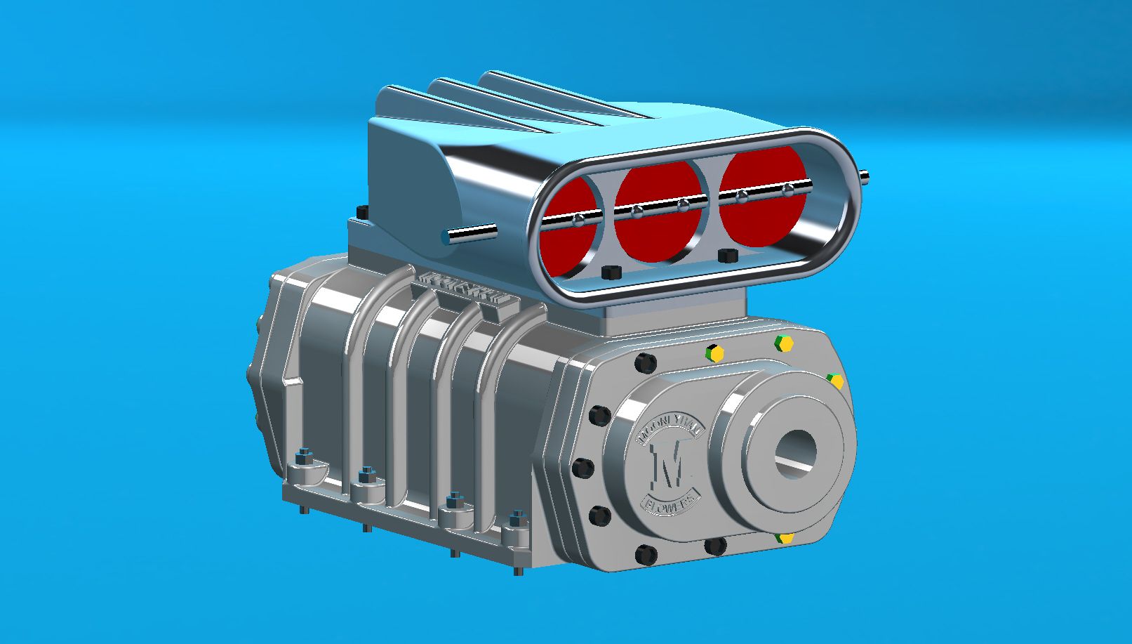

Here are some more shots of the blower and Injector Hat assembled.
MooneyhamBlowerAssembly-4_zps5c4fcdb6.jp
BlowerampInjectorHatAssembly-11_zps21aa3
BlowerampInjectorHatAssembly-12_zps329cf
BlowerampInjectorHatAssembly-10_zpsf3676
Ok Fellas... time for me to go do a little work on the build and take a break from the 3d Modeling. I need a change of pace at the moment...lol Hope to have some progress pics later for you.
