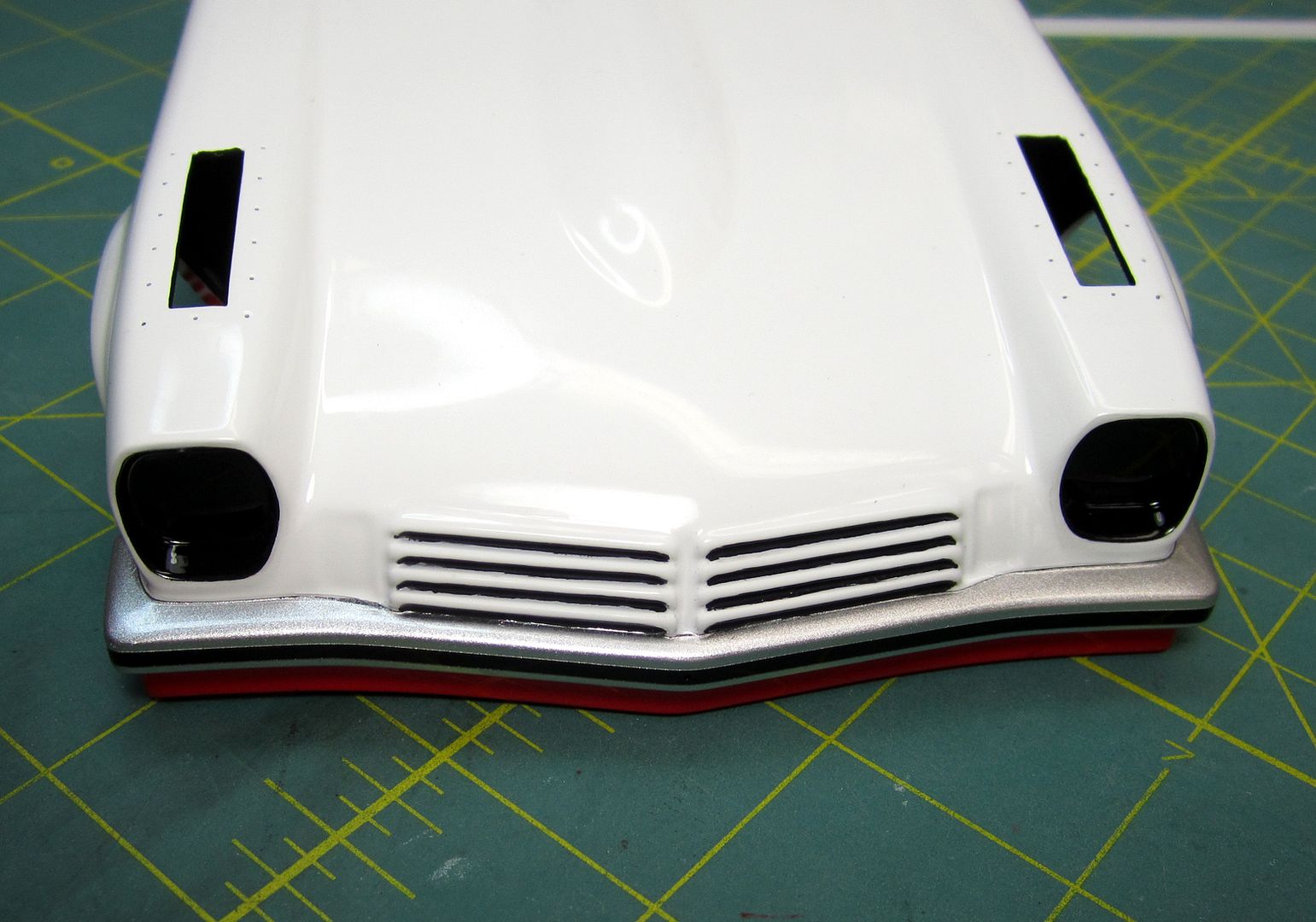

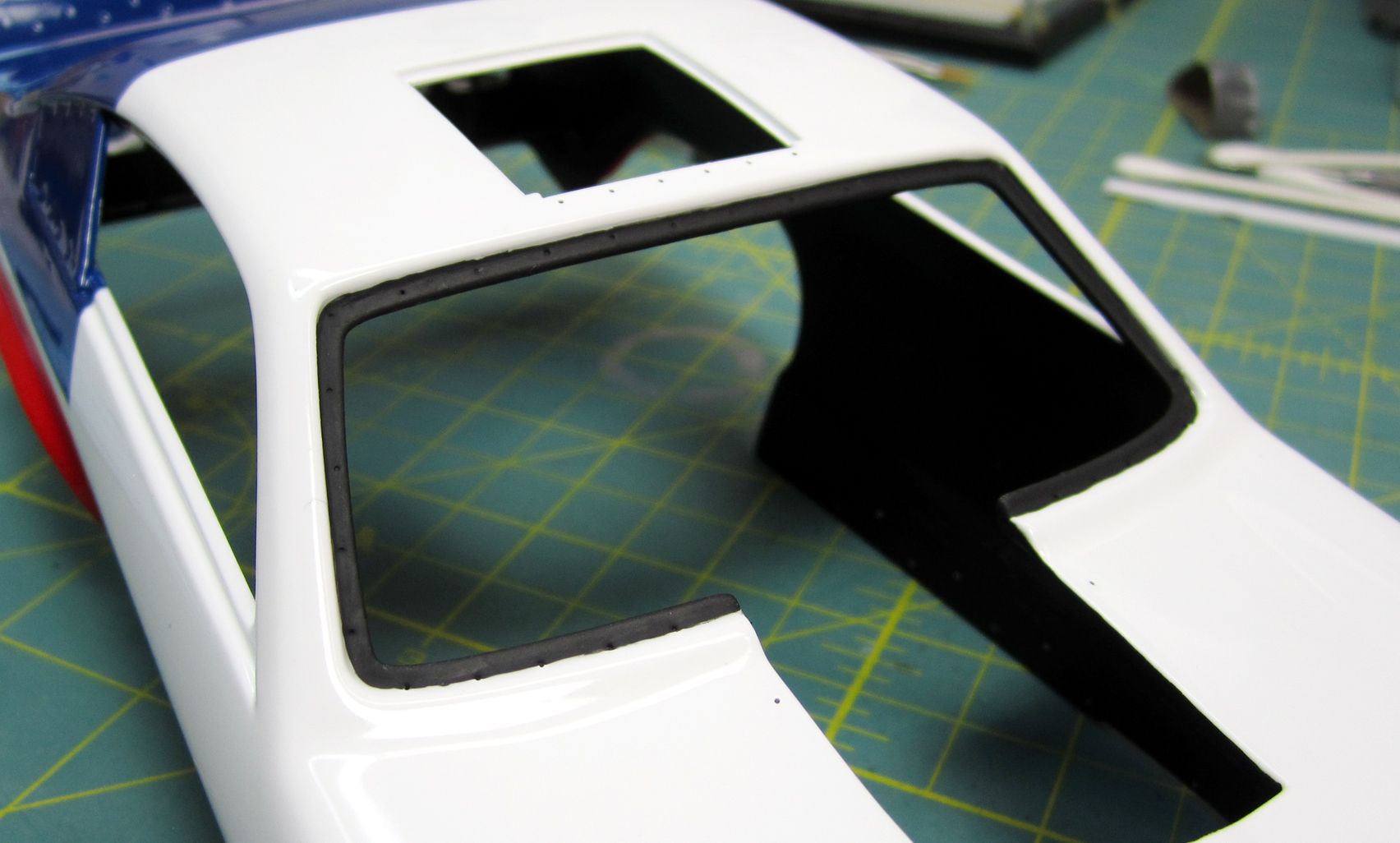

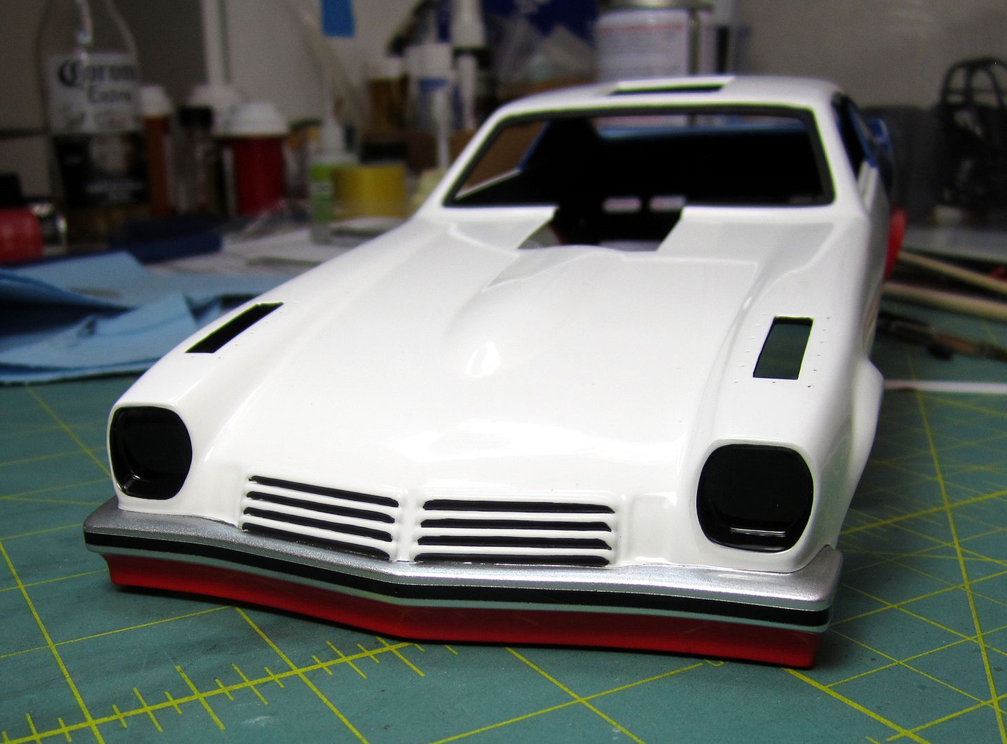

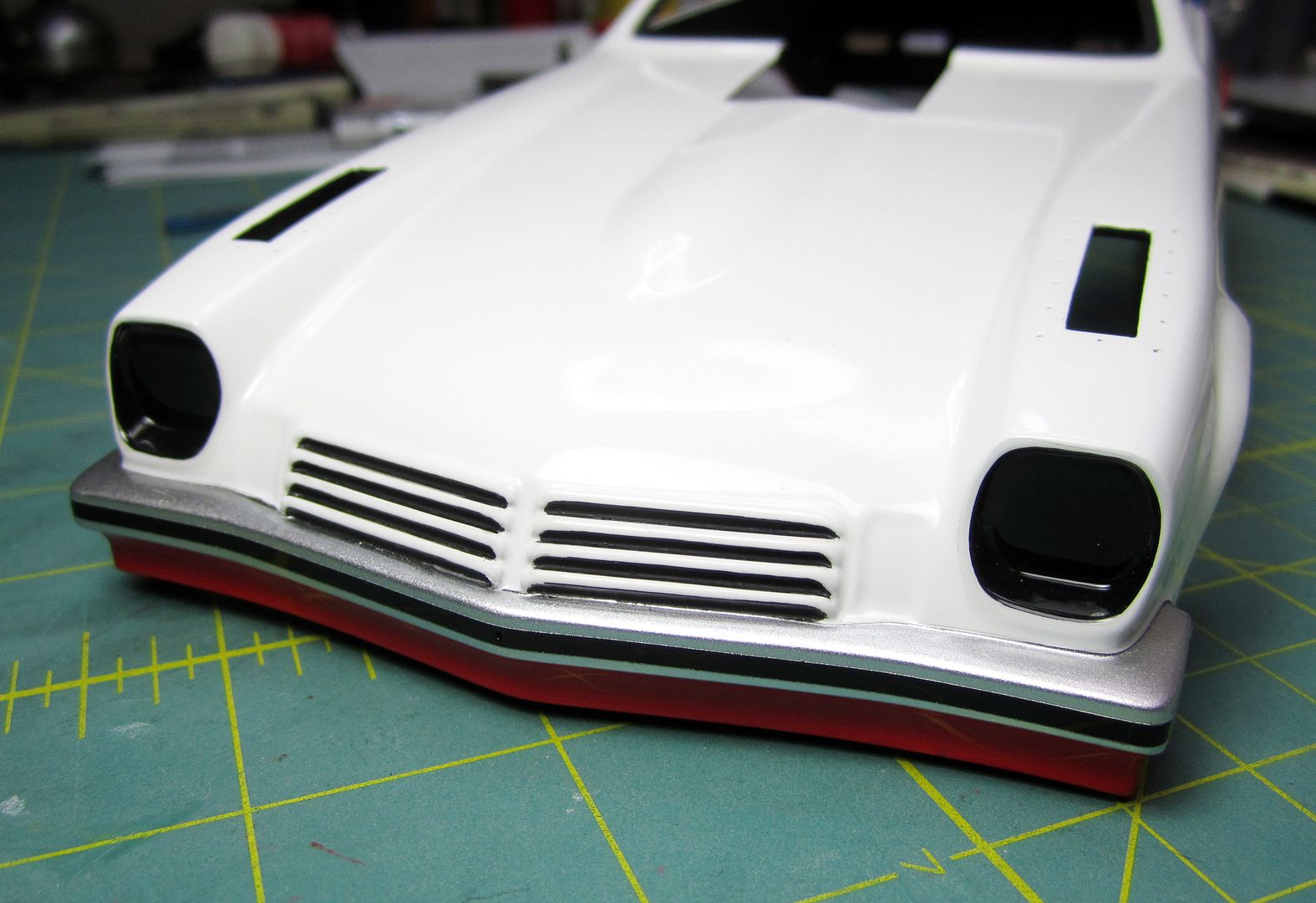

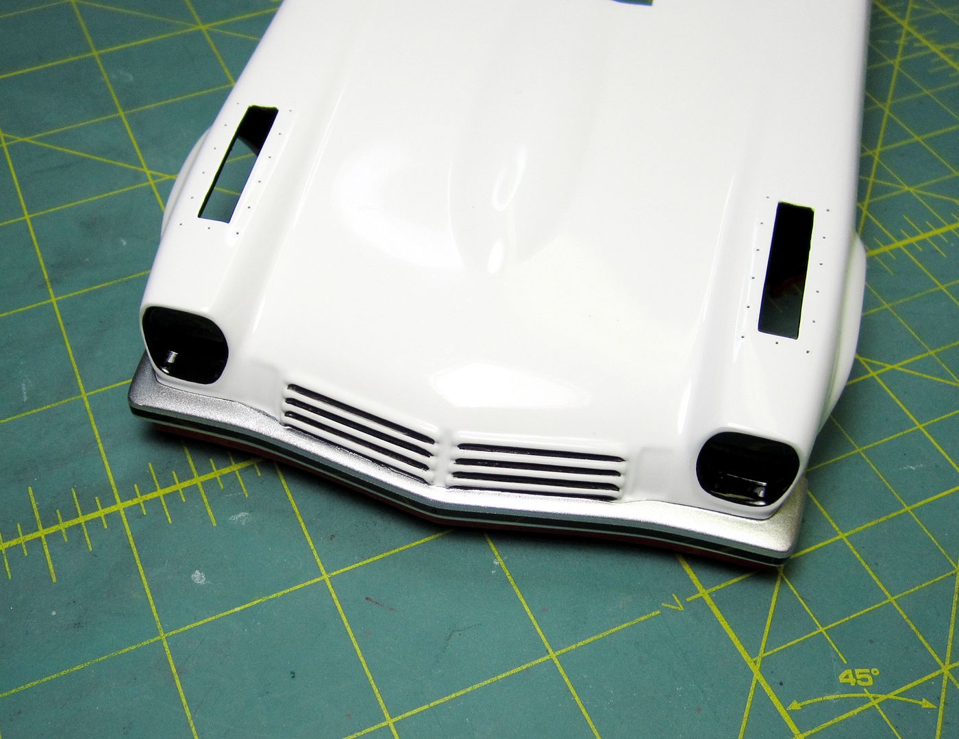

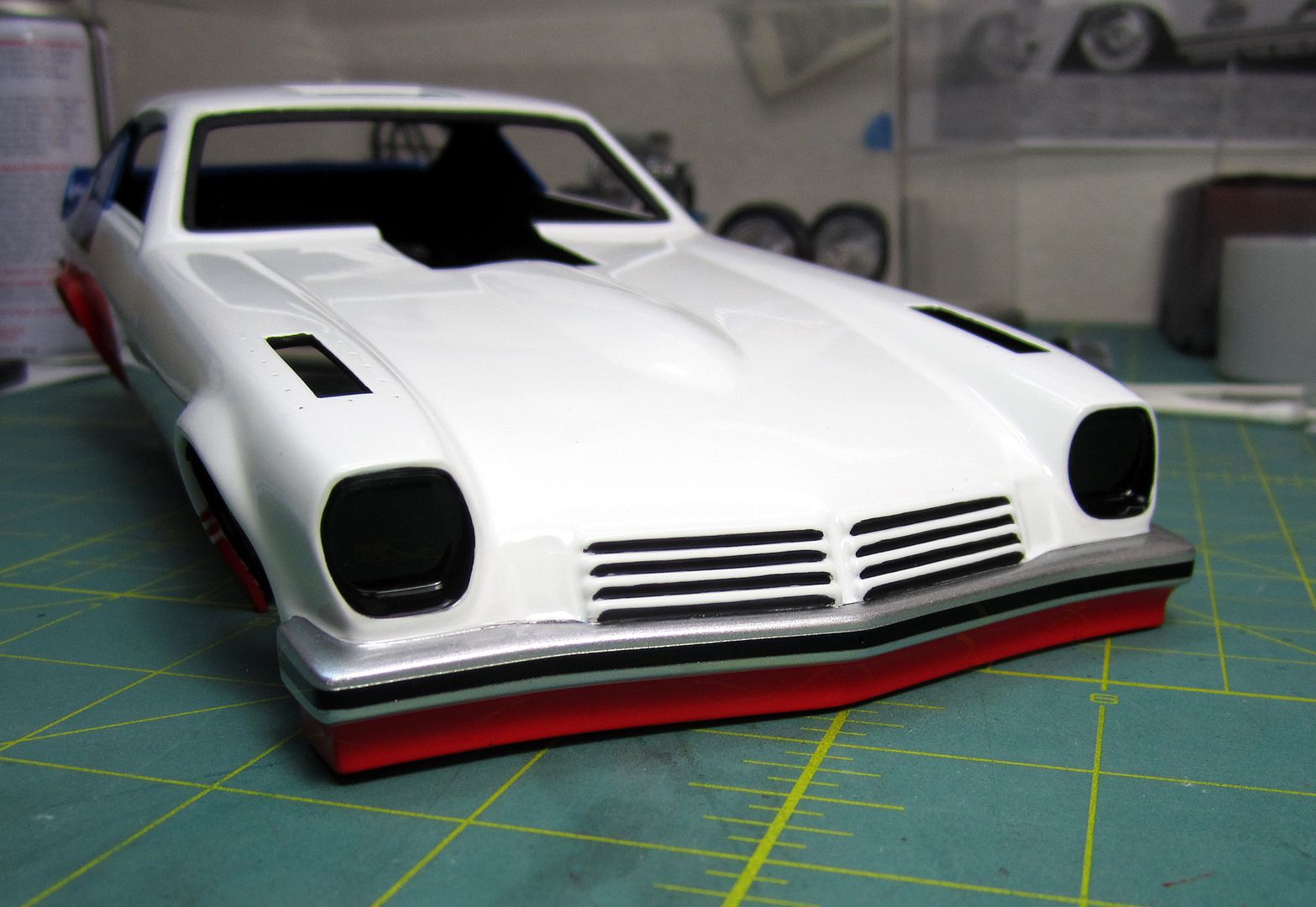

Mooneyzs Posted May 28, 2016 Author Posted May 28, 2016 Good Morning Guys.... It's time for an early morning teaser on what I worked on for what felt like hours last night because I was trying to get it right. But I was able to get a little work done to the body. I had gone thru and drilled all of the holes out due to the paint build up in them. Then I decided to get the black painted in on the grille and front window ledge. Which means that I am a step closer to being able to get the decals on. It's a really good feeling to know that I am so close to getting the decals on because I am Anxious to see what the body will look like with them on. I started out by painting the front window tray: Then it was time work on the front grille. I think it turned out ok. Honestly it could be better but it was a pain in the Butt, still thinking about touching a few spots up but don't want to mess anything up...lol: Here is the spot that I am not 100% happy with things. I am thinking if I could lay some tape down across the grille to get that straight line I am looking for: Here are a couple of angled shots of the front end:
Dragline Posted May 28, 2016 Posted May 28, 2016 Chris, what I would do for a truly sharp line that is also easy is this. Overfill the grill with Acrylic paint and then wipe away with a tightly balled rag with a 50/50 solution of water/ammonia. It'll be straight and perfect.
gasser59 Posted May 28, 2016 Posted May 28, 2016 Another solution would be use a Micron fine point black marker using the edge f the above louver for the marker to rest against as you make your line.
Mooneyzs Posted May 28, 2016 Author Posted May 28, 2016 Bob... Thank you. I never thought about a 50/50 mix of water and ammonia. I did do the tight wrapped towel with water but the problem I had was the since the grille vents are stepped that I didn't get as good of a result as I wanted maybe with this mix of water and ammonia I would get better results. I wil have the try it on one to see how it goes.Brad.... Thanks brother. I had never thought of that Idea. I just may need to try this. My one thought was to take some fine line tape and paint and use it as a border. But the micron fine point black marker may work better since I am afraid of having paint bleed thru the tape.you know I will show you guys the results when I am done with it.

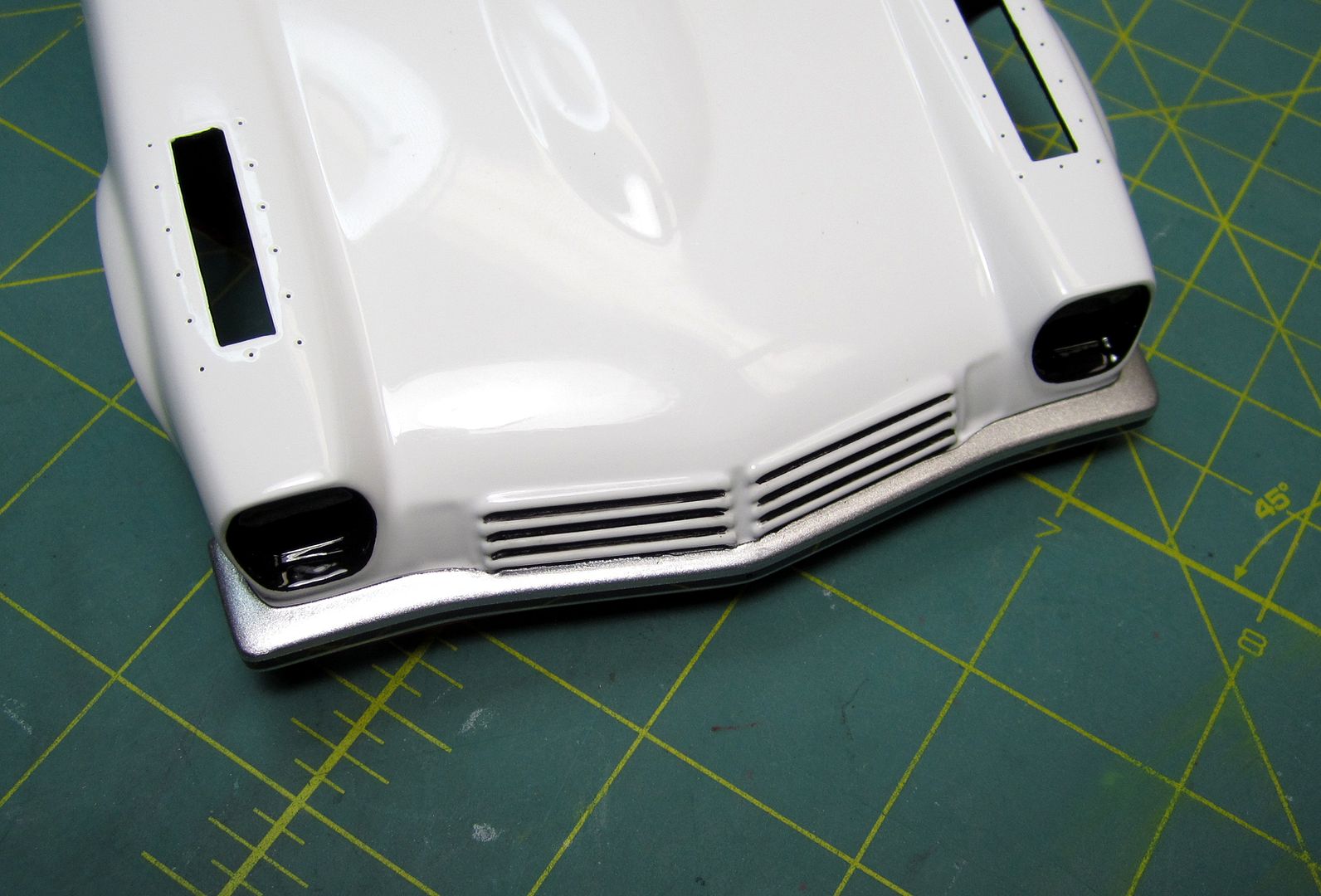

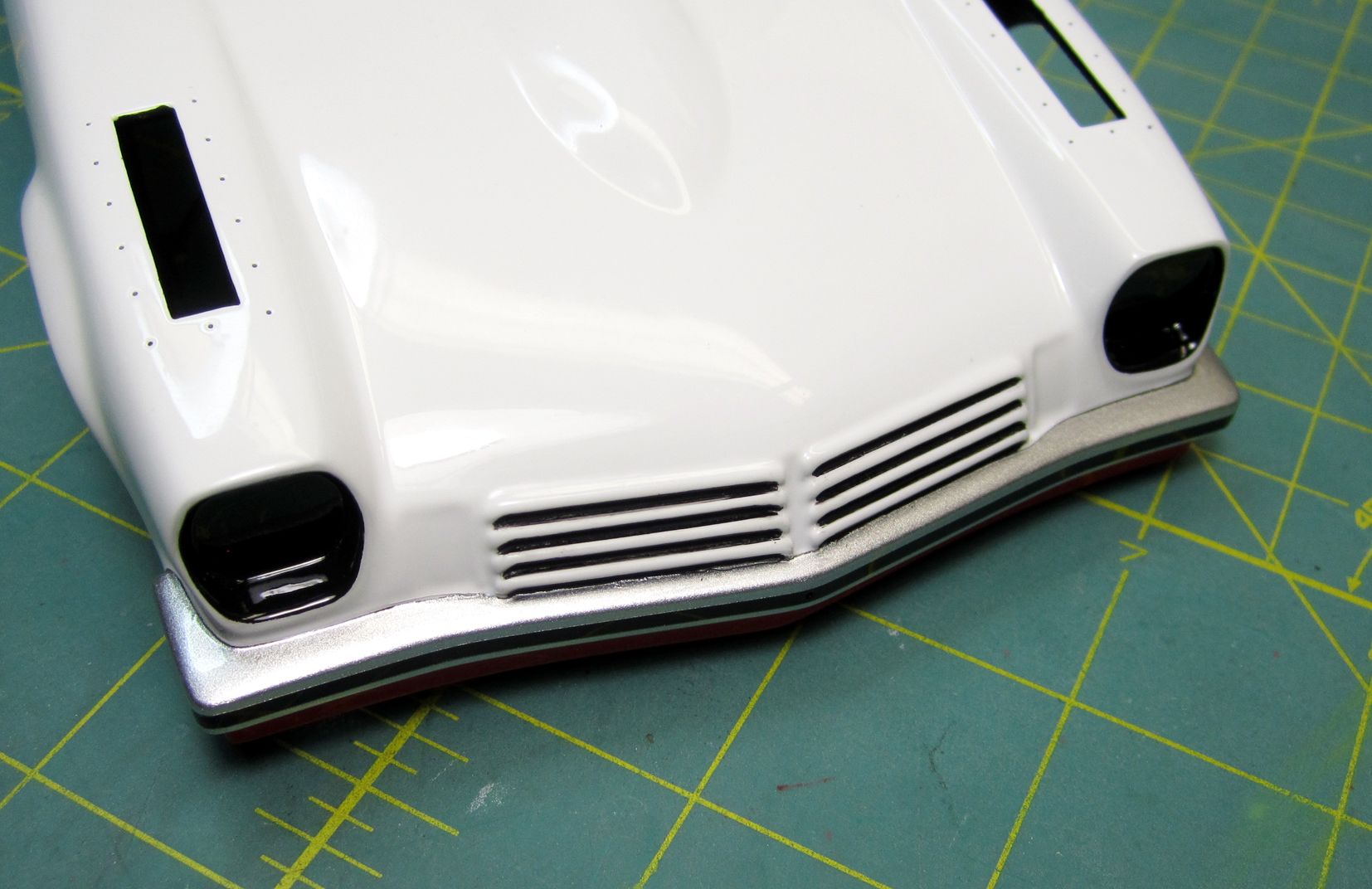

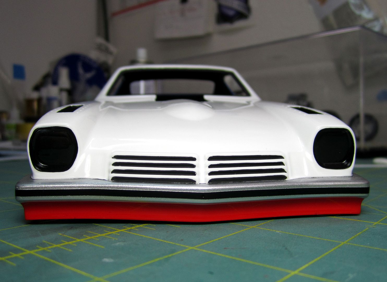

Mooneyzs Posted May 29, 2016 Author Posted May 29, 2016 Alright Fellas... I messed with the grill some more and I am thinking about calling this good. but I still see room for improvement in my own eyes. Anyway here is what the grill looks like now.
Mooneyzs Posted May 29, 2016 Author Posted May 29, 2016 Bob... Thanks. I used both both your's and Brads ideas combined. Mixing the water and ammonia together worked pretty good. Thank you for the suggestion. Never thought about doing that before.

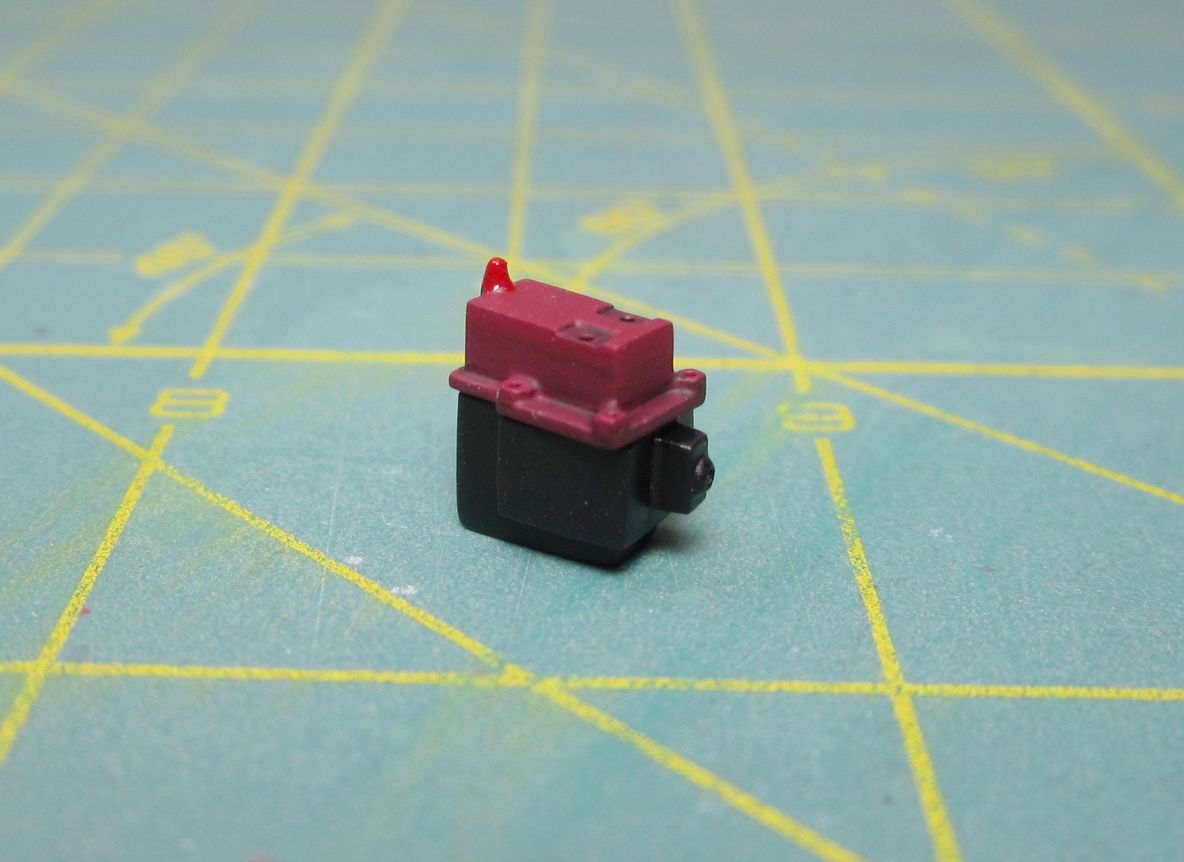

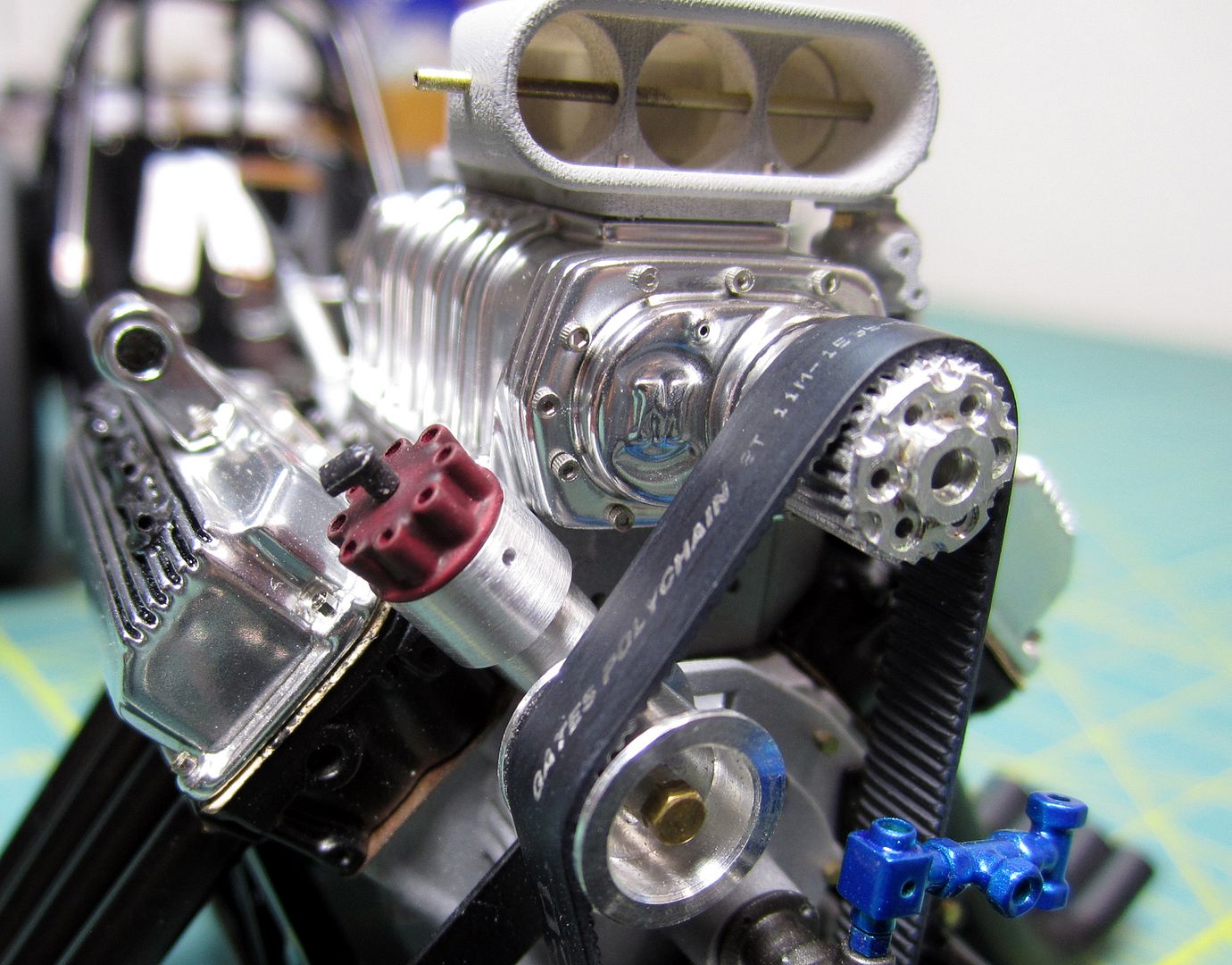

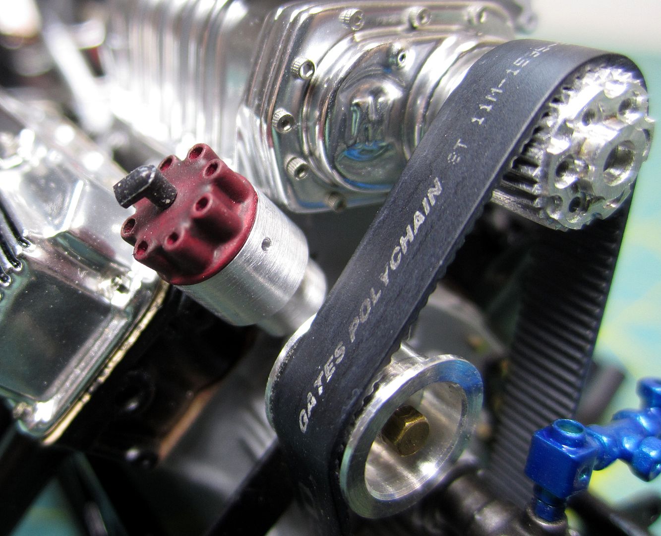

Mooneyzs Posted May 29, 2016 Author Posted May 29, 2016 It's time for another quick short teaser on a few items that I got painted up last night and just done doing a little weathering to them. Slowly but surely I am getting there. Now I can't wait to get these items detailed out. Here are the Distributor cap and the Mallory Ignition box..... Here is the Mallory Ignition box. I would like to make a gasket that goes in between the body and the top cover, then I will add the 4 screws to the top. I also need to add the studs for the positive and negative terminals on the top cover. As well as the ignition wire and I can't forget the Mallory logo: And here is the Mallory Super Mag II Distributor cap painted and weathers just ever so slighting to add some character to it: Upclose shot of the cap:

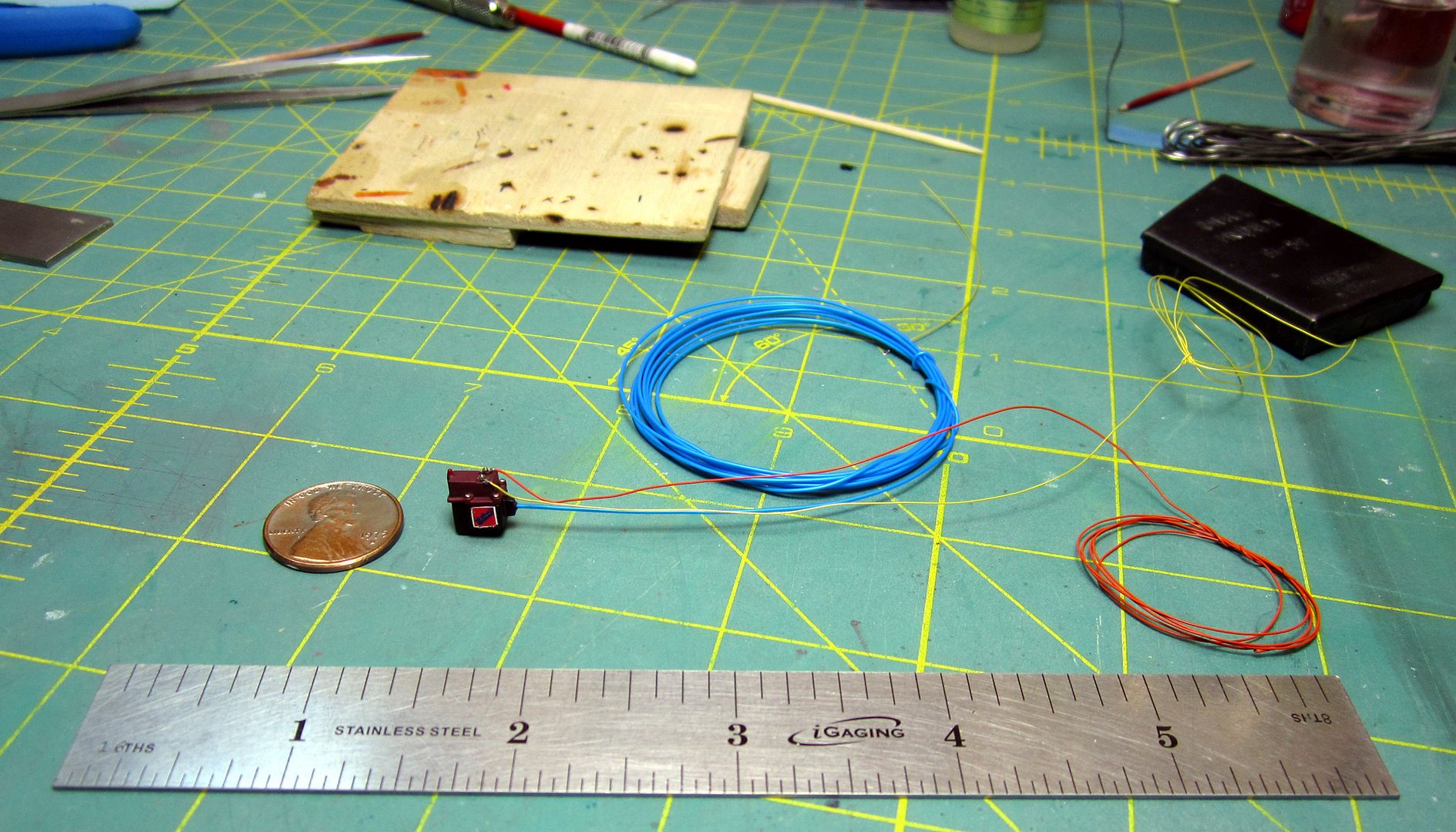

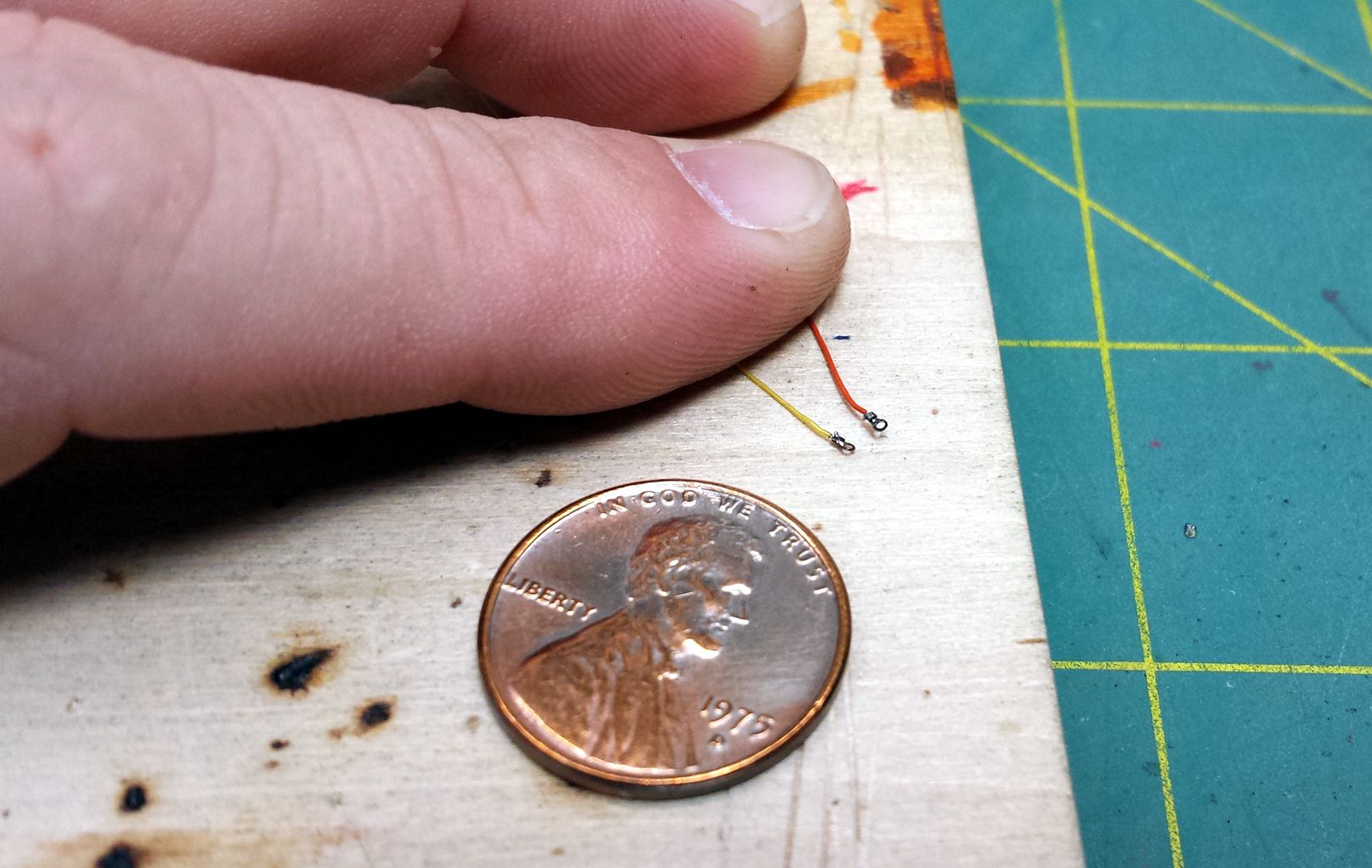

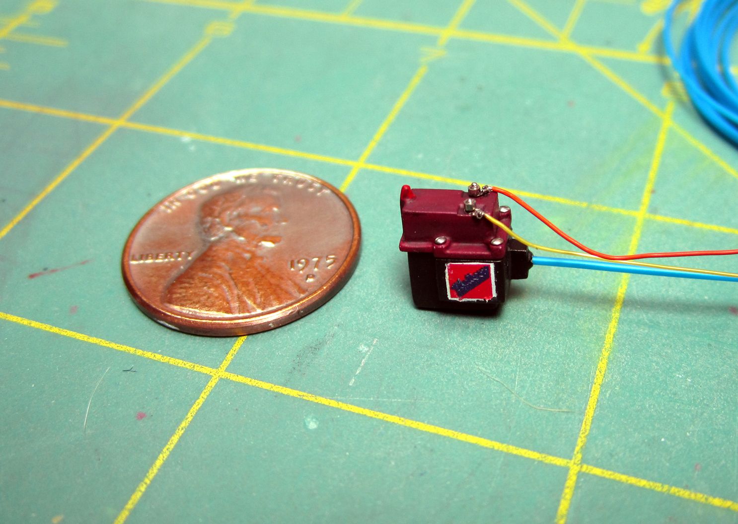

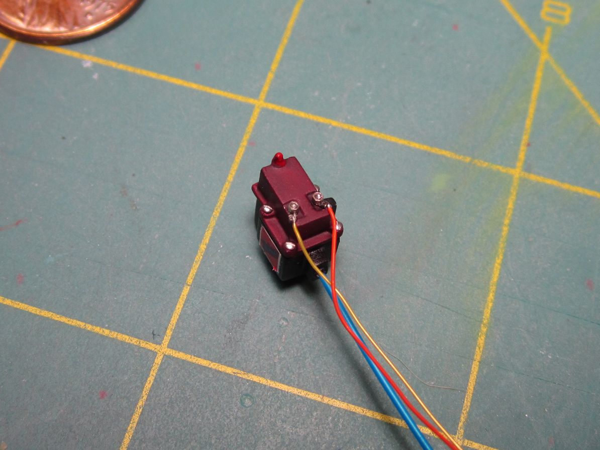

Mooneyzs Posted May 31, 2016 Author Posted May 31, 2016 Well guys I got some more work done today. I worked more on the Mallory Ignition box and started to make the details for it. I pushed my soldering techniques to see if I could try something new. Anyway here are a few shots of what I have gotten done so far today.... Here I have taken some Detail master .0125" dia wire including the sleeve and I had used some Detail Master 1/25 scale battery terminals that I used as ring terminals. I decided to try and see if I could solder the two together. My first test subject was pretty tough to do. it was hard to get the little tabs bent over the wire to solder. So I decided to Anneal the Photo etch while it was on the tree by heating it up over a lighter and letting it turn bright red and allowed to cool to room temperature that way It would make the photo-etch easy to bend. I broke out my trusty Weller Soldering Iron and got the pieces soldered: I then hooked the wired up to the studs on the Ignition box cap as well as I got my Mallory decal put on the base and threaded the nuts on to hold the wire in place.. I was thinking about redoing the decal since some of it chipped away from handling it after putting it on but I remembered some of my reference pics that the decals were a little beat up in them any way so I though maybe it would give it a little more character. I am also thinking about putting a little dirty wash over the decal to make it not look so new: Here is a Top View of the Ignition box: Then I did this one for fun to get a feel of the overall size of everything:
