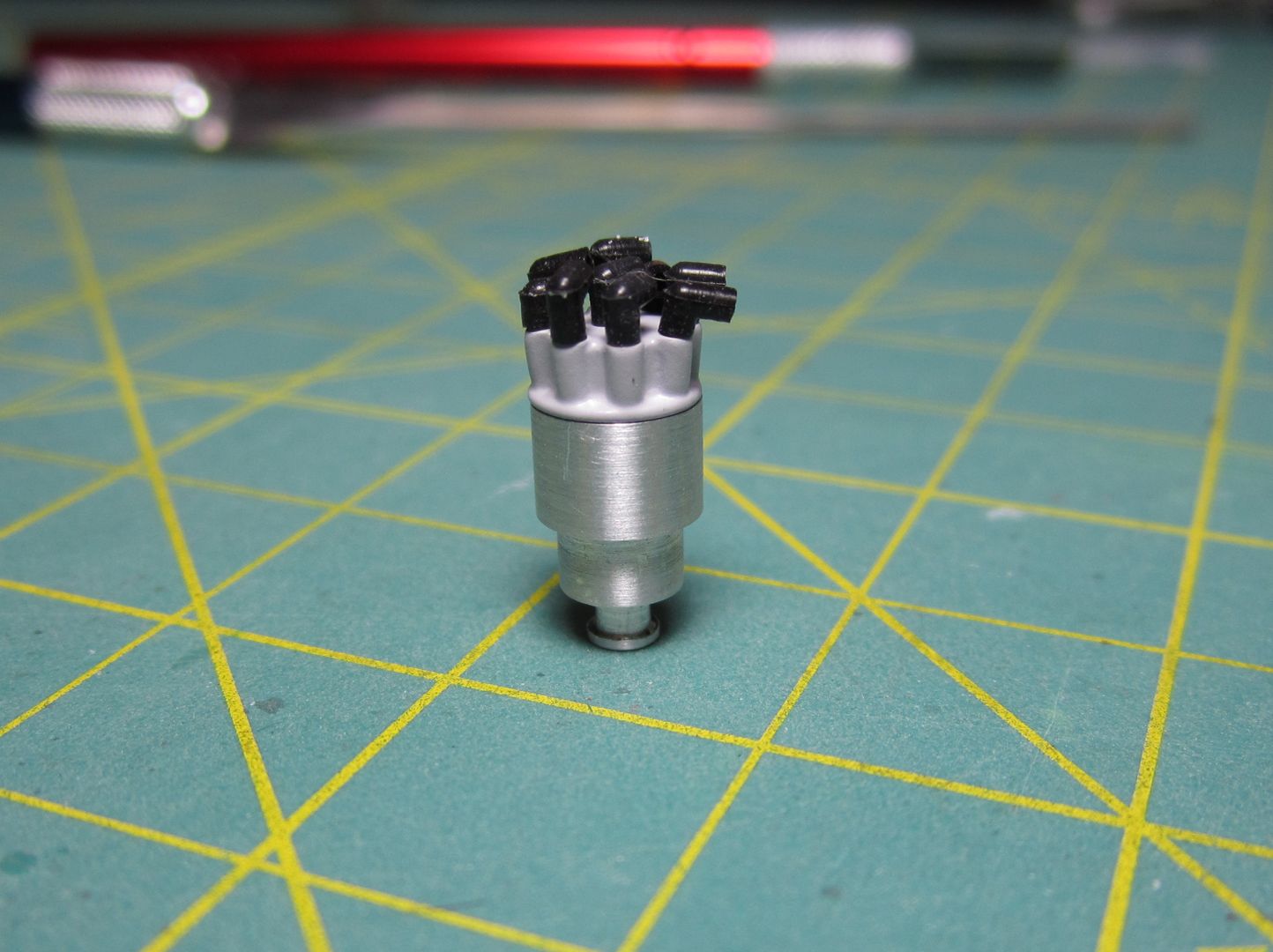

iBorg Posted May 1, 2016 Share Posted May 1, 2016 I keep on reading this post and keep on being amazed. As I've said before, this is a textbook. Not a W.I.P. Looking at the distributor I just couldn't understand what you were doing with it......mercy it looks good finished. How were you able to cut all the brass to the same length? Also, were the boots 3-d printed? Quote Link to comment Share on other sites More sharing options...

Mooneyzs Posted May 2, 2016 Author Share Posted May 2, 2016 Mike... Thank you very much. I have enjoyed sharing this build the way I have been by showing every step of it. Yeah on the distributor I had this idea in my head which probably didn't make sense at first when you saw what I was doing but with this next update I think it will help even more. As far as cutting the brass I took my calipers and set it at .100", I took my brass tube marked it with a Sharpie, then I take the capers and basically scribe a line into the sharpie ink. Then from there I take my exacto knife and line it up on my scribe line and roll the brass tube back and forth to cut the brass. The boots on the distributor are actually RB Motion 1/16th Spark Plug boots. It has crossed my mind to draw up some spark plug boots just to see how they would print. Tim... Thank you very much. The more ticks I can punch off on this to do list the sooner I can get it done... . I have to say that I am super excited and hopefully will be able to sand the steering wheel tomorrow so that it will be ready for some black paint because I can't wait to see how the contrast of the wood grips and the black look. Cheers! Scott... Thank you. That was the first time I had though to use my pin vise as a holding device while soldering a part. It seemed to work pretty good for what I was doing. Oh that's not good about the torch flame. Good thing I was using a soldering iron. I am sure we all have done silly mistakes. I know I have that's for sure Quote Link to comment Share on other sites More sharing options...

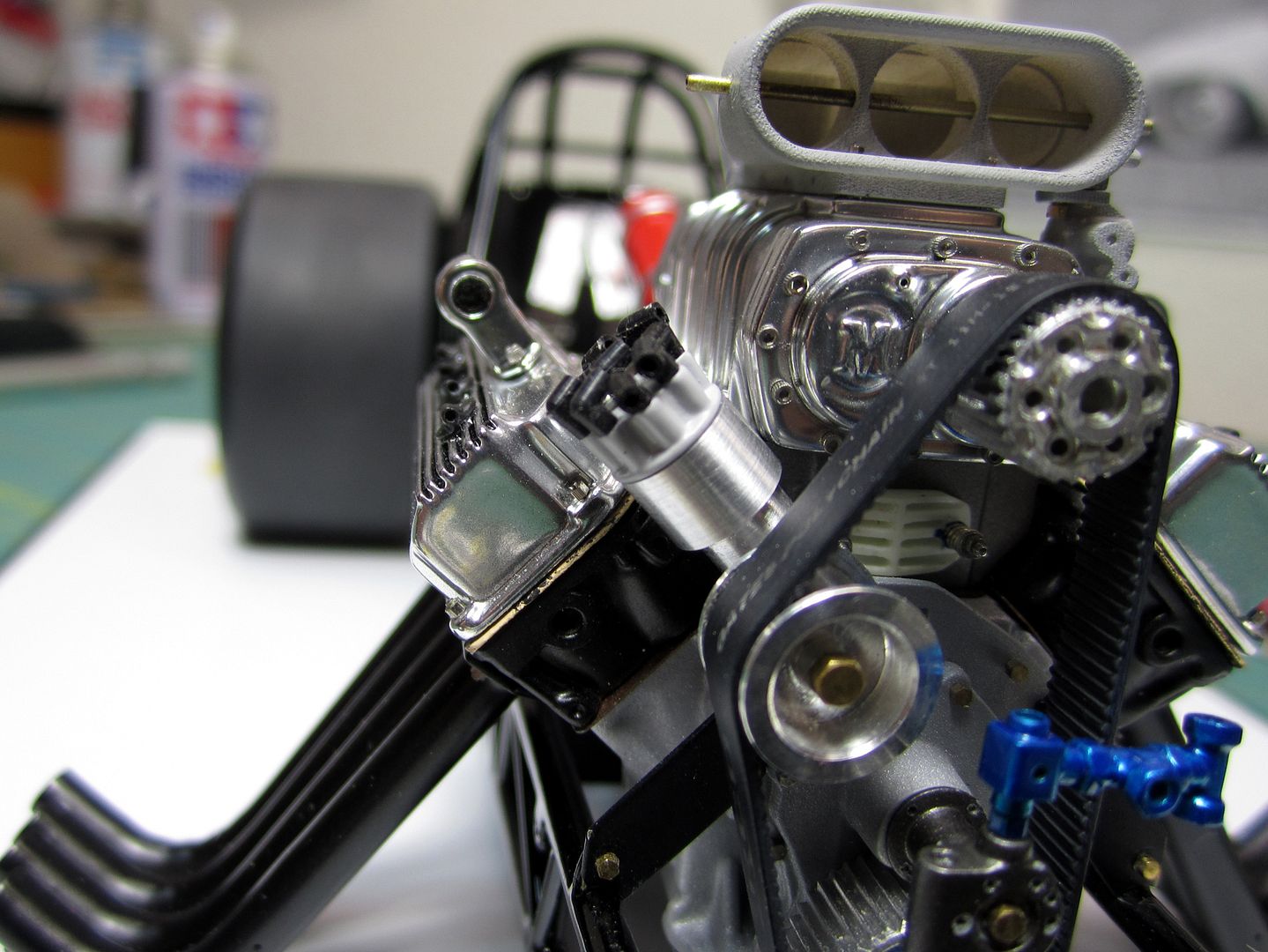

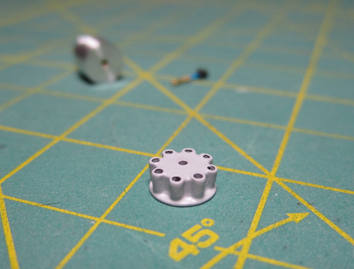

Mooneyzs Posted May 2, 2016 Author Share Posted May 2, 2016 Good Morning Fellas.... well I tried to post this last night but was having issues being able to get onto model cars last night. it seemed that the site was down for some reason so I gave up trying to post last night. But I got a little more done last night. I decided get some more work done on the distributor cap. Did some sanding some priming.... little more sanding and then got it primed again and I think I am not happy with it and it is ready for some color. Here are a few pics of it.... Here is the Distributor cap after a few coats of primer: Here is the distributor mocked up with the cap and boots put into place: And here are two shot of the distributor on the engine: Quote Link to comment Share on other sites More sharing options...
