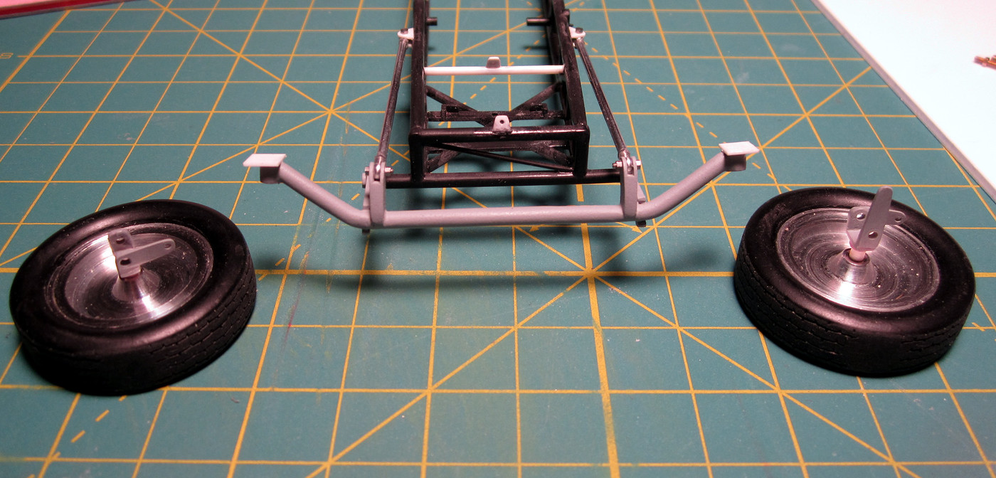

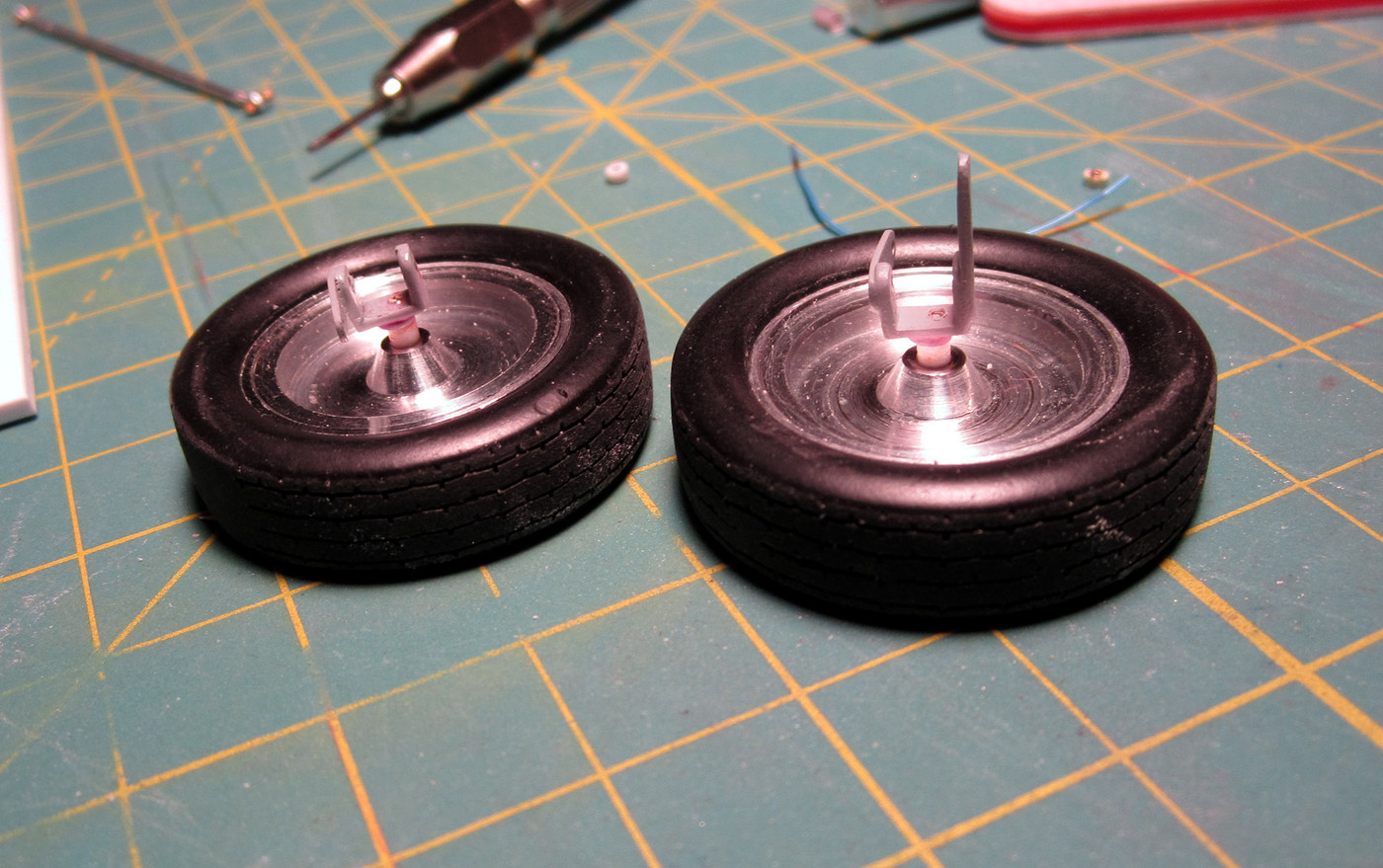

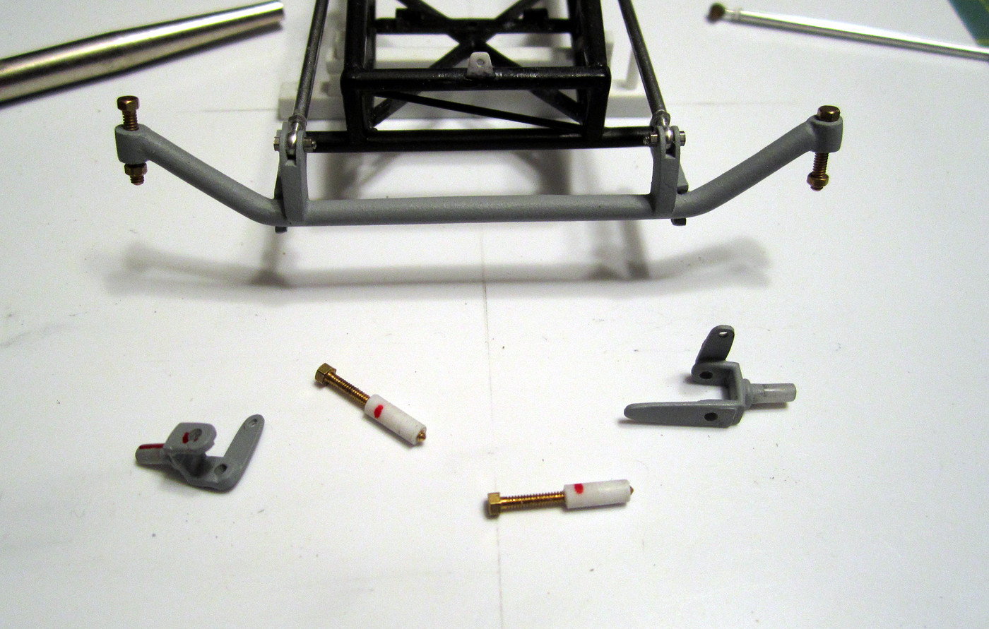

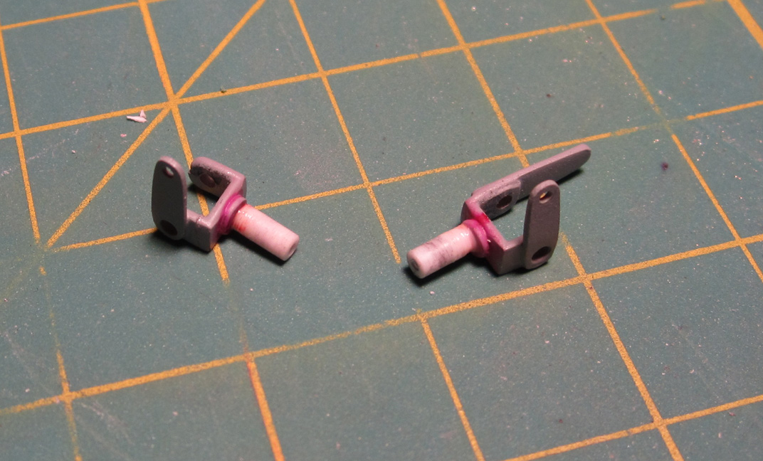

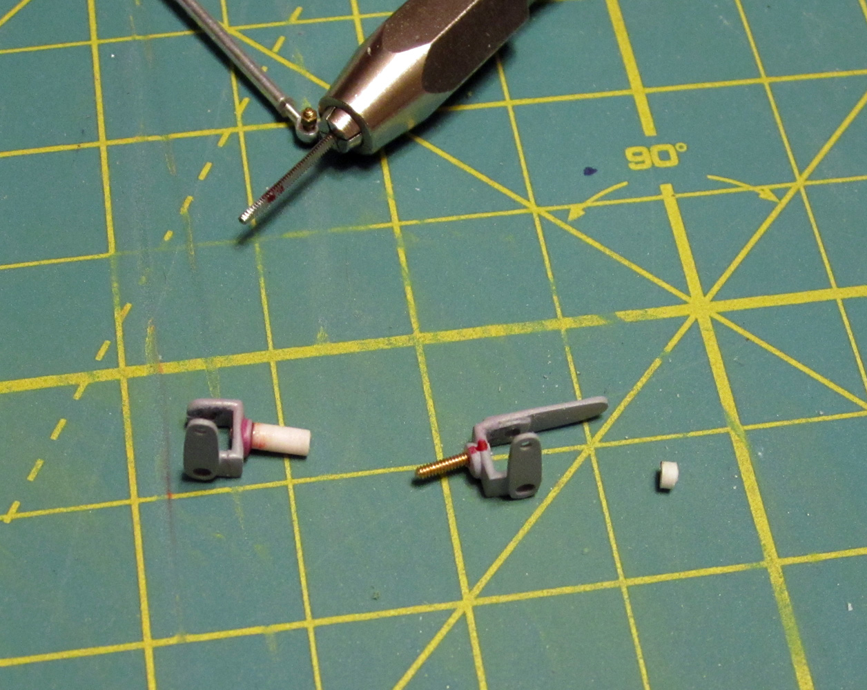

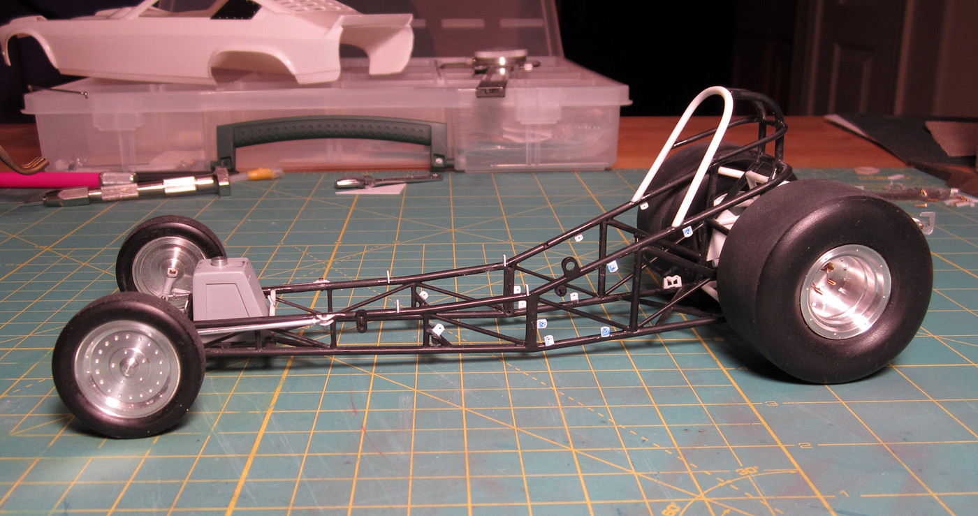

Mooneyzs Posted December 2, 2011 Author Posted December 2, 2011 (edited) Gabriel, Thank you. Well I was able to sit down at the bench tonight an put a little more time into this build. Tonight my plan was to get a little work done that I needed to to the front end. I have been meaning to redo my front spindles somewhat so that the new rims Jim turned would slide onto the axle. So with what I was able to accomplish tonight, it looks like I am at the point where I am ready to start the rework of the chassis tomorrow night and get the engine moved forward as well as moving the mounts for the raidus rods. With that said, here are the pics from tonights progress.... I started out tonight by taking my spindles off and getting they new axles ready: So what I did was I took some tube and had to sand the diameter down just a smidge to get to fit into the mounting hole of the rim. My plan was to use an 00-90 bolt inside of the axle to mount it to the spindle. So I cut off the stock spindle axle, drilled a hole and then tapped the hole. I cut down a 00-90 bolt to make a stud out of it and threaded it into the spindle. Next I threaded the inside of the tube and proceeded to thread the tube on to the axle. when I had it almost all the way on the stud I took my Weld-On #3 glue and put it on the areas I wanted to glue and finished threading the tubing as far as I could go bonding the tube to the spindle. I wanted the axle to be strong so I thought this would be the best way to accomplish that: Here is the finished spindles with the new axles installed: Test fitted into the rims: Edited July 25, 2017 by Mooneyzs

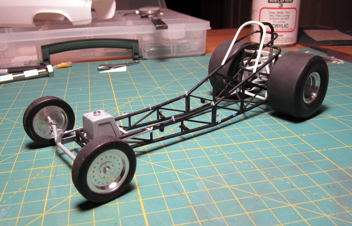

Mooneyzs Posted December 2, 2011 Author Posted December 2, 2011 (edited) Here is a Shot of the rolling Chassis after I had cut down the rear axle a little bit to get the rear tires tucked up against the chassis: Side View: I then decided I wanted to add a little spacer to the front axles as I found that I had some play/slop between the front axle and spindle. So I took Shims and glued the pieces to the axle in which I will go back and trim it down by cutting and sanding to shape. I will be letting this dry for the night and picking it back up tomorrow drilling the hole for the bolt to go thru. Then I can start with the chassis re-fab: Thanks for following along and stay tuned for more progress over the weekend. Edited July 25, 2017 by Mooneyzs
gasser59 Posted December 2, 2011 Posted December 2, 2011 This is looking great Chris. So nice to see a rolling chassis even if its going to be reworked some. Those rear meats are massive. Can't wait to see your weekend progress.
Mooneyzs Posted December 2, 2011 Author Posted December 2, 2011 Brad.... I will have to take a shot of it from behind so you can get the true effect of the Tires Jim... Thank you and thanks for all of your work you have done for me so far. I am hoping to maybe sit down and draw up a few more parts that I have been thinking about. Thanks Virgil! Mike... Thank you and for all of your help so far. Its much appreciated. I think I sould be picking up some purple pond tonight or tomorrow and will post some picks of that when I get to it. But though I might as well get to soaking while doing the chassis fab work.
W-409 Posted December 2, 2011 Posted December 2, 2011 This sure looks good! This needs to be the best Army Vega, I've seen. It looks as realistic as the 1:1 version, I think. Great job with it, those front spindles just look right. Really great job, I really enjoy about following this build.
