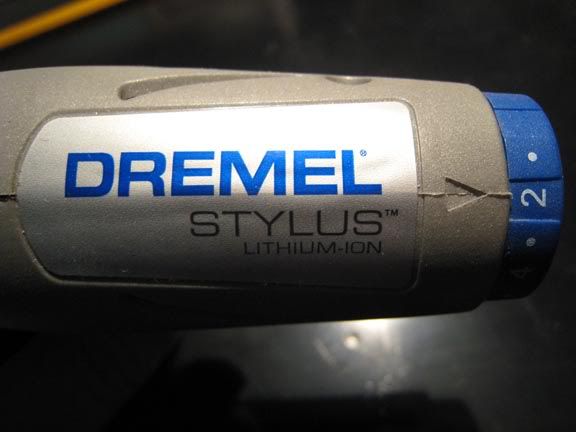

I would add the indespensible Dremel Stylus tool. It holds a charge forever and fits the hand much better than a regular Dremel tool. A must have in my book.
I think you can get the copper Dri-wick at Radio Shark or from any electronics supply company- search solder removal. You want the thinner guage stuff that is actual copper not the steel colored stuff but it would work it's just larger guage stuff. It is indeed really good for seat belts. It wicks up melted solder when removing solder with a solder iron. So it absorbes paint . It needs to be primmed first before painting. When painted it looks like weaved material. It's best on 1/24-- 1/25 -- 1/16.
Also I saw the dremmel tool with the batt. It looks pretty usefull.
Here's a couple of pix of the Dremel Stylus. It is a variable speed moto-tool that fits nicely in your hand and uses the same collets and bits as your regular Dremel. I got this a couple of years ago as a Christmas present coupled with the Dremel Driver which I use almost everyday around the house. Both of these are small, compact and holds a charge forever. Lots of torque for such a small tool. I have not seen this combo in any of the home centers lately but you can buy them individually. Highly recommend.

I'm going to try and post pics of the stuff I posted about. Hopefully before this weekend. It will just be thumbnails.. I've seen those dremmels at Lowes or Sears I think..
Yes, the Stylus is my choice for a dremel. Since I got mine a few years ago I haven't picked up the old one. And you're right I put it back on the charger base maybe once or at the most twice a year.
