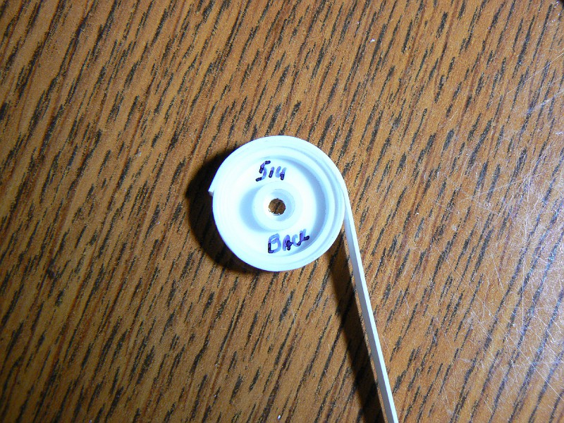

OK, I got my wheel backs set up for the Pegasus rims, seems like I do this a different way every build. This time I added a strip of styrene around the outer edge of the wheel back so it fits snugly into the Pegasus rims. I also had to grind the mounting post on each rim down, but I'm used to doing that by now. I slapped some primer on 'em, then laid down some Dupli-Color Ultra Silver as the base. The part of the wheel back visible through the rim will be painted body color, which should look cool!

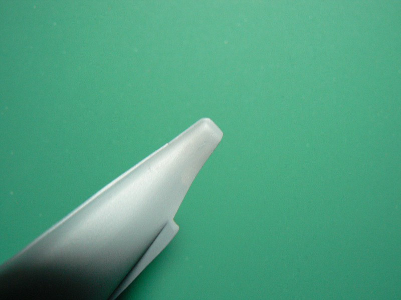

I got a lot done on this day, let's start with the fenders. I cleaned up the bottom edges of the fronts, then added a bit to the rear so it snugs up to the frame at the front edge. I still have some clean-up on all of them, but we're getting there...
And a little work on the remaining stock fender, it's been pie-cut, filled, and the new lip has been started. Then I went to work on the chassis, I didn't like the "neutral" rake the kit had out of the box, so I went for an easy fix. I cut the number tabs off of a parts tree, made them into shapes I could work with, glued them over the attachment points for the rear axle and shocks, then drilled out the holes so I could attach the parts when the time comes. It gives me a slight "nose-down" rake with minimum work, another easy fix for my arsenal!

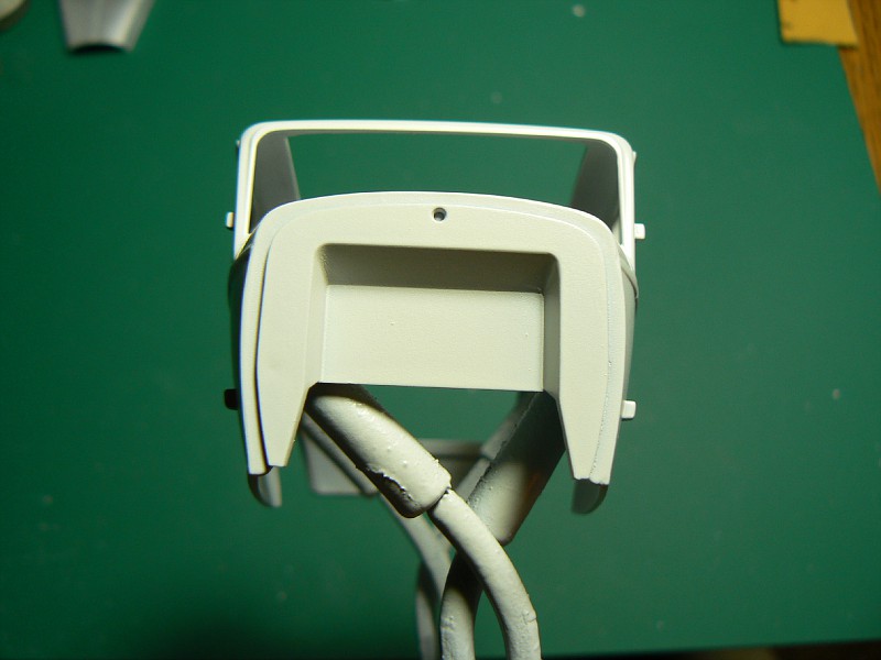

The body has been recovered with Primer/Sealer, the trunk lid is stripping due to some bubbling, along with the grille shell, but not all went badly today. I got all four fenders tightened up, with a tiny bit more work before I pronounce them done. They're currently in the Dehydrator letting the final coats of Filler Primer cure so I can see if they're finally perfect. Here's some shots prior to the Filler Primer, we're looking pretty good, but I want perfection!

I painted my freeze plugs up nice and pretty, got my hood all finalized with it's Ultra Silver base, detail-painted the rear end (Air bags and bolt heads), got my differential cover set up in it's Ultra Silver base, and the frame crossmember is cleared and bolt-heads for the tranny mount picked out. My fenders, well, I screwed up there. I made the mistake of putting them in the Dehydrator, a big no-no when you use Acrylic Filler. The good news is, it only ghosted in a few spots on each fender, right now my Driver's side front is perfect, but the other three will need a little more sanding tomorrow, but it's nothing earth shattering at least. Now, on with some new pics!
And now onto my freshly reprimed body. It's wearing a fine White primer from Dupli-Color. Lesson learned, White primer by ANY manufacturer does not like coming off, period. It took me until an hour ago to get this back in shape for primer, what a P.I.T.A. that was. I've got some debris in the door panels, but that will be easily taken care of. Next, we lay down some Ultra Silver for the base coat, then I'll get my hood sides, grille shell, fenders and trunk in Ultra Silver too, clearing the way (Hopefully) for some pretty colored top coats for everything!

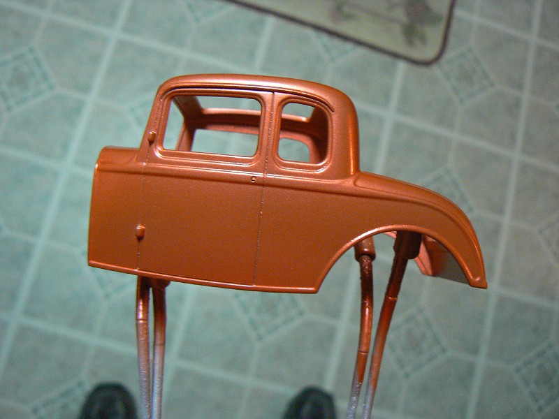

WE HAVE COLOR!!!!! I found it's going to take 9 color coats to get the shade I want, but they're thin, so it's all good! I've got enough Nail Polish to do it with ease, and so far, I'm looking good, 1 bottle down and 3 left unmixed. I can't wait to get some clear on this stuff and polish it up, it should pop like mad in the sun! I've got a bit of debris in the door panels I forgot to clean out, and a tiny speck on the front corner of the fender, but I should have no problem clearing those two little issues up!
