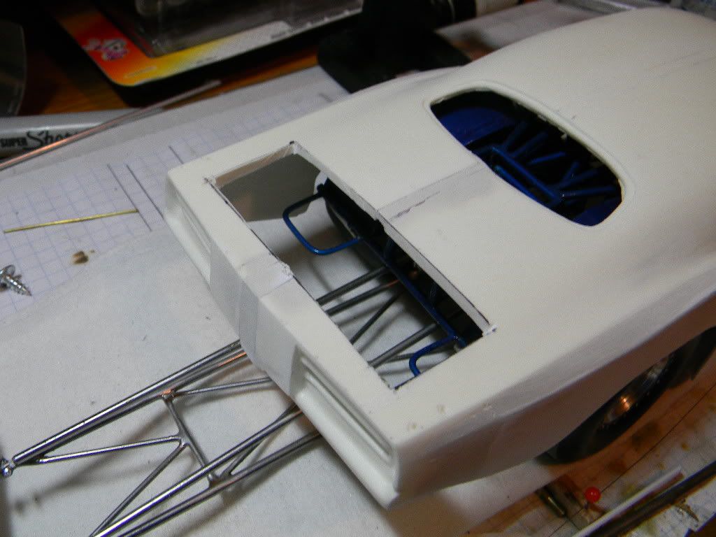

Hey thx Joe , I have a question for you guys.... Does the rear trunk hatch fasten down with zeus fastners (dont know if I spelled that right :blink: ) or is it usually hinged ? any photos you may want to provide will be more than welcomed. :)
Photo curtisy of old aftashox archives

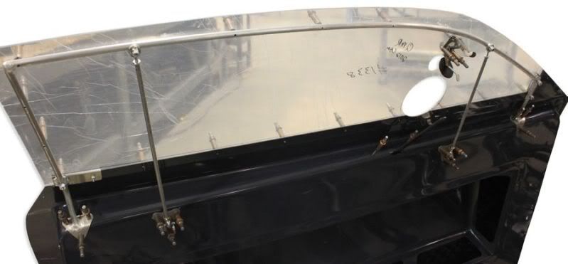

With fastners, it is easier and faster to get off and out of the way. You will just need to thin the deck lid and the area around your hole to add the material to hold it into place to look like the fiberglass body.
Hey thanks for the info Bart , the body has already been thinned down I just used an old picture to show where I was talking about. ;)

Rom... Looking good buddy. You will want to go with the Dzus fasteners on the deck lid. I would also want to recommend putting some on your front clip as well. If you take a look at pro mods and pro stock cars you will see they all are using them. Can't wait to see more of this Bad Boy... Keep up the killer work

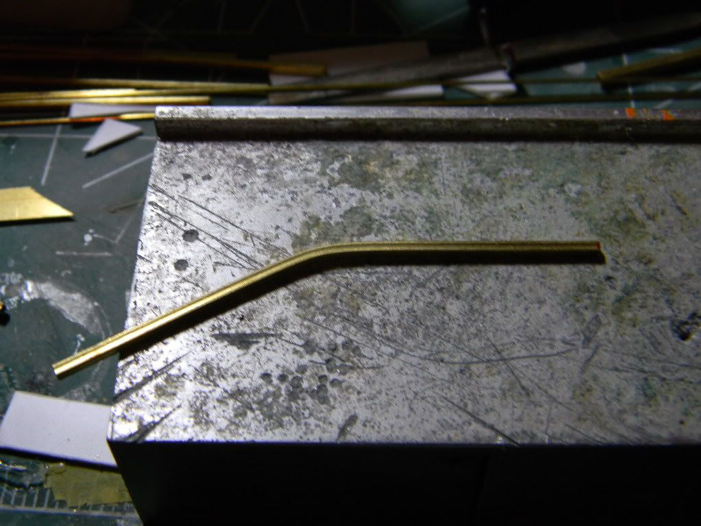

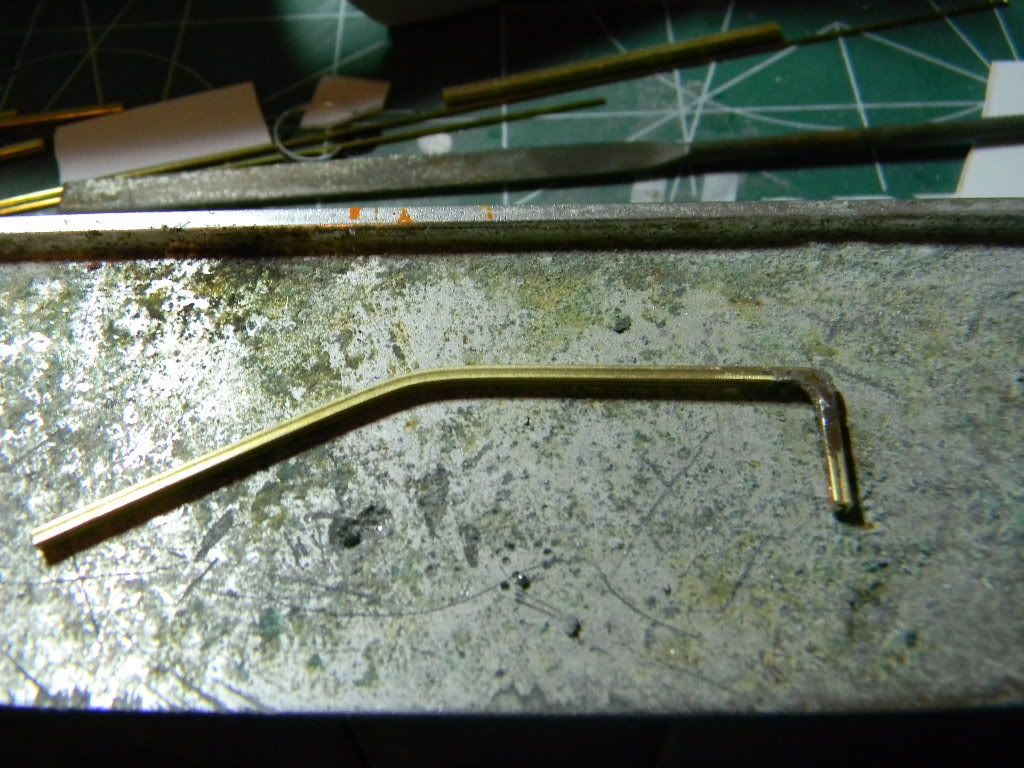

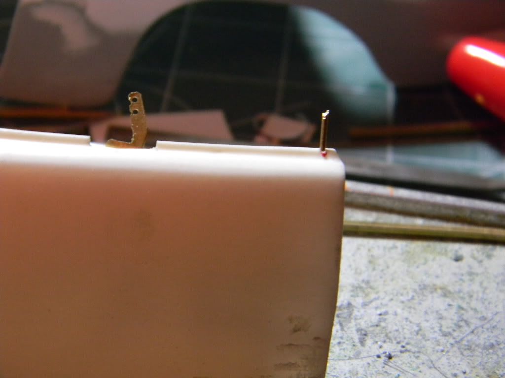

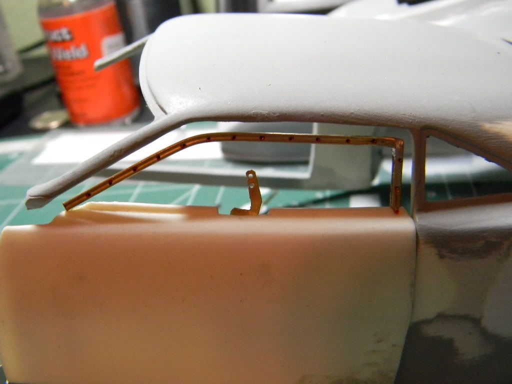

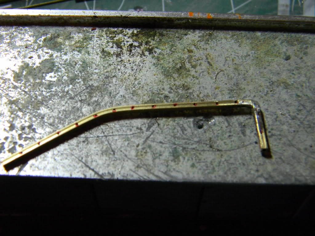

well fellas I got the window frames made and installed on the doors . The frames are made from brass (like most of the car) and they have been drilled to accept the riviets that will hold the windows on. Also I cut the door handles down to a more scale size. not much more to explaine so I hope you enjoy.
Thx fellas for the many compliments.
Started with a square piece of brass tube.
soldered to make this

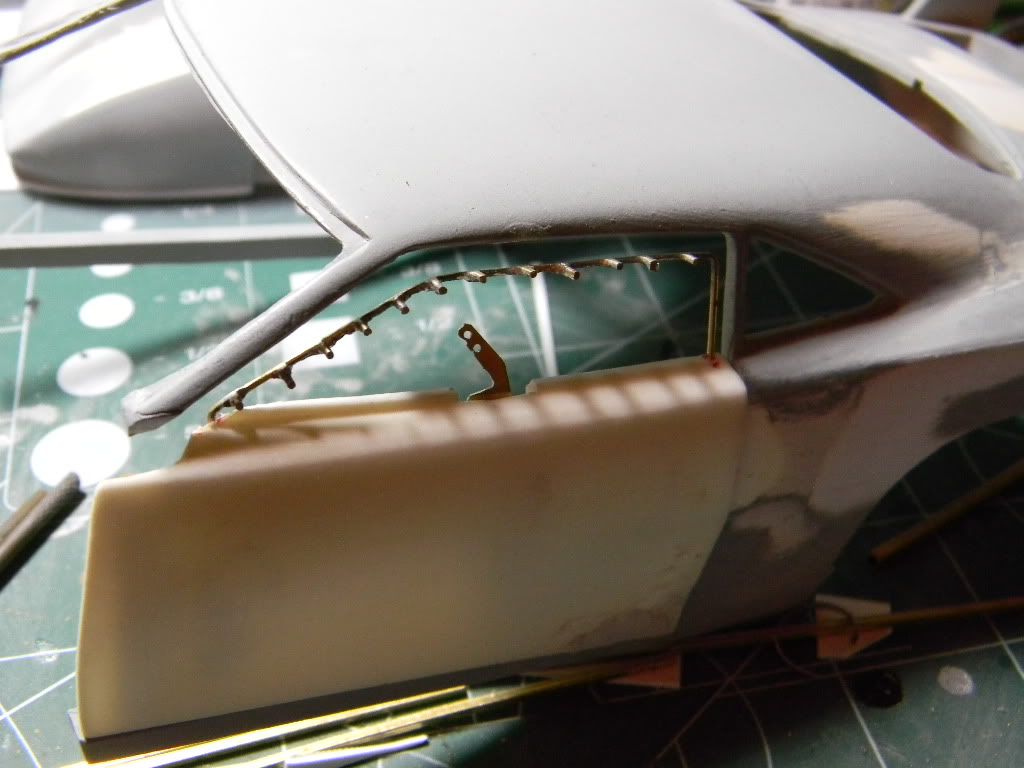

This small piece of wire supports the window frame and also makes it possible to adjust the angle of the frame as needed.
finished frame drilled for window rivets

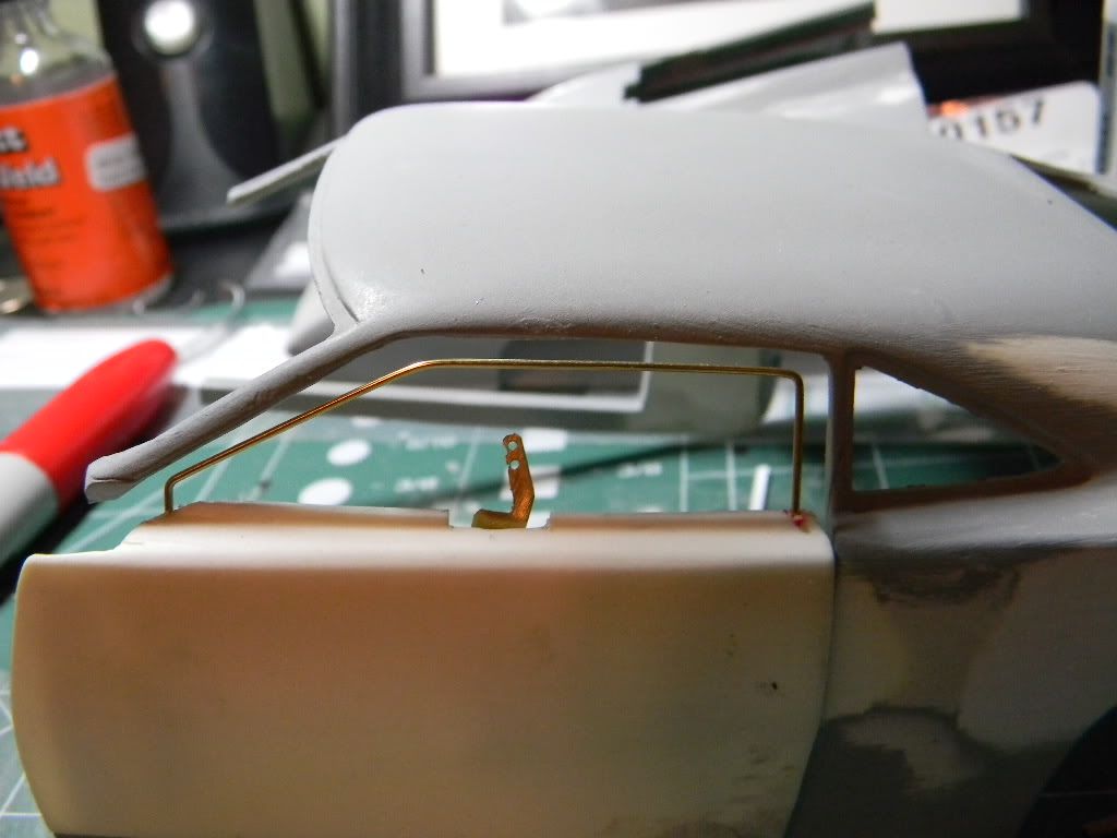

Heres the frame attached to the door , And no the frame isnt supposed to fit snuggly in the door, its just a support for the window.

I'll try to answer these questions to the best of my ability ., the rod is about 2mm square I got the rod from a bag of bits and pieces they sell at the local hobby store. I used a #61 drill bit to drill the holes , I got the rivets from Scale Hardware the part number is RIVT-07-S comes in a bag of 100 these are 0.7mm a scale 1 inch. As for a website I dont have any website you can visit but if you ask the right question here on the forums you will get an answer. There are lots of knowlagable builders here that would be more than happy to help you out. Thanks for you compliments Make and I hope I was able to help a lil. B)

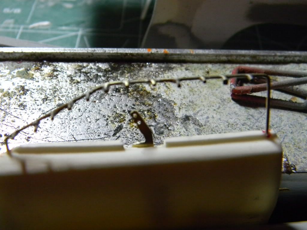

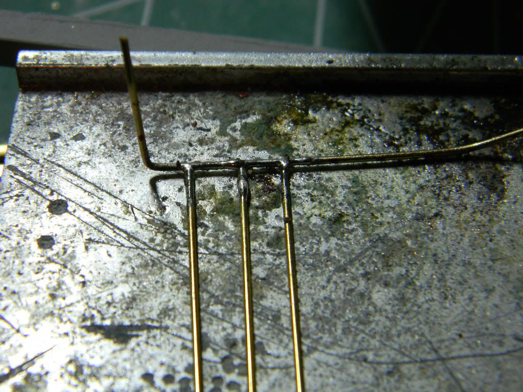

After reviewing the window frame and seeing that i had no excuse for not doing it correctly (other than being lazy and trying to rush) I decieded that Bart is correct if im gonna do it,... it should be done right. So I went back to the drawing board to design a more accurate window support. Heres what I came up with.
started witha piece of brass wire shaped to the window
next step was to soldermore wire onto the the frame (thx for the extra work Bart :angry: ) lol no really thank you

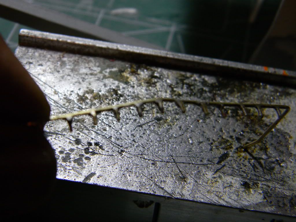

After cutting I have this still have some filing and clean up to do....
heres the partially done frame on the door .....
not done yet some of these will be removed for proper spacing. so stay tunned for more to come...I hope you enjoyed
typically the tubing around the window is 3/8" chromemoly. there are typically tabs welded to the tubing. the bolt size is typically a 10/32 button head or (if you are into a lot more work) a flathead. i say typically as there are as many variations as there are stars in the sky. these numbers will put you in the ball park.
Edited by comp1839
Okay I am confused What are the round pieces sticking out from the frame? Are you going for a not finished car and these are going to be the cleco fasteners? Sorry sometimes I can be a bet slow.
