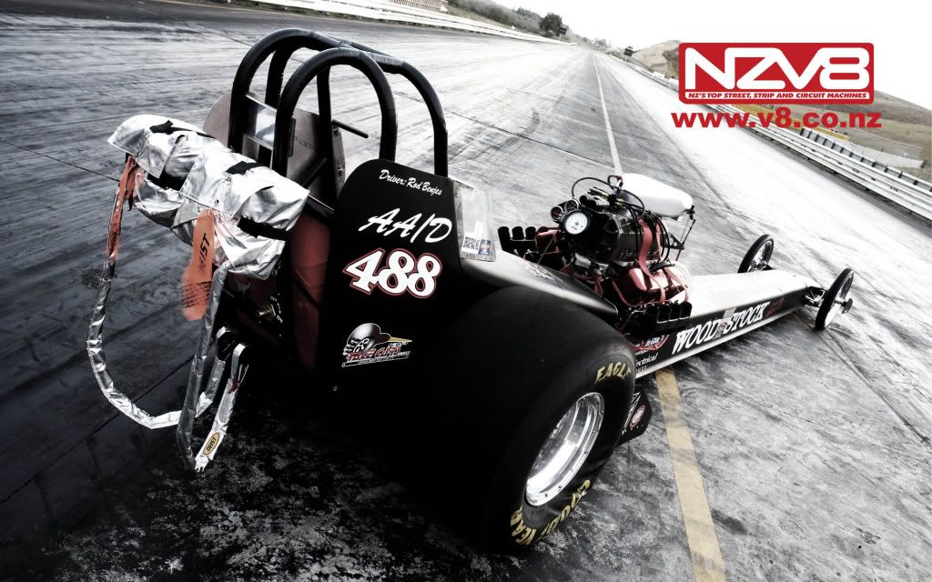

SuperStockAndy Posted June 7, 2011 Author Posted June 7, 2011 Thanks for the replies guys. I'm leaning towards building one that looks very similar to this: Oh, and how would one go about building a jig for that kind of chassis? Thanks, Andy
bobcrozier Posted June 7, 2011 Posted June 7, 2011 There's probably quite a few ways of doing this, but I made myself a magnetic jig consisting of a 10" x 8" magnetic sheet (sort of a vinyl-like) glued down to a similar sized piece of 5/8" plyboard plus several small blocks of metal which were offcuts from a 1" x 1" bar of mild steel.I think Micromark make a similar unit (or used to!) Then I draw the chassis out on graph paper full size,and tape it down on to the board. Then taking plastic rod cut it to length on the plan and hold it in place on the drawing with pins (the vinyl sheet was rubbery enough to take a pin) and or adhesive tape. Then every so often tack the rods together with liquid poly like mekpak or similar. Don't forget to "fishmouth" the rods together for a good fit. Make two sides this way. Then a liile superglue applied to each joint with a wooden toothpick re-inforces each joint and provides a realistic "welded" look. at this point manufacture those little gussets, brackets and engine mounts etc. When both sides were complete I attached using double-sided tape each frame to the side of a 3/4" square short length of wood batten so they can be stood up. Then I drew two lines representing the converging frame rails and positioned the two side frames in position relative to each other. Then cut the cross-wide rods to join the two sides together. Glue and reinforce as before. The trickiest part is joining up the rear of the frames. Gentle heat and a gentle touch and bend your rod to represent the curved rails and hoops at the rear. Draw it all out as much as you can to avoid surprises and get a feel for it. Good luck Bob
