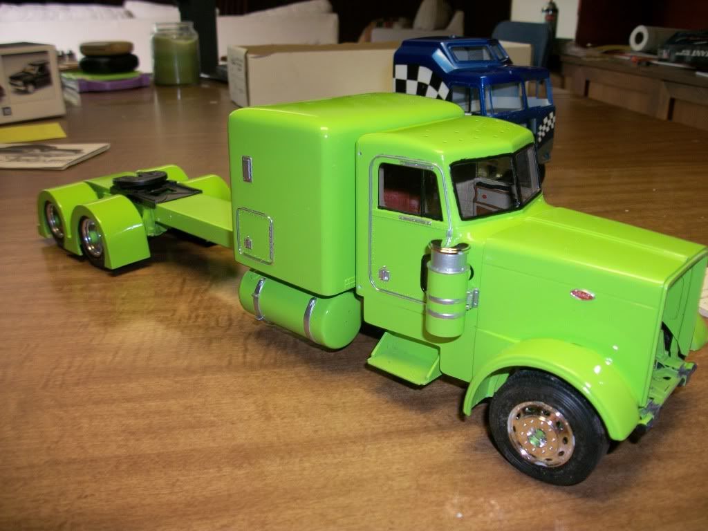

yur doing great on yur largecar but need nother carrier barring .longest yu can go on drive shaft is 6ft.with out one that is max.too much realy but thats specs.
post-7088-0-50528800-1308076786_thumb.jp
Dispite the fact that I personaly don't like the painted fuel tanks and breathers, your Peterbilt is coming ery nice!!!
The color is amazing and the frame is as long as it should be for a nice custom large car.
Keep the good work coming!! I am watching this build.

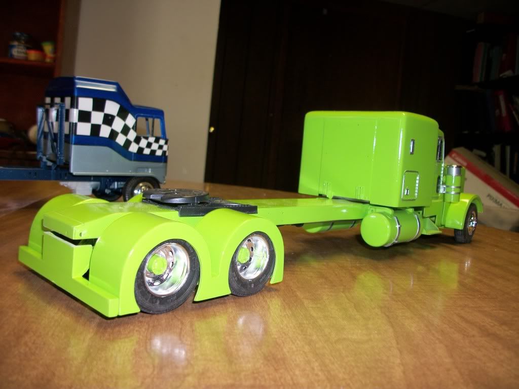

Okay I've been away from this build for a couple of weeks tring to get stuff done around the house but now its model time :) . Eric sent me some really cool fenders and now I'm needing to mount them. I got the FR2 fenders( they look like camel humps)like the ones I've been seeing alot lately on custom trucks around here. I'm looking for creative ways to mount them on my truck; does anyone have any cool ideas they'd like to share? I want them as smooth as possible but solid because I have a little girl who likes to look with her fingers B) Any ideas would be awesome!
Okay I've been away from this build for a couple of weeks tring to get stuff done around the house but now its model time :D . Eric sent me some really cool fenders and now I'm needing to mount them. I got the FR2 fenders( they look like camel humps)like the ones I've been seeing alot lately on custom trucks around here. I'm looking for creative ways to mount them on my truck; does anyone have any cool ideas they'd like to share? I want them as smooth as possible but solid because I have a little girl who likes to look with her fingers ;) Any ideas would be awesome!
Josh, I don't know if this will be any help or not, but here is how I'm mounting my RF1 fenders from Eric to my Ford LTL9000 project.
I took a small piece of aluminum tubing and drilled a hole into the frame rail, then super glued the tubing into the hole. Then I took a little larger diameter piece of tubing, just large enough for the tubing glued to the frame to slide into. The next step is going to be to super glue the larger tube to the inside of the fender, and that will not only mount the fender, but allow for removal of them as well. I would also suggest since you are using the RF2 double humps, make sure you mock everything up before you mount them to see where your mounts will be on the frame. Here's how this idea turned out for mine.
One other suggestion, and something I haven't done yet on mine, you may want to grind a small channel just deep enough for the outer tubing to sit in on the inside of the fender, but not deep enough to go through the fender. That will lower the fender to the wheels if they are sitting a little high like mine are. ;)

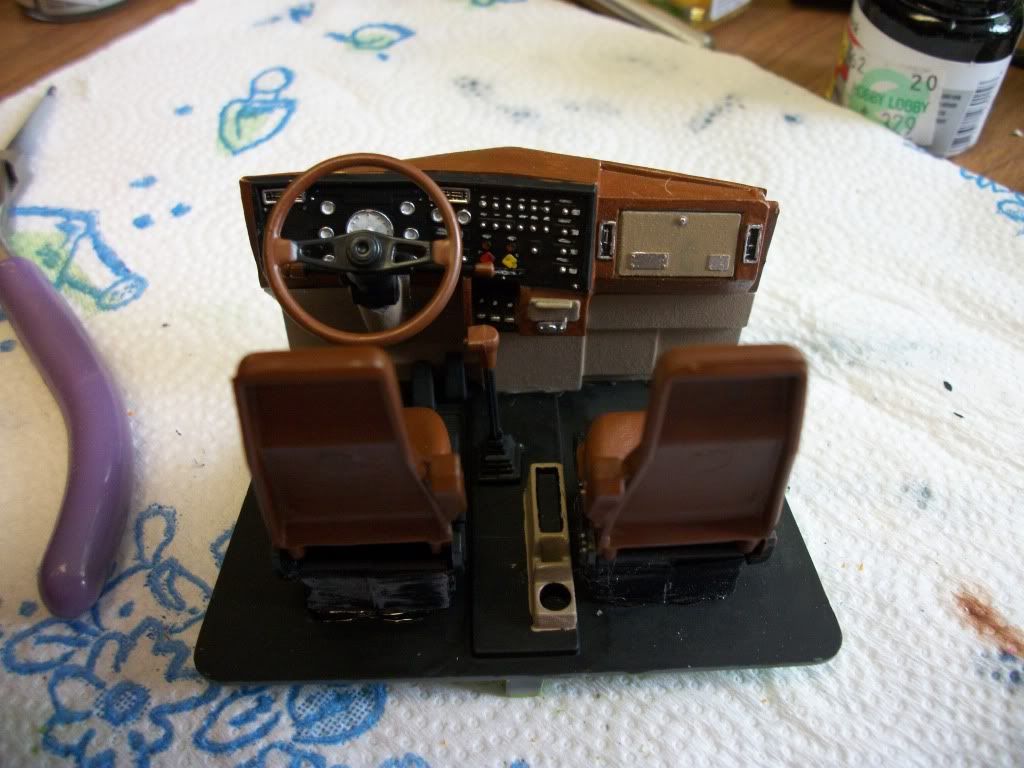

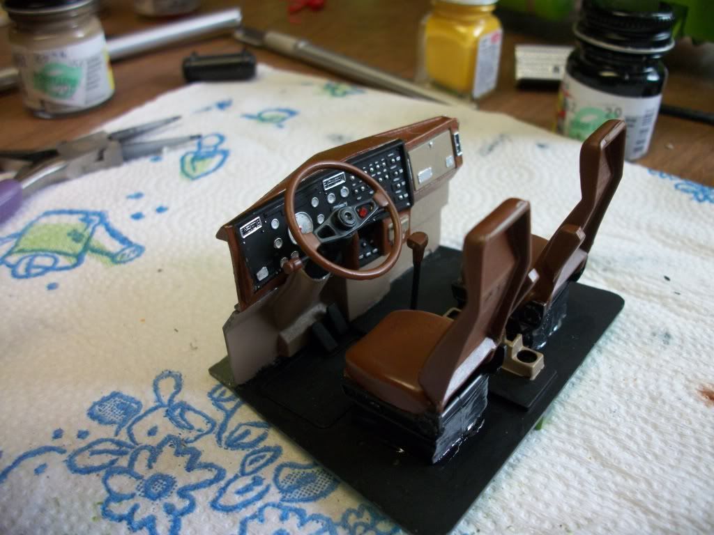

Okay finally got some model time in this week and got some pictures for ya all. did the interior with lots of leather color for that texas feel. painted the fenders and made the mounts for them now just waiting to get the wheels on so I can finish100_0744.jpg100_0743.jpg100_0740.jpg100_0739.jpg
Looks good Josh. I think I hear "Give Me 40 Acres" playing in the back ground (Might be showing my age here).
