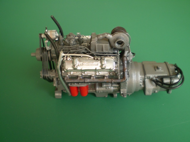

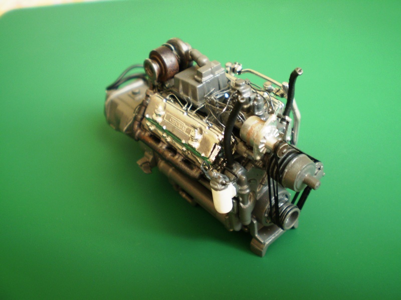

truckabilly Posted September 2, 2011 Author Posted September 2, 2011 (edited) Well, I continued with my research and addressed Klaus Lassen (thanks for the tip, Hessel). Klaus sent me a rock solid evidence that in 1993 the unit 402 called Clydes II was powered by CAT 3408. This makes it possible for me to carry on according to my initial plan. I already started working on the CAT 3408 using the old Ken Smith articles for detailing. The parts of the engine are base colour painted. Edited July 18, 2017 by truckabilly

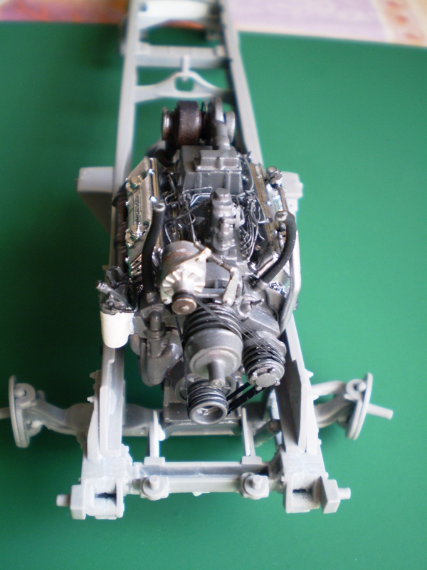

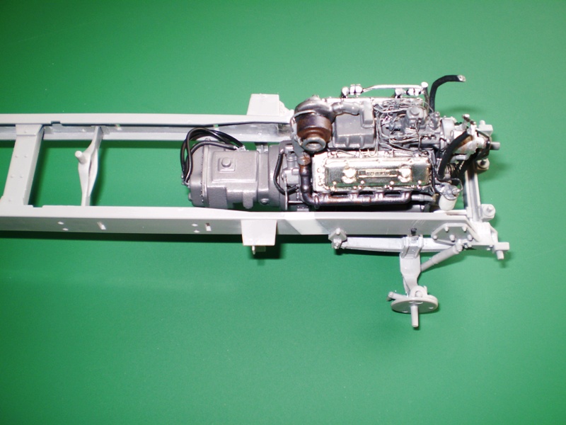

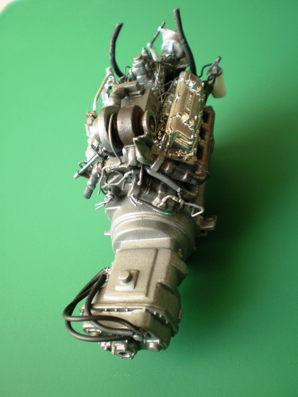

truckabilly Posted September 27, 2011 Author Posted September 27, 2011 Hello there, I finished the engine. Still not positive that the engine in Bill Signs unit is of the same color as the truck. But it is painted already. I used GSI 28 lightened by a drop or two of white. I added the plumbing and reworked the belts and puleys. Not a 100 % accurate but it is my first try. Here is a few mock-up shots of the engine in the frame. Still some colour imperfections but they will be fixed. Till next round Jarda

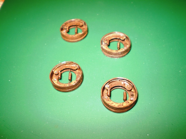

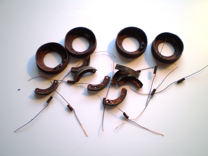

truckabilly Posted October 26, 2011 Author Posted October 26, 2011 Again, I couldn´t resist and made me the brake details to rear axles. Not 100% accurate but still better than empty wheels. I used only a junk plastic sheets and a wire. The brake drums are made of a plastic stripe. I coudn´t find any tube. Jarda
