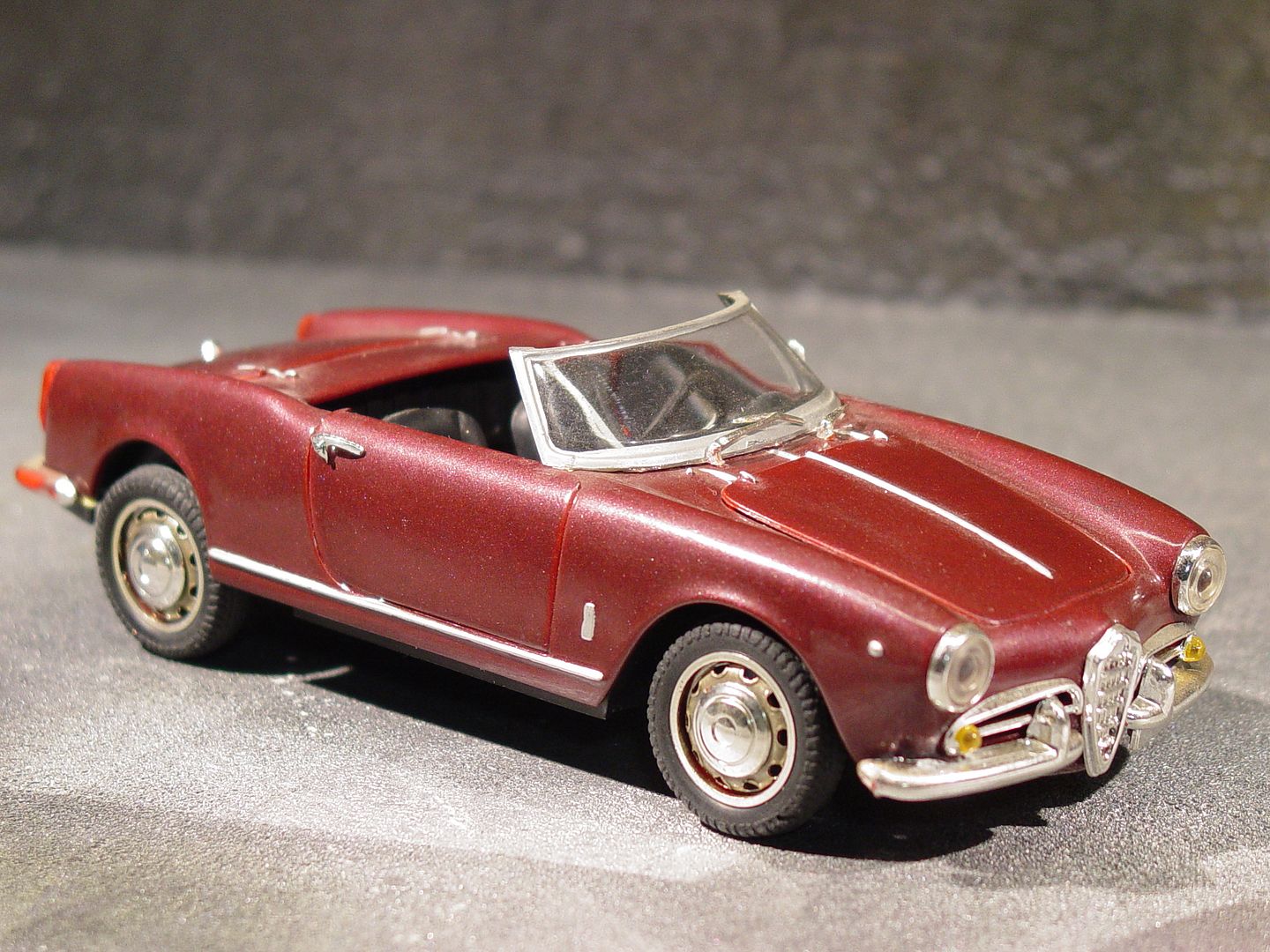

Here is an example of one I bought assembled & decided to strip:
that's it before disassembly.

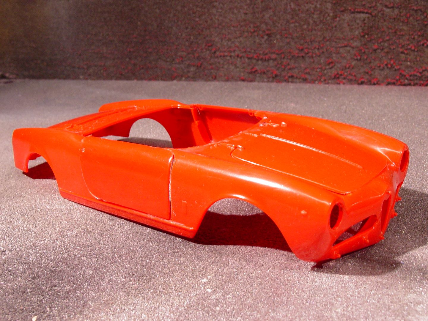

After taking a swim in a bucket of Super Clean - the body came out like this:
Shiny, Clean, almost virgin plastic.

2. Thanks for posting this very nice strip job. CSC seems like a pretty good alternative (I'm particularly attracted to this example because I used to own a 1:1 Giulietta Spider Veloce). As for the type of paint I need to strip, I really can't tell. I received the kit with a painted hood and fender assembly, which have a small amount of orange peel and actually is a tiny bit tacky (enamel?).
