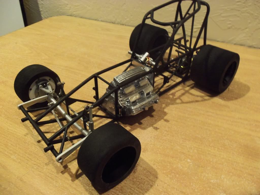

I'm starting a Grant King/ Tony Bettenhousen offset sprint car. This car was a record holder a Pheonix, for several years, driven by Anthony Simone. I am scratch building this and here is a picture from the first day. Ken.101_1085.jpg

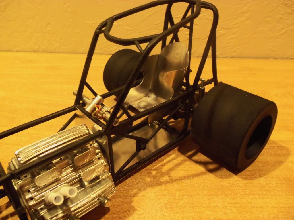

Thanks Mooneyzs. you must go to PIR, like I do. Well I drew those plans with a pencil and architectual scale; used to do that for a living. I made a mistake with Tony Bettenhousen as it was Gary Bettenhousen who help with Grant King designing the car. Here's some pictures of it. 100001.jpg

ken, i don't want to have to tell you this but, .......your motor fell over........LOL! gotta agree with the madd man, looking good!

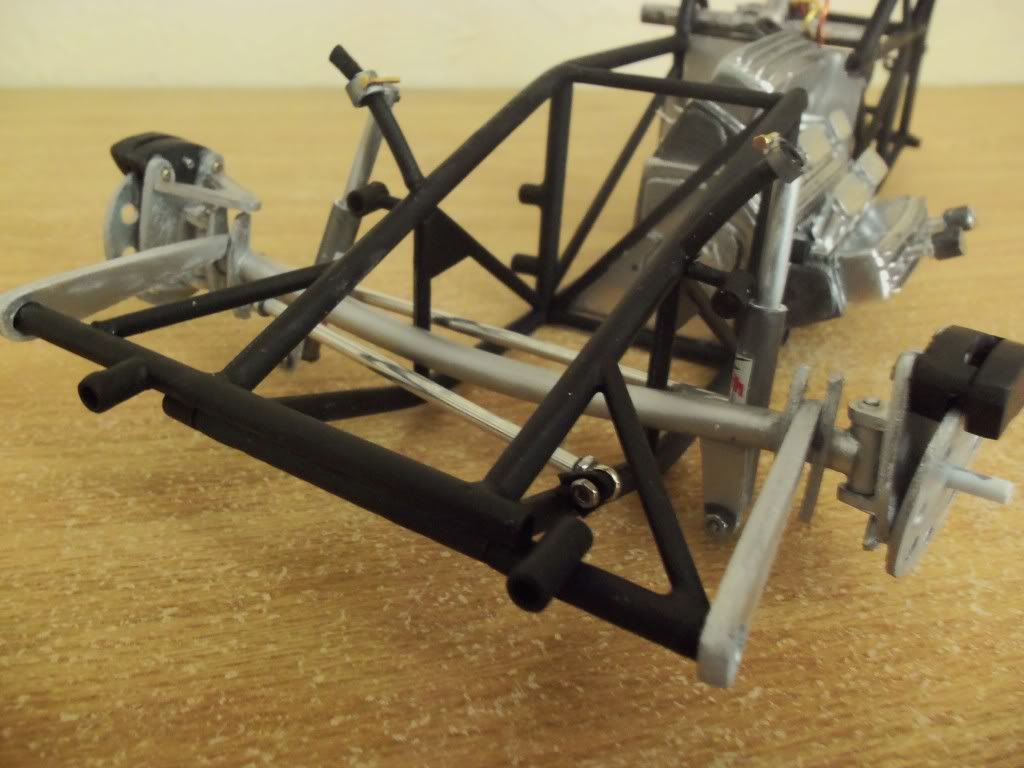

Thanks Madd Fab and Comp 1839. I've almost got the font end done and the steering box and firewall/ torque plate installed. The motor is set so I can install the removeable top rail to the frame. 101_1127.jpg

Dave, from the looks of it, I'm pretty sure those are R/C car tires and rims (foam-rubber tires, like slot cars have).
Dave; Wayne is correct. A year ago, when I first decided to try and scratch build a model, I bought these tires for a supermodiifed I was going to do. Tires for a scratch builder (like me) is a huge problem so I thought these tires would work. Well they didn't, too short, so I got some RC tires for dirt and filled in the tread. Since then I have built 7 cars and non of them would work with the tires either. So this model attracted me the most because I could make it to fit the tires and finally get to use them. This is a fooling around project that I needed to do, without spending a bunch of time or money on. I have been working on it less than two weeks, including drawing the plans. Thanks, you guys, for the great encourgement

May I ask what size tubing for the cage in 1/8 ?

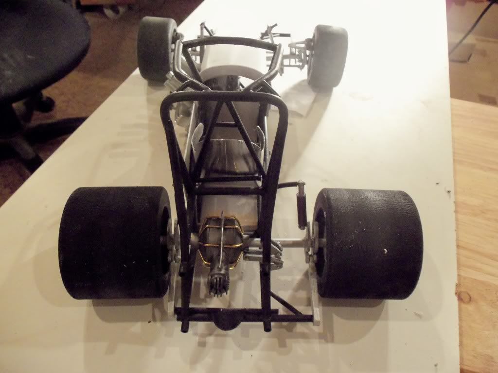

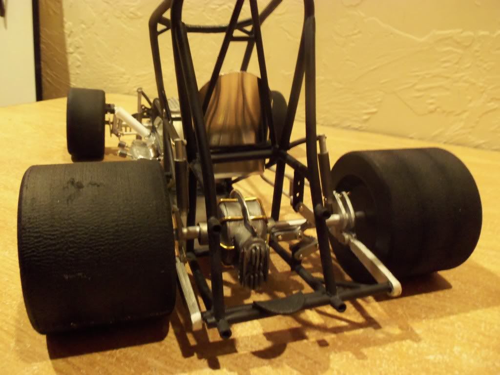

101_1142.jpg rear end done and the seat and belly pan in. That starnge looking sway bar, in the rear, is called a Jacob's Ladder. They're used mainly on circle track cars and keep the roll center consistant during suspension travel.

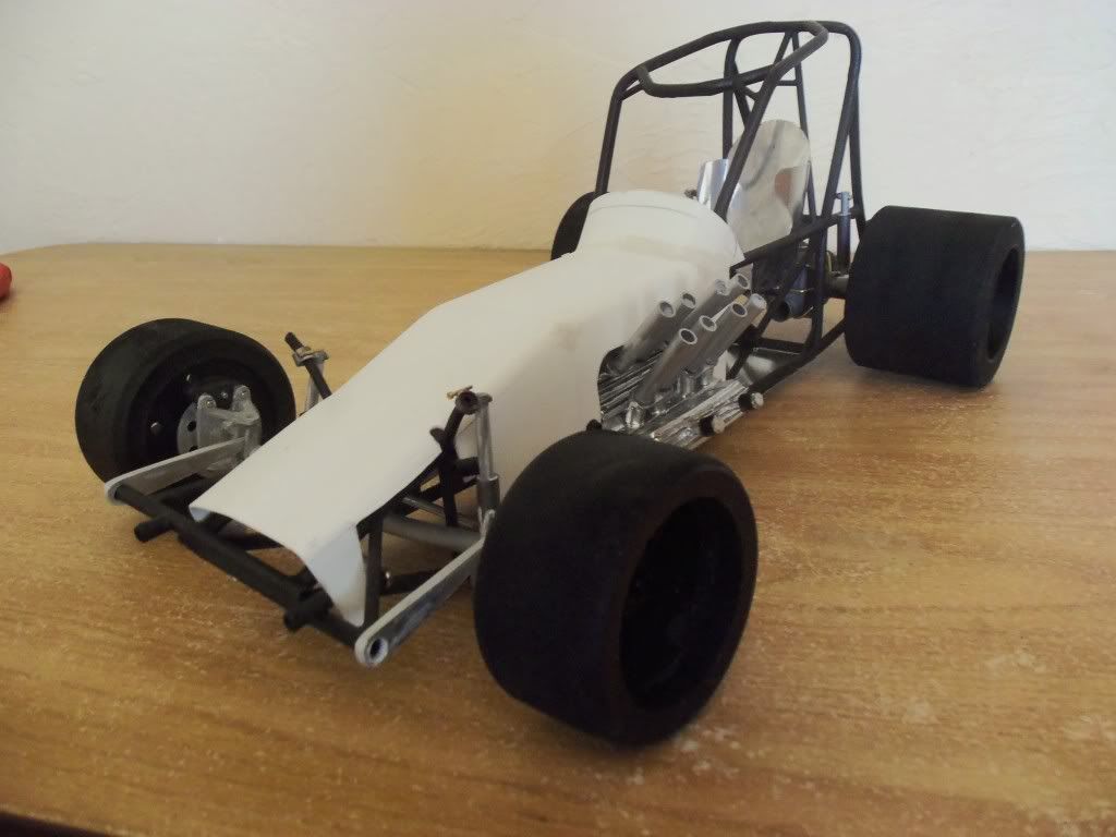

Fabulous. this is gonna be a cool project and your really moving along. what do you plan on using for the body?
Styrene and fiberglass. I trying to learn working styrene to get bends without using flame heat, just friction and body heat. I'm having some good luck so far. Ken

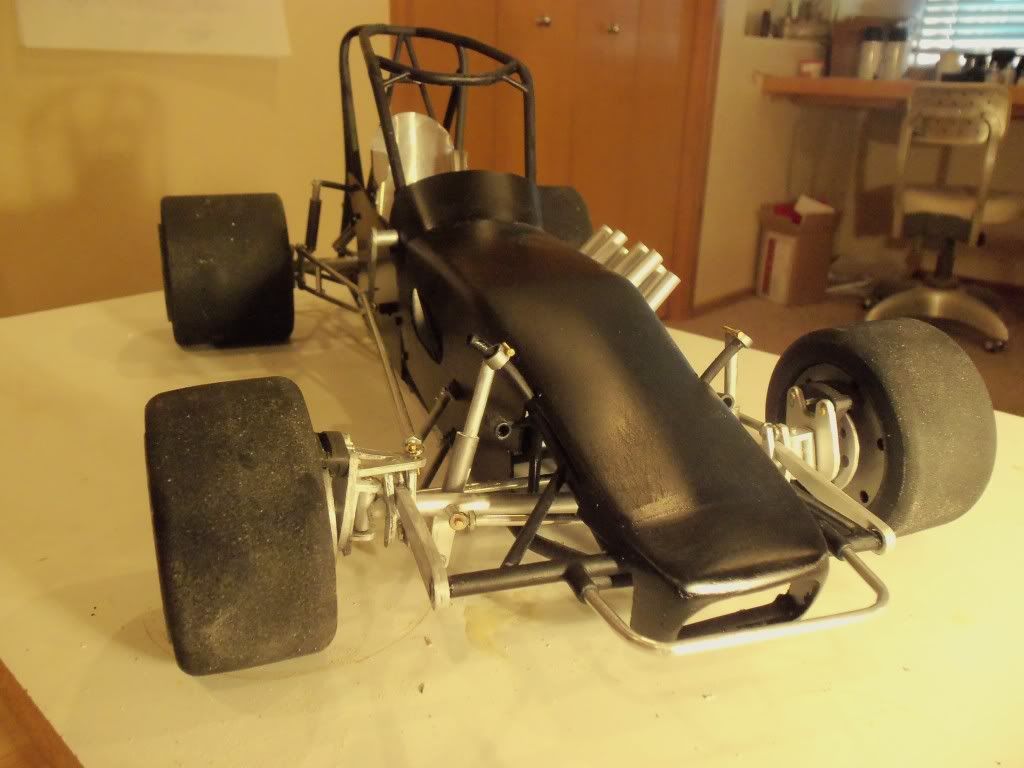

Joe; they're carpet RC tires I bought for my first model I built almost a year ago. They didn't work out well so I built a car to use them on. Here's my first attempt at making a body out of styrene. 101_1149.jpg
so if the tire dont fit the car , build a car to fit the tires lol. love it man...... surperb job
excellent modding the styrene body
