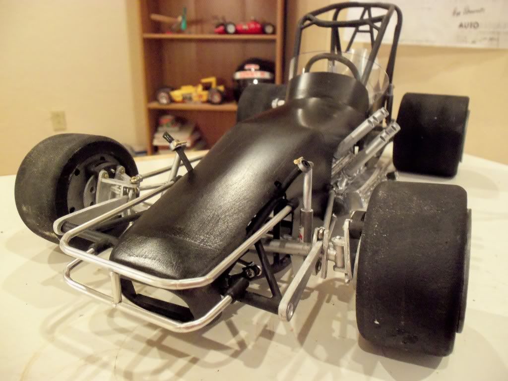

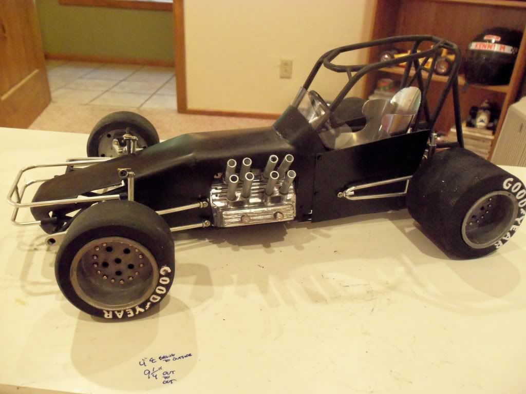

71drolds Posted September 26, 2011 Share Posted September 26, 2011 this may be a real bone head question but i dont know anything about sprints. why is the motor canted? is it for weight distribution? Quote Link to comment Share on other sites More sharing options...
Old Sprinter Posted September 26, 2011 Author Share Posted September 26, 2011 this may be a real bone head question but i dont know anything about sprints. why is the motor canted? is it for weight distribution? Yep, you got it. You try to get as much wieght to the left side of the car. Sprinters only turn left. Quote Link to comment Share on other sites More sharing options...
