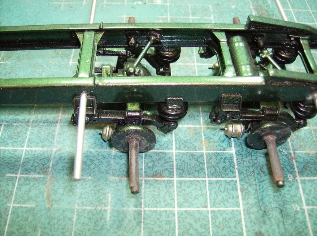

mackinac359 Posted December 23, 2011 Posted December 23, 2011 The "assumed" air ride was marketed exclusively by Peterbilt until 1971, it was the Western Unit Corp and called "Staibilaire." When Peterbilt dropped the suspension exclusivity Freightliner picked up the suspension so they could offer an air ride. Tim
Jim B Posted December 23, 2011 Posted December 23, 2011 So the air ride suspension in the AMT Peterbilt kits is "aftermatket" and not a Peterbilt exclusive?
lapazleo Posted February 21, 2012 Posted February 21, 2012 Tim is right on that generic suspension the Amt t500 and Pete 352 use this suspension albeit 1/25 scale. It was also an option on the Dodge Big horn even though only the prototype was built with it. I can tell you from personal experience you might as well have a four spring suspension.
