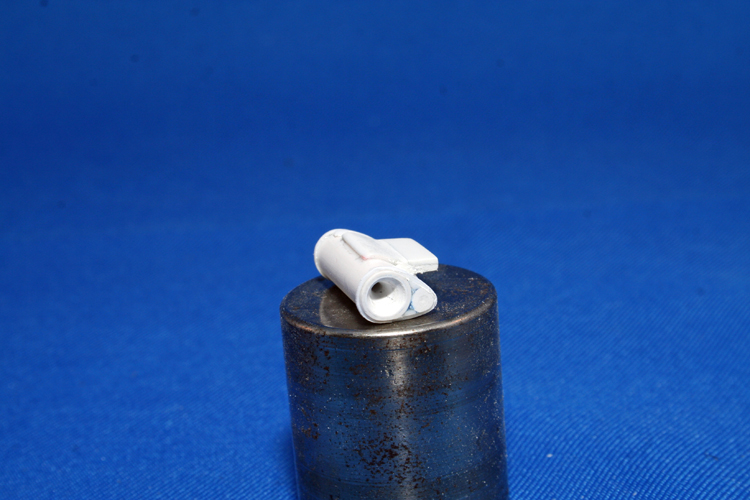

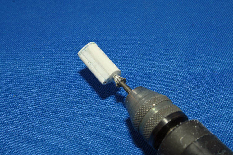

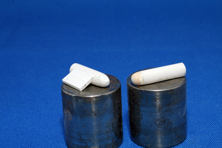

carsntrucks4you Posted October 29, 2011 Posted October 29, 2011 Currently I'm working on some swamp cooler's for my models. Here the first pictures. I had use 5.85 mm ( about 0.230 ") tube, with a 5 mm (0.194") tube as a insert. A conical mill was used to get a conical inlet. The end caps were made out of conical shaped scap material that I found somewhere. 0.06 x 0.25" sheet was used as air outlet. I also working on a Thermador car cooler. Until it is finished I'll post some pictures. These swamp cooler are easy to make.

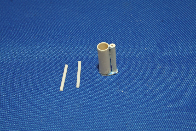

carsntrucks4you Posted October 29, 2011 Author Posted October 29, 2011 Now to the tHermador Cooler Materials that are needed 2 x 0.113" tube 1 x 0.193" tube 1 x 0.230" tube 2 x 0.058" half round strips 0.030" plastic sheet Metal foil
