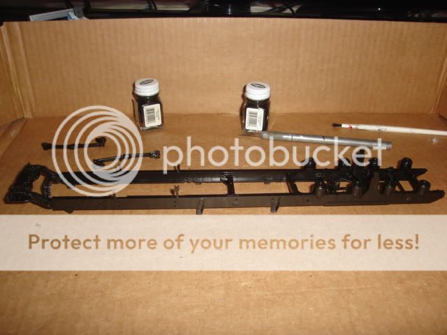

Scalper Posted November 20, 2011 Posted November 20, 2011 Wife got me this for my b-day. It will be my first build in the new place. I have a few days off so I will be working on this as much as I can. Not sure what color it will be The cab is molded in Red. Guess its time to start building. Thanks for looking.

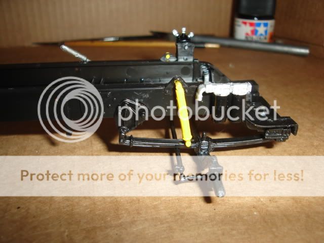

Scalper Posted November 22, 2011 Author Posted November 22, 2011 Got more work on the frame Front suspension is done. Would the ac unit from this parts pack be period correct. Probably will use the horns from this too. BTW what year is this truck anyways?
Jim B Posted November 22, 2011 Posted November 22, 2011 The truck is about a 1973 to 1982 (give or take a little).

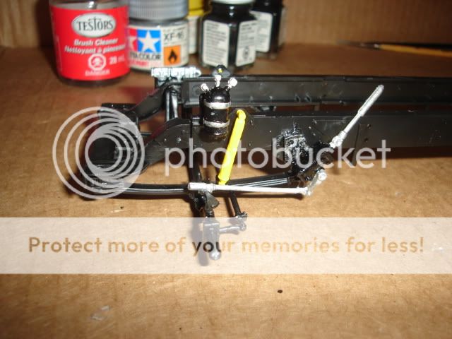

Scalper Posted November 23, 2011 Author Posted November 23, 2011 Got some more work done to the front of the frame. Thanks for looking

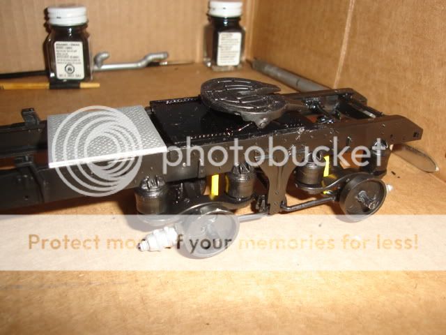

Scalper Posted November 27, 2011 Author Posted November 27, 2011 (edited) Got some more work done. Next the Back axles. Thanks for looking. Edited November 27, 2011 by Scalper

clayton Posted November 29, 2011 Posted November 29, 2011 Got some more work done to the front of the frame. Thanks for looking Can't see all that good but look like the shocks are upside down.
Scalper Posted December 4, 2011 Author Posted December 4, 2011 Hey Clayton. You are right. I did end up putting the shocks upside down. good eye I tried to take them out but they will not budge, But I did manage to complete the back end. thanks for looking.

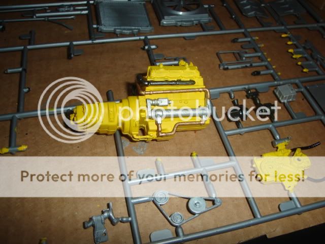

Scalper Posted December 11, 2011 Author Posted December 11, 2011 Andre Any updates?? Done a bit of work on the engine this week. more then half done. If I am lucky might finish the engine tonight. here is what it looks like so far thanks for looking.
