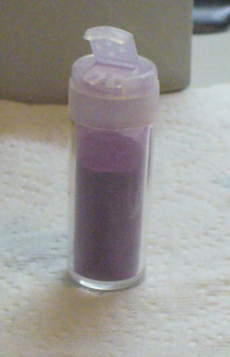

If any of you lives near a Roberts, they are going out of business and closing the retail stores. Things are 50% off. They don't sell models at all, but they do have art and craft supplies. I went in and picked up some paint, but my daughter Genevieve noticed a set of 18 different colors of flocking by Hampton Art for only $12.50 (normally $25). They all come in a small bottle with a snap-cap. The cap has small holes in it so you can sprinkle the flocking out easily. The flocking is finer (smaller bits) than the stuff I usually get from Detail Master, so this should look even better than the regular stuff. Here's a picture of the bottle to show you:

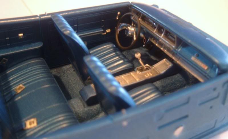

Then reach inside the fridge and grab the baking soda. It looks a lot better than flocking. ;)
Here's the best two photos I have.
The process is pretty much the same as flocking. I use white Elmers glue (diluted with water) to glue the soda down. I don't push the soda down, I merely tap the floorpan on my table 3-4 times. After the glue and soda is dry,I primer it with Plasti Kote primer(usually two good coats in a criss cross pattern). This is a must do as it seals the soda. If it isn't sealed before paint,the soda will begin to soak up the paint. Don't ask how I know this. After the primer is dry,spray it whatever color you want.

I actually sprayed mine with some dull coat Bill. The paint was Dupont Marina Blue and it had a little too much sheen for some reason. These two photos don't capture the texture very well at all. What I like best about it is that it doesn't have the fuzzy out of scale look that flocking does. The next project I use baking soda on,I'll take some good photos without seats and door panels.
