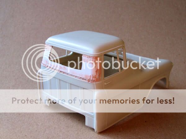

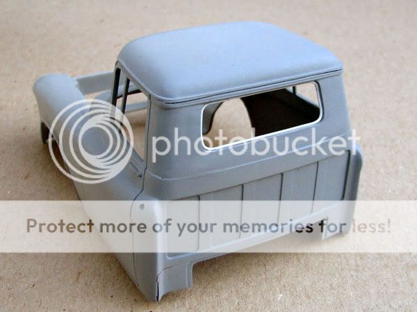

. Progress continues with the rear window. I found a picture online that was directly behind the cab. After resizing the image it was printed to scale. From this I can cut out the shape and use this for a template, as pictured in my above previous post.
I didn't take measurements from a 1/1 pickup truck to scale from. I'm working this one visually which is the way I usually build models. If it looks right then it is, usually :)
the window part has a weatherstrip detail along the edge around this part that has a thickness beyond the glass
I needed to uniformly fill the 'glass window' area with a sheet of styrene cut to the correct shape. I don't know the thickness of this material, I just placed them against each other and ran my thumb over it. It felt smooth and flush so I used it.

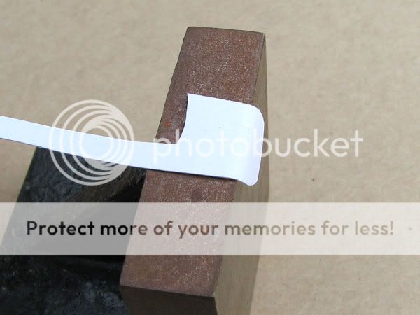

To get the exact shape right, I burnished a piece of paper over the detail shape of the window part
Then this was penciled for better clarity. This was then cut out with scissors and transfered to the styrene sheet. Then the styrene material was cut out to the proper shape

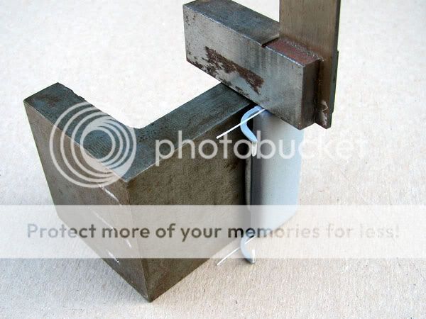

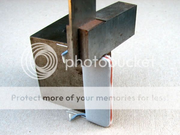

This was then shaped over a steel block for better gluing and adhesion
Crazy clampidge while the glue set was deployed
After glue set, automotive product Body Filler was used to fill the gaps arond the 'glass window' part that this kit is famous for
I wanted to complete this model by this weekend for a local model fest, but lots of OT at work kept me away from the bench.

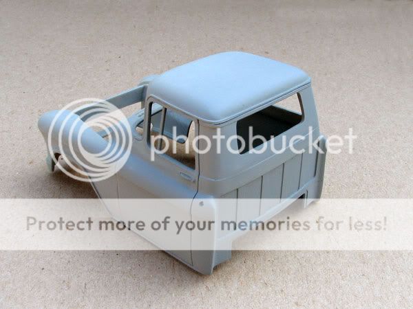

The rear window body work is finished with only the window weather stripping to install.

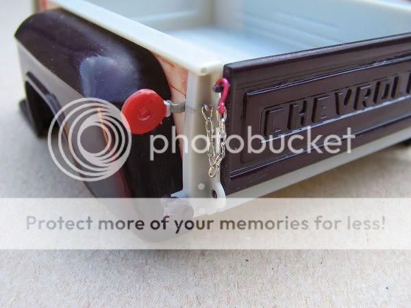

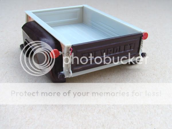

I found the tiny chain for the tailgate support from a craft store in the jewelry beading department

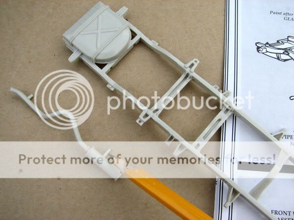

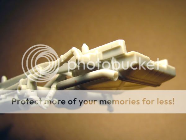

The iSheets indicate location for these exhaust parts, but there are no holes for the pins.
I had to drill hole at 1/16" through the top side of the chassis frame part.
What type and shape of material would you recommend for this?
Edward, for this scratchbuilt Jeep halfcab, I glued on .010" styrene sheet that was about .020" or so LARGER than the window opening. After curing, carefully cut out the window opening, leaving behind the "rubber" moulding:

But the '55 I'm building has this weather stripping sort of in the frame though. I guess I can do the similar thing but with a thinner piece of strip styrene

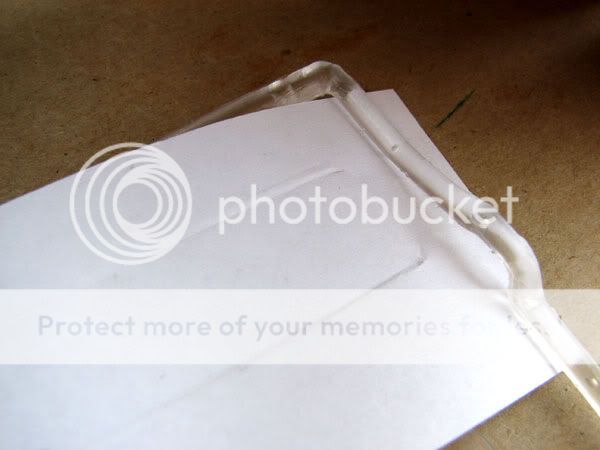

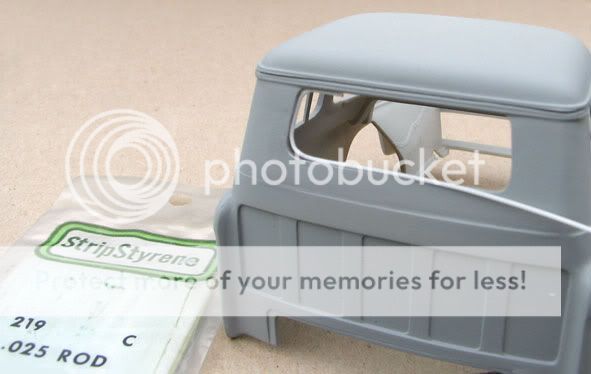

Thanks everyone for getting at me with those various suggestions and ideasfor the rear window weather strip.
I'm going with the .025 styrene rod method that is so-far the easiest and I already have a pack here.
I'm forming the rod by bending it by hand. Then Crazy Glue (CA) in place as I go along.
I'll update soon with results if this actually worked...

This material works, finally done with this part
A sharpened pencil tip was used to shape and hold each radius because of the variable corners and the porous wood material broke free easily from the CA where it touched
The lower piece at the bottom of the cab cracked free during this over handling but that's cool, it's fixable
