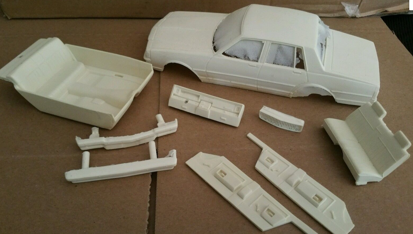

The Modelhaus makes a resin 1985 Impala 4 door for $62.00 that Includes four door body with hood molded in, interior tub with separate door panels and bench seat, dash, steering wheel, front bumper, grille, rear bumper, taillights with back up lens, hubcaps, glass. Use any Revell Caprice kit to finish.

As Darin wrote, your only option is the Modelhaus, which evolved from a heavily modified Ertl diecast stockcar and is an Impala, not a Caprice.
I have never seen one built, but after seeing a photo of the kit, I wasn't convinced enough to shell out 62 $ for it. It just doesn't look right to me.

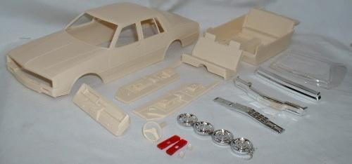

I've been seeing this kit by AJ Resins on ebay on and off for some time now:
http://www.ebay.com/itm/1986-90-Chevy-Box-Caprice-4dr-Euro-front-resin-kit-lowrider-/112066034090?hash=item1a17a7f9aa:g:jw0AAOSw1DtXJzS6
It looks to be a modification of the Modelhaus Impala. The taillights look good but I am not satisfied with the way the headlights look. And the kit comes without glass, which is a big negative. Any thoughts guys?

Definitely a Modelhaus clone. The headlights look a bit off, but then again she's the only game in town right now.

Headlights seem a bit too short vertically.  But it would be a good starting place to swap in headlights from something else to do an 86.
The headlights actually seem like a fairly easy fix. It's the lack of windows that is turning me off from getting one.
The windows shouldn't be too hard to make from sheet plastic, though...the rear and side windows are pretty flat.
But the front window though :rolleyes:
Shouldn't be that difficult..not much curvature.  I've made windshields out of sheets of clear plastic, from random stuff like electronics packaging, etc.
I get ya, I get ya. What I'm trying to get at is that I have ZERO experience with this and would rather not buy right now given that and the price. One day I'll learn ;)
