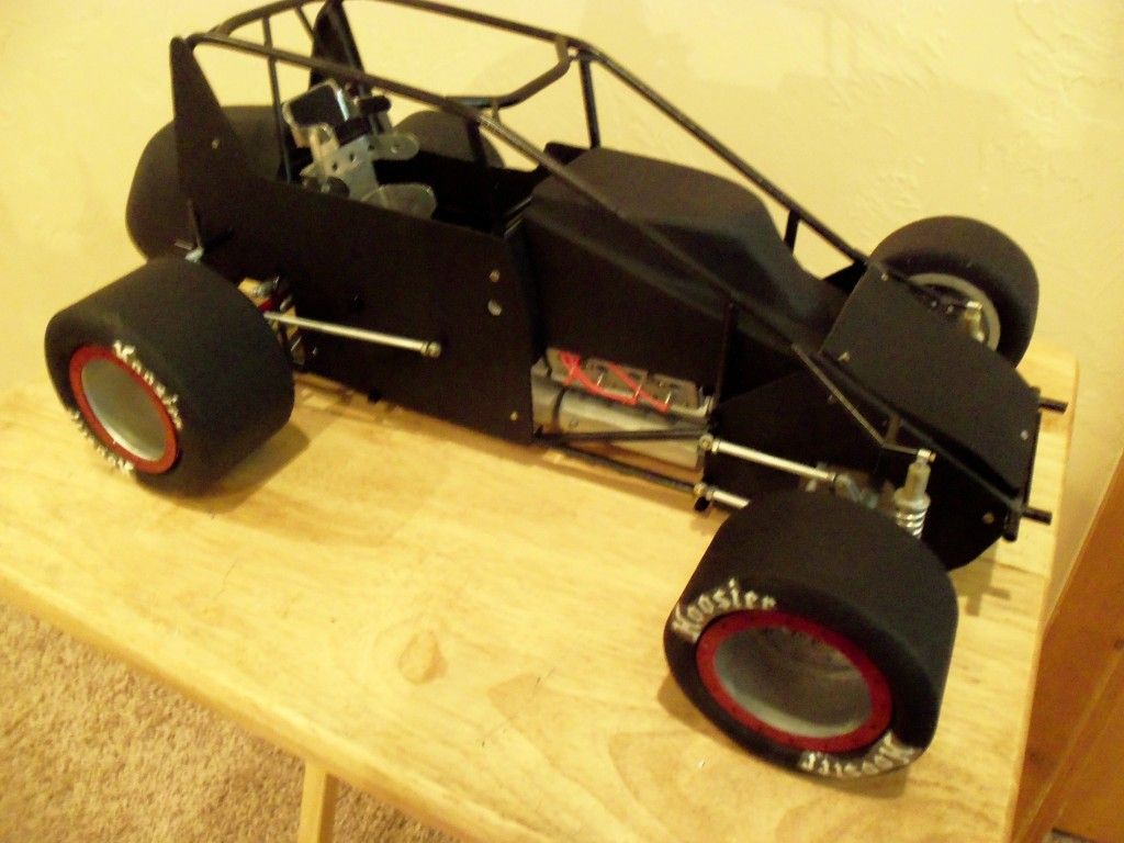

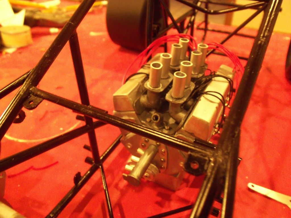

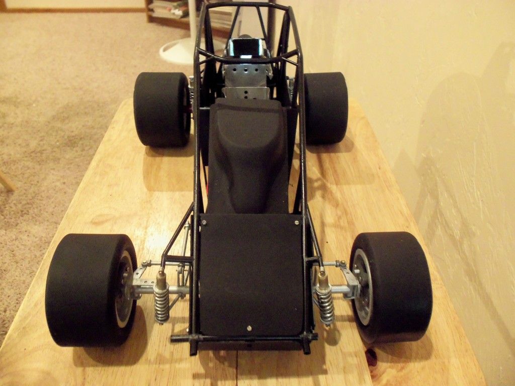

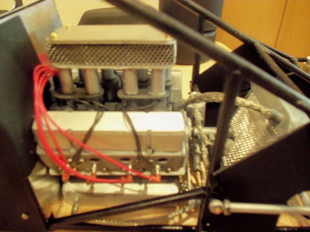

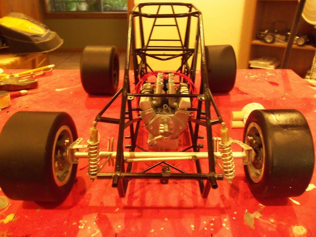

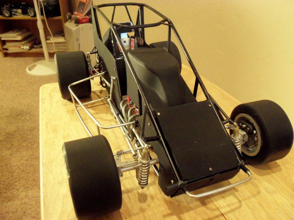

Here's where the Beast sits today. Front end almost done; building the quick change and the motor is almost complete; plus I have finished the tires. Thank God for slicks, this time as there's no tread to cut in. Notice the offset to the left. The whole car sits 2" to the left from center of the wheel track. That's what the USAC rules allow other wise they'd be like super modifieds where nothing is on the right side and the motor hangs out flush with the left rear tire..101_2049.jpg

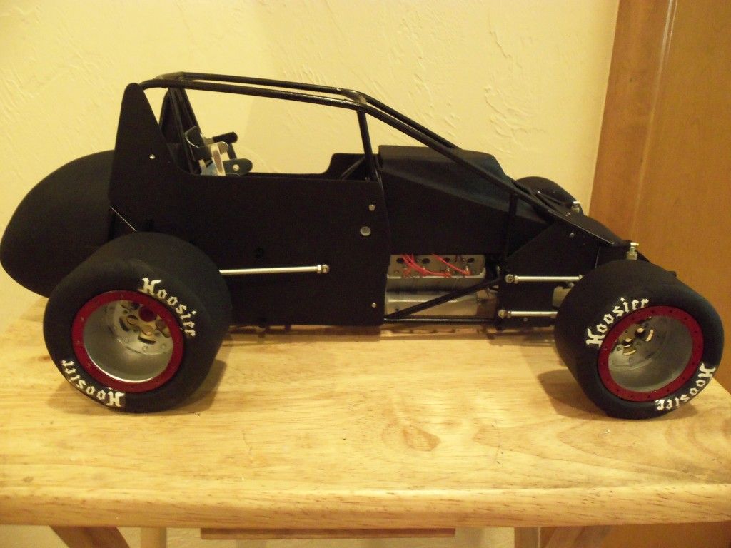

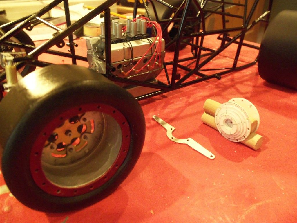

Joe; I think that's a great idea, but I need to finish my commitments first. Here's today's progress. This is a pavement car driven by Tracy Hines in USAC. I'll be getting the decals next week, some time, so I can finish both cars up and start on the next. Check out the jabobs ladder on the right rear.101_2062.jpg

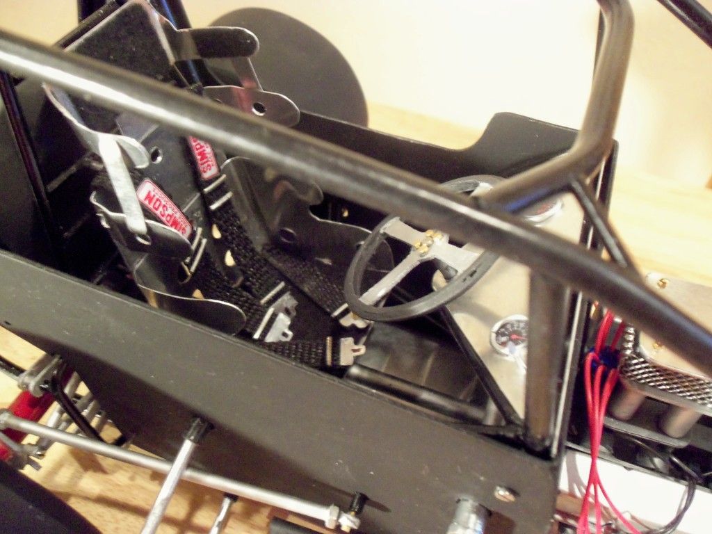

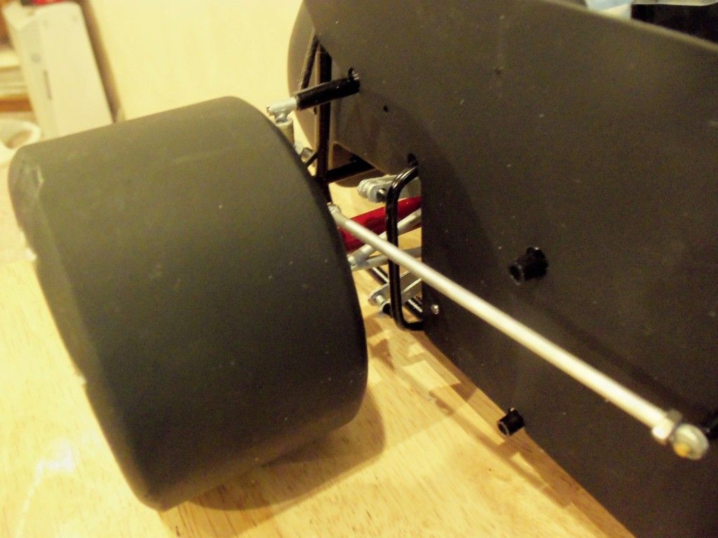

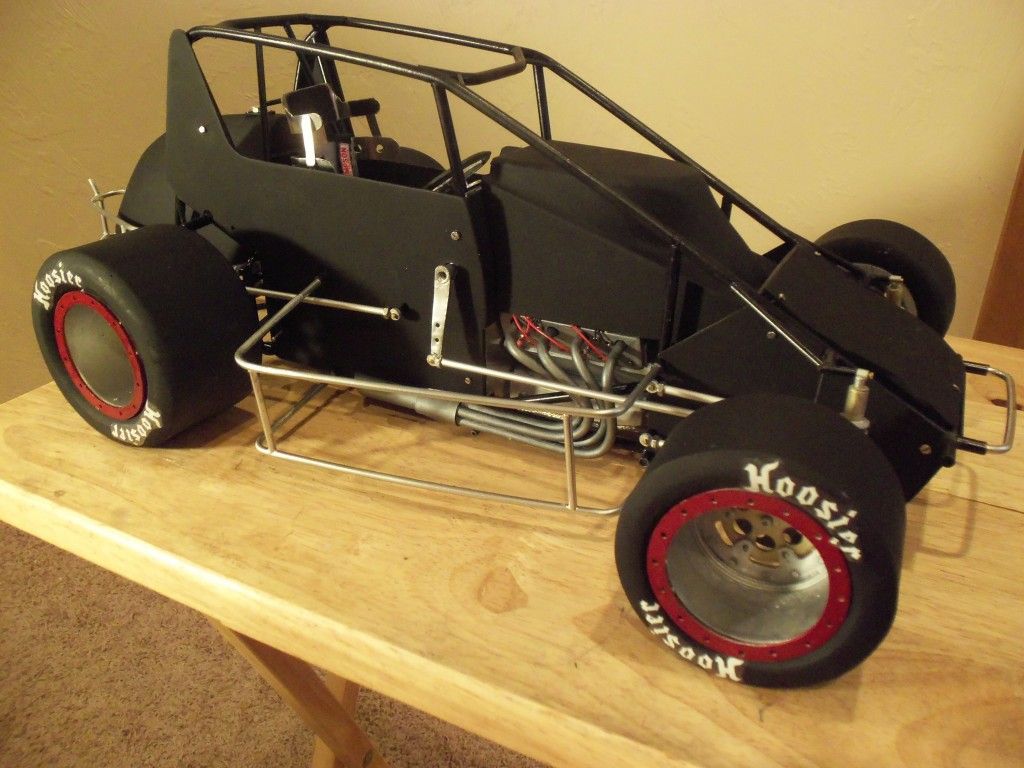

A dirt sprinter uses two brakes; one the the left front and one at the center of the rear end ( to the left of the quick change). A pavement car needs more brake so they run one on each front wheel and add an additional brake to the rear on the left side, Also the radiator is laid down on an angle to allow better cooling with the areo front configuration.101_2079.jpg

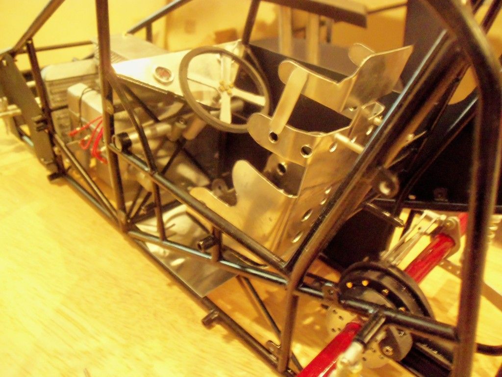

These cars are getting decals this week and being deployed to Indiana next week. Note the right hand steer on the pavement car vs. left hand on the dirt car.101_2099.jpg

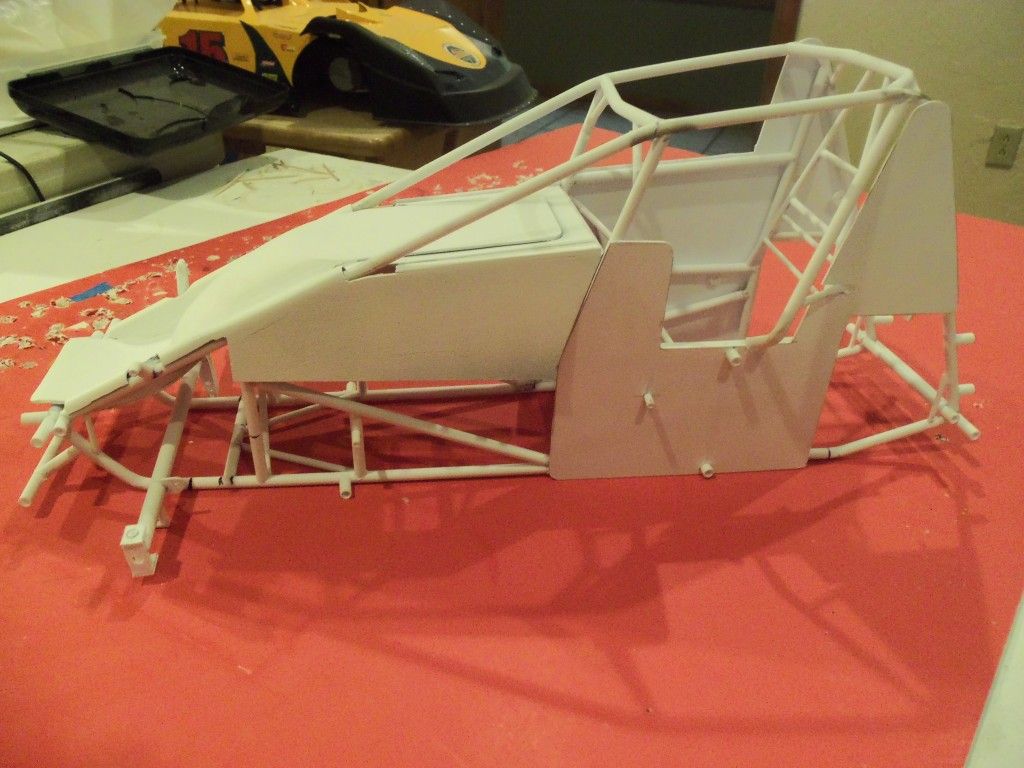

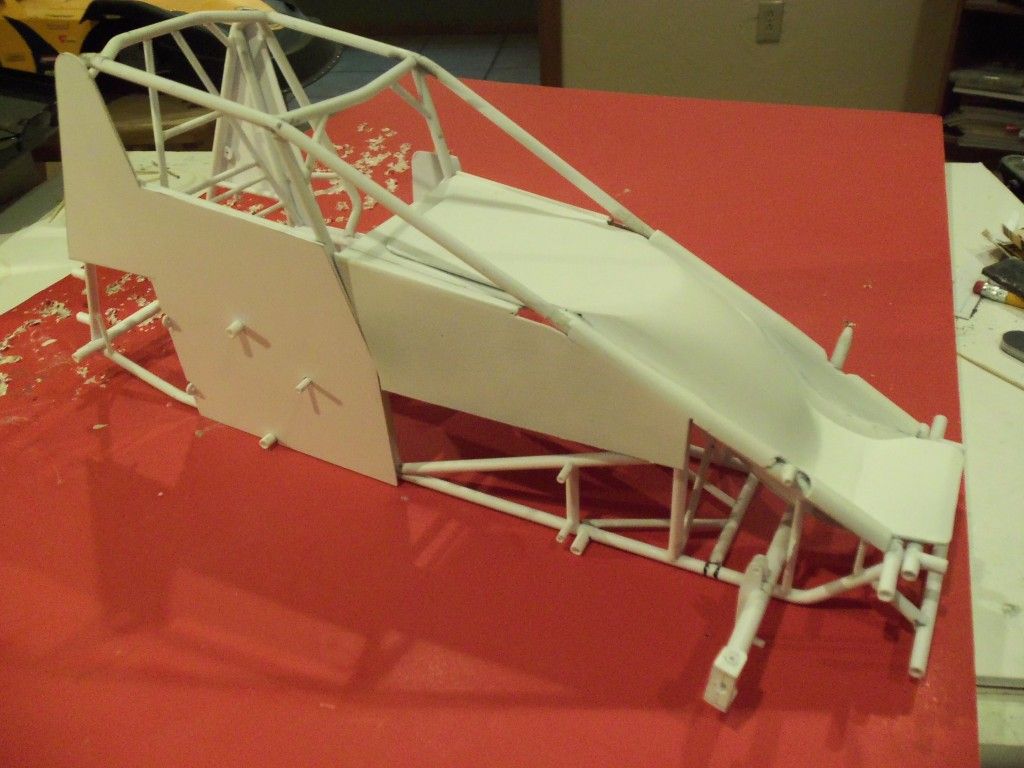

I'm starting on #3 actually it's car 53 in USAC. It's another dirt car with some slight differences from the first one. The left side has another vertical bar at the cage, the front braces are different and the shock mounts and hood is different. I'm getting faster as all of this has taken me about 12 hours to do. Here's also a shot of the real car, I'm building..101_2114.jpg

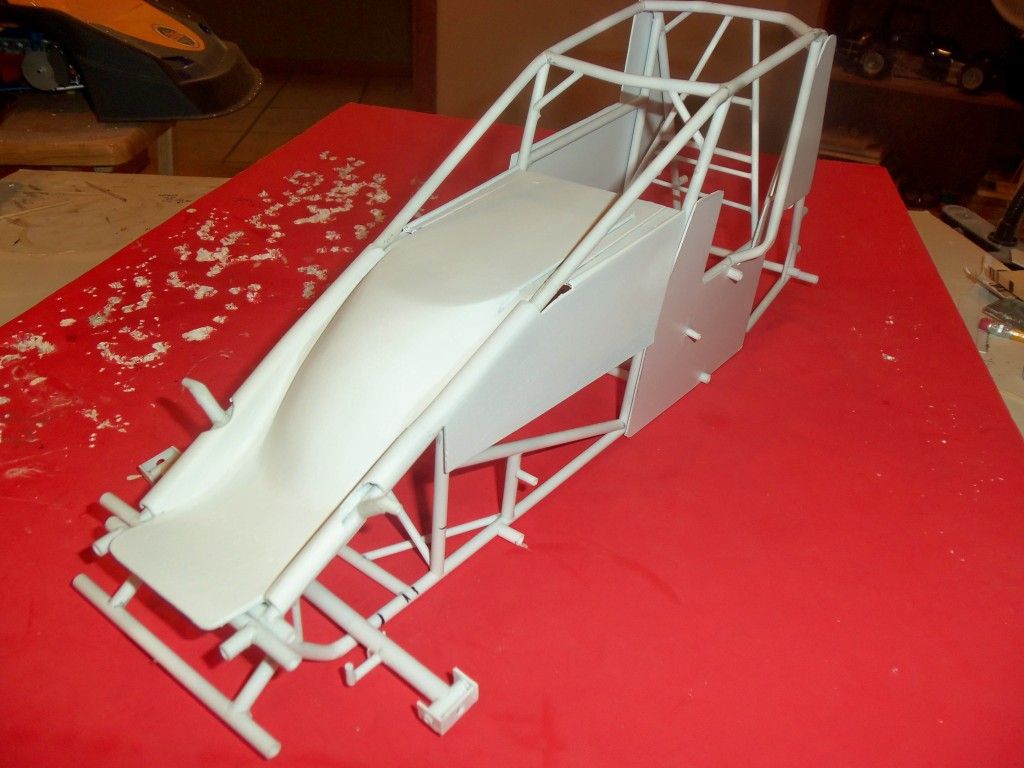

I'm waiting on the decals, still and on a shipment of styrene so I robbed some tires and wheels from the first car just to see what she's going to look like. The hood on this was a challenge.101_2137.jpg
Ken, I don't know how you can Contort that styrene but man you do a fantastic job.
Well I guess I should ask of it is styrene and not fiberglass...?
Care to share your secret on,how you made that hood happen?
Bart; it's styrene and some Bondo. The sides and top are .040 styrene sheet epoxied to a half of a 1/4" styrene tube. The main rail at the cage are 3/16" so it has to slide over them; that's why 1/4". The rounded part of the hood I made styrene ribs in that shape, glued them to the top and filled it in with Bondo to make it rounded. The hood is cut along the injector box so the sides pull out to slip the hood on or off. It's an old Indian trick! LOL Ken
