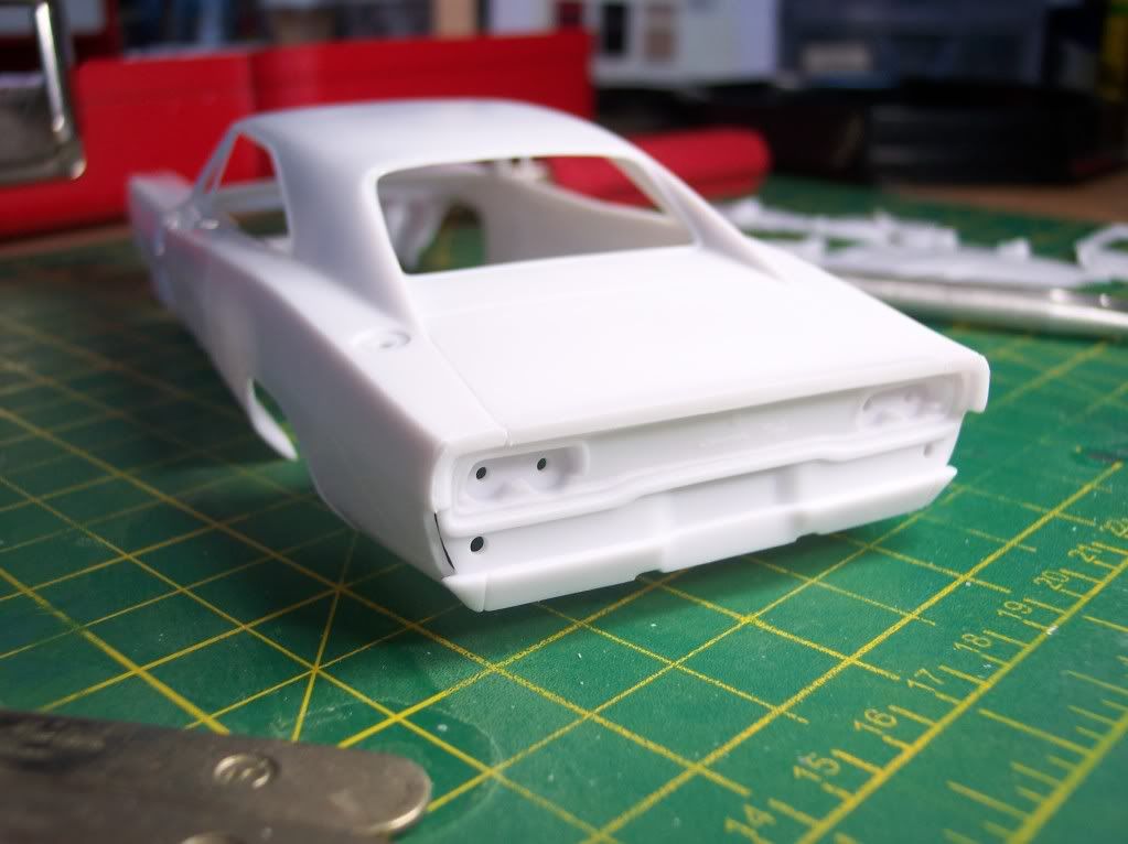

GeeBee Posted March 26, 2012 Posted March 26, 2012 (edited) With the '32 Chrysler Imperial finished, I thought I would make a start on the '68 Charger I bought off eBay, I'm still not sure why I bought it, as I usually only build classic British & European cars, oh well, it's too late to do anything about it now ! The body will be done in a genuine colour of Dodge, UU-1 Light blue Poly, which a friend in New York was kind enough to get it for me from Scale Finishes, and send it over, it's also the same paint that Dodge was using at the time in '68 to paint the Chargers, Acrylic enamel, something I haven't used before, so it will be interesting to see how it sprays. Luckily I have managed to get hold of plenty of reference materials, and had some photo's printed out so it will easy to look at them for reference, having to keep looking at the computer screen does my nut in !! This morning I opened the plastic bag the parts were in, the chrome has now gone into the stripper, as all the chrome will be done using chrome Alclad lacquers, but the body and most of the parts have a lot of work to be done to them, the rear quarters of the body, just by the roof gutter trim and by the front of the rear wheel wells need a lot of work, now I'm not 100% sure if the body tooling was modified from the '69 Charger, but there is remnants of the chrome trim that seperates the body and the vinyl roof, and a very heavy mold line just below it .... A chisel blade and sanding sticks should get them out, also the chassis has some copyright scripts that will need removing and other parts have a lot of sink marks and ejector pin marks, so this one isn't going to be a five minute build Body sorted .. Edited March 26, 2012 by GeeBee

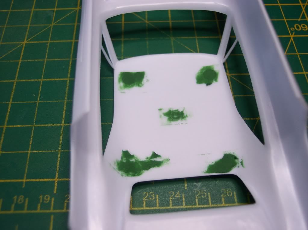

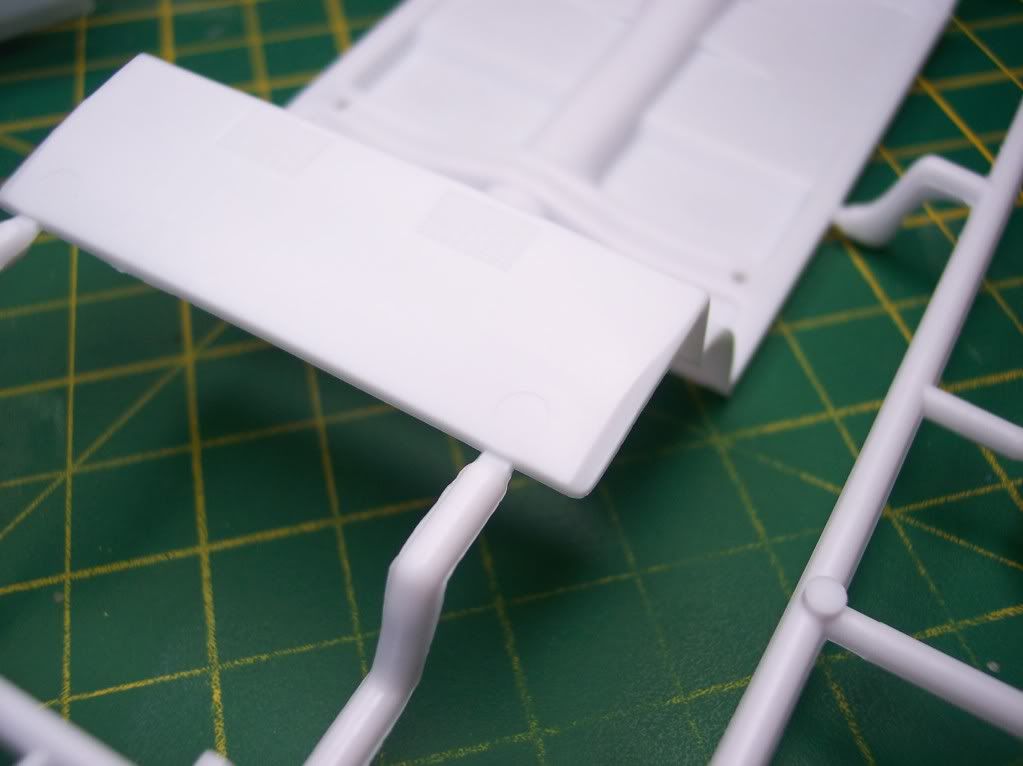

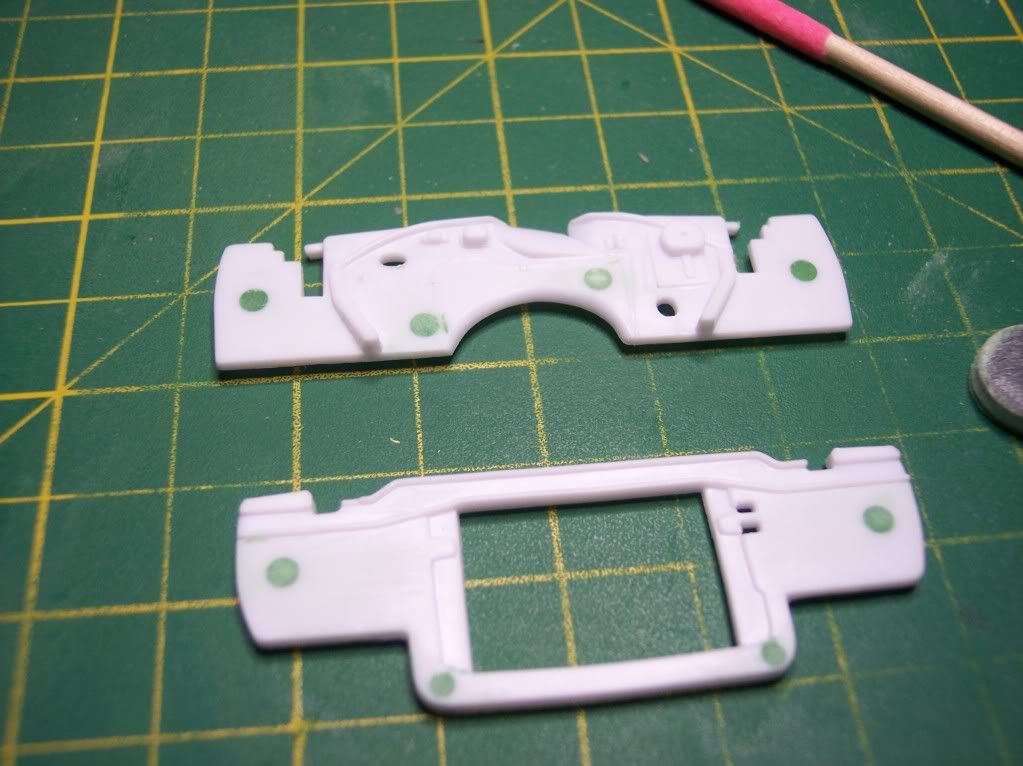

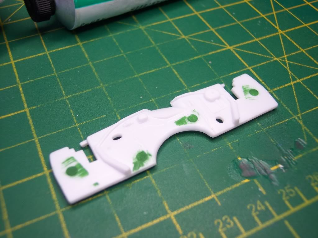

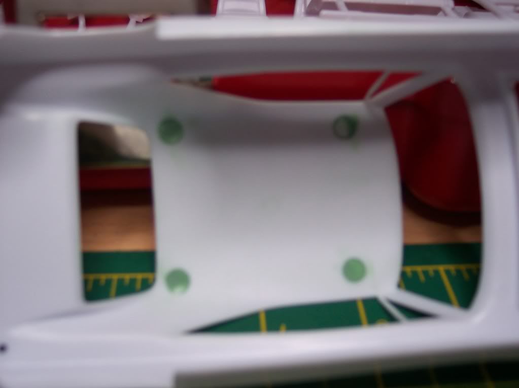

GeeBee Posted March 26, 2012 Author Posted March 26, 2012 Spent a little time scribing the shut lines on the door and boot (Trunk) as they were a bit on the thin side, and a couple of coats of paint would have seen them filled in, also went round all the parts that had ejector pin marks on them that will be seen, a little bit of Squadron green putty soon sorted them out, and test fitted a few parts,

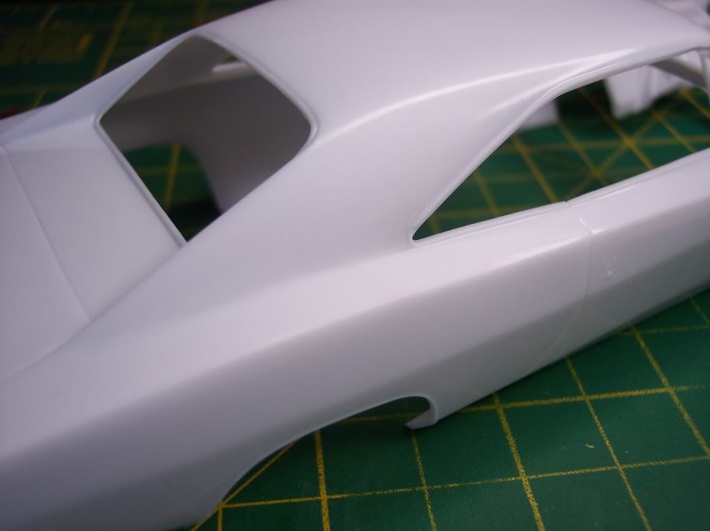

62rebel Posted March 26, 2012 Posted March 26, 2012 you mistook the dome light recess for an ejection pin mark.
GeeBee Posted March 26, 2012 Author Posted March 26, 2012 Good start. Question, why re-chrome all the chrome parts? At least, in my opinion, the chrome on the bumpers is always better than the ones done in Alclad. I personally think that Alclad is perfect for smaller parts like valve covers and stuff. I suppose it's just a personal thing, since I've been using Alclad, I now just have a dislike for kit chrome, for me, it just looks too new, plus they always seem to connect the parts on the chrome sprue that leaves a mark when there cut off, so they either need touching in with chrome silver paint or BMF, stripping the chrome and doing the parts in Alclad to me look better and worth the extra work needed ... you mistook the dome light recess for an ejection pin mark. You know, as soon as I'd popped the putty in the centre, I realized my mistake, but luckily it isn't too heavy, and should sand back out ...
GeeBee Posted March 26, 2012 Author Posted March 26, 2012 (edited) Only a little more done today, managed to sand down the putty that I put in earlier, Edited March 26, 2012 by GeeBee

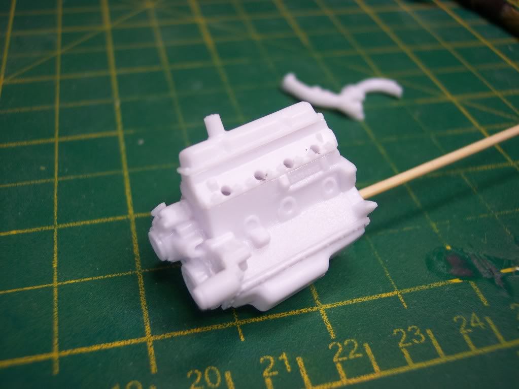

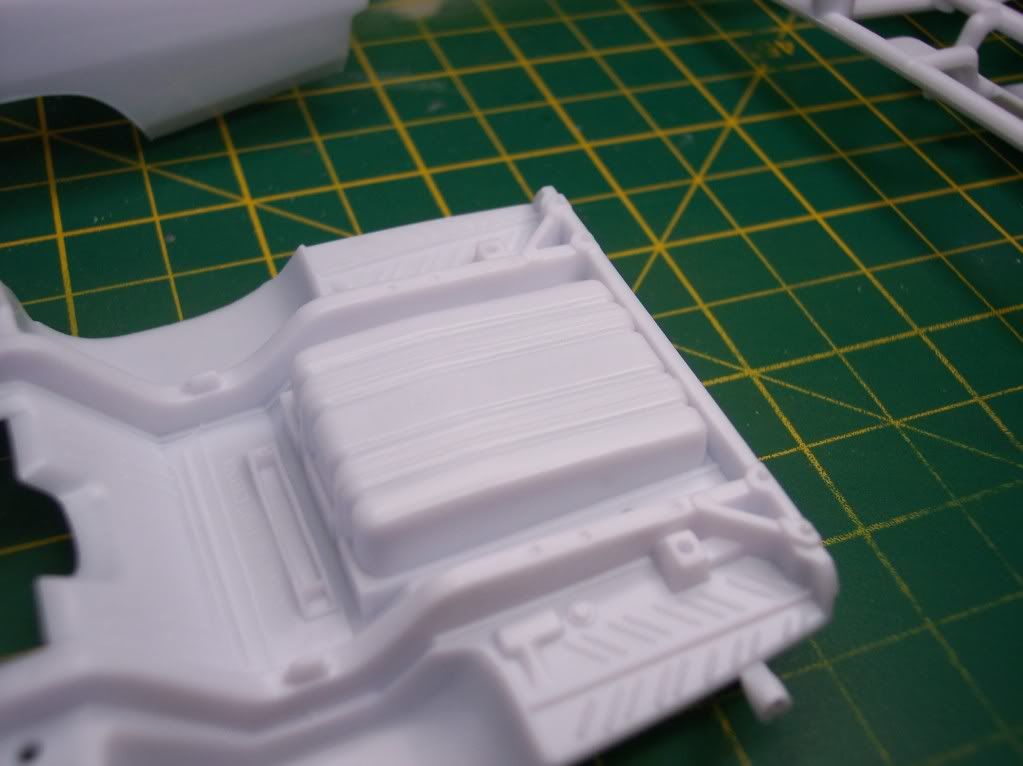

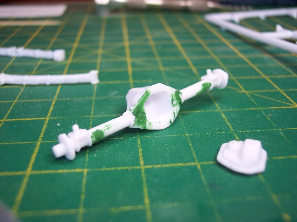

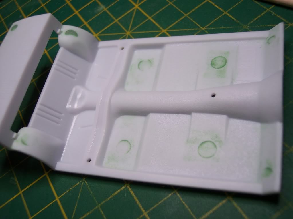

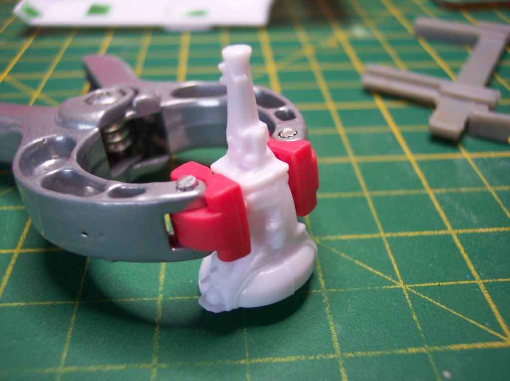

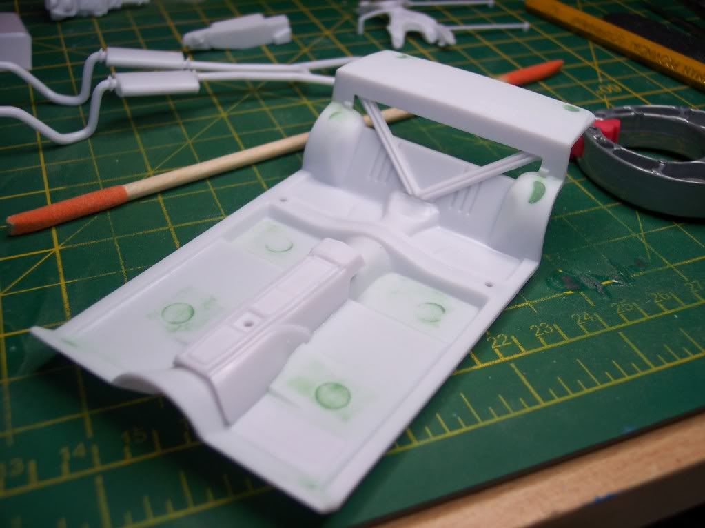

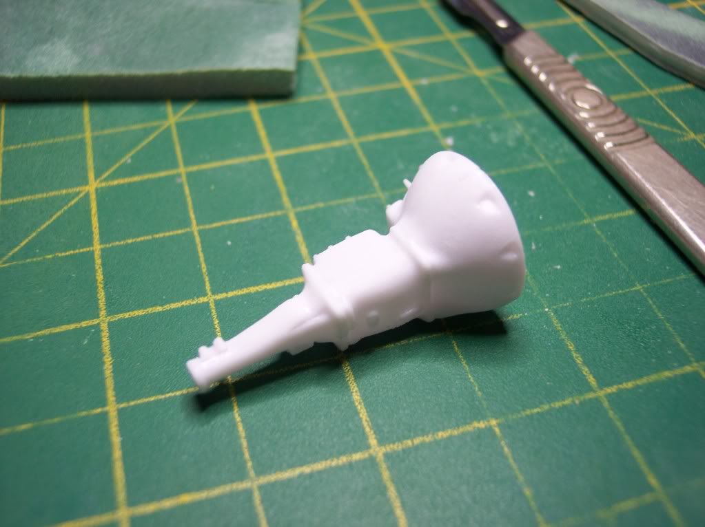

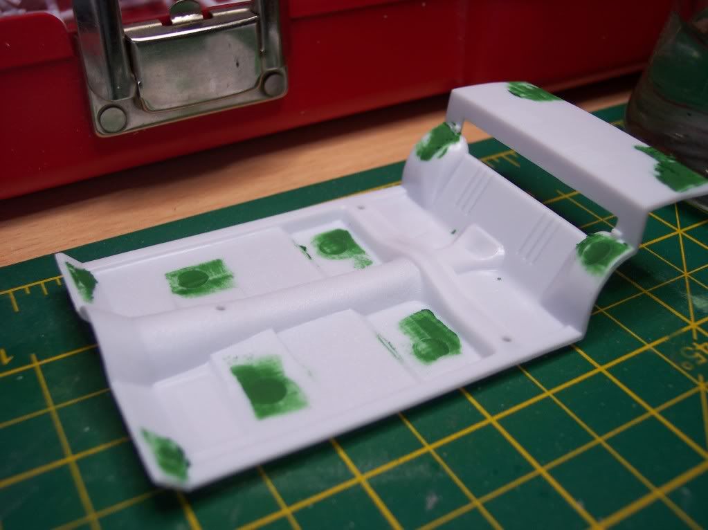

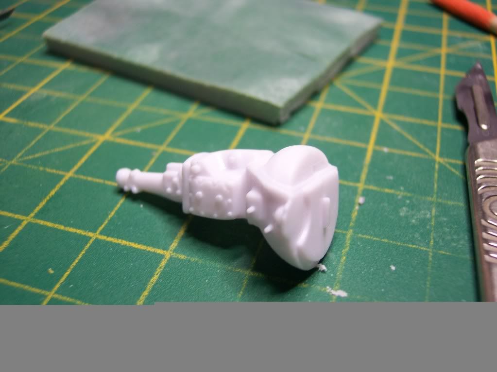

GeeBee Posted March 27, 2012 Author Posted March 27, 2012 Just a little bit more done this afternoon, I noticed that the floorpan had a lot of ejector pin marks on it, and although it will be covered in either flocking or embossing powders, they still needed filling in, got the engine built up as much as I can before it needs painting, also got the gearbox together, once the cement had dried, the join line was removed with files and sanding sticks, it will be painted metallic silver

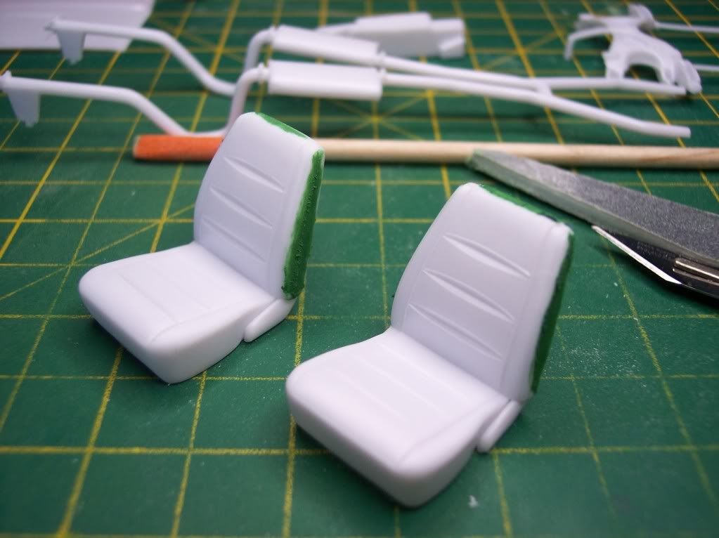

GeeBee Posted March 28, 2012 Author Posted March 28, 2012 Not a great deal done today, still got the chrome parts in caustic soda, the bleach got rid of the shiney stuff, but the lacquer underneath put up a bit of a fight, an overnight soak in Fairy power spray did a good job, but there was still a bit left, so there was nothing for it but a soak in good old caustic soda, so a trip to the local hardware store, left it soaking all afternoon, and all the lacquer has now gone, got the front seats and seat back glued, which left a seam line that needed filling, the centre console and the rear seat brace was fitted in at the same time ...

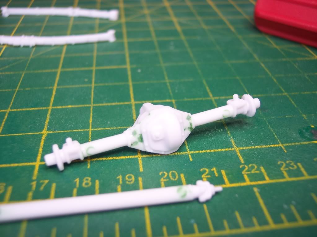

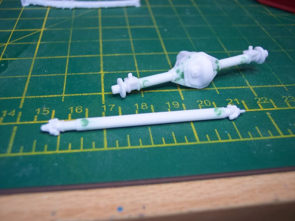

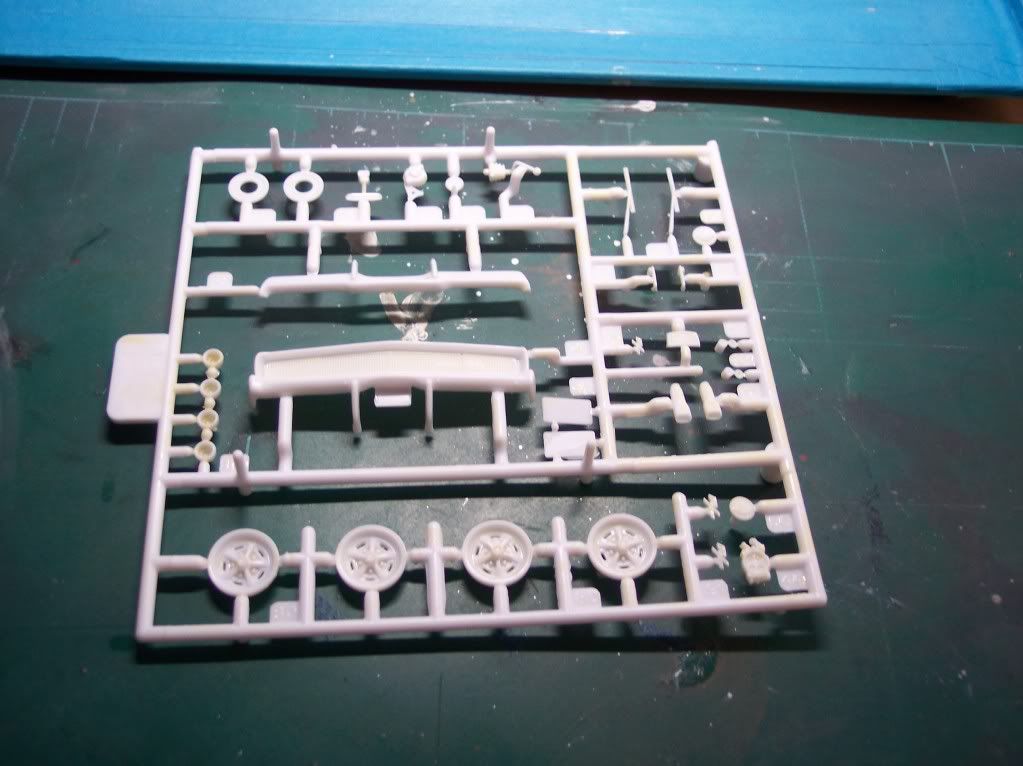

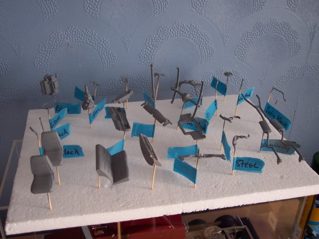

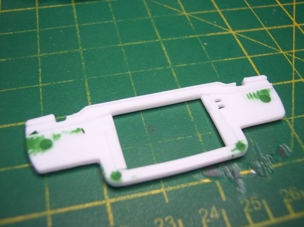

GeeBee Posted March 30, 2012 Author Posted March 30, 2012 Not a great deal done today, found some more ejector pin marks, seems a lot of parts have them, got the rear axle and prop' shaft sorted, added the springs to the axle, but I will leave it off the chassis until both parts have been painted, got the plug holes drilled, this will be the first engine I have wired, so I have a bit to learn ... Sorted a few parts and labelled them, so there ready for primer and then their correct colours ...

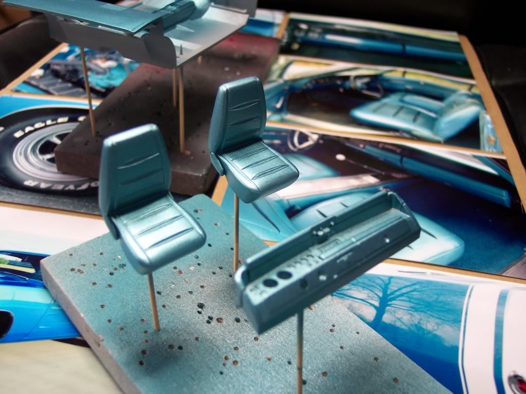

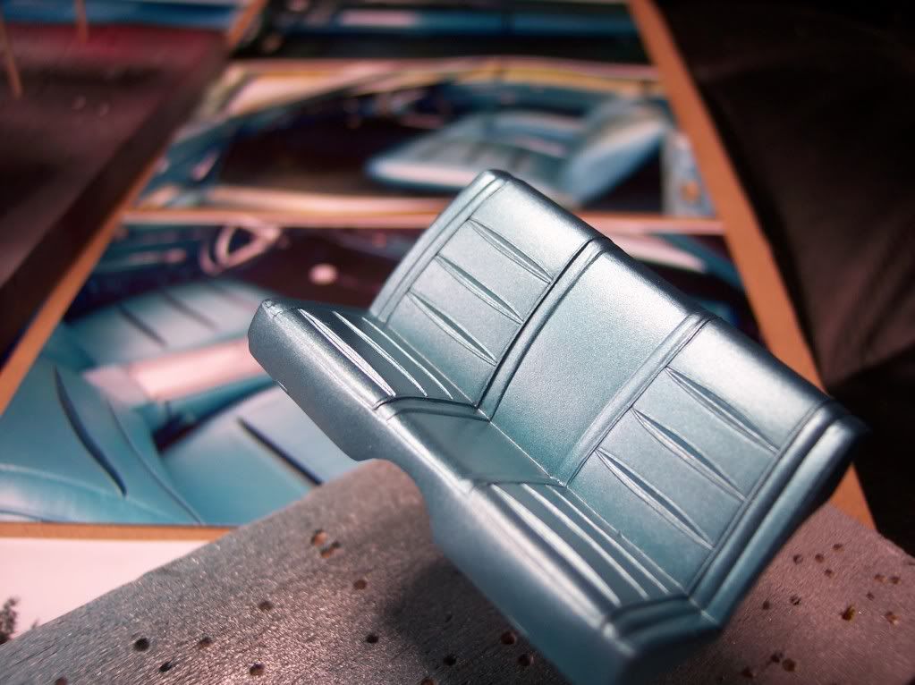

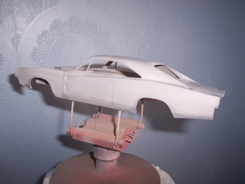

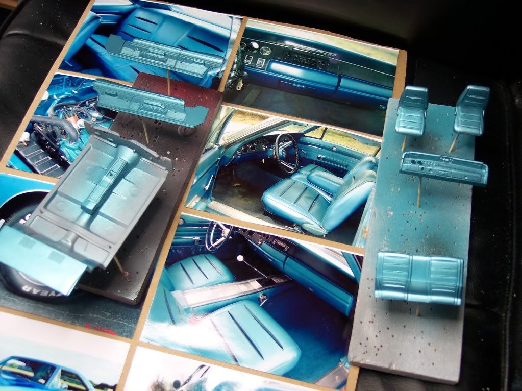

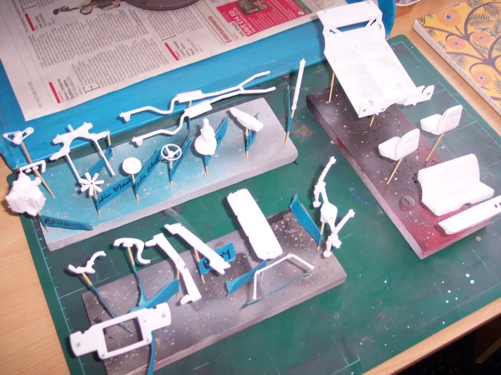

GeeBee Posted March 31, 2012 Author Posted March 31, 2012 I've never done as much custom paint mixing as I am having to do on this build, but I like things to be as realistic as possible, working on the photo's I have, I mixed up the paint for the interior, this is the main colour, and will need masking off for the contrasting colours, I used Tamiya metallic blue and aluminium, thinned with lacquer thinners, looks good enough for me .... Also worked on the body and some of the smaller parts, got them into primer, the body will get another coat of primer, this time it will be white, as the top coat is going to be light blue metallic

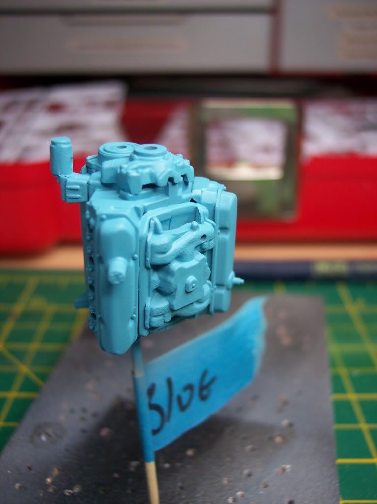

GeeBee Posted March 31, 2012 Author Posted March 31, 2012 Also got a coat of paint on the engine ....
