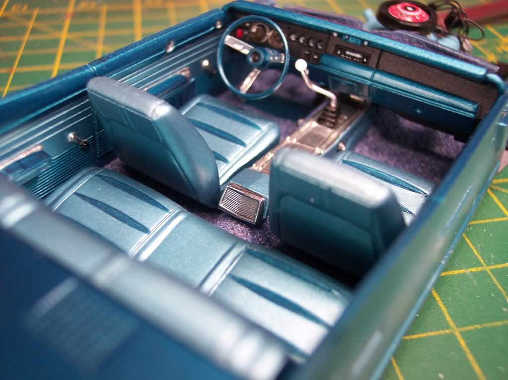

bryan_m Posted April 29, 2012 Posted April 29, 2012 wow! this is one beautiful build geoff, i like how you did the contrast color on the seats, that really made a big difference. the paint is incredible, and if this was your first time wiring an engine, you did one helluva job!! what a great build, keep it going, i wanna see more.... cheers! bryan m

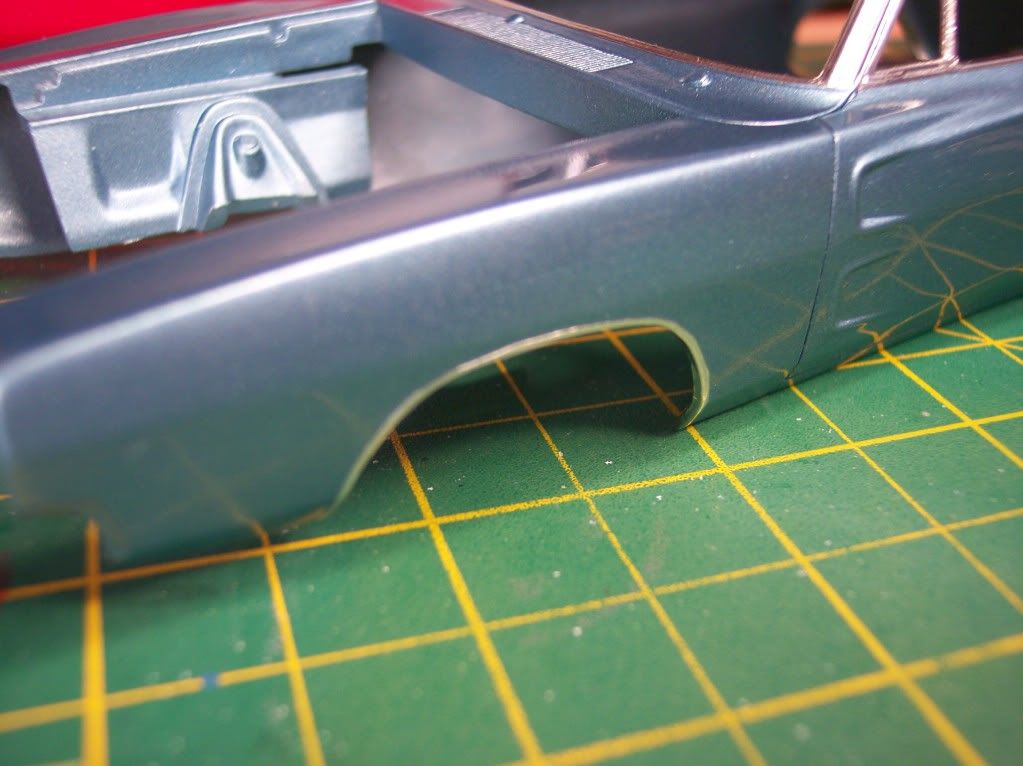

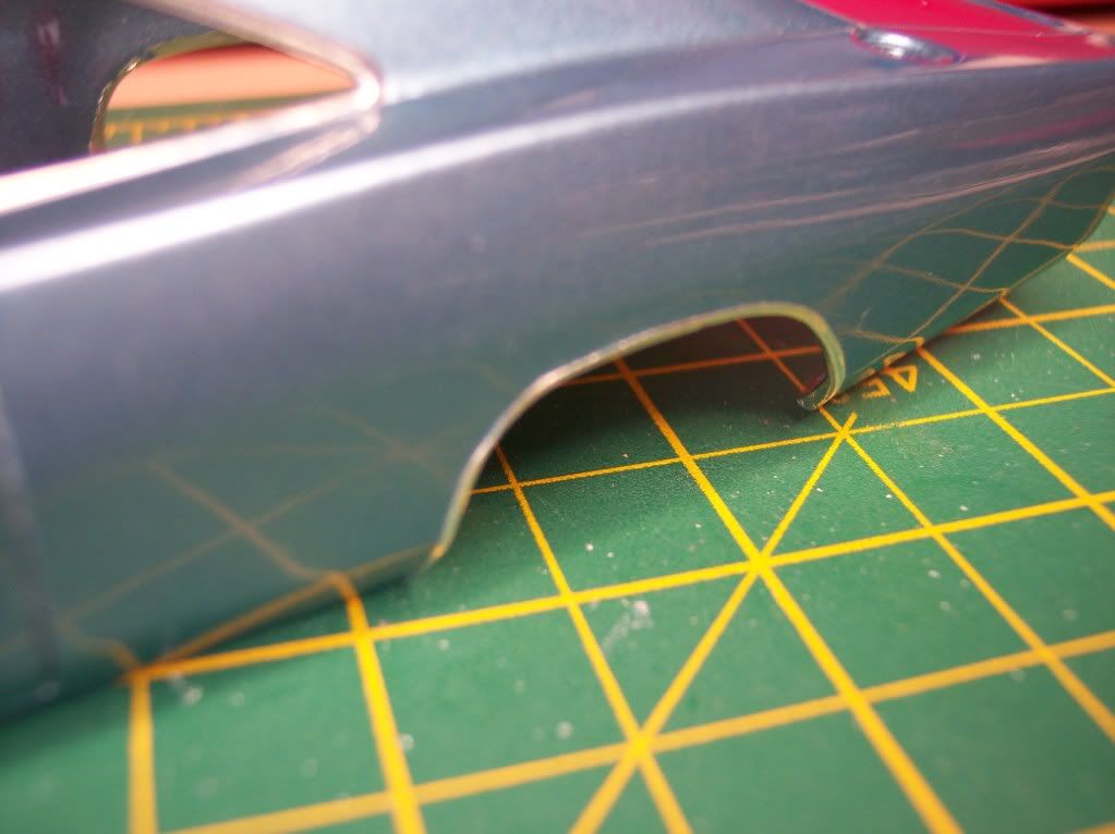

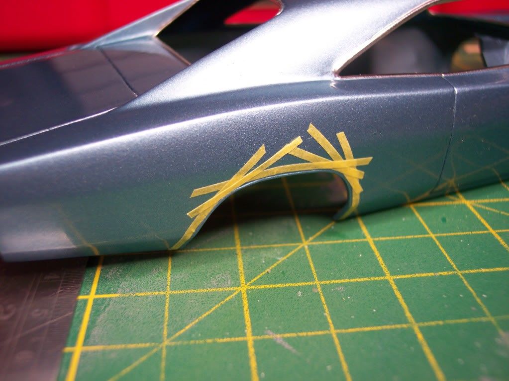

GeeBee Posted April 29, 2012 Author Posted April 29, 2012 Your doing are great job mate, I wish I could get my BMF to like yours does Wheel arches are a bit tricky to get the line nice and clean, but here's a little trick I do, run a line of masking tape around the edge of the wheelarch, and then you have a hard edge to cut to, and it also stops the blade going off line, put the tape on, put on the BMF, trim, following the line of the masking tape, and then remove the excess BMF and the masking tape, and you end up with a nice clean line .... If you use thinner masking tape, you can do it in one piece, instead of using numerous pieces of thicker tape
bryan_m Posted April 29, 2012 Posted April 29, 2012 nice trick for BMF, ill have to try that next time...... you did a great job wiring/plumbing that engine geoff, very nice work. cheers bryan

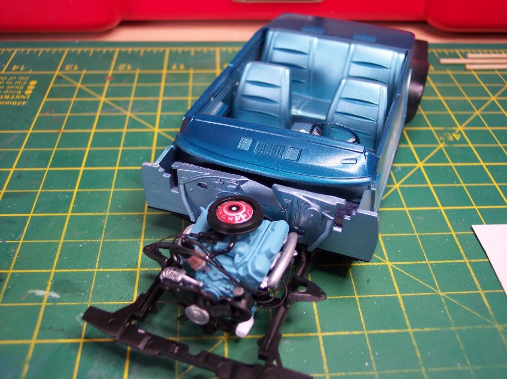

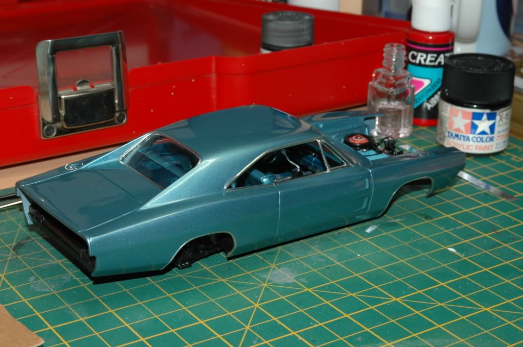

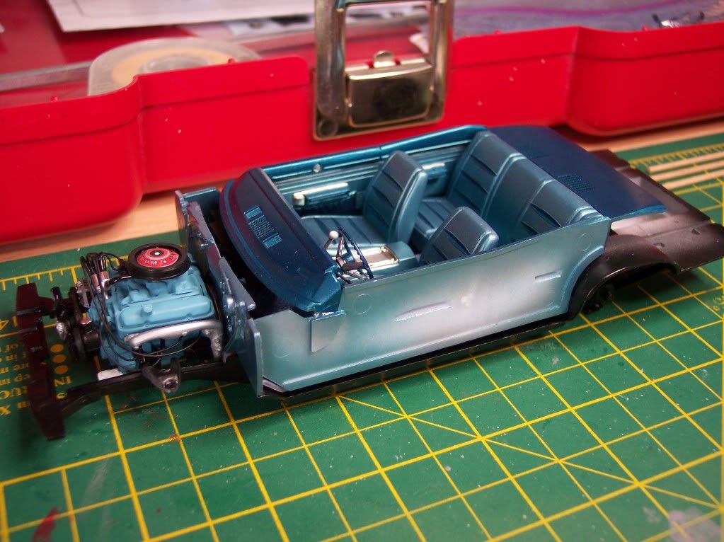

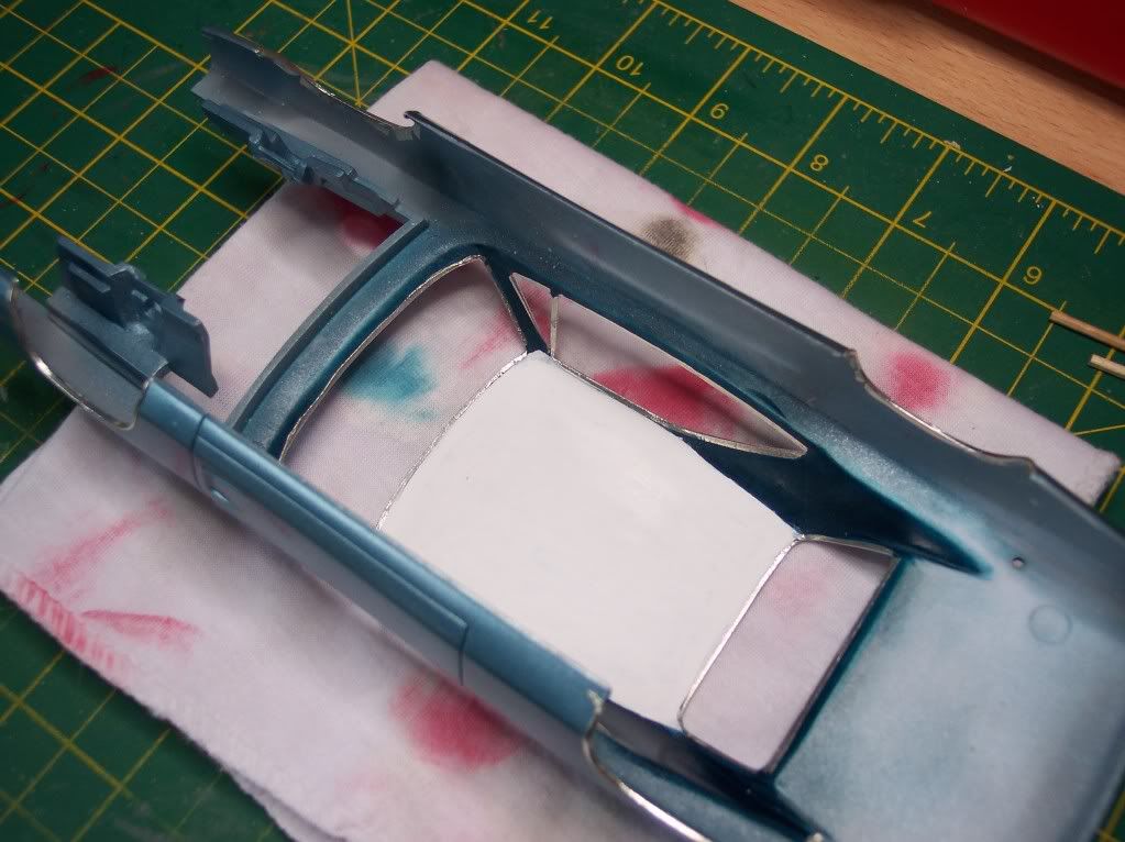

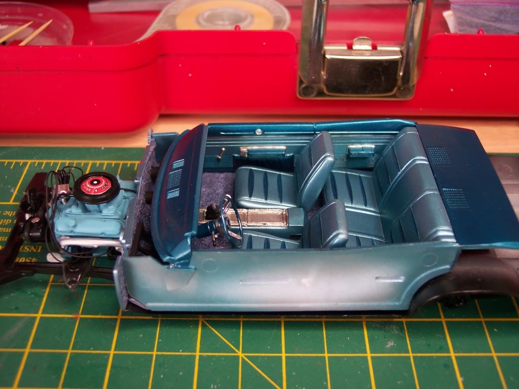

GeeBee Posted April 30, 2012 Author Posted April 30, 2012 Got the BMF finished this morning, also fitted the interior tub onto the chassis, painted the roof lining and the C pillar trims, the interior dome light and the windows will be fitted when the order containing the clear epoxy resin arrives, hopefully in the next day or so ....

GeeBee Posted May 2, 2012 Author Posted May 2, 2012 Hopefully my order I put in the beginning of the week will arrive tommorow, I need some clear epoxy glue to fix in the windows, so I can't go any further without it, but I did notice something that I hadn't fixed into place, I'm not sure what it is, but it has to fit at the end of the centre console, again, it was stripped of it's chrome, and done using chrome Alclad ..

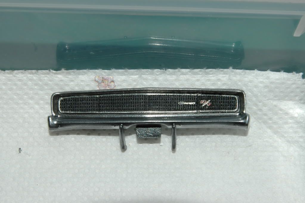

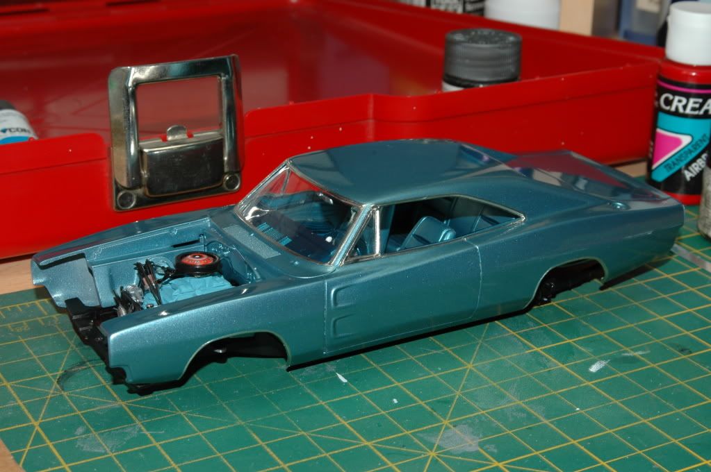

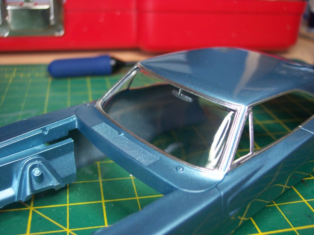

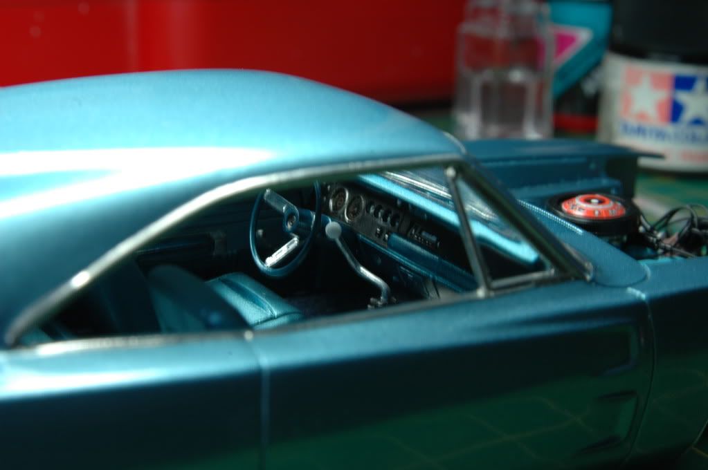

GeeBee Posted May 11, 2012 Author Posted May 11, 2012 A few days ago, the clear epoxy resin I ordered arrived, so today the windows went in, also got the finish the front grille, the small chrome trim was done using chrome BMF, a very tricky job, but well worth it, the body got fixed onto the chassis, I usually do a dry fit, but once it was on, it wasn't coming off, and it was so tight, it didn't need any glue to fix it ...
