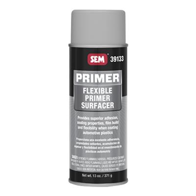

Ace-Garageguy Posted February 5, 2013 Posted February 5, 2013 Bodyshop supply stores also have a rattle-can gray flex-primer that MAY work on the seat material.
