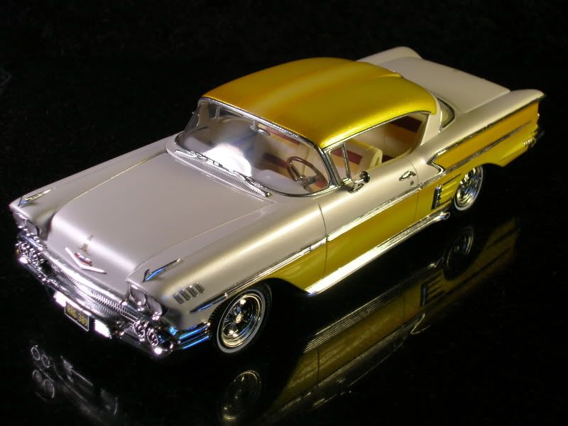

ZTony8 Posted April 4, 2012 Posted April 4, 2012 (edited) I have only used it once,over bare white plastic. Edited April 4, 2012 by ZTony8
