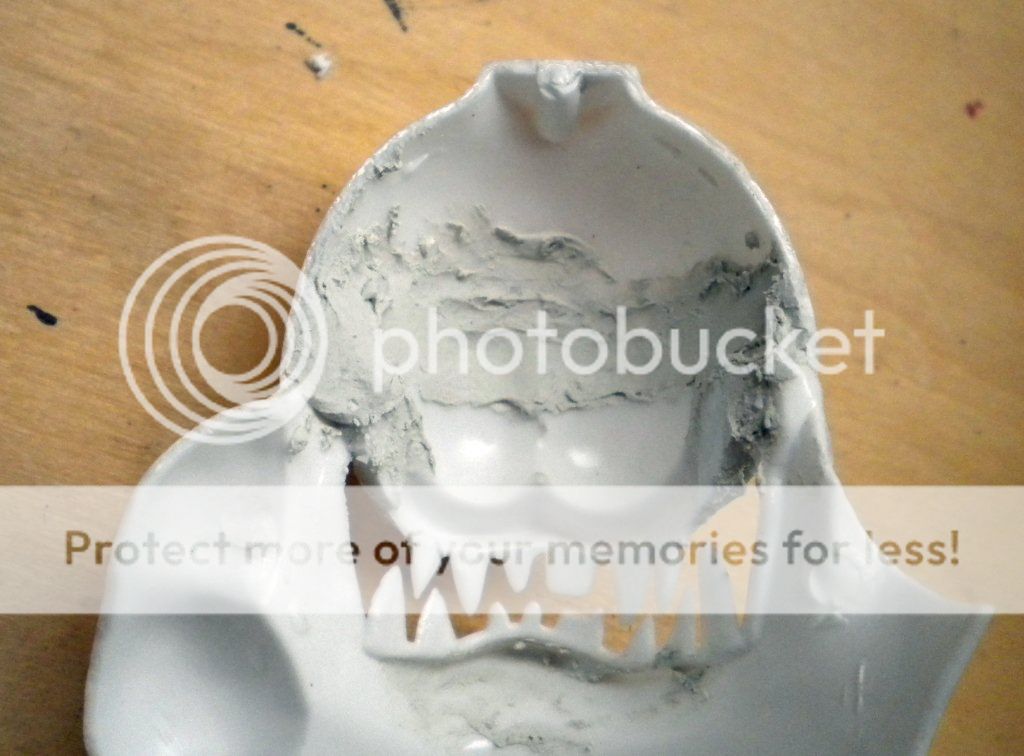

Ira Posted May 9, 2012 Author Posted May 9, 2012 (edited) FILLIN' FREDDY'S HEAD!!! I will be carving the Freddy's Helmet into the shape of Hair... So I am filling in the low areas in Freddy's Head with Squadren Putty! Edited May 9, 2012 by Ira

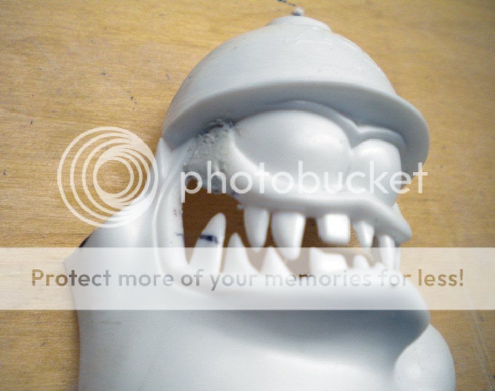

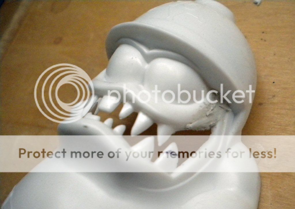

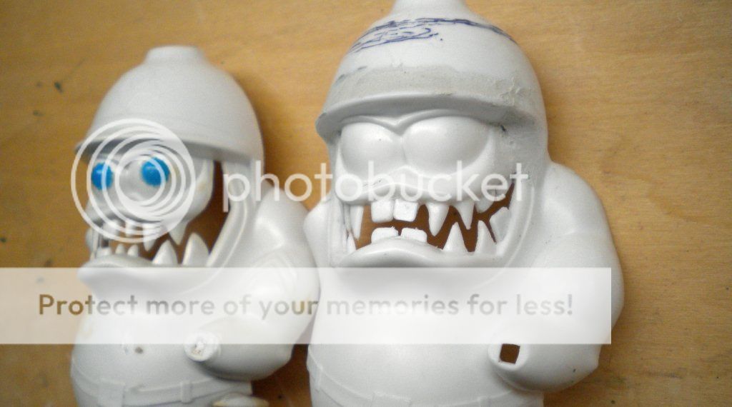

Ira Posted May 9, 2012 Author Posted May 9, 2012 FREDDY"S SMILE... I used small pieces of sheet plastic to fill the top points of his Smile. Then I filled the area in with Putty. That's about right! Next I need to work on Freddy's Teeth...

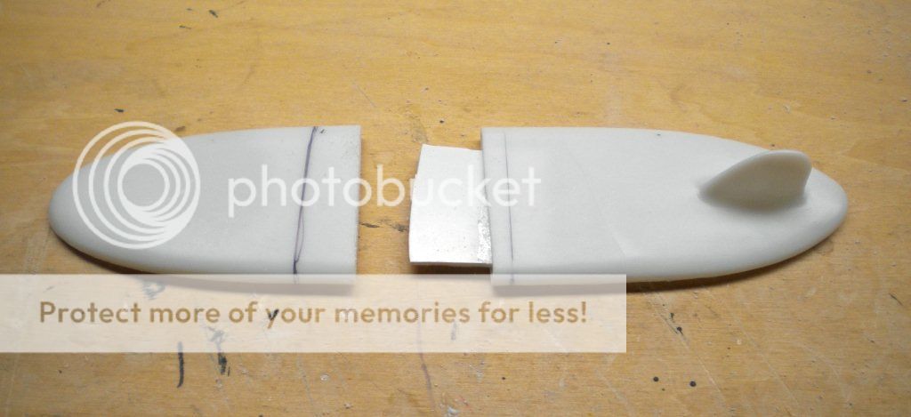

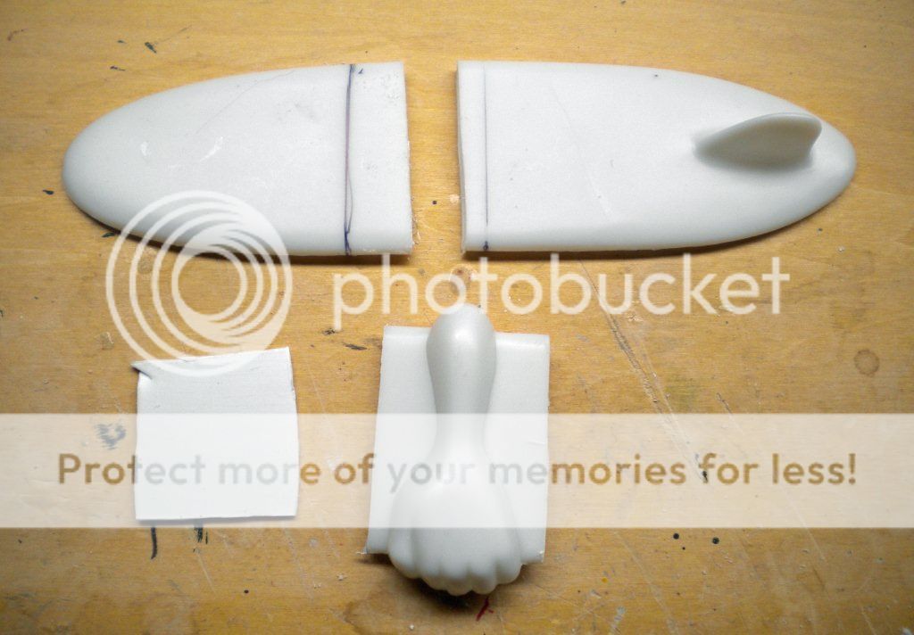

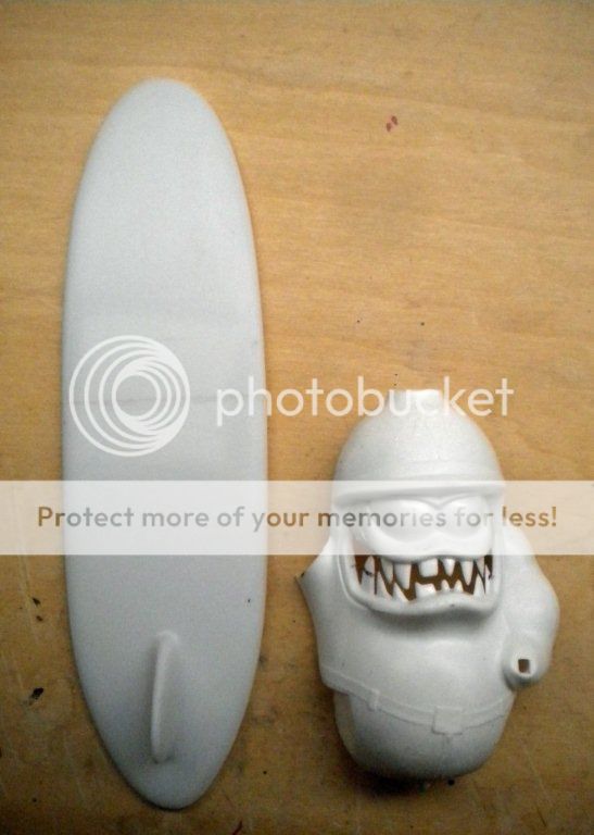

Ira Posted May 10, 2012 Author Posted May 10, 2012 NEW SURF BOARD For FREDDY!!! "Beach Bunny's" Arm didn't match up with Freddy very well so, I cut that section of the Board out. I cut a square piece of plastic to fit inside the Board for added Strength. I glued it inside then glued the Board back together. A little Putty & Sanding and Freddy has got a New Surf Board!

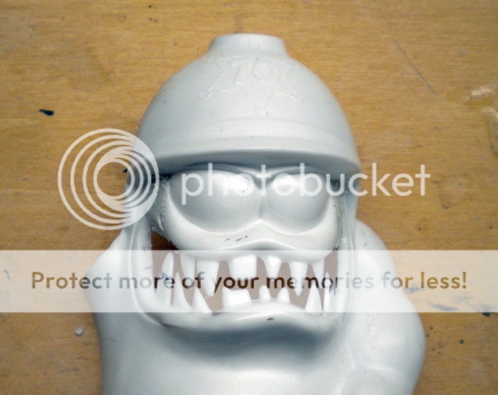

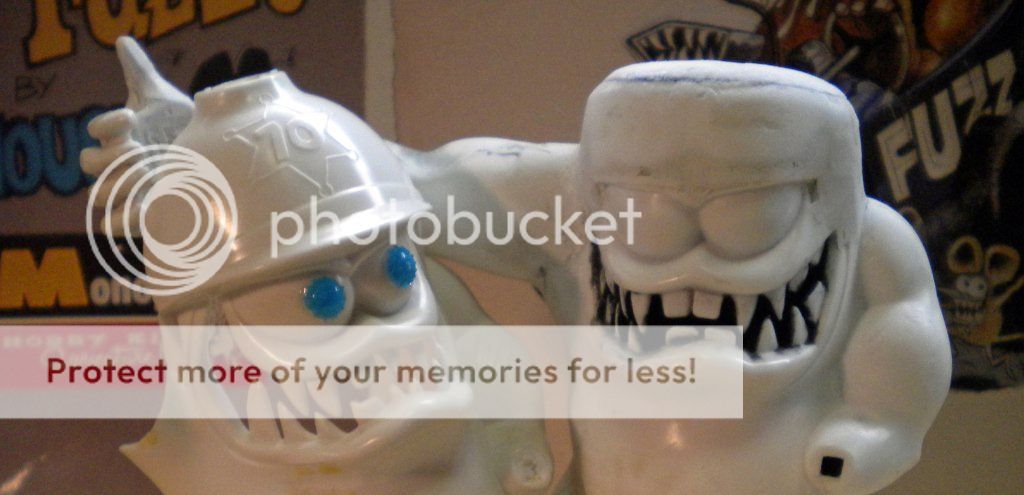

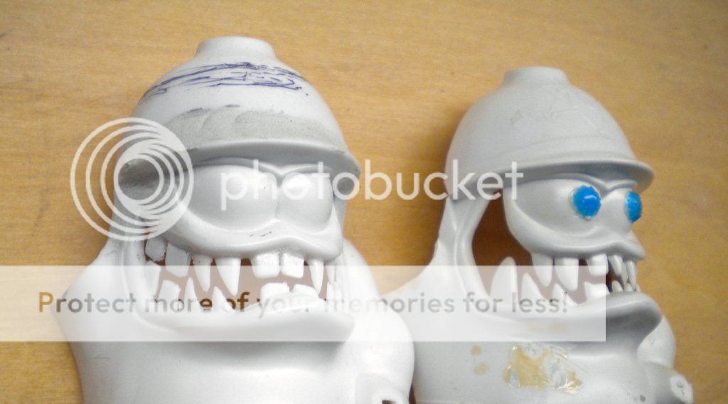

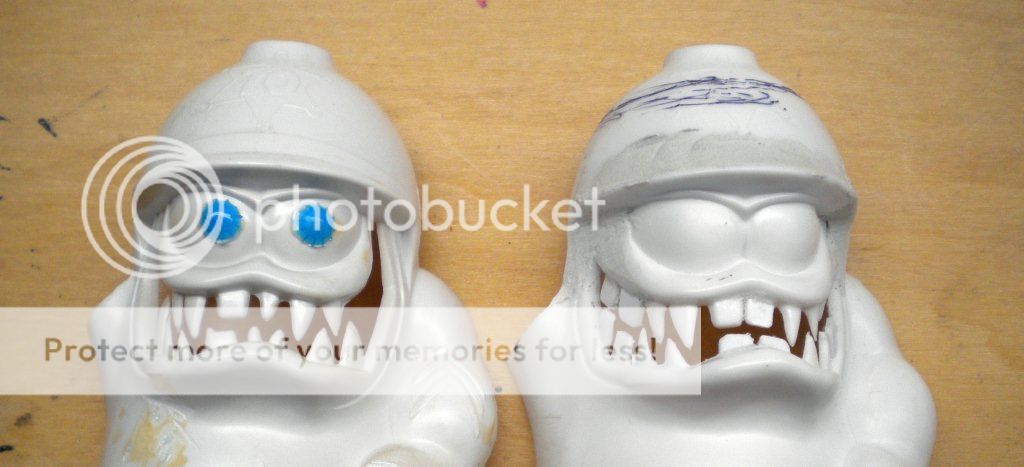

Ira Posted May 12, 2012 Author Posted May 12, 2012 FREDDY Gets More TEETH!!! Here are the Before & After Photos of FREDDY'S SMILE. FREDDY with the Blue Eyes is the Before FREDDY. I cut out the bad teeth and replaced them with small rectangles of Strip Plastic, cut to size & shape.

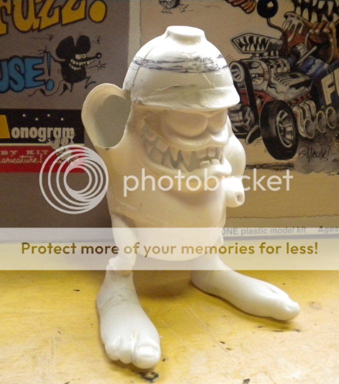

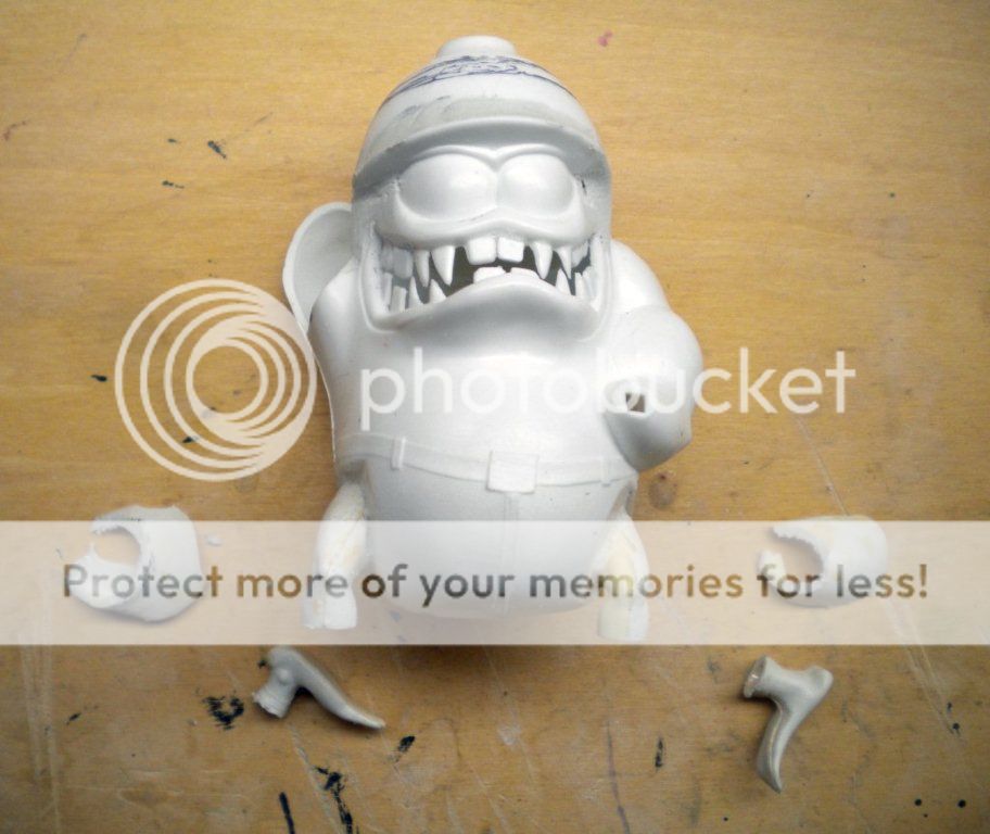

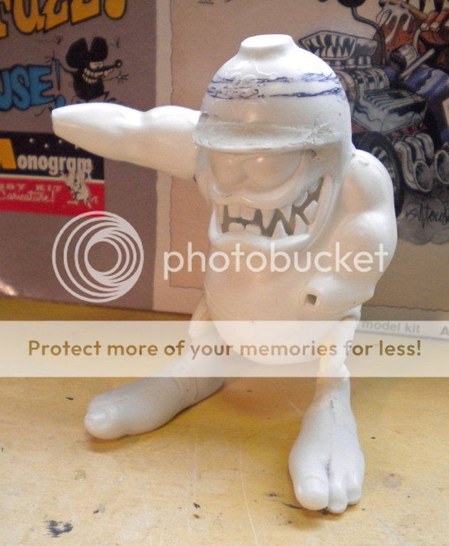

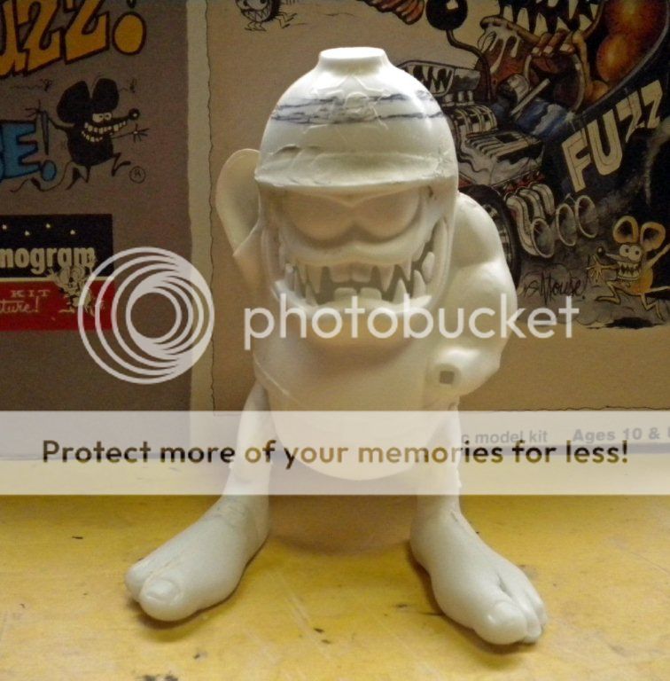

Ira Posted May 13, 2012 Author Posted May 13, 2012 Getting FREDDY Back On His FEET Again!!! The original "Super Fuzz" FREDDY sits down, so I needed to modify His Hips to fit the Standing Position Better. I also cut off His Shoes so that we can attach Him to His New Feet! After some Cutting & Fitting I glued FREDDY'S Right Foot in place. Then I glued His Left Foot in place with Zap-A-Gap Green Label Glue. FREDDY is Standing on His Own! Now lets see if He can Surf!!!

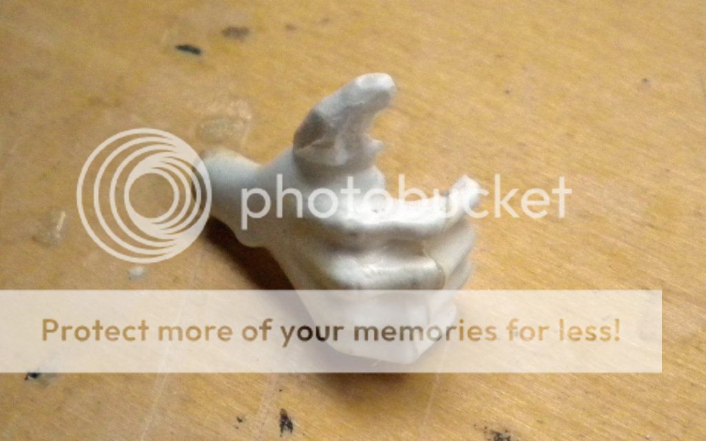

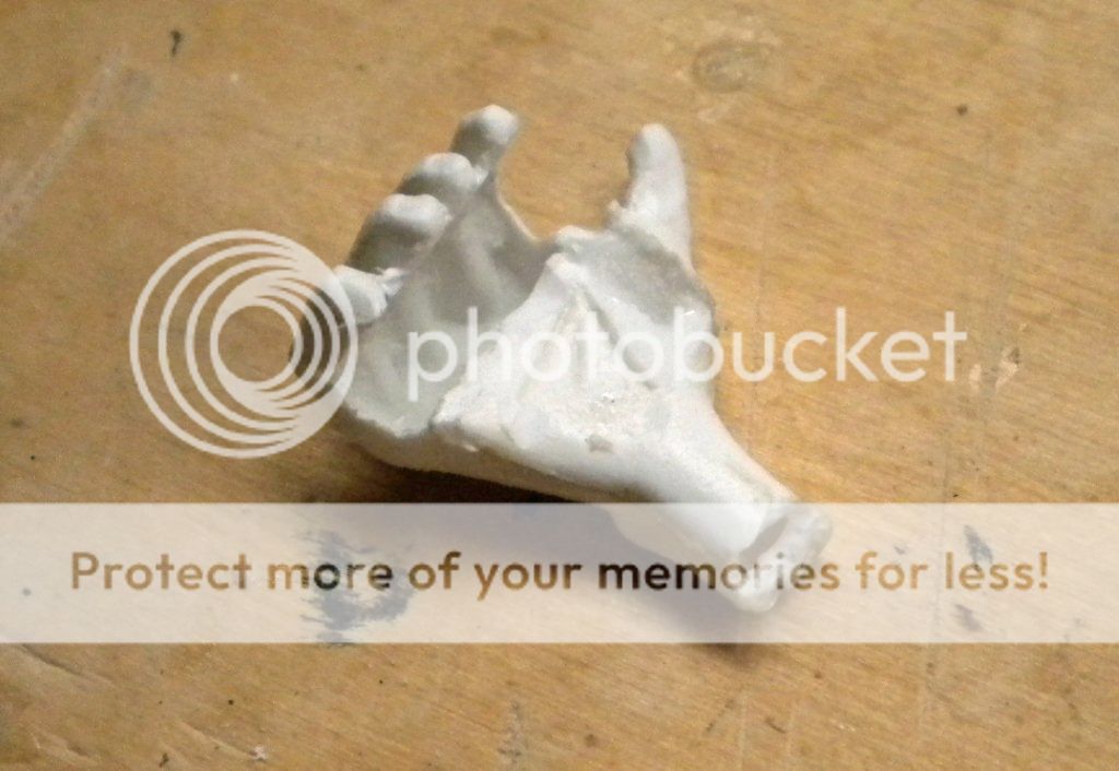

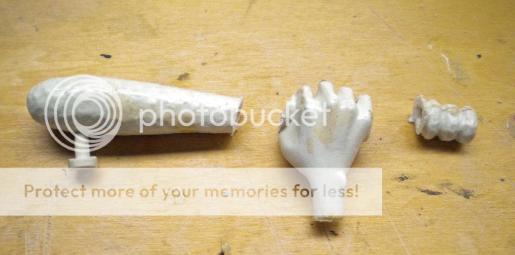

Ira Posted May 13, 2012 Author Posted May 13, 2012 (edited) DROP THAT CLUB FREDDY!!! I glued FREDDY"S Hand together and then Cut off the Club. I also Cut off His Thumb so I could reposition it. I used a Dremel Tool to carve the Club from the palm of His Hand. I carved the Thumb down a bit, then I glued it back in the New Position. Now lets try that grip on a Surf Board!!! Edited May 13, 2012 by Ira

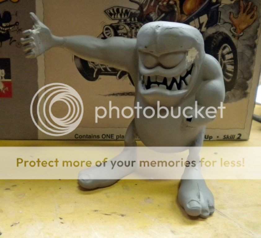

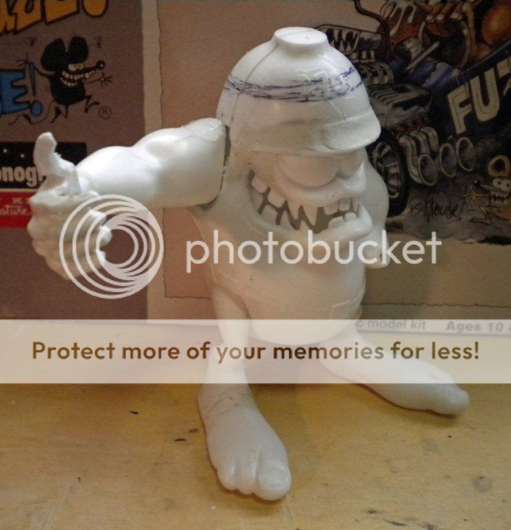

Ira Posted May 14, 2012 Author Posted May 14, 2012 FREDDY Gets A BiG Thumbs Up!!! After a little bit of carving I got Freddy's right arm to fit almost horizontally,now he can hold his Surf Board! Next I glued his hand in place. Looks like Freddy might be trying to get a Ride....

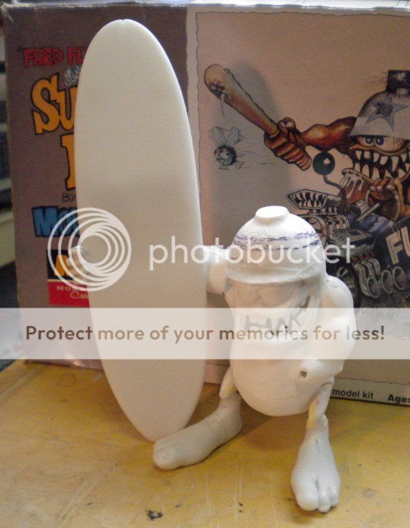

Ira Posted May 14, 2012 Author Posted May 14, 2012 GRABBIN' The BOARD!!! It's a Perfect fit! Freddy got a New Surf Board, just his size....
Dr. Cranky Posted May 14, 2012 Posted May 14, 2012 Yes, I say I like that size board better. Good work, Ira. It's coming along swell.

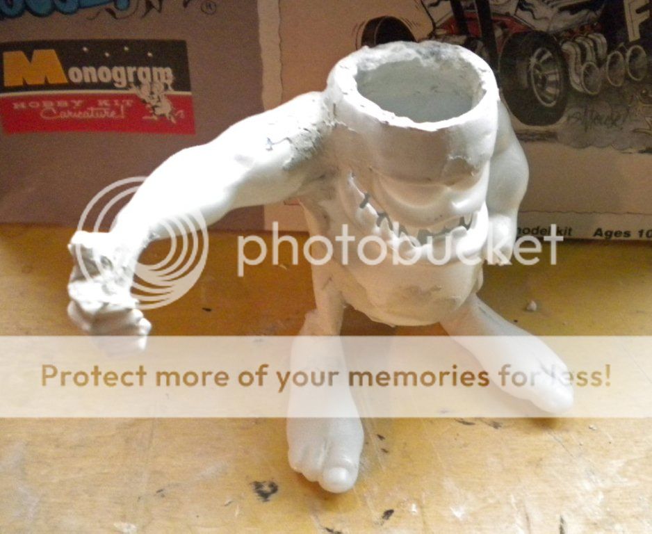

Ira Posted May 15, 2012 Author Posted May 15, 2012 (edited) CALLING DR. FRANKENSTIEN!!! I cut off the top of Freddy's Helmet, and there was nothing inside! We need a Brain.... I carved away most of Freddy's Helmet, and in some places I also carved through His Helmet in to the putty, lining His Head. Be careful not to use TOO MUCH of that Squadren Putty or it can melt the Plastic! I used just enough to "soften" His Head so that I could squeeze it down smaller around the top. Here is Freddy Before & After.... I added a piece of plastic to close the top of His Head, added putty and carved some more. Here is Freddy Flip Out in Primer!!! Edited May 15, 2012 by Ira
Dr. Cranky Posted May 15, 2012 Posted May 15, 2012 Looking good, Ira . . . I think that smile is really really growing on me!

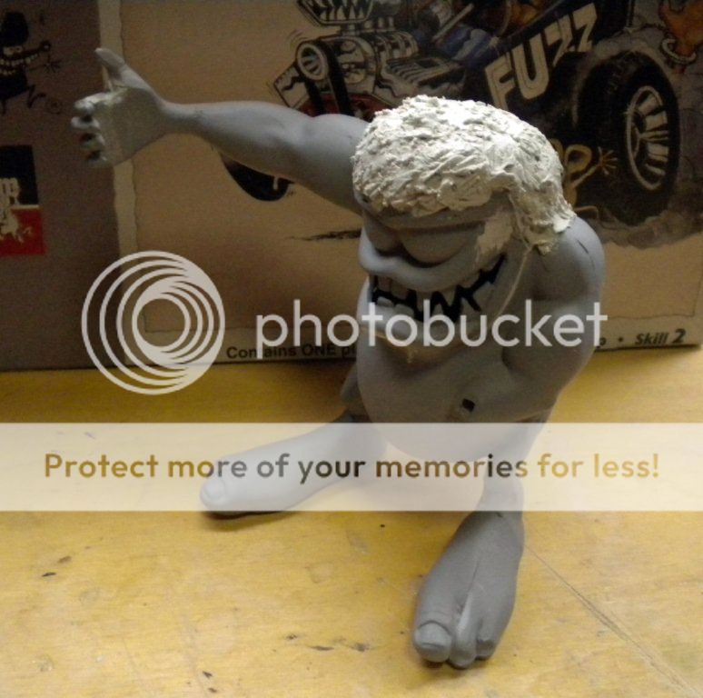

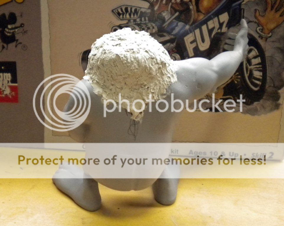

Ira Posted May 16, 2012 Author Posted May 16, 2012 FREDDY'S Back And He's Got HAIR!!! Squadren Putty was used to build up Freddy's Hair. I Shaped & Styled Freddy's Hair with a Putty Knife, X-Acto Knife and Toothpicks. Oops, I Sanded off Freddy's Pants! That's OK I am going to fit him with some New Low-Riding Cut-Offs later!
crazyjim Posted May 16, 2012 Posted May 16, 2012 Looking good, Ira. Maybe I need to try some Squadron putty on top of my head?
cobraman Posted May 16, 2012 Posted May 16, 2012 is that a butt crack I see ? I never get tired of seeing your creations, you have quite the imagination.
