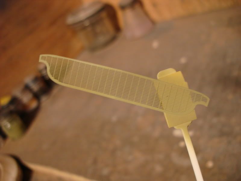

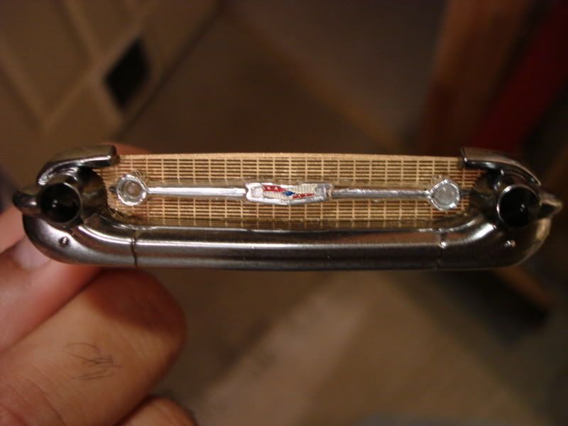

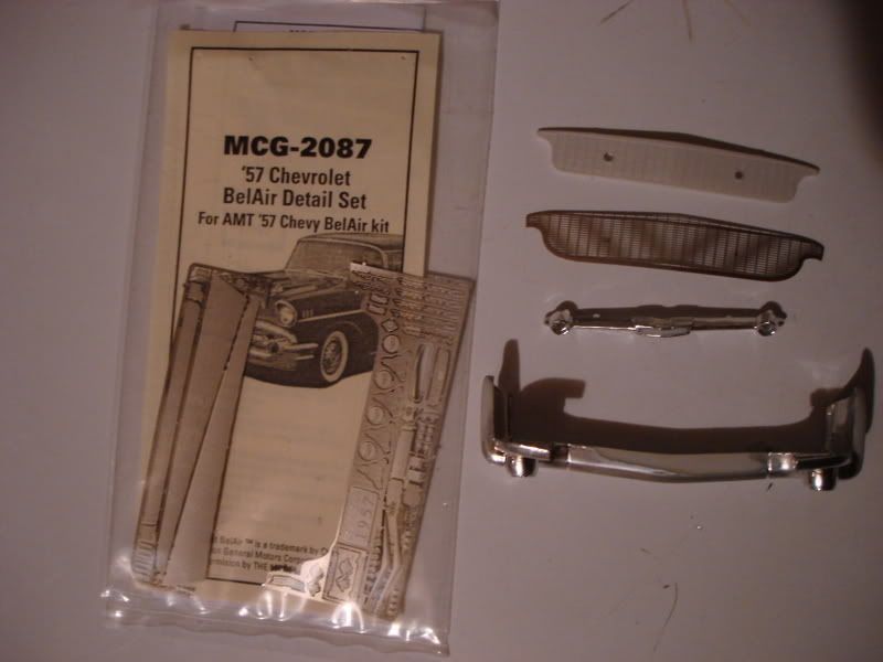

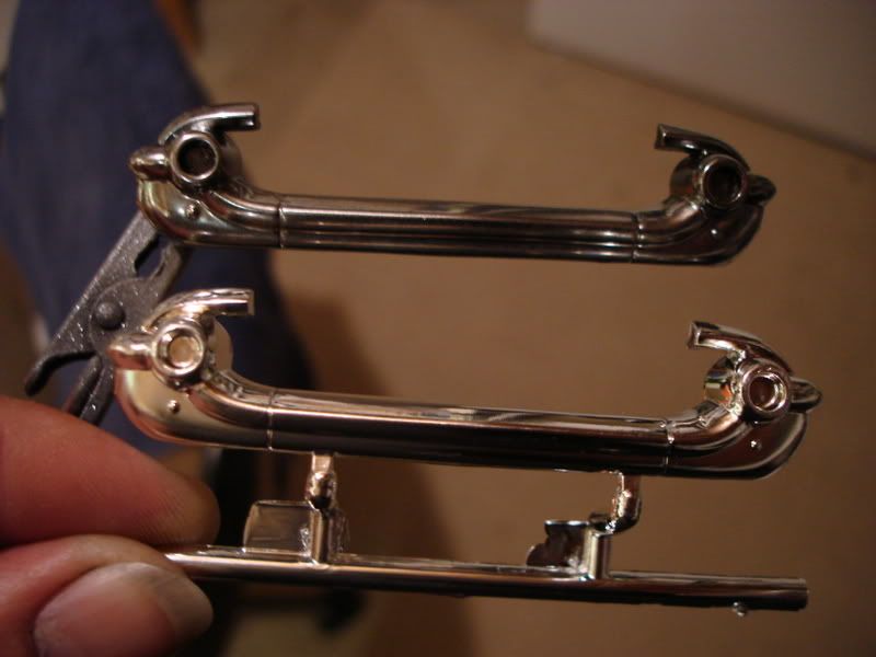

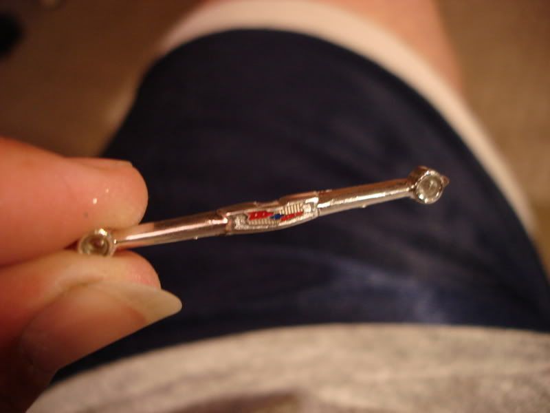

cruz Posted July 10, 2007 Author Posted July 10, 2007 Started with the 57 Chevy detail set, will be painting the grill in gold............Also will be Alclading the bumper.
cruz Posted July 10, 2007 Author Posted July 10, 2007 I will be using this primer to paint my Photo-etch grill and other parts............

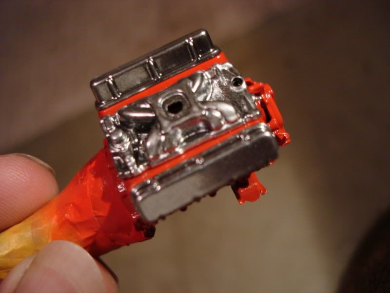

cruz Posted July 11, 2007 Author Posted July 11, 2007 Here is a bit more progress on my 57. Painted the engine block chevy orange, Alcladed valve covers chrome and the manifold aluminum with Alclad also.............I will be painting the transmission later.

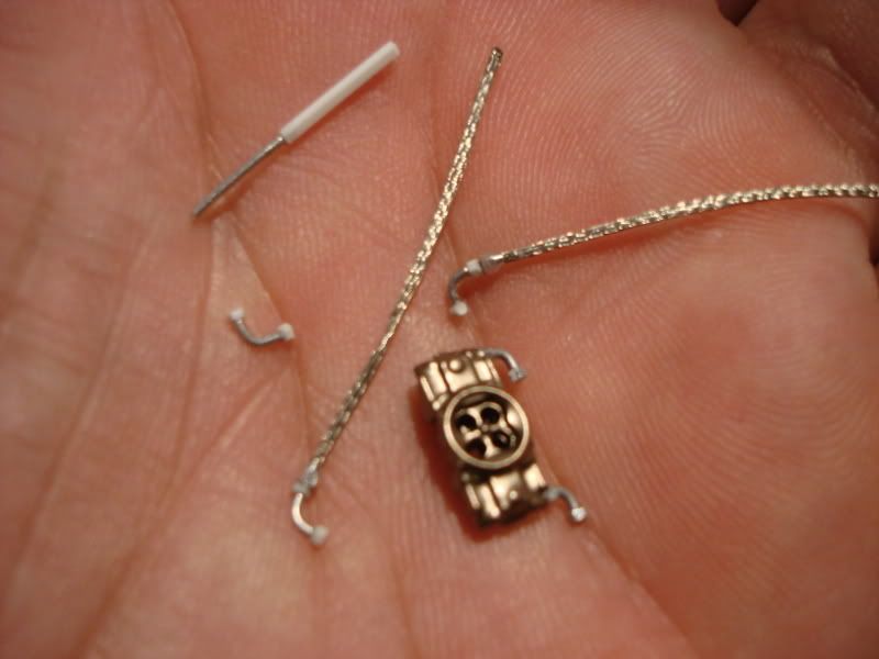

cruz Posted July 11, 2007 Author Posted July 11, 2007 I will be plumbing the carburetor with some Detail Master connectors and Plastruct .040"/1.0mm Styrene pen rod cut into small sections and connected to fitting lines from Detail Master. The carburetor was Alcladed with Pale Burnt Metal and later it will be given a black wash and dry brushed with very little silver all over.
cruz Posted July 11, 2007 Author Posted July 11, 2007 This is more or less how it will look..........

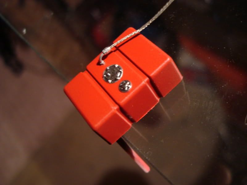

cruz Posted July 23, 2007 Author Posted July 23, 2007 A little bit more progress on the 57 Chevy, fuel cell for the trunk and feed for gas.........

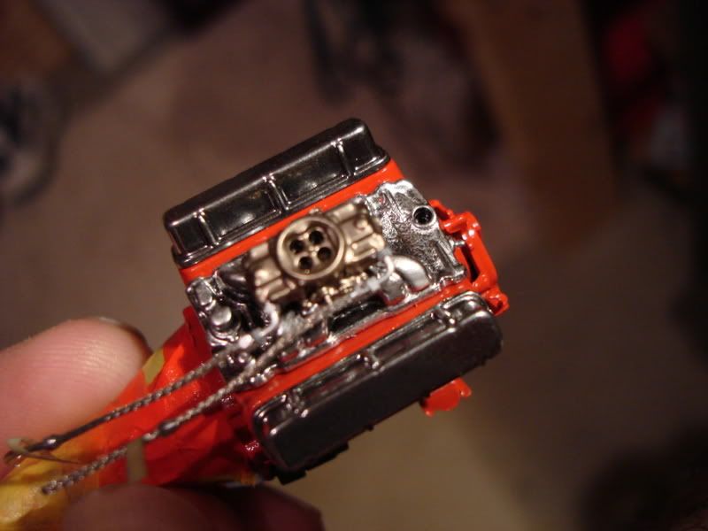

cruz Posted July 23, 2007 Author Posted July 23, 2007 Engine with distributor and wiring done.................
