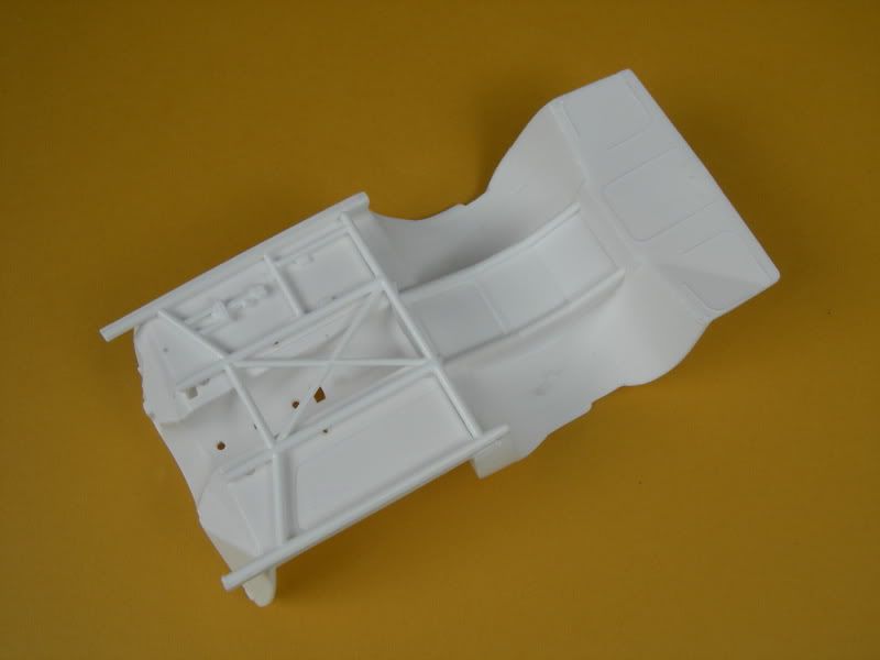

The central frame rail section turned out pretty well and mimics much of the Revell structure. I've added some structural tubing and seat mount tabs under the driver's seat area. Here’s a pic of what it looks like fitted to the bottom of the pan.

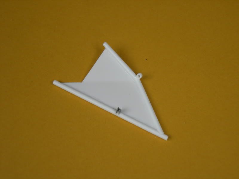

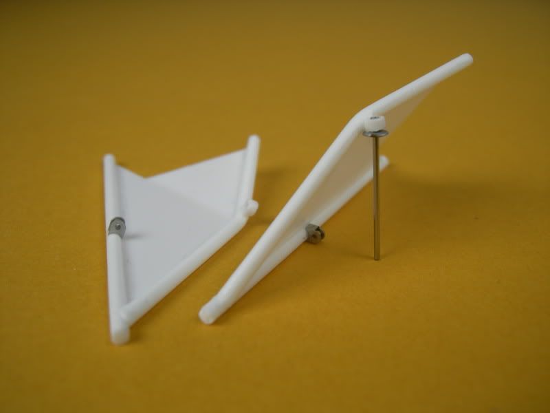

I made a bit of progress in getting some of the structural components prepped. I did successfully mold and cast both upper strut tube/tin work pieces and have drilled out the strut mount collar and have done some general cleanup on the tubing. Flash was pretty minimal, which is nice. I added some small alignment nubs to the outboard side of the lower rail so there is something to use as a guide when attaching the main lower control arm PE brackets. The nubs do have to be trimmed to allow for a tighter fit to the rail. This pic shows the passenger side lower bracket attached.
The driver side panel with the strut piston rod and sample upper mount inserted in the collar. I have PE upper strut mount gussets that will be added, both for strength and aesthetic detail. Pics of those will hopefully come soon, as will some lower PE control arm wishbones. They will tie both lower angles of control arm tubing together as well as offer a fool-proof connection to the bottom strut mount. If nothing else, you'll come to realize that I value solid mounting points when connecting fragile pieces together. LOL One of the trickiest parts of assembling the lower mounts was having them as close to perpendicular to the rail as possible, while also being on the same plane as the rail. I think I pulled that off reasonably well…
One of the many challenges in building and designing as I go, which is basically what's going on at this point, is that portions of the lower tin work will have to be removed for header clearance. I could probably remove some of it now, but I don't want to take out too much. Until I have more of the engine and motor plate assembled, I'm going to have to play it close to the vest. I'm actually toying with the idea of making some true tin work, i.e., PE panels that can be laid in over the top of these panels. IF that is the case, I may be able to remove the central portion of the resin "tin", leaving a perimeter flange, or maybe Dzus plate sized resin tabs. What is anybody's opinion of how that could be done?

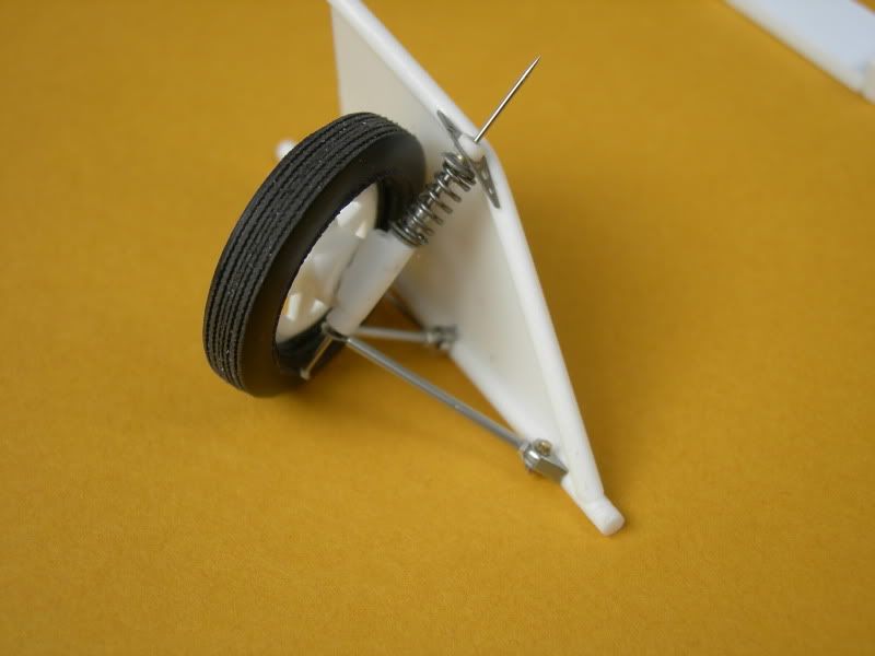

I made a bit of progress last night. I’ve got one side of the front suspension pieced together. The question, now, is whether I can match the driver’s side to the passenger side… LOL

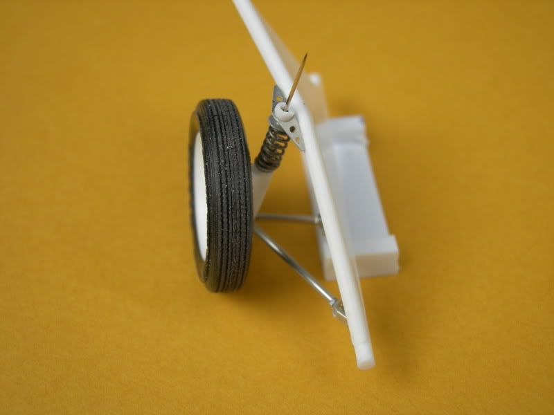

I am adjusting on the fly to get the front suspension pieces where I want them. Try as I might, the front tires currently set too far outboard to make them have a realistic placement.

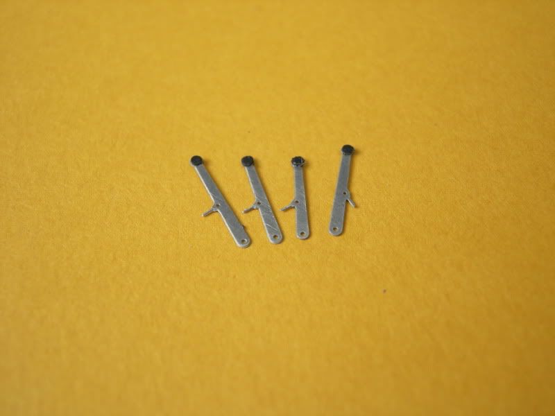

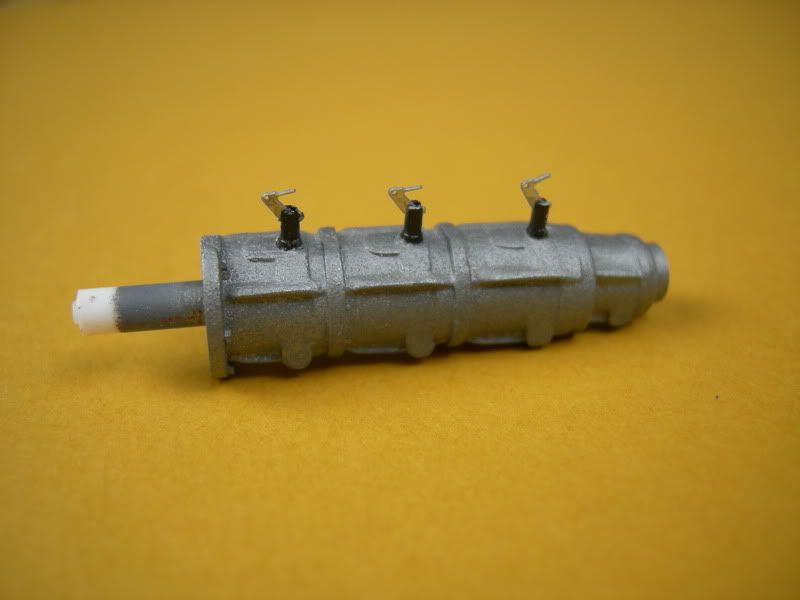

In the meantime, I am working on some sub-assemblies. I am using photo etch OEM-style Lenco hand levers. I drew them up them with very small alignment pins on both the detent levers and hand levers but am debating whether I want to remove the pins and add RB Motion rod ends and hardware. The pins make alignment pretty straight-forward, but the hardware detail would be cool too. I added the tiny .050" OD PE buttons to the grip portion of the hand levers to simulate the phenolic grips on the 1:1 levers.
Here is a profile of the Lenco trans with the detent levers attached. The small PE pins will bend, so I can adjust the angle as necessary when attaching the linkage tubes. I am planning to add mounting tabs and slide mount. Just haven’t gotten there yet.

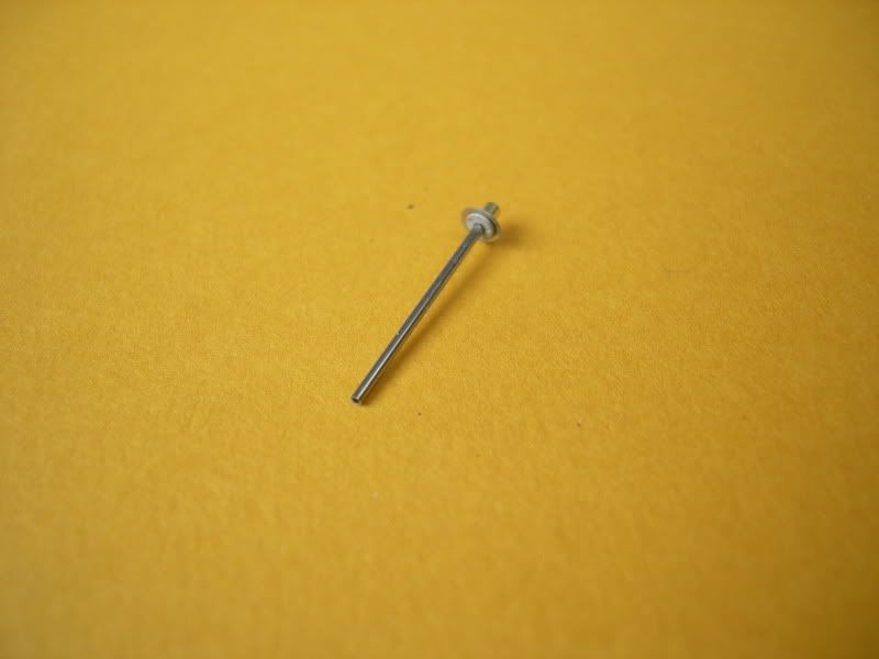

The struts consist of a stainless tube that simulates the piston rod. Attached to the upper end of it is the spring retainer and a small centering disc that attaches to the underside of the retainer.

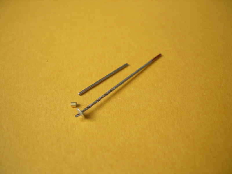

An .032” drill but is used to enlarge the holes in the retainer and centering disc so the piston rod will slide up through. The small sleeve slides over the stainless tube and attaches to the top of the retainer. The sleeve then will fit inside the collar/mount on the upper strut tube.

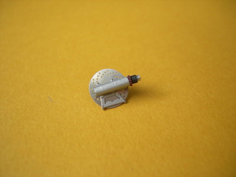

Here you can see some of the detail on the chassis-side of the strut. The body itself is resin with an .063” aluminum tube sleeve inside. PE steering arms and resin calipers have yet to be installed and the spring assembly added. I added RB Motion bolt heads to simulate hardware attaching the caliper brackets to the strut.
