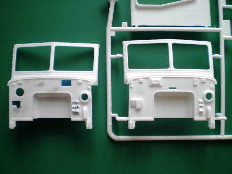

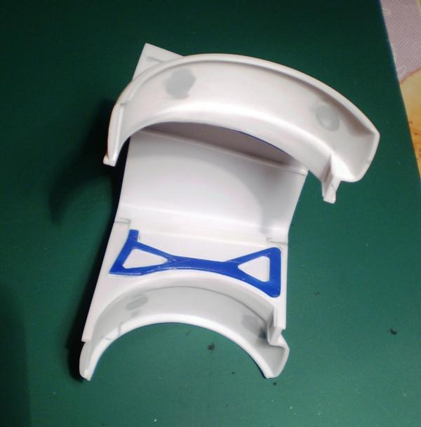

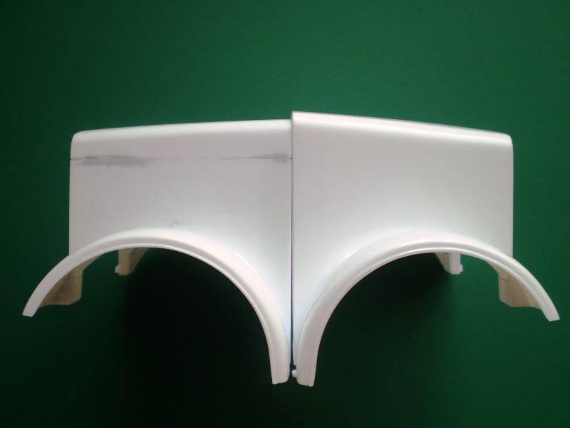

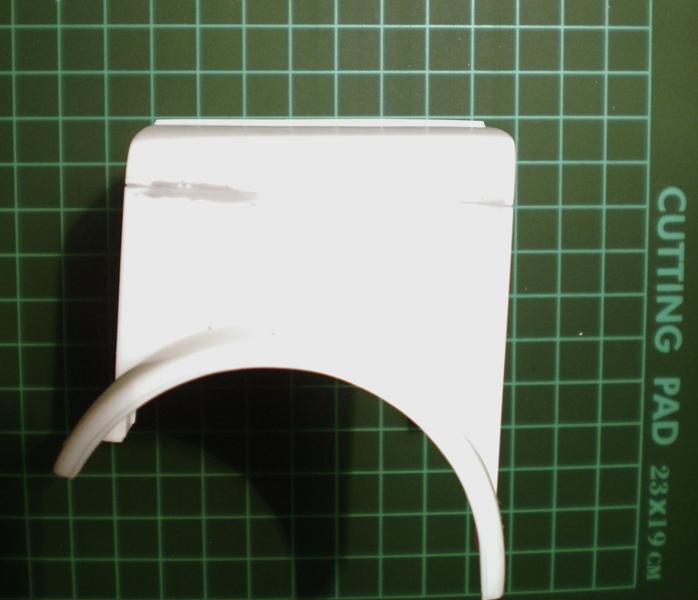

This is another project that I started. Even though it is the 378 by the box title and the parts included, I like the box art 379 better. And, since there´s a great tutorial on Tim Ahlborn´s web sites how to convert the 378 hood in the 119 BBC 379 hood, I followed the instructions and started the 379.
P7250275.thumb.jpg.3d9aab1c53861b28b783d

I also changed the firewall since some of the elements are mirror-inverted.

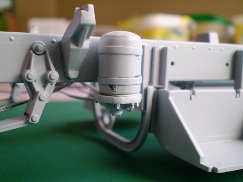

P7250267.thumb.jpg.363e7101832941298f4e7

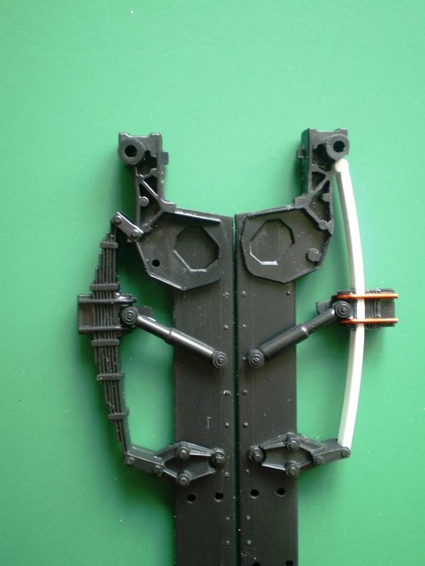

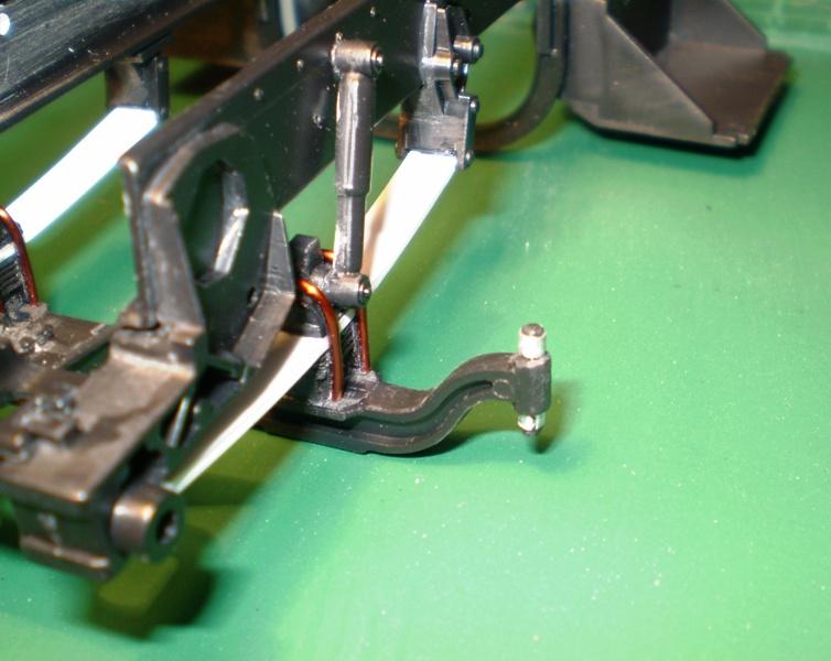

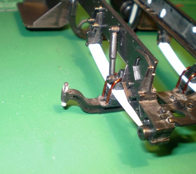

The front leaf springs of the kit are in a strange arrangement. I changed them to look more like the real deal. Two leafs on each side is enough for a highway tractor.
P7250270.thumb.jpg.967043791616ee0142c06

The kit springs are, well, strange. Nothing a highway spec 378 would have. I suspect that Italeri sliced up the 377's springs (which aren't right either) to make the short-stack springs the 378 has.
Tim
Better get rid of the tabs on those fuel tanks! ;)
Thanks for the reminder. I hope I won´t forget because the fuel tanks will be some of the last items I will put on the model.
looking good! what did you use for ubolts on the springs?
The U-bolts on my spring is nothing but 1mm copper wire bended around the spring centre-piece.

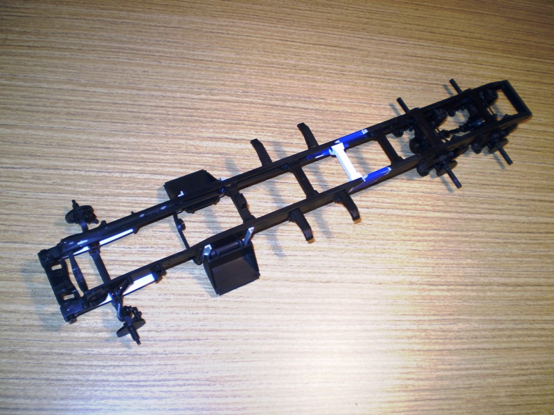

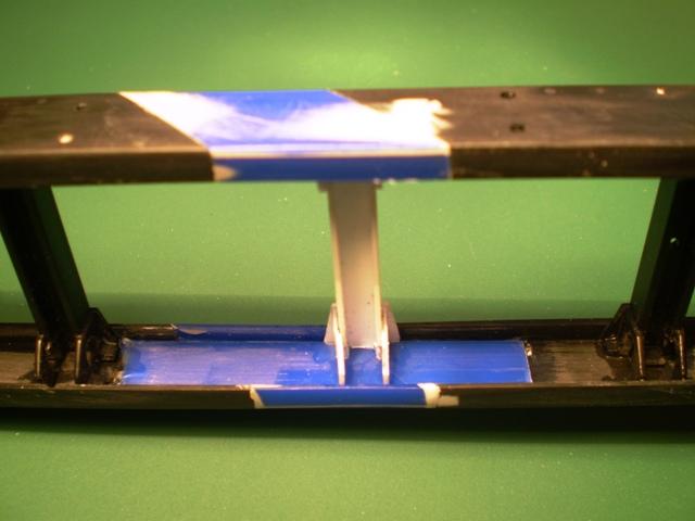

I extended the frame up to WB 270" to get a room for some equipment that I am going to use. With the extended frame I had to make one more cross member.

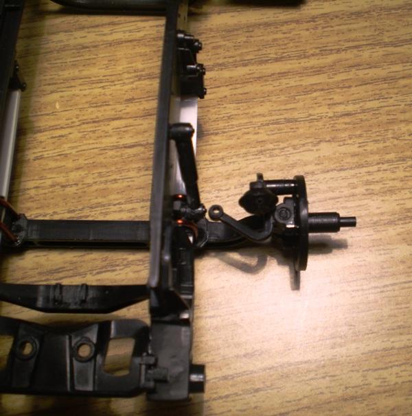

I want to keep the steering operable but it requires additiona thickness to the turning pins so that the joints were firm. So, I added a beer can stripes around the pins.
P8070302.thumb.jpg.4bfd3407cc67e4a324bea

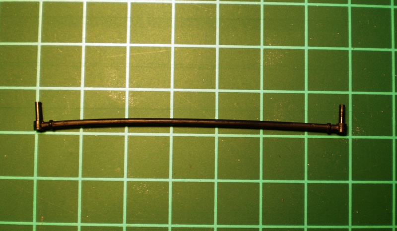

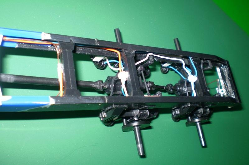

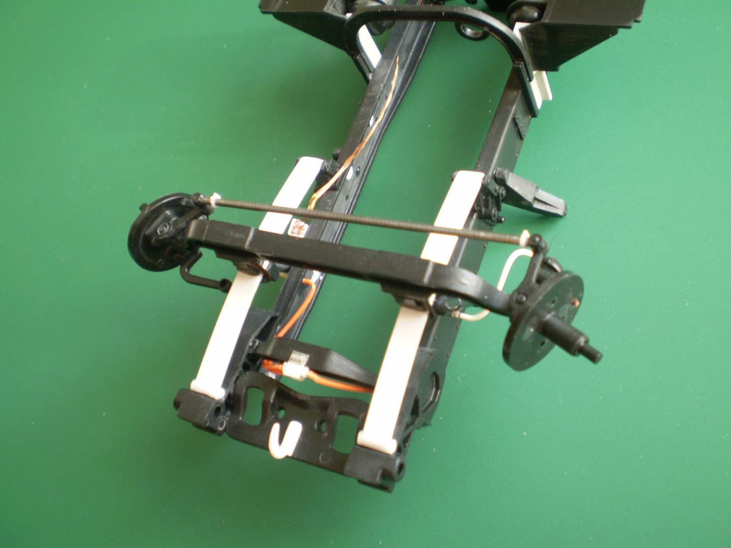

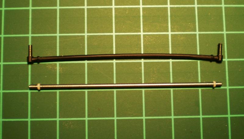

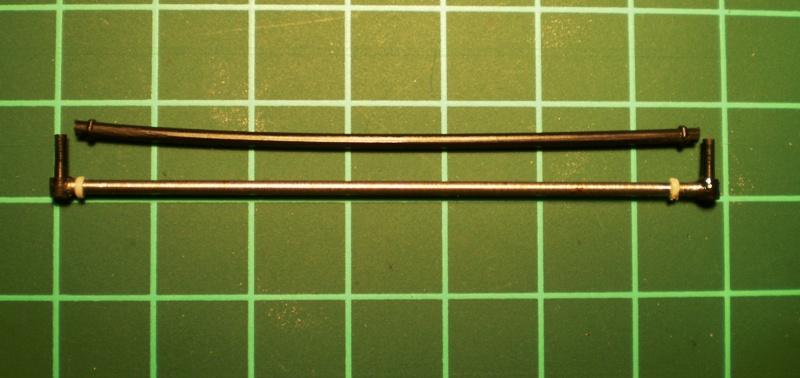

A little bit of progress on the frame. The tie rod in the kit is useless because it is very easy to bend. In fact, it was bended already whe I cut it off the sprue. I cut off the ends and superglued them to a 1,5mm steel wire cut to length of the tie rod.
P8230409.thumb.jpg.874b544babd5ec8fa8070

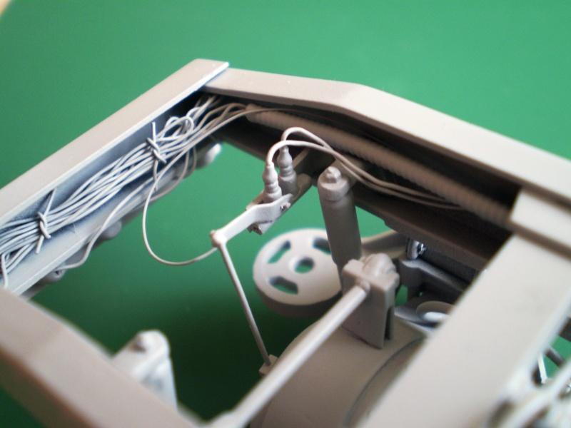

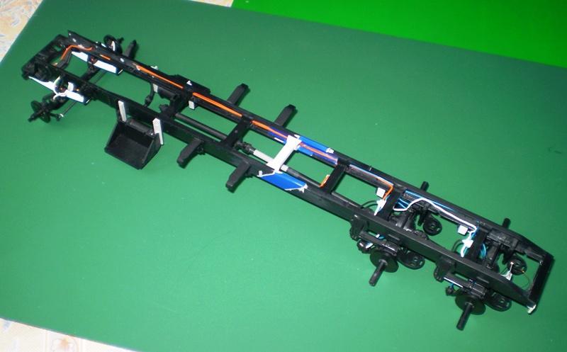

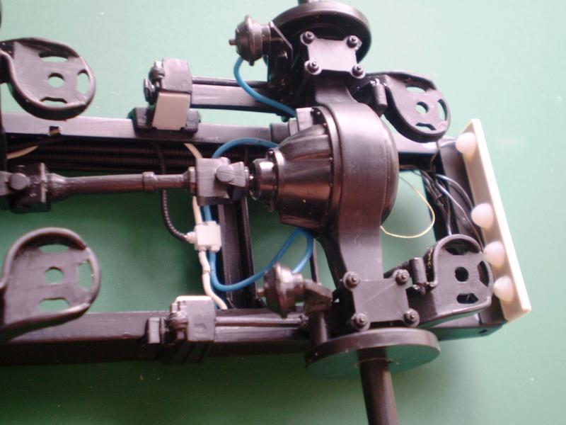

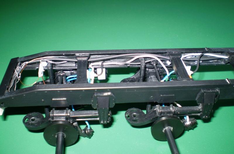

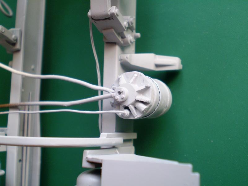

The tow hook on the previous picture is one of my added details. So is the quick release valve. I plumbed the frame using different wires and "simulated corrugted duct" by Tuner Model Manufactory.

The air springs will be painted separately. I will get them in place after the frame is painted too.

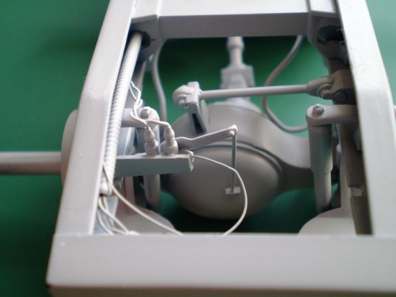

Jarda, I'm amazed at your wiring and plumbing work. I thought of doing it to my own 379, I drilled holes in the brake air chambers, in the air tanks... And just let go, I don't know where to route all these wires! Thanks to your pictures, they are going to help a lot. I have seen some diagrams for air brakes on the net, but I don't get it. It's surely not that difficult. Anyway, I'm going to take a movie and tons of pictures of real trucks for next time I build. Thanks for your "in progress" pictures man! I like your front axle tie rod! Nice work.
Thanks a lot Robert. I have also seen some diagrams. But still it is hard to tell the routing of the lines and where all the valves, relays, crossings and fittings are located on a real truck. Plus, I think it varies from truck to truck. A great help for me is the truckpaper and pictures that you can find there. Sometimes it is only an overall look of the truck. But then you can find a whole set of pics showing interesting details of the frame, engine, interior and such. My plumbing usually does not follow any particular diagram. I just try not to make anything non-sensical. Most of my wires come out from semewhere... and end up nowhere. But it´s okay if it´s hidden somewhere inside the structure.

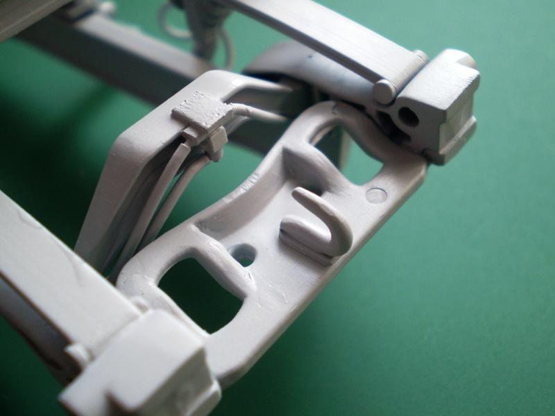

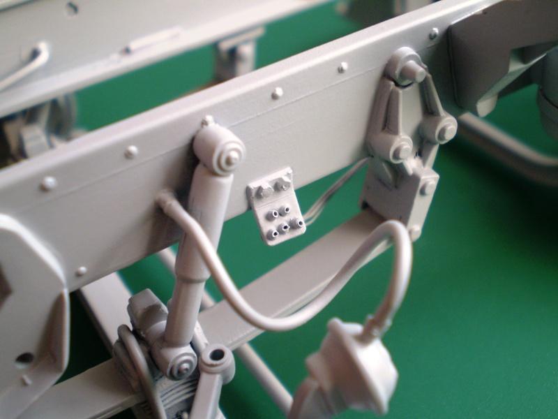

Now with the frame in primer I could take a bit better pictures of the details that I added. Details like tow hook, front quick release valve, remote lube, height control valve, and air dryer.

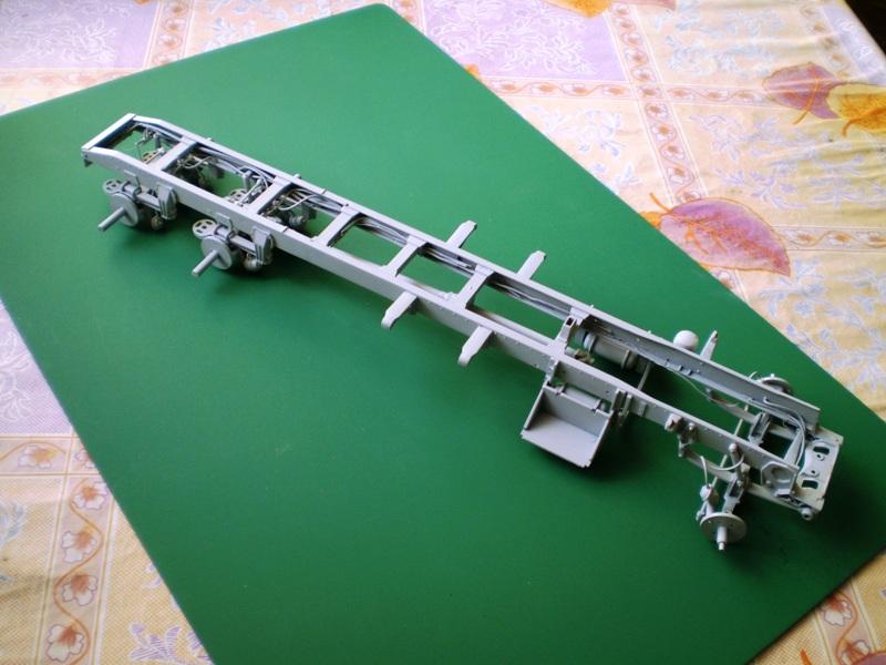

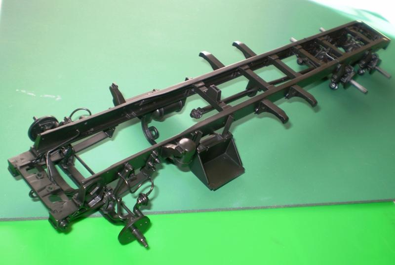

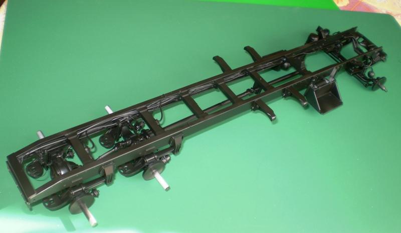

The whole frame...
P8280532.thumb.jpg.cba9eedc2aba7910b8363

Great looking frame! And it's really good to see kids showing interest in model building. We have to train the next generation, because no one else will.

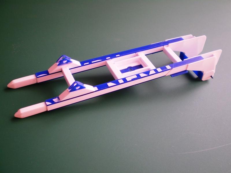

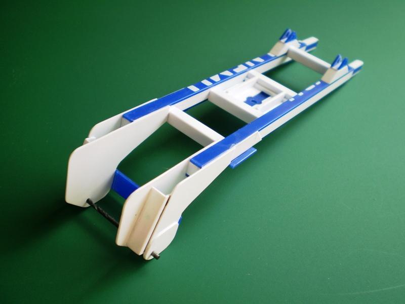

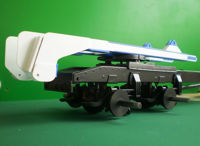

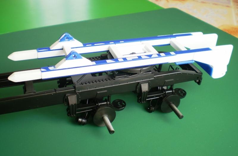

To make a liitle difference from a highway tractor I started working on a DTU. It is going to be a complete scratchbuild inspired by Holmes unit. Probably not 100% accurate as I have only a handfull of photos and a parts brochure. No dimensions, just my four-eyed judgement.
I built a base of the unit using Evergreen channels and warning signs made of plastic... basicly 1mm plastic sheets. Still a few details to be added before it goes to the paint booth.

Looking very good! I'll be watching this one for sure! I had no idea what the DTU was until I saw your last picture, they usually call them lowboys around here :D I will try to get some pictures of the front brake setup on my trucknext week if you want them, not a peterbilt, but it's basically the same setup, although with 500,000+ miles, it might be hard to see anything through the dirt and grease!
Edited by eizzle
