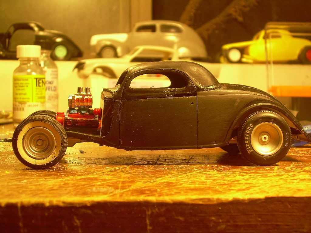

Ace-Garageguy Posted October 5, 2012 Posted October 5, 2012 (edited) WARNING: This post may contain typos. I'm assuming the script is molded-in on the valve cover. Here's an idea worth a try....I've used something similar to get sidewall lettering (on hard-plastic tires) and valve-cover lettering to come up in white, when the part was molded in white. If you get lucky, it's very crisp. DISCLAIMER: I've never actually tried it over black. This is JUST AN IDEA. 1) Scrub the valve cover with Comet and an old toothbrush. Adhesion is important. 2) Spray the valve-cover lightly with a self-etching automotive rattle-can black primer. Careful careful, 'cause the stuff is HOT. 3 or 4 coats. 3) Paint the valve cover with the red of choice. Let it shrink in and dry really well. 4) Come up with a small sanding block that will hold (minimum) 600 grit wet-or-dry sandpaper perfectly flat. I've used rubber or contact cement to glue it on a small piece of metal stock. 5) Ever-so-carefully, sand the red off of the script, exposing the black. You really have to keep the sanding surface square with the lettering and not allow it to drag on the edges and corners of the part. The only photo I have easy access to is this one, showing my first Q&D attempt on the rear tires on this mockup........It looks a lot better with practice. Edited October 5, 2012 by Ace-Garageguy
