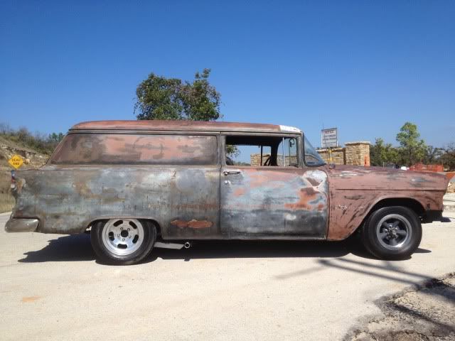

Ace-Garageguy Posted December 14, 2012 Posted December 14, 2012 (edited) The angle of the final pillar and rear gate on the SD is different from the Nomad too... The Nomad rear is raked forward more, and more of the tops of the fenders poke out past the rear gate. Filling the side windows with .015" styrene is easy, and you can gently form curves in the stuff with your fingers to conform to the curvature of the ends. OR, yes you can use the Nomad 'glass'. Just make sure it's bonded VERY well to the body, so it doesn't crack on the seams while you do your bodywork. I really recommend a slow-set epoxy and milled cotton-fiber paste, or epoxy and RC-model-airplane fiberglass cloth to reinforce the joints. Do your bodywork with a two-part polyester automotive glazing putty like Icing. Edited December 14, 2012 by Ace-Garageguy
Muncie Posted December 14, 2012 Posted December 14, 2012 (edited) An interesting and challenging project... Although the Nomad and sedan delivery chassis are the same, there is a substantial difference in the body. The Nomad roof and tailgate are cosiderably different with the Nomad's shorter roof and more fastback slope to the tailgate. The Nomad roof is also two inches lower than the sedan delivery and wagon roof. It may almost be easier to start with the '55 sedan than the Nomad because that will give you the correct roof/windshiled height with everything from the back of the doors forward and the rear quarter panels. Starting with the Nomad gives a headstart on sedan delivery with a two inch chop so it's not a bad plan either. I've seen a couple of AMT Nomads buit with the windows glued in and painted - makes a cool phantom Nomad delivery. (edit) oops, posting at the same time - the picures tell the story... Edited December 14, 2012 by Muncie
