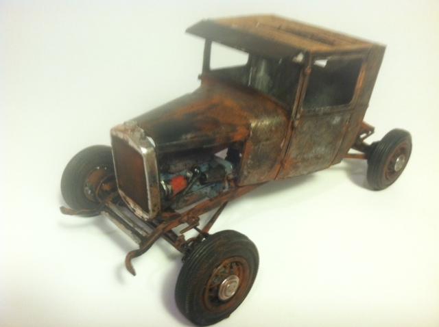

32 3-window coupe ,flathead v8 , " scalp't " , painted metallic copper
hey all ,
my next build , the 3-window coupe from revell
the boxart >

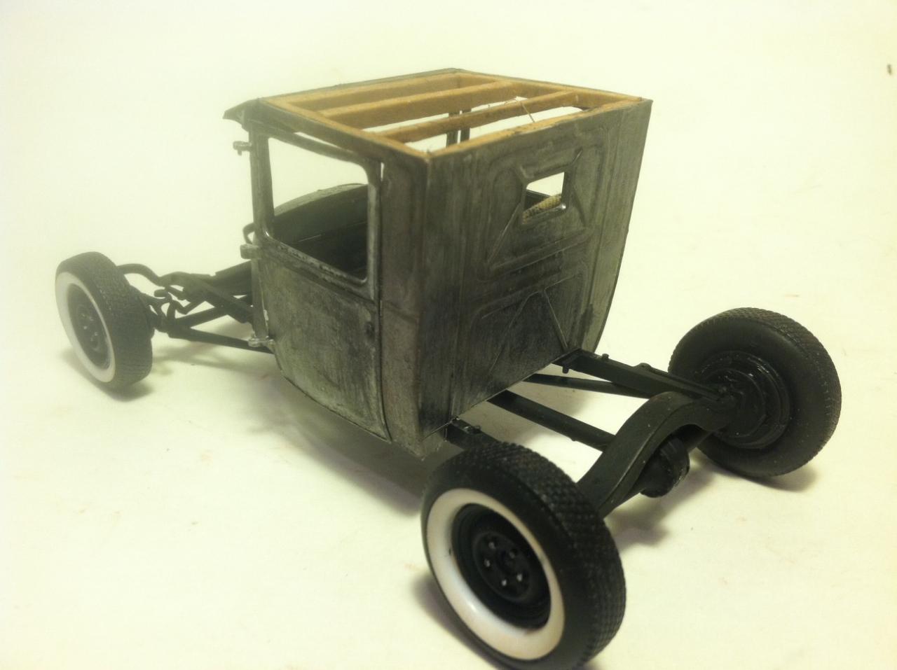

so first i markes a smaller piece just to look what happened
then tried to get a idea for the next step with these wheels
maybe i can make some roof support beams of real wood ?

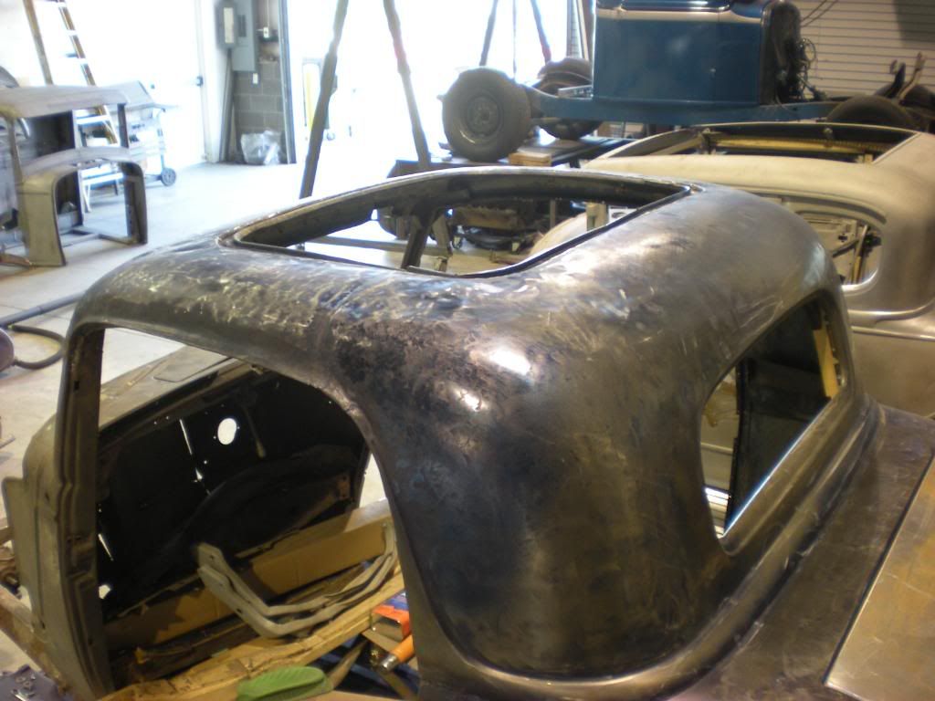

The reason the T was done that way is that Ts had a fabfic-coverd, built-up roof with a lot of wood. The '32 Ford 3-window had a soft roof insert like this...
...and when opened up looks like this (a '34)

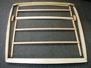

Hot-rodders have been filling the soft-insert with steel for a smoother look for a very long time. Removing so much OEM steel would quite thoroughly destroy the structural integrity of the body shell, though you could restore some of it with wood. Probably not a mod that would ever occur in 1:1, as good 3-window shells are worth their weight in gold. Still, a car with a badly damaged roof could be turned into something cool by what you're doing, and a lot of hot-rods came to be that way. Interesting. The Model A had a lot of wood in the roof and might give you some ideas. This is the wood for a '28-'29.

this is just a rough idea , just to check how wood looked
so this isnt the width or how i want to use it
i will make a real frame following the outerlines of the gap and make some pillars in between
