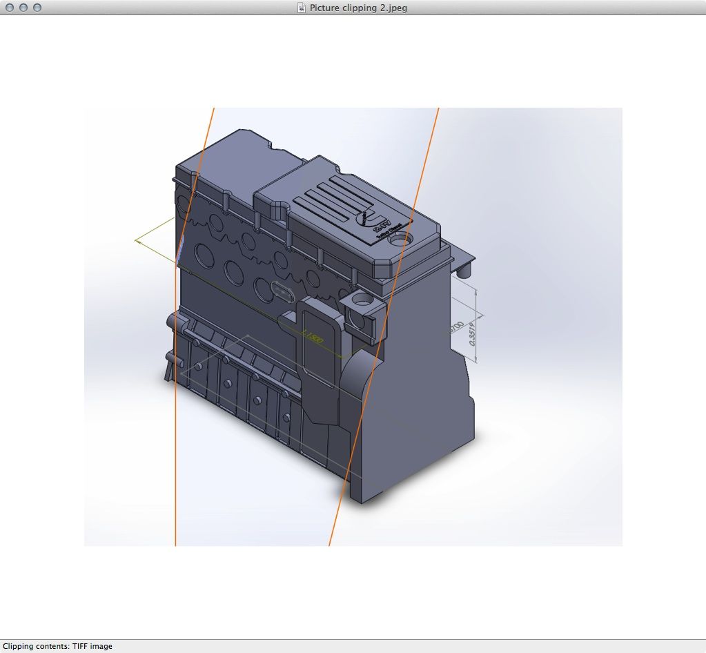

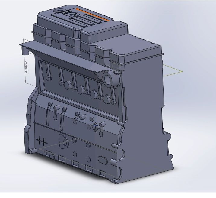

stewart Posted February 2, 2013 Author Posted February 2, 2013 I have about three different vehicles I have planned on putting one into. I hope to get this one cast in a more timely fashion than the last one. I started drawing up the main block in SolidWorks today. Only took about 5 hours to get it mostly completed. One reason is because I'm still new to the program. After I finish the block, I am going to try to get it 3D printed. The college I go to has a printer on hand and it is open to public use, so I can get it done for free. If it looks good, I will build a version myself, because the printers are pretty rough in texture. If I can, I might just clean up the printed version for casting. I'll try to get some screen shots of the block and post them up later on. STewart

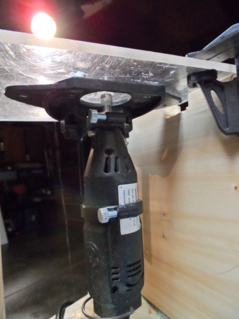

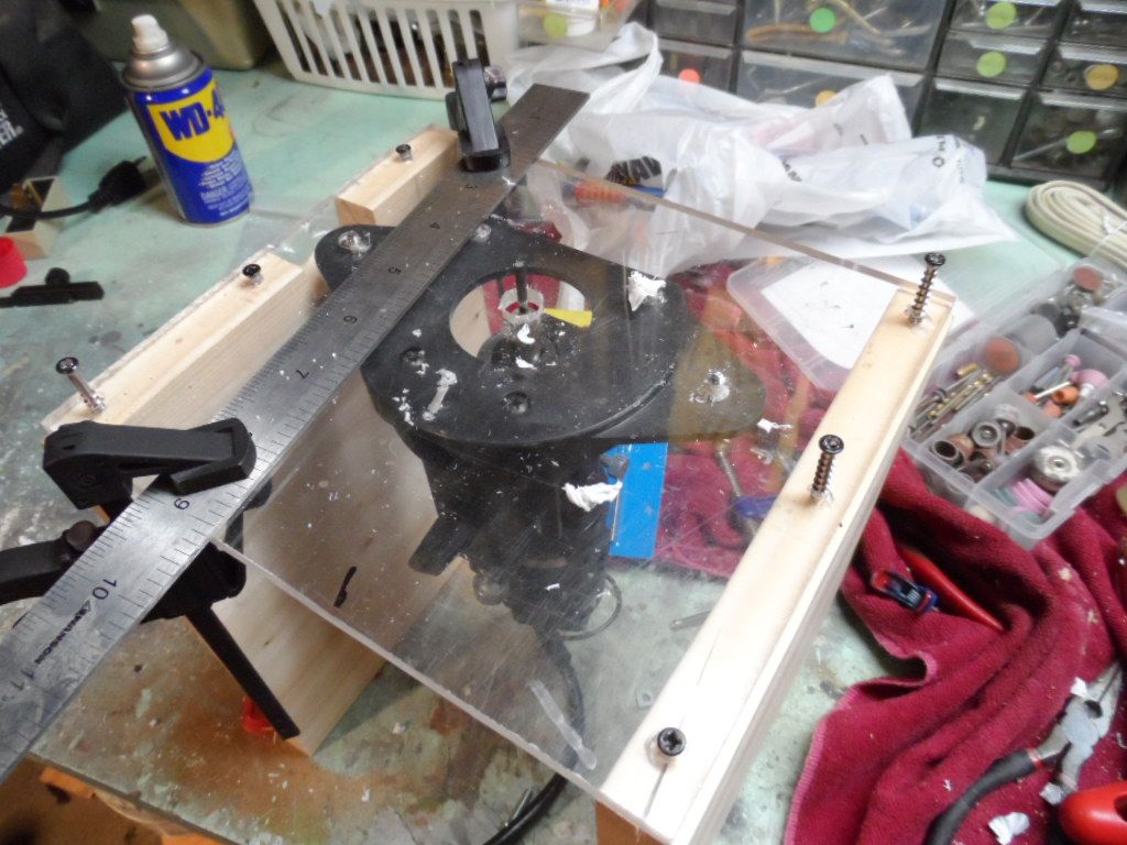

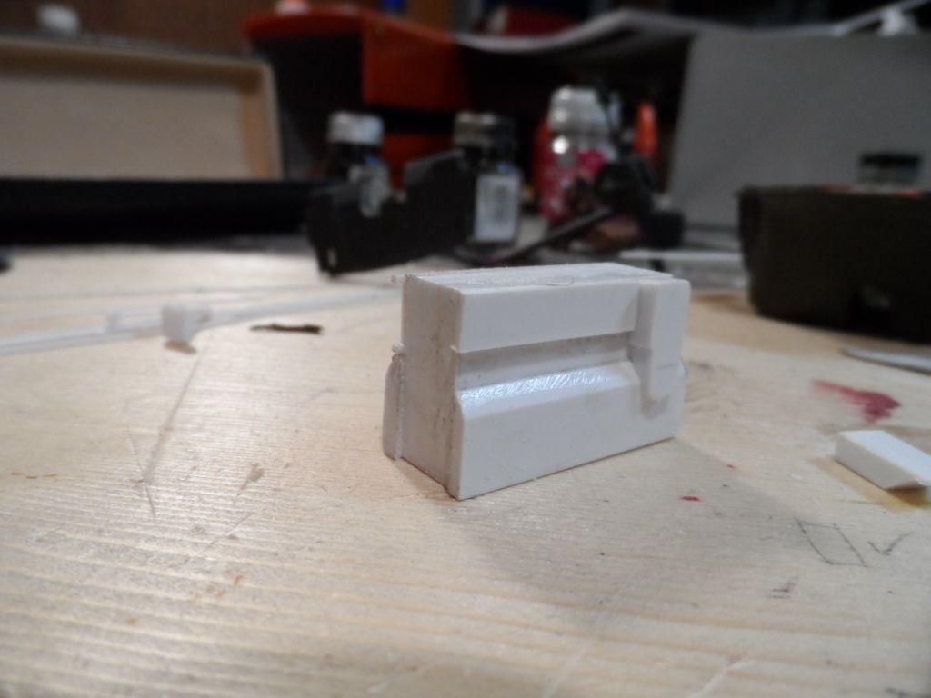

stewart Posted February 5, 2013 Author Posted February 5, 2013 Well, I don't have any pics of the 3D model yet, but I put a little more work on it today and I should have it 3D printed by Friday. I have also made progress on my own styrene prototype and I do have pictures of that. Using a razor saw and file to square up an engine block doesn't usually create a nice square block. I have a dremel router attachment, so I screwed it to a piece of 1/4" plexiglass and made a stand. It works very well. STewart
stewart Posted February 6, 2013 Author Posted February 6, 2013 ok, 3D model nearly complete. Just a little more shaping to do on the front and rear and an oil pan, and this will be finished. Here are the pictures. STewart

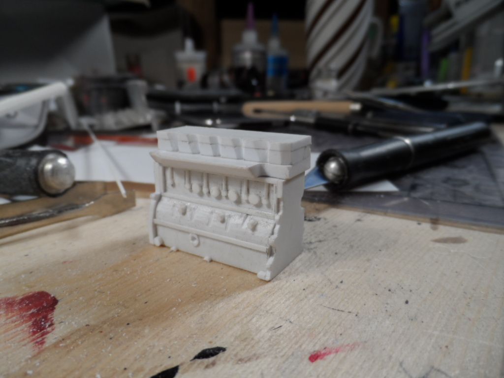

stewart Posted February 16, 2013 Author Posted February 16, 2013 I have quite a bit more done on the cummins. Doing details this small with styrene is very difficult. STewart
