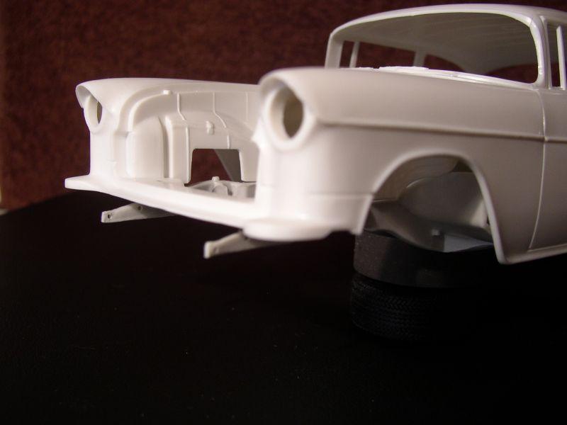

Alan Posted February 23, 2013 Posted February 23, 2013 (edited) Here is my front splash corrected ...... pick up the AMT 57 or the Rev 55 hard top or the 56/7 sedan ... those can be made to fit ..... another option would be the MPC/AMT 57 flip nose Belair sedan Edited February 24, 2013 by Alan
