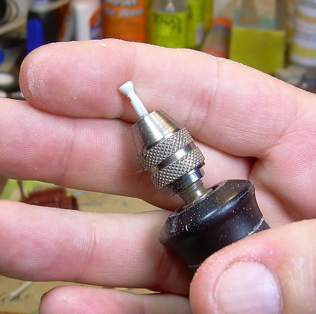

Ace-Garageguy Posted February 27, 2013 Posted February 27, 2013 (edited) To build ANY kind of effective el-cheapo lathe, from any kind of Dremel, drill motor, etc. there are only 2 things you have to remember. The power source that turns the part on the spindle needs to be rigidly mounted, and you need some way to hold the cutting-tool steady relative to the work piece. METAL-cutting lathes always have a rigidly-mounted but adjustable cutting-tool-holder. Many lathes for turning WOOD do not have a rigidly mounted tool-holder, but have something that one rests one's hand on while holding the cutting-tool, chisel, etc. Having a rigid support for the cutting tool makes it much easier to make round things actually round (required of metal machine-parts) but true roundness isn't really required of wood-turnings like table legs and bannister parts. A Dremel will have plenty of power to turn plastic and soft aluminum model parts. I turn a lot of small parts, like this flared universal-joint cup for a '32 Ford driveshaft. Edited February 27, 2013 by Ace-Garageguy

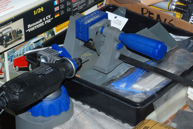

Foxer Posted February 27, 2013 Posted February 27, 2013 I use a Dremel Multi-Vice for a cheap and quick lathe when needed. It comes with an attachment I put on my old corded Demel. The vice slopes out of the mount and the Dremel slips in and can be turned to any position. This attachment is rarely shown or mentioned. The photo is mine with the Dremel mounted. I do need to come up with something to rest the cutting tool on and this thread has been very helpful
MikeyB08 Posted February 28, 2013 Author Posted February 28, 2013 On 2/27/2013 at 12:57 PM, Foxer said: I use a Dremel Multi-Vice for a cheap and quick lathe when needed. It comes with an attachment I put on my old corded Demel. The vice slopes out of the mount and the Dremel slips in and can be turned to any position. This attachment is rarely shown or mentioned. The photo is mine with the Dremel mounted. I do need to come up with something to rest the cutting tool on and this thread has been very helpful Very Nice. Thank you for posting this.
