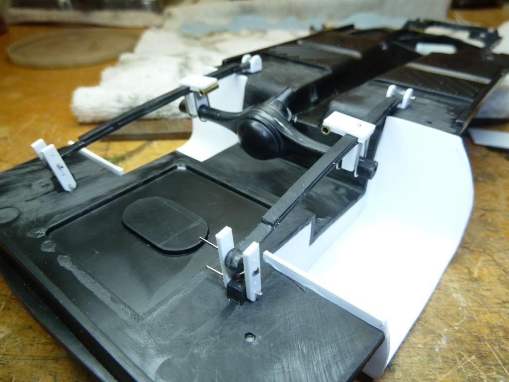

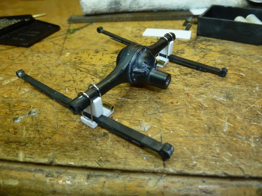

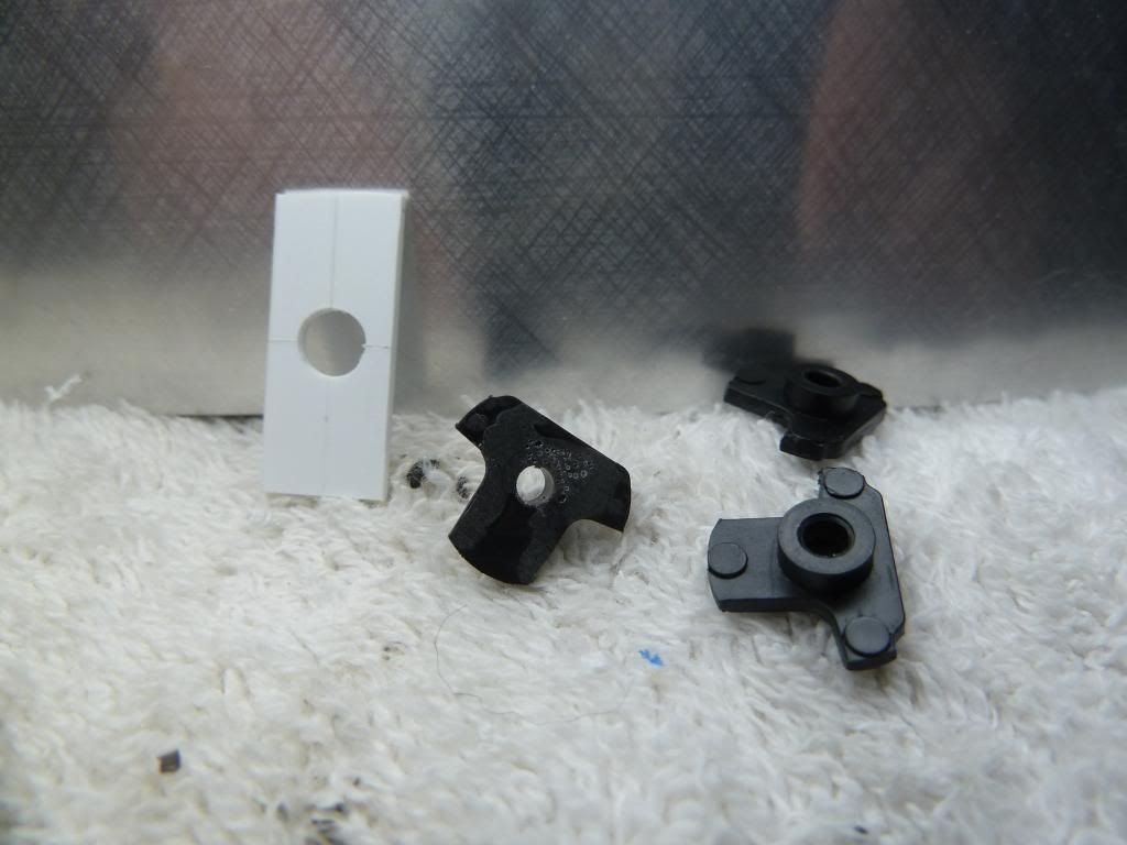

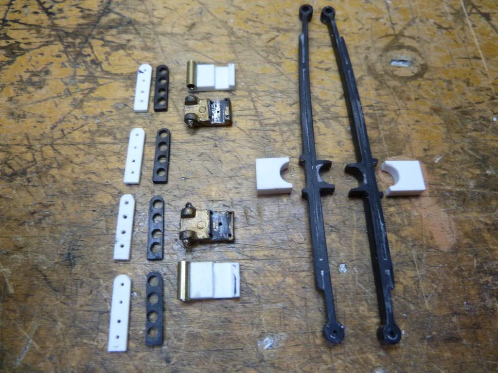

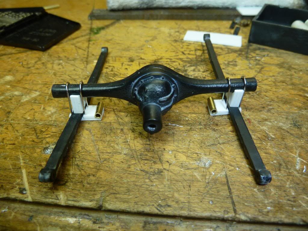

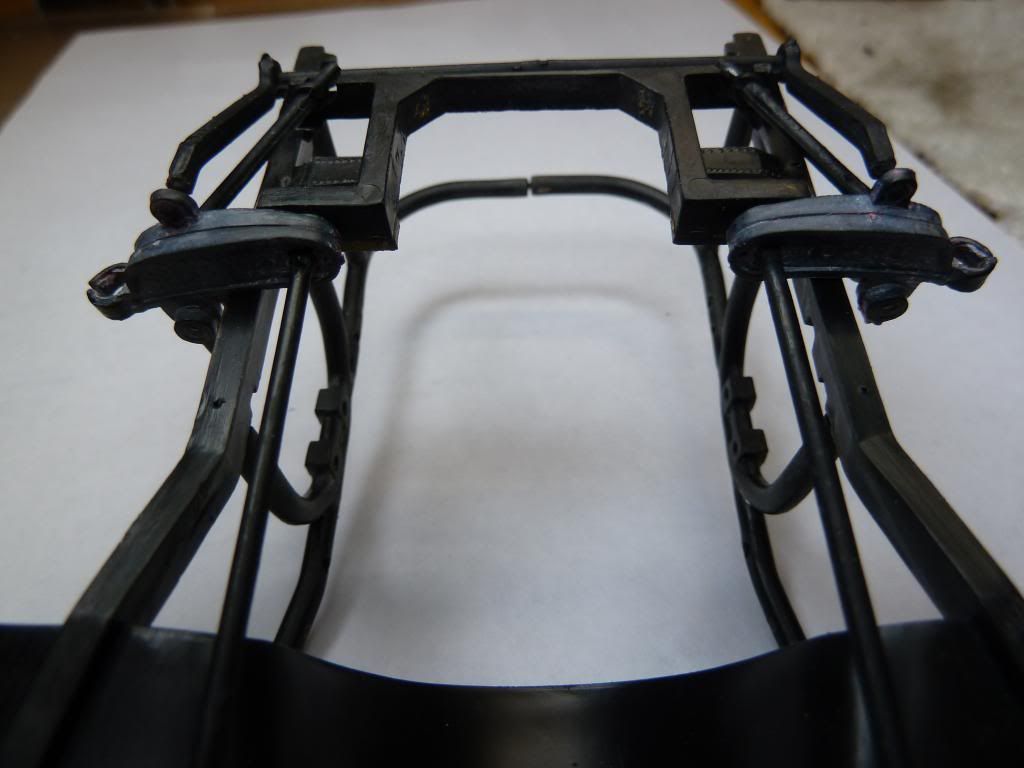

After a quick review of yesterdays work, I figured out there would be an issue with the ride height. The block that cups the axle needed to be taller which translates to a lower ride height. So back to the drawing board.

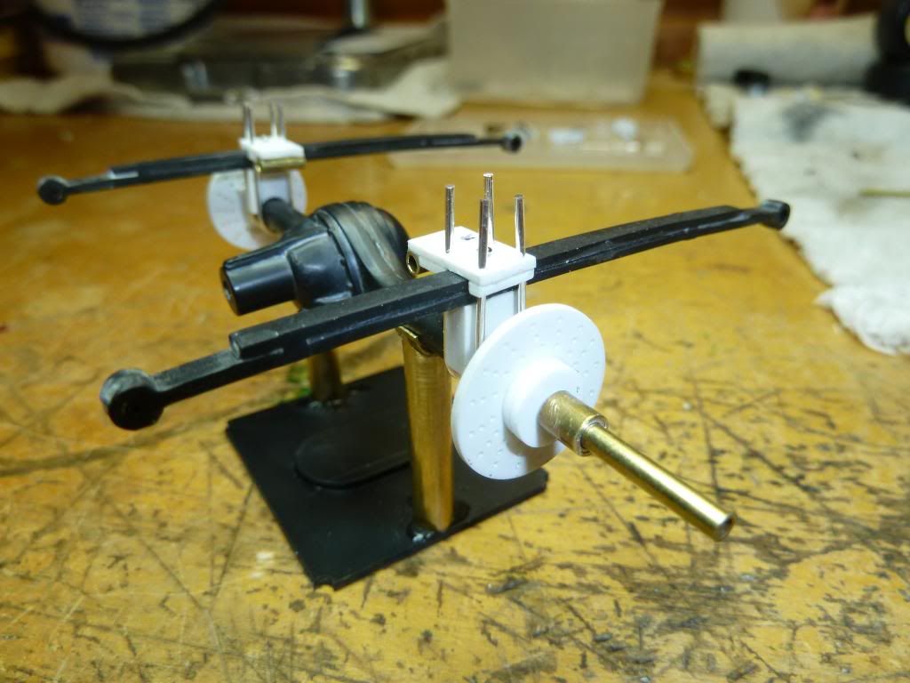

Since I wasn't 100% pleased with how it turned out anyway. I spent the whole morning scratch building all the parts to redo the rear suspension.
Here's what I came up with.

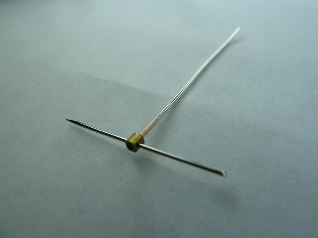

With the help of a hand full of pins, I got it temporarily held together.

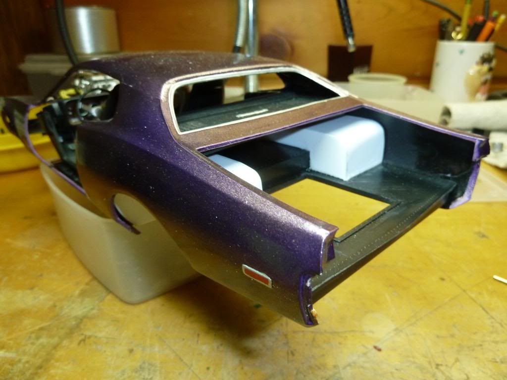

I think it turned out a lot better and looks a bit more realistic. The rebuild saddle blocks dropped the whole car 3/8 of an inch.
I finally glue the new tubs in place last night so it would be dry to work with today.

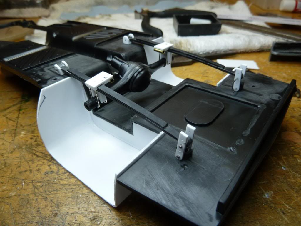

Here's a couple views of it all sitting in it's perspective place.
Now that I have a measurement I can get to work on the Coil over shocks and mounts.
Here's the battery, nitrous tanks and fuel cell (I may scratch build a new one out of aluminum) What do you thick, the plastic just looks to cheesy
All added up it doesn't look like a lot but it took all day to build.

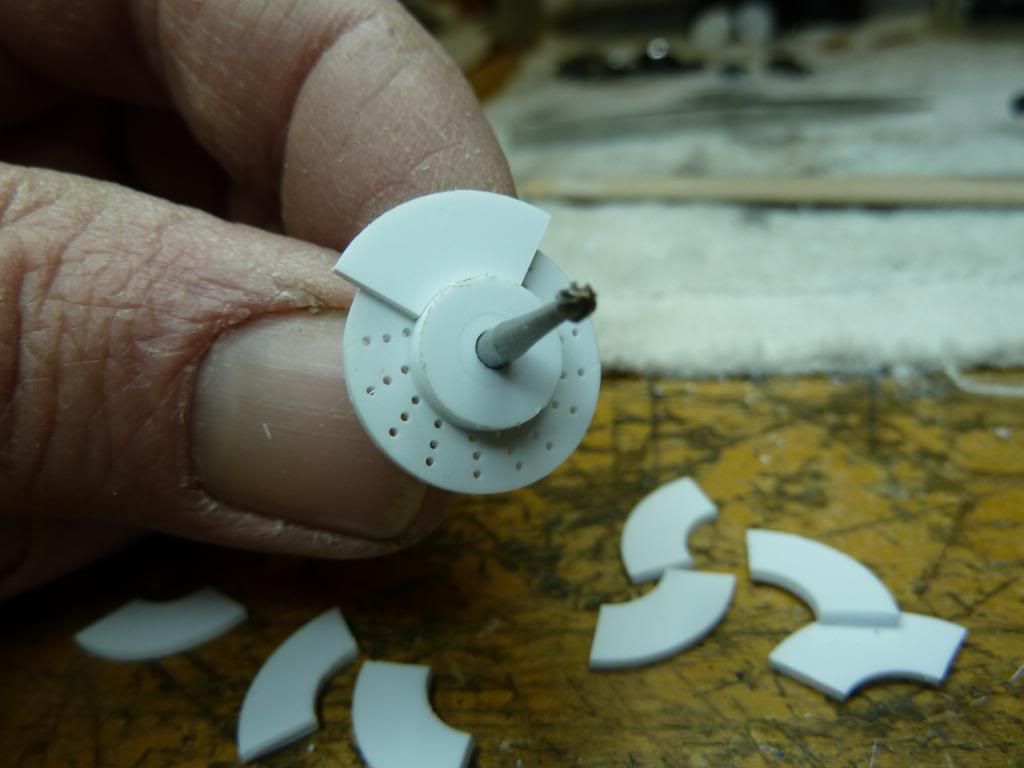

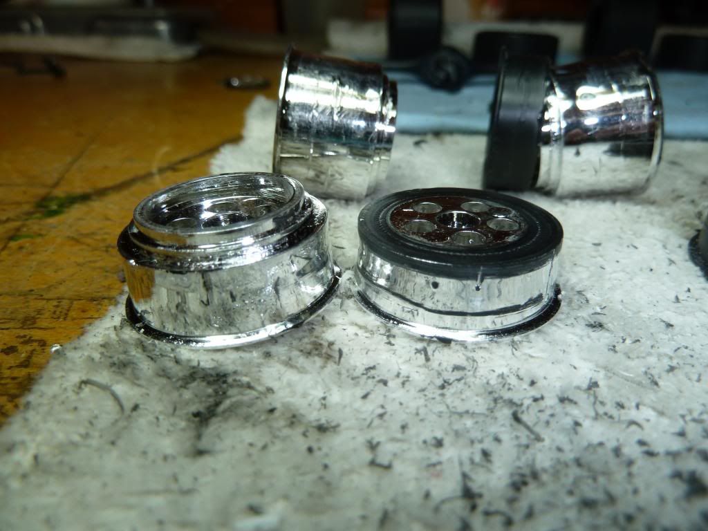

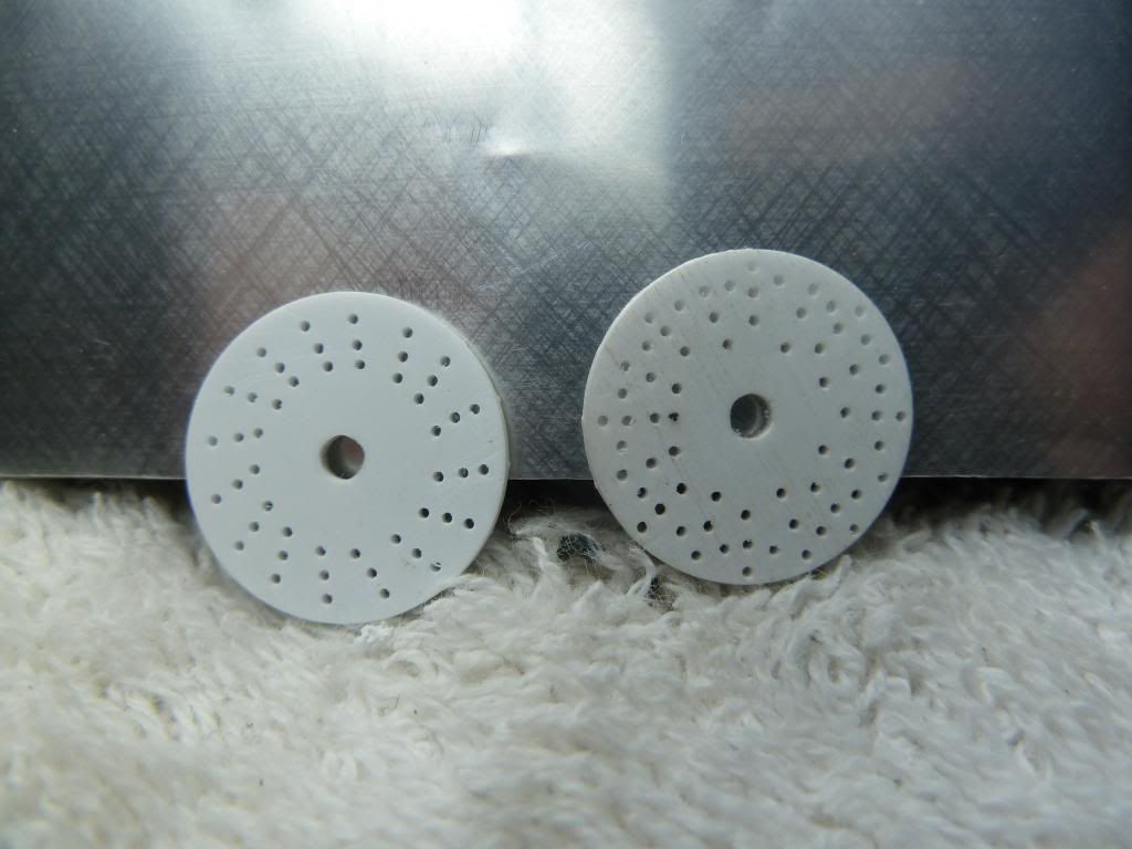

I had to chuck up the rims and remove some plastic so I could fit the car with Disc brakes (original kit had drums on all 4's)

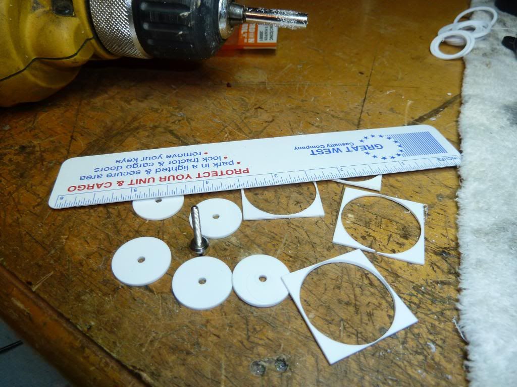

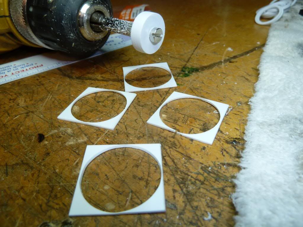

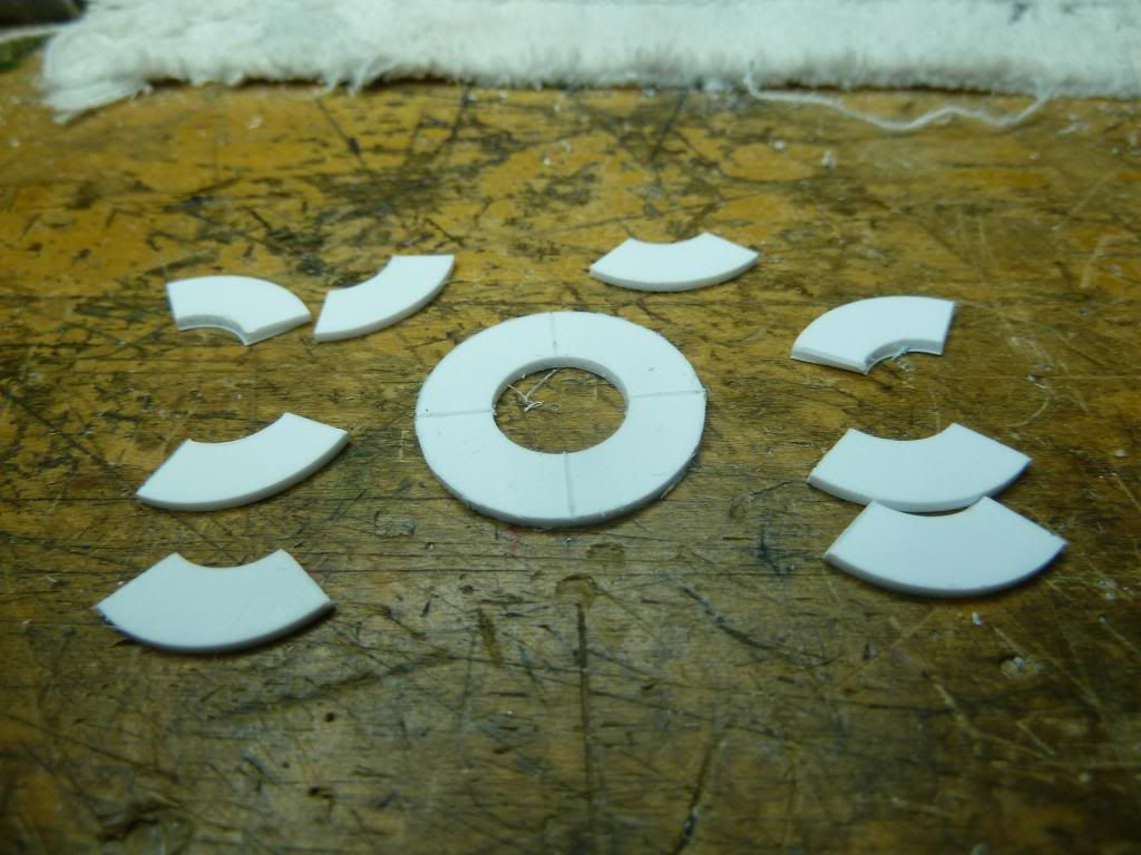

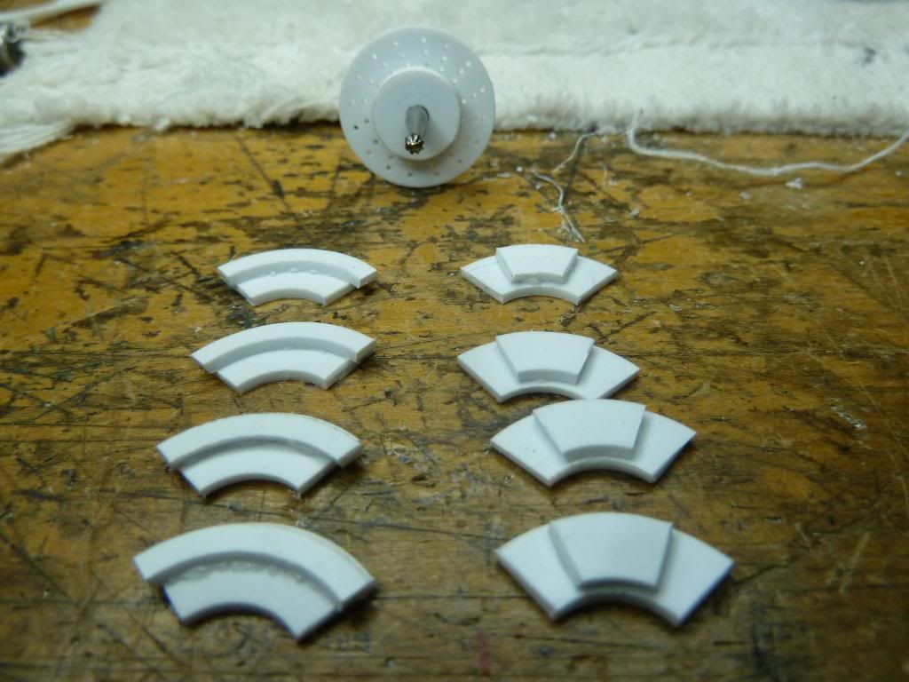

Next, I cut some styrene squares and chucked them in the drill and stuck a knife to it to come up with the disc's. Laying them out for the vent holes was a little tricky and I came up with 2 different designs but one looked a lot better than the other.
I cut more styrene for the bracket that holds the rear calipers in place.
Then I got working on the calipers themselves. They are at a crude point right now but some putty and Dremel work should pull them together.
Here's the work removing the lip on the rims. It was the only way I was going to get realistic sized discs and calipers added.
The left is original, the left is after trimming.
Here I got the disc's cut.
I made 5 of them so I could sacrifice on while laying out the vent hole pattern.
This proved to be a little time consuming.

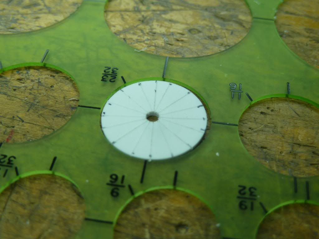

I used the hole guide and put punch marks on each of the lines, then dropped down 2 sizes and repeated the process. Then I took a pin vise and drilled them all out. 54 holes on one pattern and 86 on the other. I decided to go with the pattern on the left.
Here's the bracket for the rear calipers. I can't complete it trimming it till I get the calipers finished.

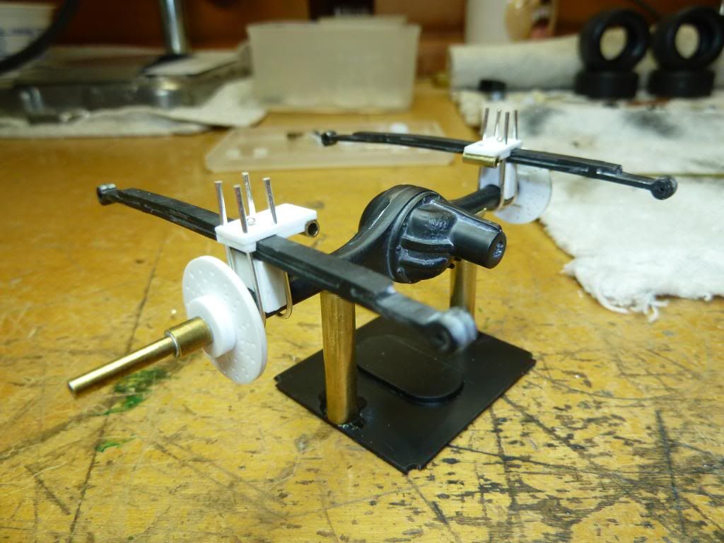

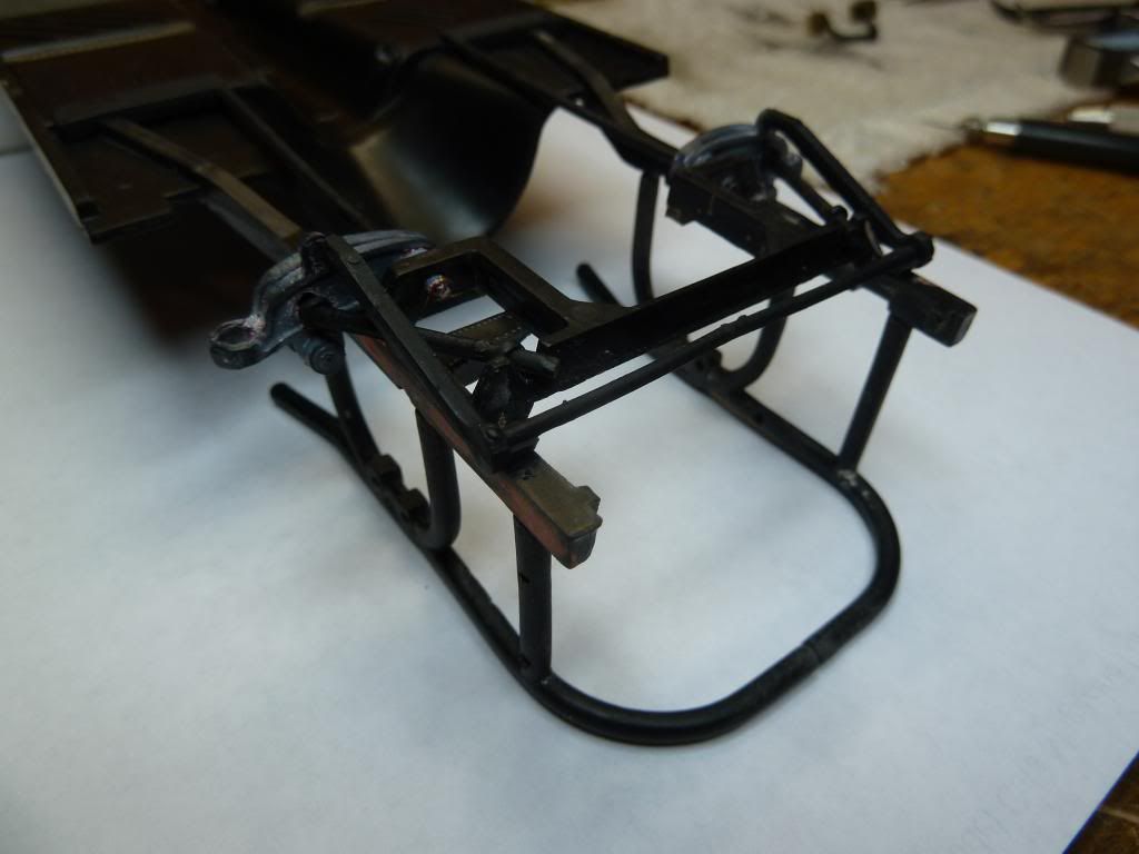

Small update.. I finished the discs and mocked up the rear end. Looking pretty good I think.

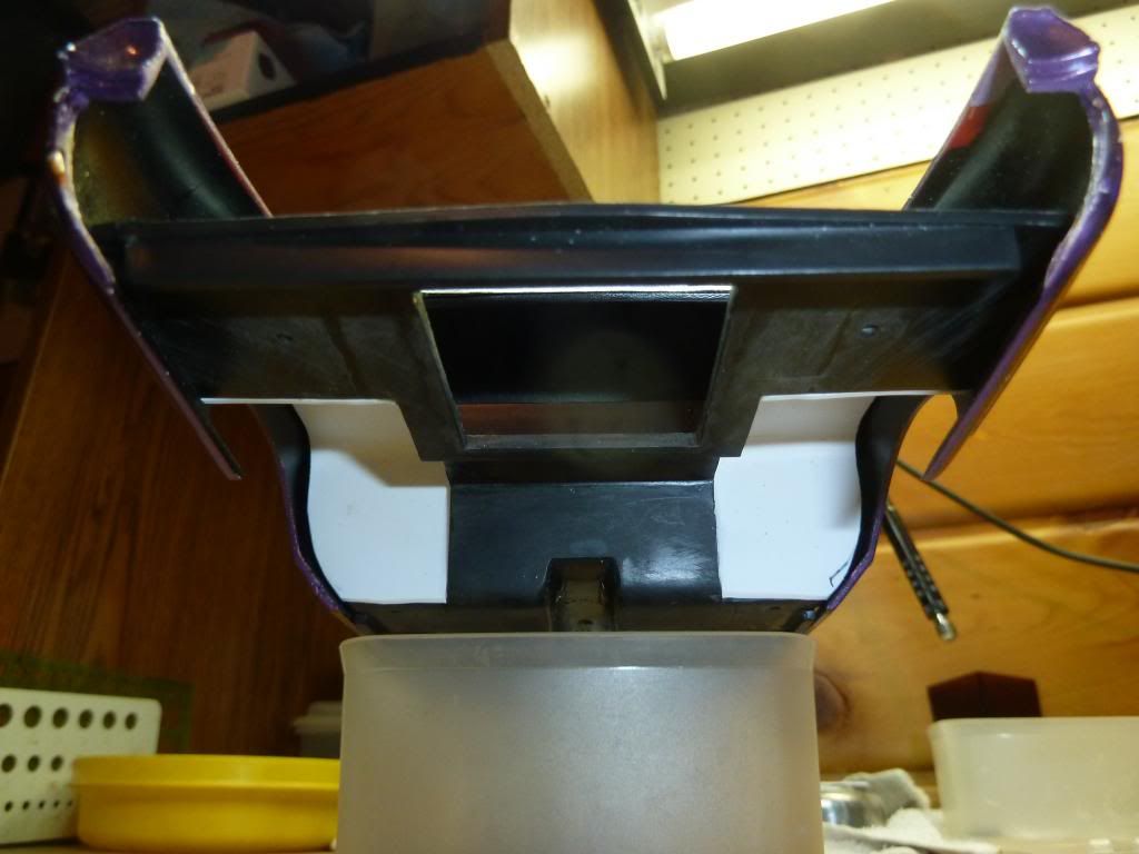

I got the tubs all sanded down and fitting properly into the body.

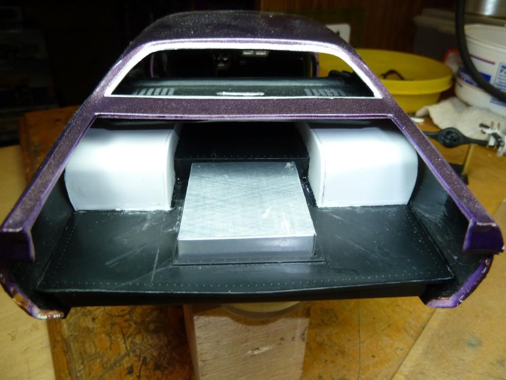

I decided that the old fuel tank had to be replaced with an aluminum one.
Also while digging around in my stash, I came up with a tube of "Testors Red Putty" that I've had for years and never opened. I played around with it on some frame work to see if it would be suitable for the rest of the build. I used some other stuff back in the 90's that had Tolene (think that's how it's spelled) and it was so hot, it melted and warped the project I was working on. Valuable lesson learned. I like it, and I didn't have to put out any money.
Here's a photo of the rear end mocked up with the discs added.
I'm going to trim off the U bolts and add some brass nuts on them when the final assembly comes around.
I had to cut out where the old fuel tank used to be.
Another view of the trunk area.

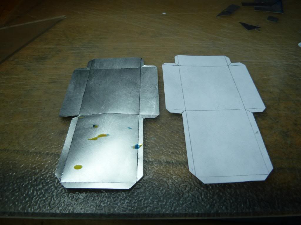

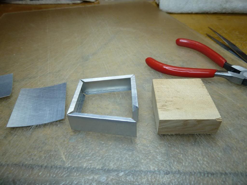

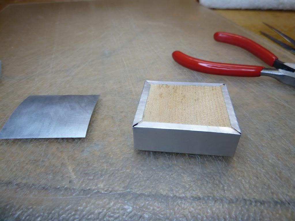

Let's see what we can make with a couple of left over soda cans. I've been using them for years to custom build all kinds of stuff, pretty cheap and always in supply.

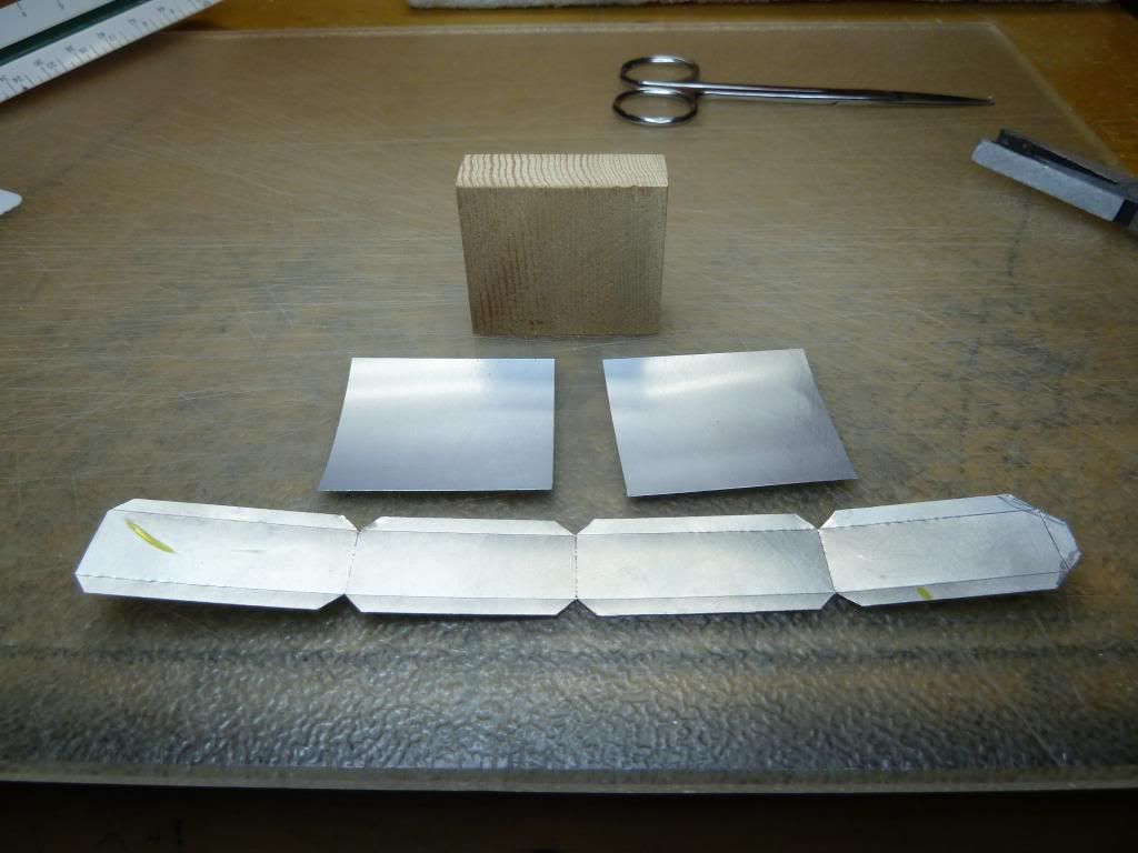

My first attempt at the fuel tank was an epic failure. Can you figure out why? I didn't even see it until it was all cut out. I had to laugh at myself..
The second try took a different approach. I realized I wasn't going to be able to make it in one piece like I had planned. I also decided to cut a wood block to hold the inside ridged, this will also help later on when I drill it out for the fuel lines. Here's the pieces before assembly.
It's about time all that schooling in Wood and Metal shop to pay off, not to mention the 3 years in Auto Body class.

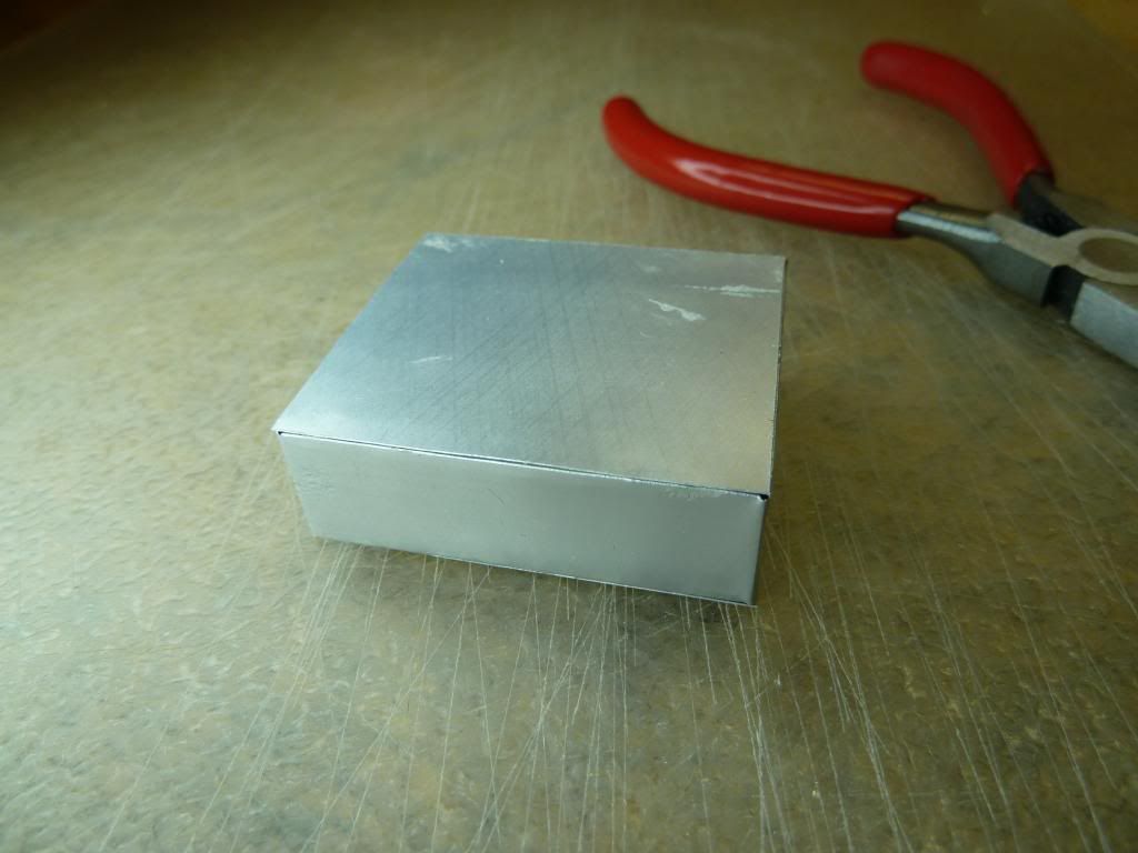

I had to get it bent just right, then work the wood block inside without mangling it to badly.
That wasn't so hard!
Then I used Super glue to put the top and bottom pieces on.

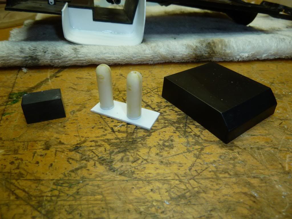

I have 2 Nitrous tanks that will be mounted on the black deck right between the wheel tubs.
I still have to do some trimming on the top and bottom plates. And I have one more really sweet trick left to perform!

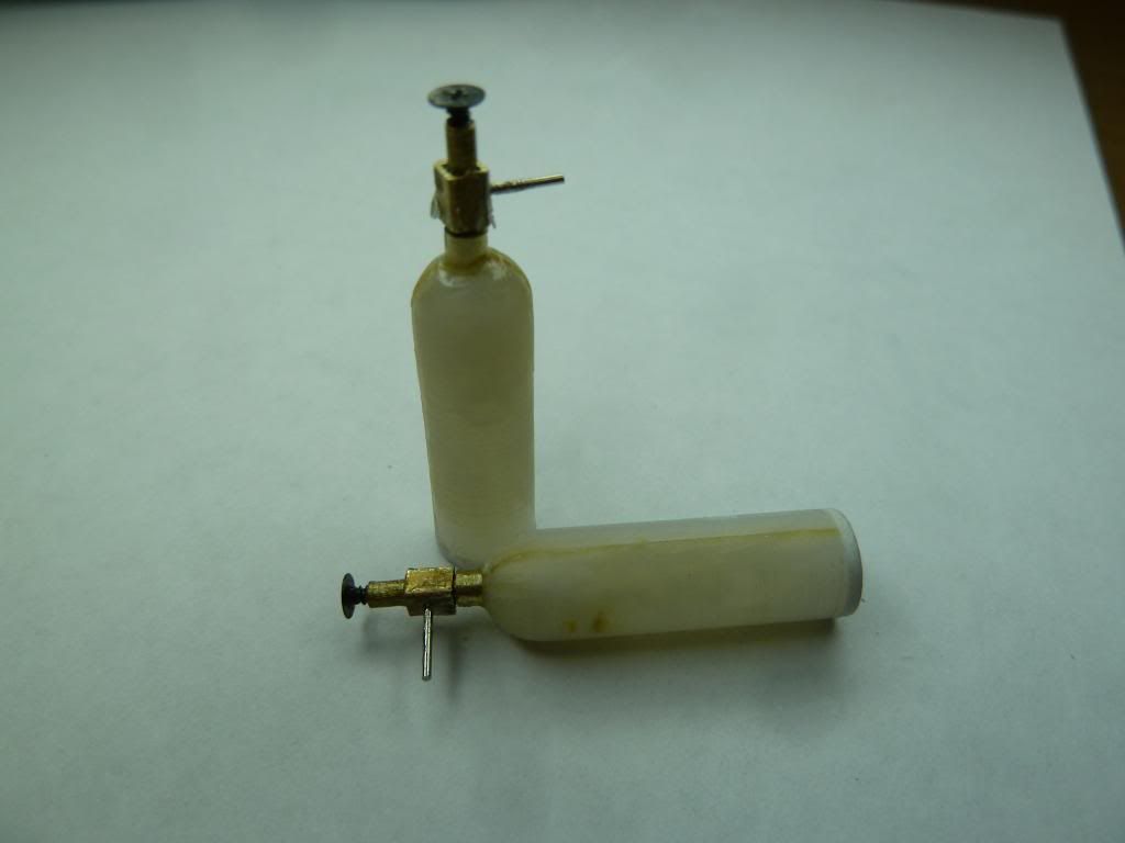

I got the nitrous tanks and the "T" fitting done. just need paint and a decal on them.

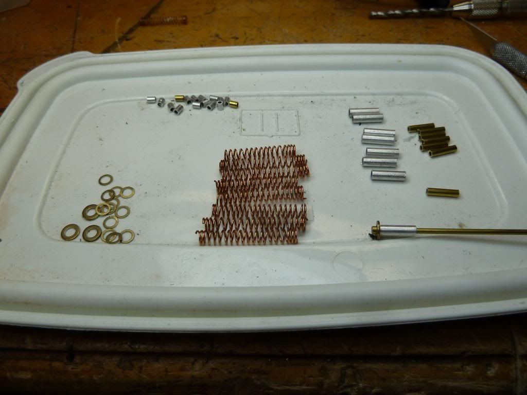

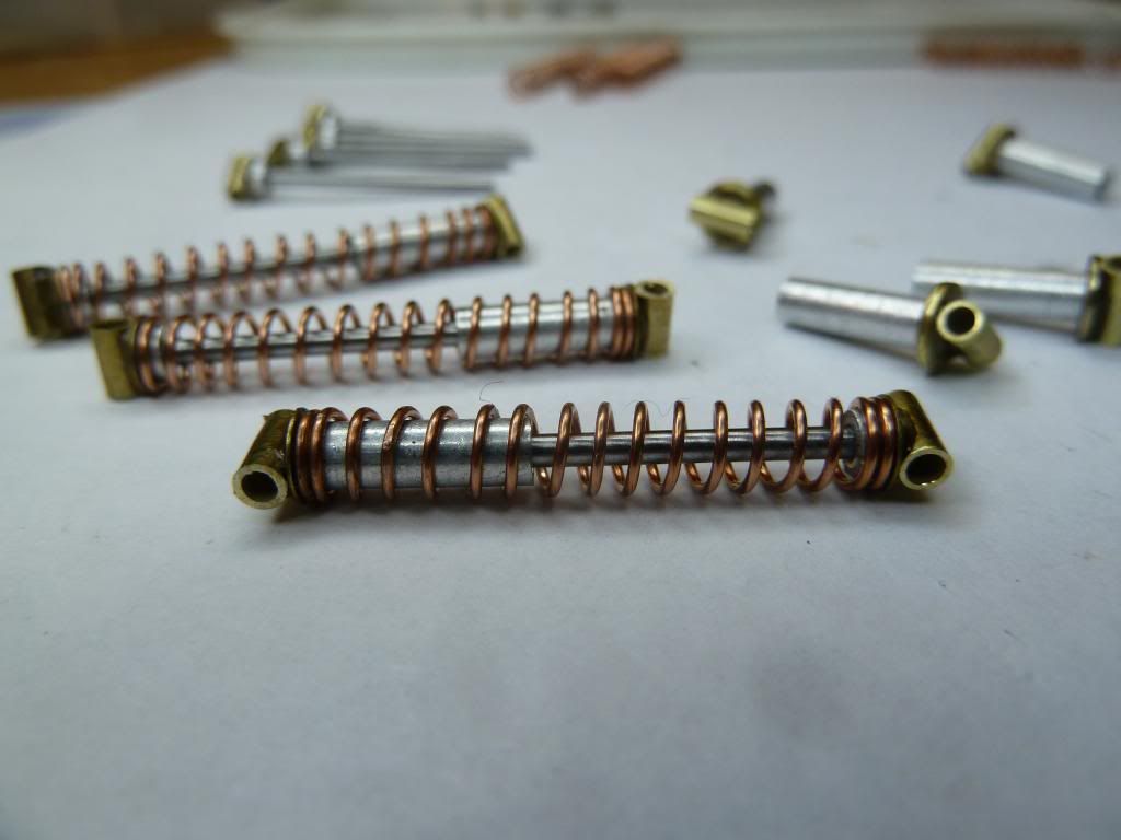

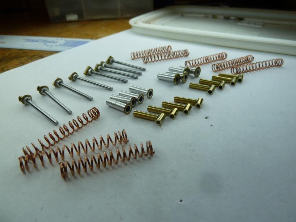

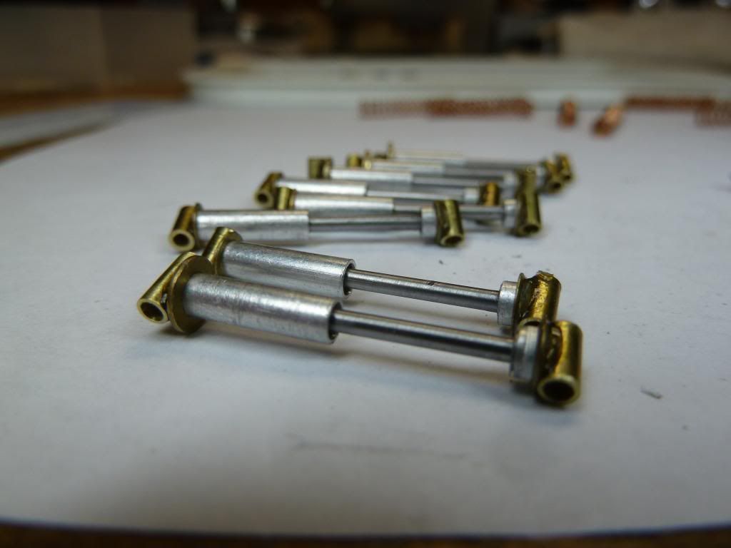

Then the task of making 8 identical coil over shocks. Tedious but I enjoyed it.
I've started to turn some focus on re working the front suspension.
Here's a photo of the Nitrous tanks.
And the "T"
Most of the pieces needed for the coil overs.
Some assembly required...LOL
Without the coils.
These still need to be trimmed to fit. They are in 2 pieces so after the suspension is complete I can measure then cut the center ram and coil for the final fit. They turned out pretty good I think.

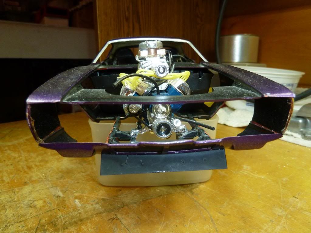

Here's a photo of the stock front end. I'm in the process of making lower A arms to replace the old set up. The kit had A arms for the uppers but the new ones have to be wider and making all the brackets for the new front end out of brass. Should be fun.
