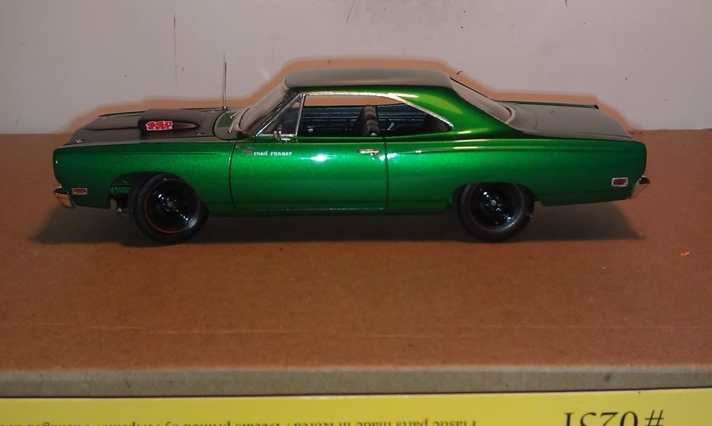

azers Posted April 19, 2013 Posted April 19, 2013 Here is a picture of my roadrunner a/12. The keithmarks decals cover nicely.
Stuntman Mike Posted April 19, 2013 Author Posted April 19, 2013 Beautiful Roadrunner, Joe. It came out great. Looks like you have used the Jo-Han body aswell. And a GTX chassis. Great build and thanks for the info on the decals. What kind of wheels did you use on your build, Joe?
azers Posted April 20, 2013 Posted April 20, 2013 (edited) The wheels are resin copies i picked up off ebay. The only thing johan is the body. I used the gtx for everything else the tires are satco redlines i stashed. The hood is aftermarket resin piece. Good luck on your project. Just a tip the replacement parts for the 69 roadrunner from the Modelhaus are repops of the johan pieces. Which i used to replace the grill and bumpers on mine. Edited April 20, 2013 by azers
