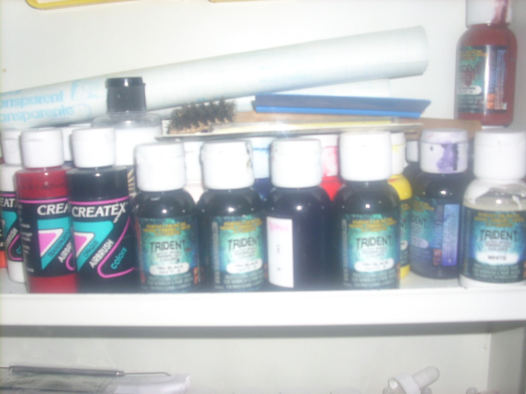

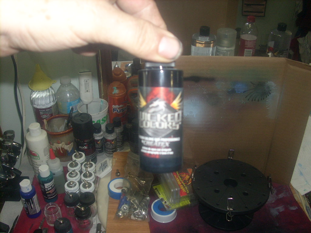

Hi all well I went and got the adhesion promoter and I followed the directions on the can to the letter. But when I went to do the finial gluing up on the cab and interior and I was using the latex gloves so that I didn't leave any oily spots or anything but the paint came off and now I have to start all over again. The paints I was using is the wicked but now I'm thinking about trying this trident paints . Any and all helpful info would be most grateful and a Big Thanks In Advance.

I've also never heard of wicked or trident paints. Some pics or links to the products please.

WICKED PAINTS
TRIDENT PAINTS
Both are water based air brush paints - I don't know of many people using these for modeling...? Sounds like there is not proper adhesion between the promoter and the paint - which is why the paint would pull off with handling. As Mike stated, all you need is a good primer base - Tamiya, Plastikote, Duplicolor, etc - for proper adhesion on styrene plastic.

If you are going to use a waterbased paint you need a waterbased primer as well. The aqueous paints do not adhere well to laquer primer
I've used Createx Wicked colors pver lacquer primer before, it works just fine. The problem here is the "adhesion promoter". It's completely unnecesary for these paints.
Strip the model down to bare and make sure it's COMPLETELY CLEAN, then start over. With Createx paint I use Wal-Mart's Colorplace brand flat paints. They are .97 cents a can and will prime three or four full kits. Then airbrush your Wicked paints. As an aqueous paint, it needs to either be heat set in a dehydrator, or clear coated to lock it down. Createx's formula is alot like neons. They are a very soft paint and can tear easily but adhesion promoter only adds to the problem.
