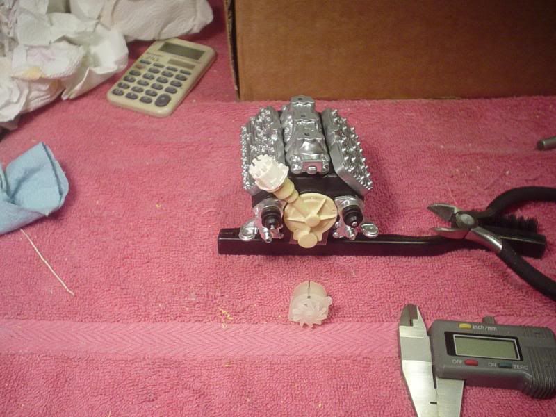

Motor looks better even now, without all that gawdy chrome smeared all over the top.
The magneto, even though it's cast to scale, is too visually large & overpowering for this motor.
Going with something smaller with a tower cap on it.

Kinda like the magneto, when I mocked it up on the front of the engine a while back.

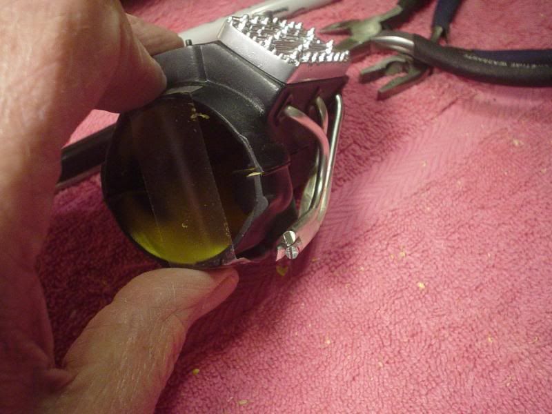

I buffed the aluminum parts on the top of the engine with the ultra fine foam pad, to get rid of the "shine".
Used a nylon bristle, detail brush to scrub down the fins on the face of the heads.
This looks better to me.
Also need to further refine the way the header tubes flow against the side of the block.

A new friend I've made through the slammers club, saw my post on the magneto a couple of pages back & sent me these.
Thank you!
The alternator is a 3 piece item, making it easier to detail & short enough to mount on the top of the engine in front of the 3 carb setup.
