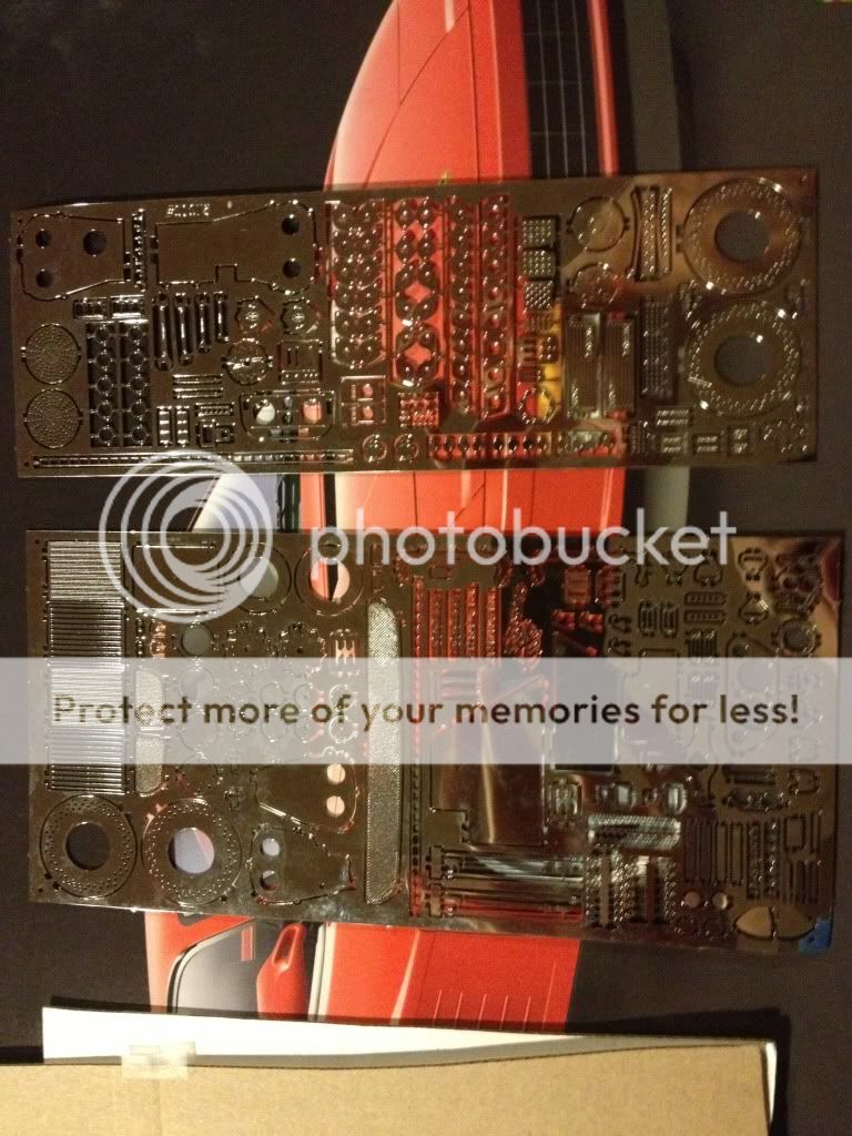

lanesteele240 Posted May 31, 2013 Posted May 31, 2013 I noticed on the gt community build that you said you were waiting on a p/e set for this one. Where are you getting it from. I have one that says it is for 2 different Ferraris. It comes from scale something another. One is the alpha m. and the testarossa. Is this what you speak of or do you have another.
Kennyboy Posted June 1, 2013 Author Posted June 1, 2013 (edited) I noticed on the gt community build that you said you were waiting on a p/e set for this one. Where are you getting it from. I have one that says it is for 2 different Ferraris. It comes from scale something another. One is the alpha m. and the testarossa. Is this what you speak of or do you have another. The parts I have are from a set that included the Testarossa and the F40. Another member on here (QuickGMC) graciously helped me out with the parts he did not need for his Testarossa. I got the parts for the F40. Some are a little out of scale but that is not a problem because I will trim to fit them. Just bought the 1/12 Testarossa today though, so I will be looking for a full set for it soon. Edited June 1, 2013 by Kennyboy

lanesteele240 Posted June 2, 2013 Posted June 2, 2013 This is the p/e set i have Cant figure why thet chromed it. It looks way out of scale
