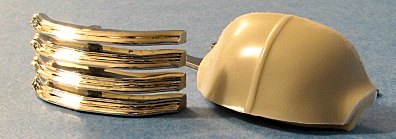

Dr. Cranky Posted October 19, 2007 Author Posted October 19, 2007 The other thing that looks different on the illustration and had me a little anxious was the size of the grill and the way Jairus cuts it . . . and when I did it the first time it was too tall because I had not cut one of the slats off . . . the illustration has four and the kit part has five, so it took me a while to figure that out, duh!!! It's always been my favorite part of the 50 Chevy along with the fat fenders!!! I'm keeping it chrome so I had to be careful cutting off the excess, plus when I paint the front of the hood (what's left of it, LOL!), I will glue it together in place . . . right now it's all mocked with Aileen's tack glue . . .
