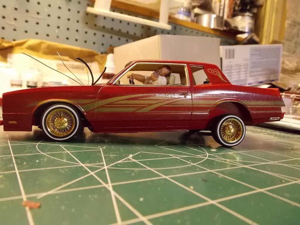

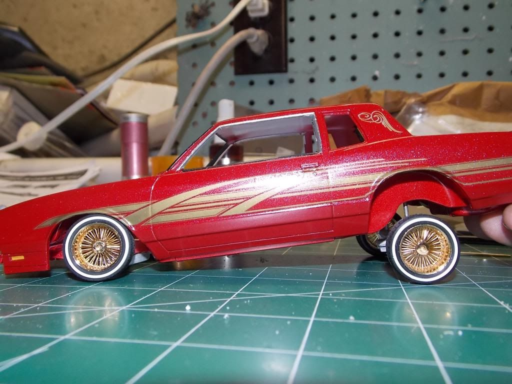

Currently working on Monte SS. I know low riders are everyones "flavor" but it's what I'm currently into building........

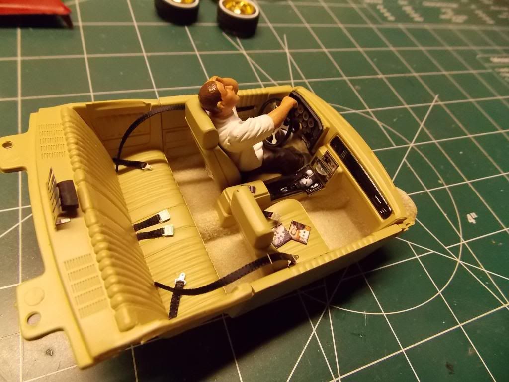

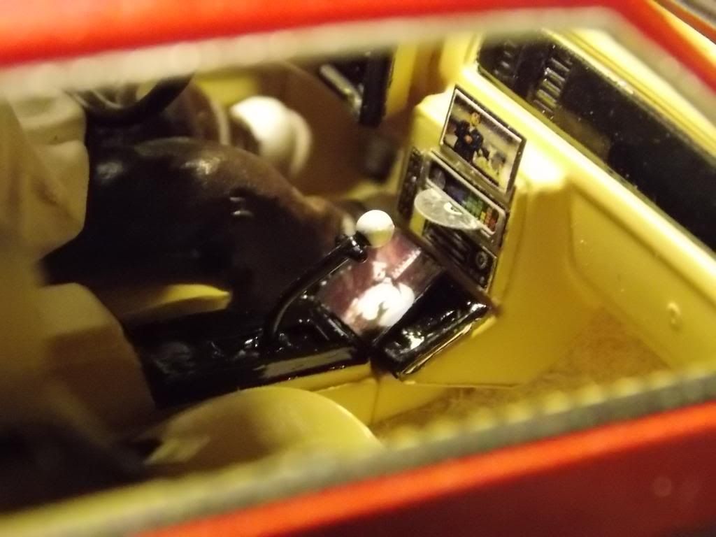

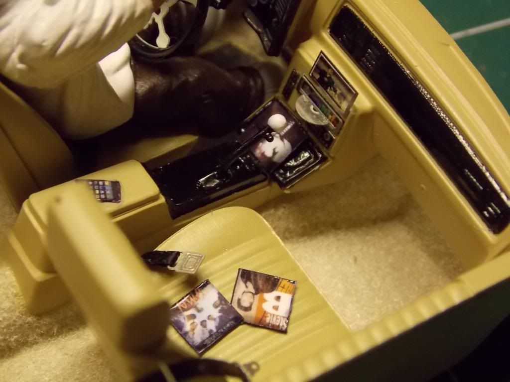

The Interior is Tamiya Tan with black foil. Lighter tan flocking for the carpet. The photo etch and scale down prints are from www.detailjunkees.com

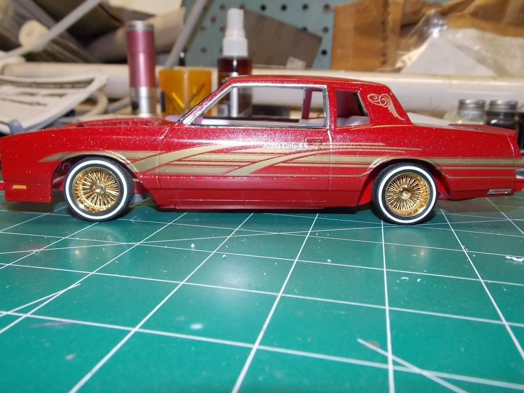

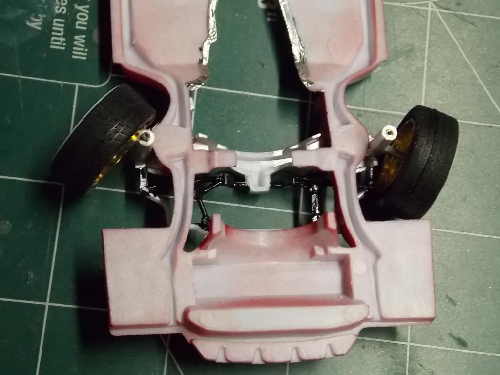

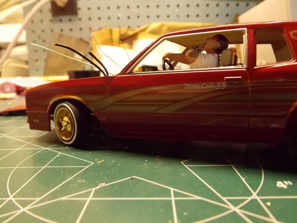

Made the front steerable and lowered the ride height by making my own spidles.
Rear suspension i adjustable

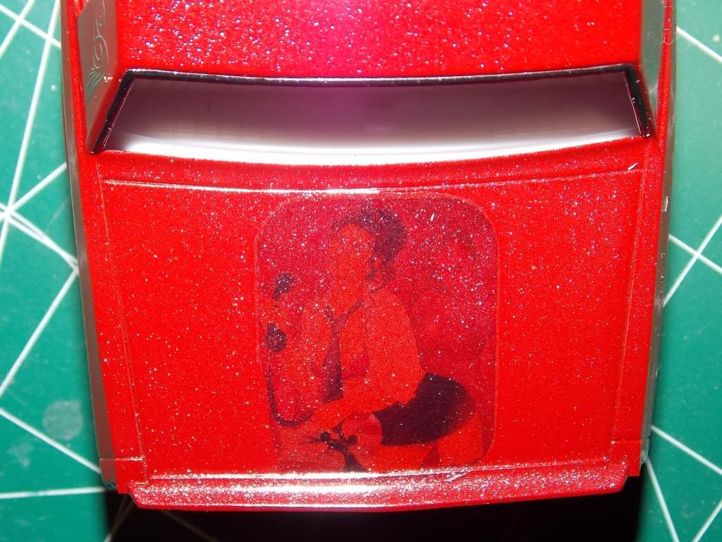

Mural on the trunk from Fraklin Ink

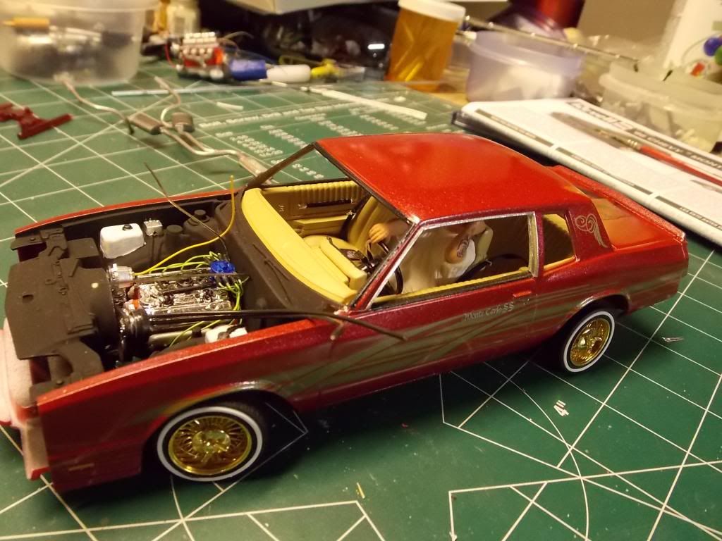

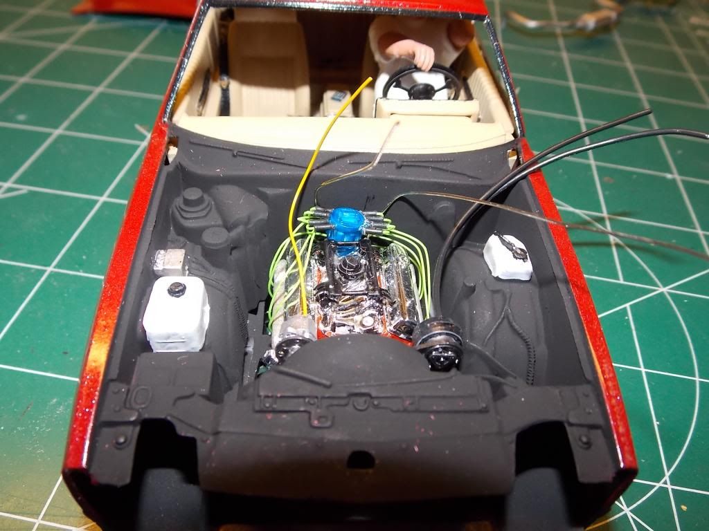

Engine bay under way
Random shots
Paint is Testors Lacquer "Revving Red" w/3 coats of Tamiya Pearl and 3 coats of Testors "Wet Look" clear. Once final assembly is complete I'll go over the body with 8000 and 12000 grit paper then polish it up.

I think it looks awesome. Love the interior detail. Suspension is really cool and engine bay it turning out great. Would love to hear/see a little more on the front spindles that you made. Great looking build!!
As you said, not my style, but a very cool car indeed! And I love the interior work. It's one of those interiors that it's a shame to hide them inside a model!
I am also one of those who are not partial to that style of build but....... I do like a well build model no matter what the subject matter is. This is one sharp build, I like it !

MikeyB08 the front was done by removing the molded in stubs for the wheels. Next I used #64 bit and drilled a hole in the A arm for a straight pin. I took some aluminum tubing, cut to size and then sized down the inside hole with two more smaller diameter tubes to fit the pin. The inner most tube is glued to the pins and the spindles rotate on them. I kept two little pieces that I had cut off to glue on the end of the inner tube to hold the spindles in place. The inner tube was left about 1/8 long for that purpose.
I wanted to put a tie rod in so they would move together but there wasn't room with the chassis and suspension on this kit are molded and mated to each other.
Awesome! Thanks for the walk through!
thats cd sticking out is just whaaaa :lol:B)B)

one thing crossed my mind would have been so cool if the engine bay was not flat black but the gold color from the stripes on the body
