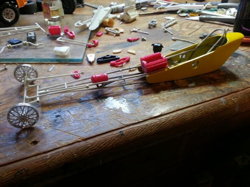

Sorry to resurrect this old thread, but, I was asked for some info regarding the build of this car and I am going to be posting some pics of the process.
First I want to start with the body mods. The body was pulled from and original kit issue body that, like the Ramchargers body, is two pieces like an airplane fuselage. After it was glued together, by Skip Sample, he cut out the cowl part so the chassis could be slipped into the body without having to glue it together and then paint it and it eliminates the seam. This can also be done to the Ramchargers body to make it look better and to work on the chassis separately.
The body from the kit is not all that accurate, but, that is what we have to work with. One thing I did to make it look better was to trim the engine side plates to more closely match the movie car.
The Ramchargers kit has to be one of them most flexible and jack of all trades chassis for mid sixties dragsters!

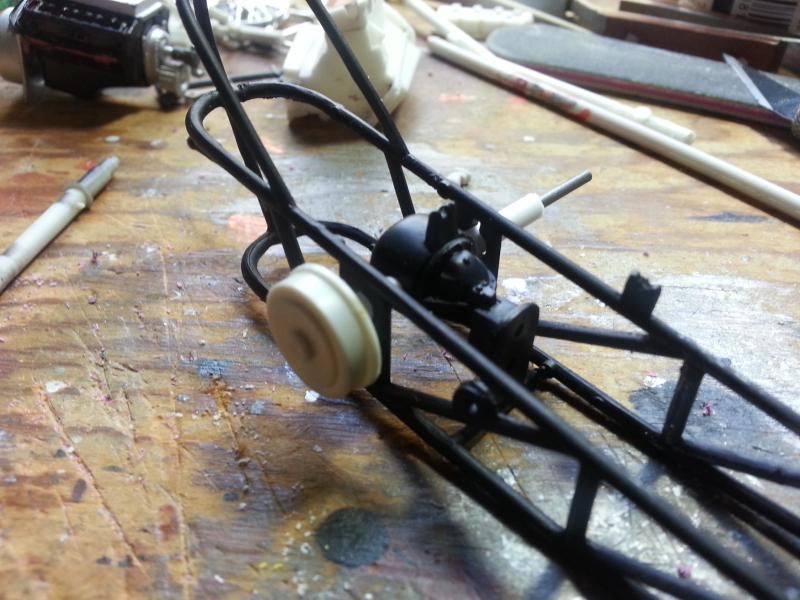

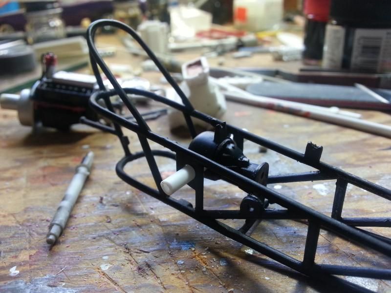

The rear axle is not really all that great in the Rams kit, so I decided to fix that by using some 1/8th tubing, the rear drum setup from the Wynn's Winder dragster and a metal axle.
Luckily the rear end of the Rams car has a separate center section that uses a solid plastic axle for the rear wheels. I simply replaced the axle with the 1/8th tube to slide in the metal axle and make it like a more conventional model kit rear end. Or as conventional as they where with metal axles!
Just cut the tubing to size and slip into frame and third member
And Voila! Axle and drums slip right in!
