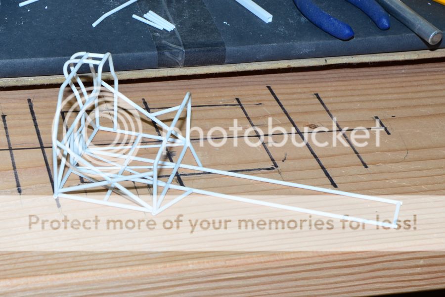

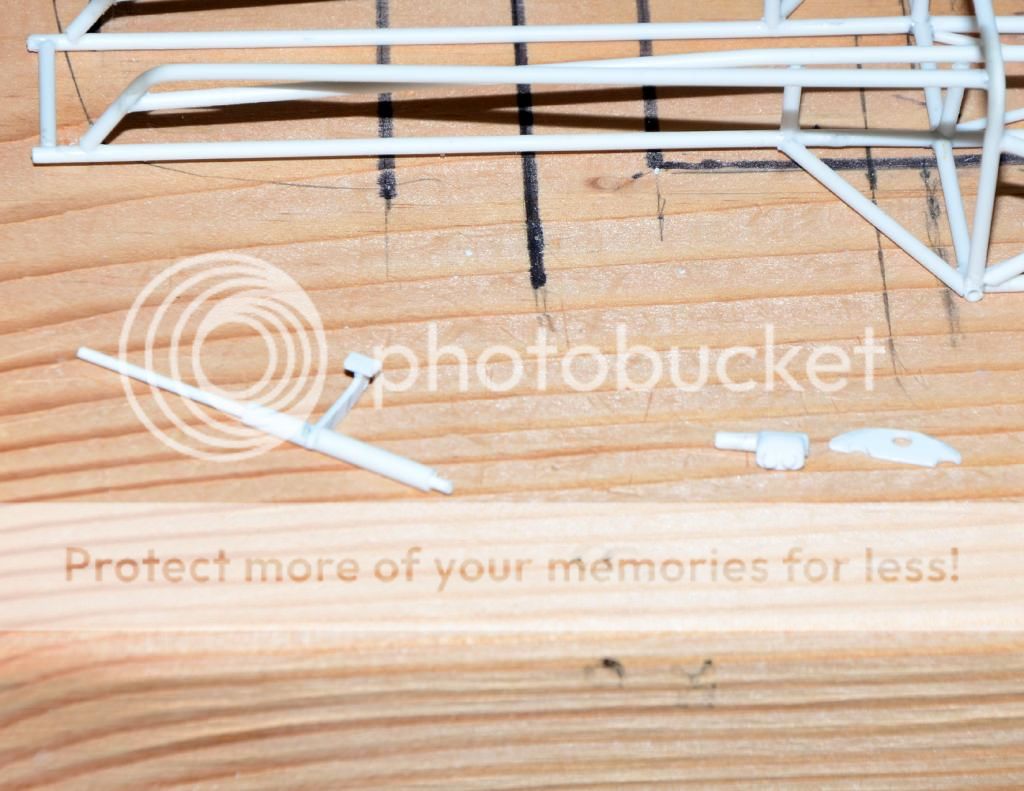

Mike, I think i used .100" for most of the main chassis, the .080" and .060" for the other stuff.

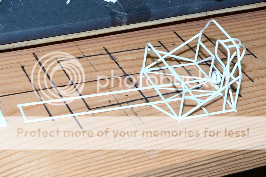

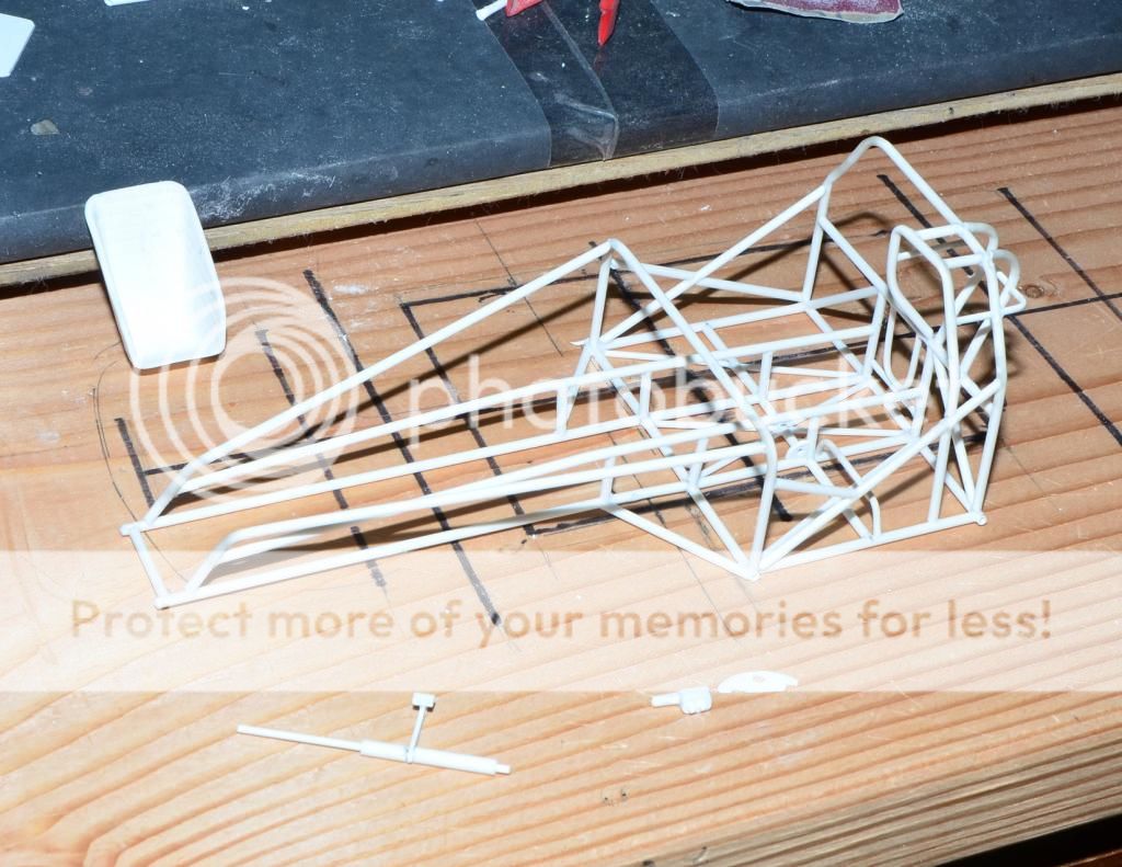

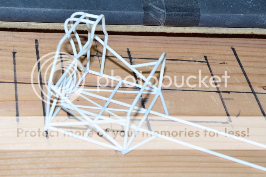

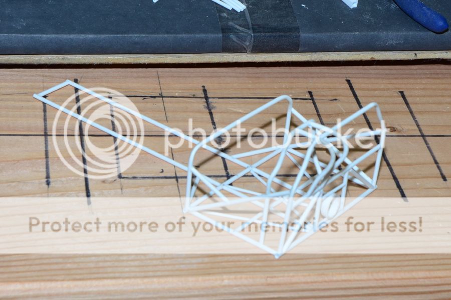

mike, what a difference. now, if your up to one more piece of advice. if you're going to make this car sit low. you're going to want to make that drive shaft hoop muucch taller. for the rear of the car to sit low the pinion will be sitting higher in the chassis. which will put your driveshaft right where the top of your driveshaft hoop is. make the hoop go all the way to the main bar above your present hoop bar.
great job!!!

Hey Mike, so pleased to see you giving this a go mate, should be a kool one to follow. :)
The chassis (part II) looks excellent too man, and with the drive shaft loop extended up a tad will look even better. B)
