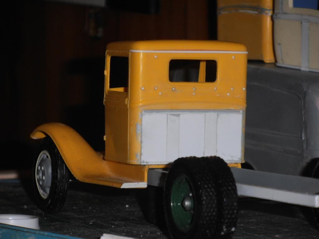

fractalign Posted August 2, 2014 Author Posted August 2, 2014 (edited) Hey Guys. Just a quick update on the trucks. At the moment I am working on the chassis for the BB and AA Fords. The cabs for the BB Fords are done and ready to mould barring a quick quality inspection in the next day or so. There are two in total, the 32 Ford is a regular cab but the 34 Ford is an Australian version with a ribbed roof. The other difference they have with their North American counterparts is a no external visor and a timber frame. The version I am producing will be similar to the one in the image. The tray will be a separate item but the kit will include the timber rails that run the length of the chassis that support the tray. I have decided to a add a full gear box with the kits as well because the trucks had heavier duty gearboxes than their passenger car counterparts. I have also decided to add more detail with the wheels, I was originally going to mould the wheels in one piece but I have opted to mould the hub caps and studs separately. The studs will be moulded from real stainless steel ones that i will be ordering shortly. Edited August 2, 2014 by fractalign

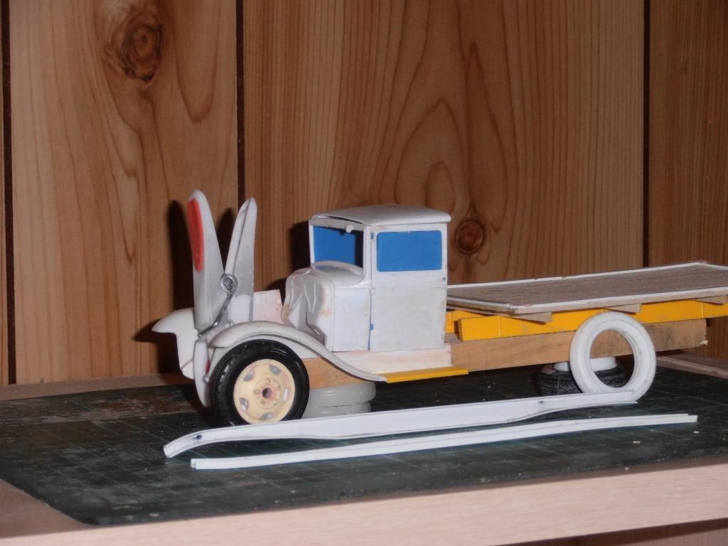

fractalign Posted August 2, 2014 Author Posted August 2, 2014 (edited) The second image is of the AA truck, since this photo was taken I have changed the wheels by drilling the holes for the studs and pieced together the rest of the cab. The cab still need the fastening studs added at the rear and the fabric over the roof added. The roof its self was totally scratch built and the rear cab was made up from the remains of some old resin 32 cabs I had lying around. Sorry there are no images of the rest of the cab, I will put them up when its closer to being finished. I have also stared work on the differential this is totally scratch built as I am having trouble finding anything else I can use. The running boards are from the Lindberg 34 Pick up. I have decided that the first AA release will be on a 157 inch wheel base like the BB trucks. The rails in the image are of the 131 inch wheelbase chassis that will be suitable for the tipper and tow truck bodies. These will follow later. There will be another version of this truck as well that will run this shorter chassis. Its called a service car and it incorporates the cargo area into the cab like a deluxe pickup. Edited August 2, 2014 by fractalign

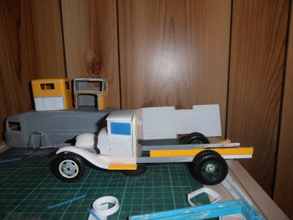

fractalign Posted August 3, 2014 Author Posted August 3, 2014 (edited) Hey Guys. Here are some photos of the trucks. These are the last I will be putting up. The next lot will be of the finished kits when ever that is. Anyway I finally pieced the Model A cab together and put it on the chassis. You can see the updated wheels as well. The Model A will be running the earlier versions of these though. The first shot gives you an idea of how much work went into putting the cab together, still lot to do but the hardest part is done. Edited August 3, 2014 by fractalign

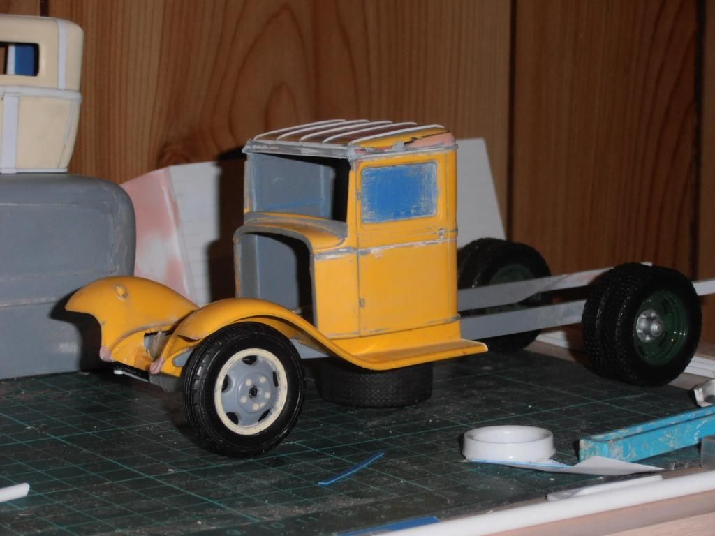

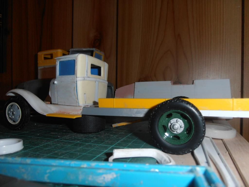

fractalign Posted August 3, 2014 Author Posted August 3, 2014 The other images are of the BB trucks, the first is the 32 version. The second one is the Australian 34 version.
Danno Posted August 3, 2014 Posted August 3, 2014 Robert, I love the work you're doing, and I'm eager to see your 30-31 AA product. However, I'm not sure about your representation of the rear wheels. All the AA wheels were identical and not position-specific. A front wheel/tire could be bolted up on the rear and vice-versa. Thus, the wheels should all be identical. The way your mock-up's rear wheels look, it appears you have the dual-wheel spacer on the exterior of the outside rear wheel. That extra disc (metal colored on your mock-up) would be positioned between the inner wheel and the outer wheel. The outer wheel would have a smooth concave dish appearance. Here's my 1:1 configured as a 1.5 ton (single rear wheels/tires). Yours is mocked up as a 2.5 ton (dual rear wheels/tires). Everything was identical between the 1.5t and 2.5t rated trucks, the extra rear wheels made the difference. In 1.5 ton configuration, the rear wheels present identical appearance as the front wheels, when viewed from the side of the truck. Notice the rear lugs are longer than necessary. To add two additional rear wheels/tires, the spacer was placed over the lugs and another pair of wheels/tires was slipped over the exposed lugs in reverse - and the lug nuts were then tightened to clamp the wheels, tires, and spacers together. By the way, in 1.5 ton configuration, all four wheels could be mounted either way, 'dish in' or 'dish out,' and you often saw the front wheels 'dish in' with the rear wheels 'dish out' on the same vehicle. In the view above, mine has all four installed 'dish in' and ready to accept another pair of wheels/tires 'dish out' to upgrade its rating to 2.5 ton. Carry on. I'm looking forward to seeing your products.
my80malibu Posted August 3, 2014 Posted August 3, 2014 Robert, I love the work you're doing, and I'm eager to see your 30-31 AA product. However, I'm not sure about your representation of the rear wheels. All the AA wheels were identical and not position-specific. A front wheel/tire could be bolted up on the rear and vice-versa. Thus, the wheels should all be identical. The way your mock-up's rear wheels look, it appears you have the dual-wheel spacer on the exterior of the outside rear wheel. That extra disc (metal colored on your mock-up) would be positioned between the inner wheel and the outer wheel. The outer wheel would have a smooth concave dish appearance. Here's my 1:1 configured as a 1.5 ton (single rear wheels/tires). Yours is mocked up as a 2.5 ton (dual rear wheels/tires). Everything was identical between the 1.5t and 2.5t rated trucks, the extra rear wheels made the difference. In 1.5 ton configuration, the rear wheels present identical appearance as the front wheels, when viewed from the side of the truck. Notice the rear lugs are longer than necessary. To add two additional rear wheels/tires, the spacer was placed over the lugs and another pair of wheels/tires was slipped over the exposed lugs in reverse - and the lug nuts were then tightened to clamp the wheels, tires, and spacers together. By the way, in 1.5 ton configuration, all four wheels could be mounted either way, 'dish in' or 'dish out,' and you often saw the front wheels 'dish in' with the rear wheels 'dish out' on the same vehicle. In the view above, mine has all four installed 'dish in' and ready to accept another pair of wheels/tires 'dish out' to upgrade its rating to 2.5 ton. Carry on. I'm looking forward to seeing your products. Dan Have you done any more work on this truck? I think this is the way it was the last time I seen it. Many years ago.
fractalign Posted August 3, 2014 Author Posted August 3, 2014 (edited) Hey Danno. You have nothing to worry about, these are not the wheels I am using for there AA or BB trucks. The lugs are off centre to the holes for a start. The AA wheels will look identical to the ones on your chassis. One thing I should add is that the lugs will be separate units so that the wheels can be joined and taken apart. The wheels in the image are from a die cast model so they are actually little too big "1:24" scale. I will be moulding them, modifying the casts and turning that into the masters. The main reason I am drilling out the lugs in these wheels is because they are off centre. I will be purchasing some stainless steel ones and moulding them to go with the wheels. ps.....since you own a full size AA chassis you might be able to help me get the details correct for my version one I start to put it together. Cheers. Edited August 3, 2014 by fractalign
