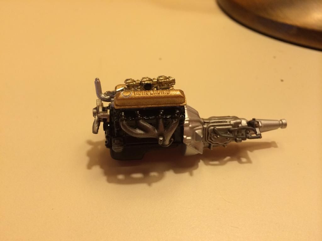

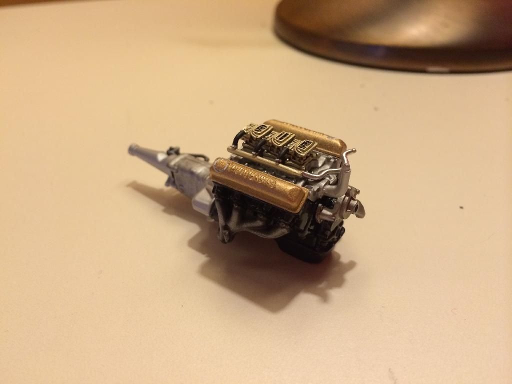

Erik Smith Posted December 26, 2013 Posted December 26, 2013 Here is a 406 I have in progress... IIRC, the block, intake and carbs are from the AMT 1962 T-Bird, most of the rest, including the Borg Warner 4 speed, is from the AMT Starliner kit - EXCEPT the valve covers. The best valve covers for the 406 are in the Mysterion kit (acutally has 2 406s) - the "thunderbird" script across the cover is the most accurate. Early 406s had problems staying together so Ford starting crossbolting the main bearings later in '62. - you can easily imitate that with two bolts on each side of the block...

Force Posted December 27, 2013 Posted December 27, 2013 (edited) Early 406s had problems staying together so Ford starting crossbolting the main bearings later in '62. - you can easily imitate that with two bolts on each side of the block... There are five main caps on a FE engine and both the late 406 and all 427 has cross bolts on number 2, 3 and 4 from late '62 onwards (406 with cross bolts are very rare though), so It should be three bolts on each side...most hi-perf engines from Ford also had threaded screw in freeze plugs...but these things are not that visible on a model so you can leave it off. Edited December 27, 2013 by Force
