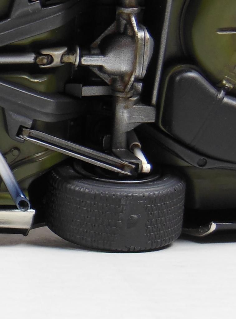

Erik Smith Posted April 10, 2014 Posted April 10, 2014 Yes. It's very easy. I use brass becuase it is thinner than aluminum. This one: is on a '66 Riviera. It is a brass tube with a styrene rod inserted, two styrene rod sections glued to each end (taper the ends), and a PE bolt. Easy and looks way better than a kit shock. Now, if somebody would actually look under one of my models...
