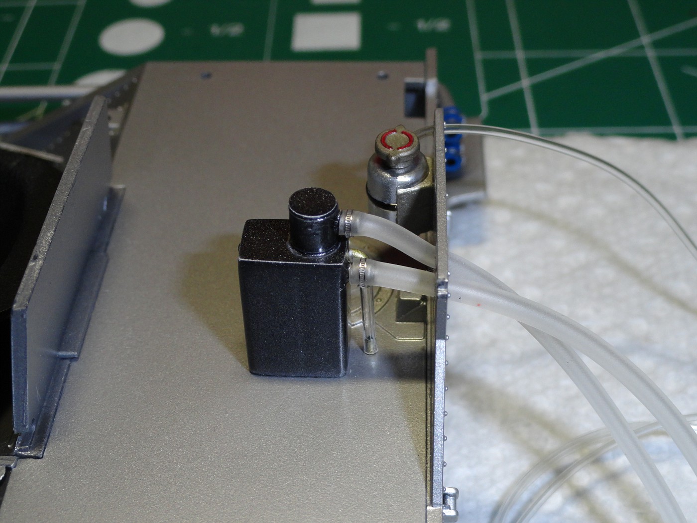

Here I am test fitting the scratchbuilt tank. The body cowling will cover most of it.
I was able to put the cowling on the tub. The cowling is twisted and I had a heck of a time getting it epoxied down. By the way this is the second cowling. This first one was warped / twisted so bad I could not use it. I also mated the drivetrain to the tub. Lots of pipes and tubing to connect the two. Some were easy to do, some were a bear. Here are a couple of pics. I had a bit of a time trying to photograph this thing. It is big!

In the next picture you can see that Tamiya would have you push a piece of black vinyl tubing unto the radiator. Not gonna happen! The kit piece, (the stub), is not long enough to put the three fittings on so I had to lengthen it. I used 1.5mm rod for the extension. I sanded the stub down flat so I could join the rod to it. How to keep it lined up and straight? I used the aluminum tubing as a sleeve to keep the pieces lined up. I let the glue set up and dropped the fittings on.
I will cut the rod down and install the braided line into the red A/N fitting.
I was able to finish installing the front radiator and the associated plumbing. I have great reference pictures of the front radiator and the braided line but have zero reference pictures of how the hard line is plumbed at the rear of the car. I know from pictures that the braided line goes into a hard line back to the engine. Where the hard line ends up, I have no idea. I did the best I could with the knowledge I had.
Next is another side shot of the radiator and plumbing. It is a VERY tight fit where the braided line runs through the front suspension. There is not a lot of room to maneuver the thick line or fittings. I had to do a lot of planning and testing before I cut the braided line and rod to their final length.
