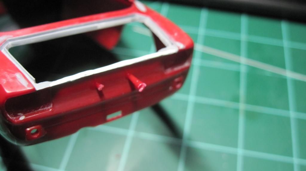

I am using Tamiya white putty to fill in locator holes and the hood blower opening cut outs on an AMT nomad. After several costs of putty and sanding I was ready for primer. I used Tamiya fine sandable primer in three mist coats only to find that the putty had lifted or expanded causing me to sand down the putty. I am now ready to prime again but am kind of leery of using the Tamiya primer. Was this lifting a fluke or is it normal, and has anyone else experienced this. Any suggestions would be appreciated!!

Jim, I just looked at my tube of Tamiya white putty. I can't imagine there being a problem using their primer since on the white putty tube instructions it says you can 'dilute' the putty with Tamiya lacquer thinner and I'm pretty sure their primer is lacquer based. From what I just read on-line it sounds like your problem may have something to do with 'curing' time, which can be eight hours, or , longer(?) to fully cure, it doesn't say on the tube how long curing time is. Let it sit overnight before priming and see if that doesn't 'cure' the problem.
Gene, thank you very much for the information!!! I believe my problem is with curing, I know it did not cure for 8 hours before spraying, probably more like two hours!! Hopefully I will get a chance to try again this weekend.
