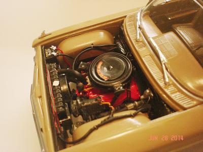

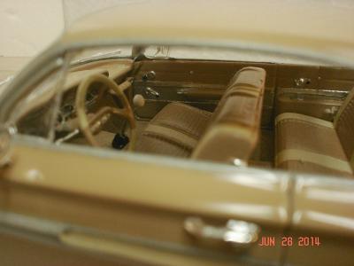

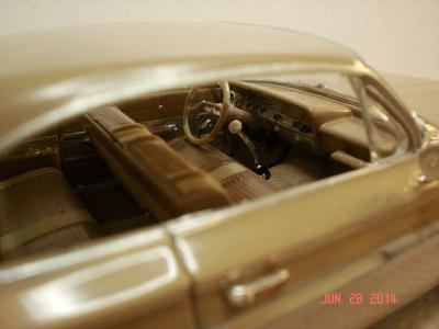

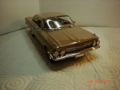

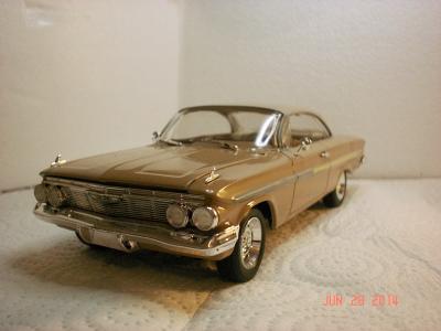

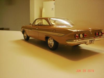

Thank's all that responded ..First off a couple pictures of the finished car..
Next : Paint is Model Masters Sand Beige and Clear. ( Krylon ) Ivory for side inserts and interior inserts.
Car was Painted then sat for a week or week and a half then it was sanded with 6000 Wet or Dry
Sandpaper.. Then re-shot and Cleared, has not been sanded or buffed since it was cleared..

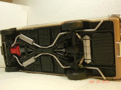

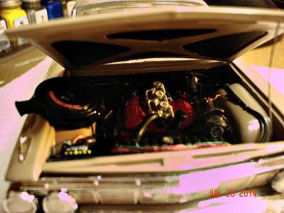

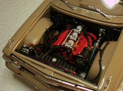

PE Parts: include Throttle Linkage - Distributor w/vacuum advance and plug boots - wire looms -
radiator cap - battery post ends -
Scratch Built : Complete Fuel Lines
Complete Brake Lines
" Real " Coil Springs ( all four )
Shocks inside front Coils
Dip Stick
Heater Hose's
Generator / Voltage Regulator Wiring
Muffler Clamps..
Any Questions or Comment's or suggestions are welcomed ...
Enjoy. Tom / 60s era

Very well done and the color scheme is right on..Is that the Lindberg Chevy? and if so how can you tell on the box which one is the "corrected" version..Really liking you build..Very clean..
Thanks Wayne.
Yes it is the Lindberg kit. I do not know how to tell if it is the " corrected version " sorry...
Tom
